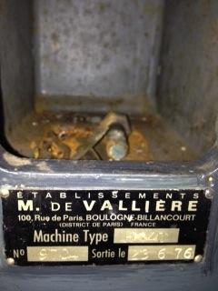

Hi again,
here's my post to "Usinages"
http://www.usinages.com/post651178.html#p651178
From what I can see, there compiling a list of De Devalliere owners, a photo of the makers plate and some information about where you are might be appreciated.

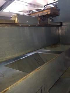

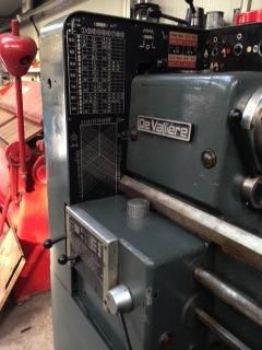

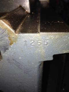

Hi Matthew,
I am living and working in Dublin, Ireland and I have a small workshop.
The work I do is mainly repair work and small projects.
Mostly sheet metal work but all tools are very necessary as you know.
I have the usual hand folder, hand knife 1metre long, hand corner notcher ( soon to be 'air operated') , pedestal spot welder 'Armless' ( more work), fly press, welders, drills, small mill, ect.
so thats where my lovely Devalliere H 140 F will live.
I notice that there is no 'cross slide detachment unit ( sorry I don't know the name of it)
I was wondering if there was any parts available ?
And any other information would be gladly received, what oils to be used?
Here are some photo's

Hi,
I'll post the photos, could you send me another photo of the makers plate, to my personal email, mattinkeratyahoodotcom, any size, without the glare that makes it un readable!
Are you talking about the tool holder? There was talk in one of the threads about what size quick change tool holder to use on the 140. A photo of the cross slide would help identify your needs!

Hi Mattinker,
this is a Metric machine.
the gears are 40; 50; 60; 65; 70; 90; 95; 120; 127.
I have changed the oil in the headstock and noticed the 'oil deflection plate' is missing.
After searching 'Usinages" site I found a post on this plate with dimensions, so I will make one, although I think some of the guys don't think it necessary.
Next for oil is the saddle apron, I'm wondering if I should strip it down to inspect/clean?
Having run the motor, the control levers are making more sense to me now.
 The 3 jaw chuck seams to be original, I am just wondering if its possible to get replacement inside/outside jaws from Ladner in France or where ever.
