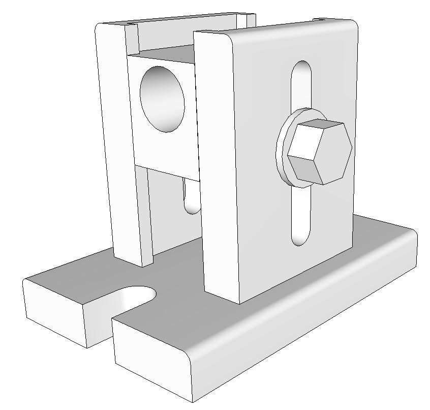

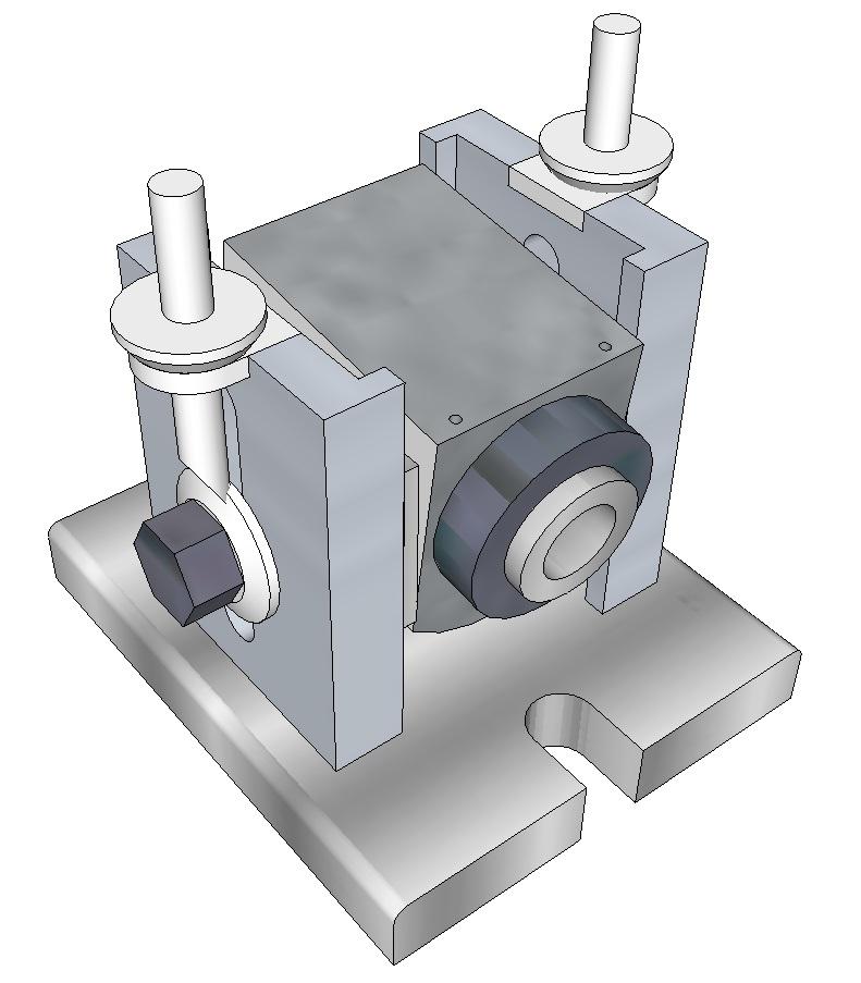

I plan to make a tailstock for my Vortex dividing head.   :smart:
I had done the attached sketch with a MK2 moveable up/Down and fastened with a 10mm  bolt BUT ...
How can I make the up/Down movement ADJUSTABLE with a screw ?  :scratch: :scratch: :scratch:
Any ideas ?

  • Posts: 537
Re: Tailstock for a Vortex dividing head ??
« Reply #1 on: September 25, 2013, 03:35:46 PM »
If you want to do away with the clamping bolt then that seems tricky and would involve precision fit slides.  If it's just for ease of adjustment, how about a screw or pair of screws through the top of your slot(s) and tapped into your bolt.  You'd probably need some way to prevent the rotation of the bolt (eg flat sides running in the slots) and enough play to allow the bolt to be tightened.

« Reply #2 on: September 25, 2013, 05:24:02 PM »
I THINK I can get the "up/Down-parts" (the block with the MORSE taper in it) to slide accurately enough with that milling faces I plan in the block itself and the sides it fits into - don't you think ?
The bolt has a nut on the hidden side ... and I beleave the bolt needs to be free and even removeable.
My first thoughts was a threaded rod (bolt) in two diagonal corners of the MORSE-taper block pushing against the bottum plate . I think I will HAVE TO adjust them BOTH to prevent the 'block' to get stocked between the "ways" - it doesn't look too clever, I think :loco: :loco: - would only one bolt do, you think ?

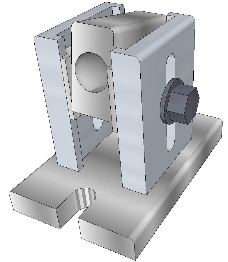

« Reply #5 on: September 28, 2013, 01:50:37 PM »
The "quick & dirty" solution could be this:
But it makes it more difficult to figure out how to do the adjustments with screws, I think  :smart: :smart: :smart:
The centerblock is pivotting around and clamped with the 10mm bolt - is this realistic ? :scratch: :scratch: :scratch:

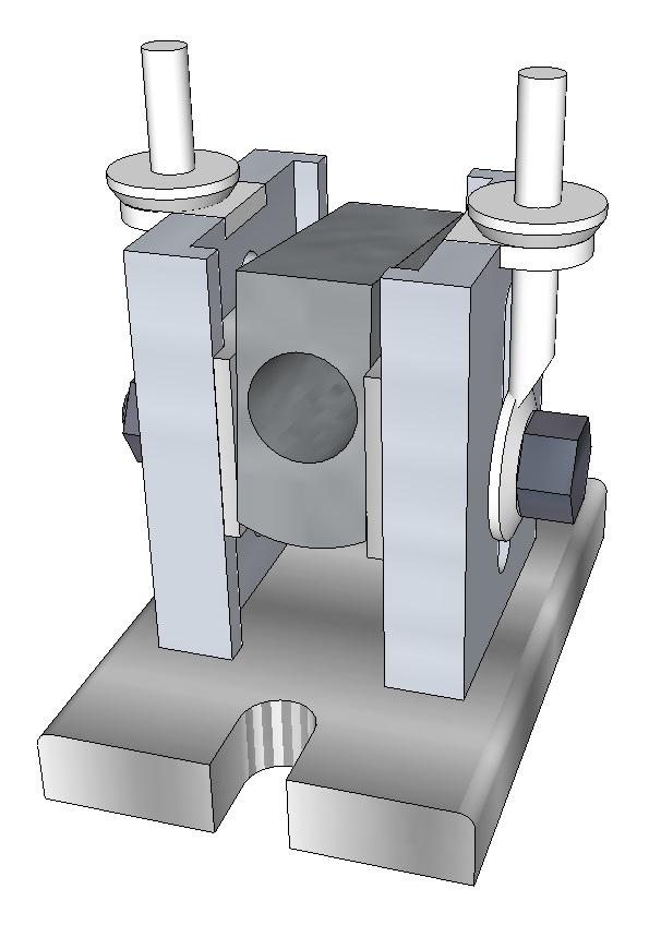

Offline ksor
  • Posts: 316
    • Keld's hjemmeside
« Reply #6 on: September 29, 2013, 07:47:36 AM »
Here it is - any comments on improvements ?
« Reply #7 on: September 29, 2013, 01:43:39 PM »
Ksor
If you could come up with a way to have the adjustment done with 1 screw/nut instead of 2 it would be an improvement. What you have shown should work well inspite of the 2 screws/nuts to adjust.  :D :D

Just an idea.

Yeah, real nice ... but I see a pair of problems:
1) you can't raise it high enough - OK, I can make the sides higher.
2) the "tilt" function is not posible
Best regards

1. You answered your own question about making the sides higher ???
2, Why would you want or need to tilt anyway ???
Most tailstocks are set to a particular height anyway and any small amount of tilting by the dividing head is allowed for by the centre in the tailstock.
In this application it is not critical that the centre sit perfectly square in the end of whatever you are tring to hold.
Also depending on the length of work being held you would only have a few degrees of movement before you were out of the range of the tailstock anyway, back to problem 1.
You would find that 99% of the time people will set the height to the centre of the dividing head and then never move it again.

I just did this in a few minutes off the top of my head.
If you give me some sizes like size of studs you want to use to hold it down with, prefered working measurments ( metric or imperial ) and morse taper you want to use.
I will see what I can come up with if you like.
Cheers.

Nice design and drawing, ausdier!  :clap:

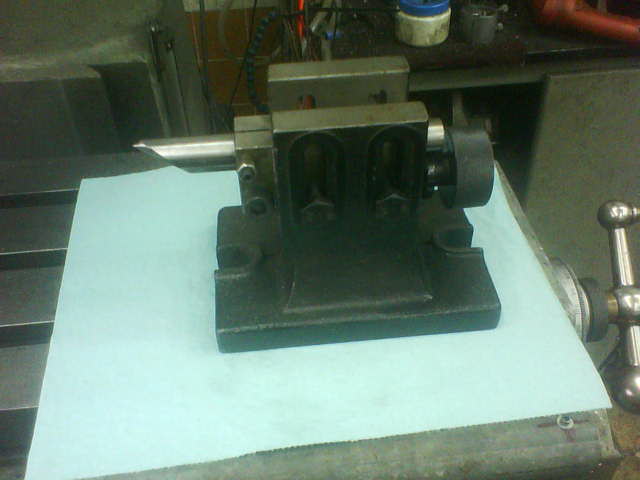

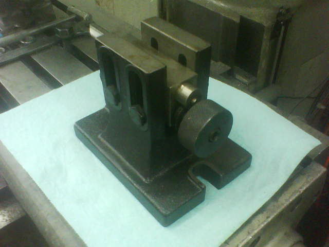

Offline unc1esteve
  • Posts: 126
« Reply #15 on: October 04, 2013, 12:54:40 PM »
Tail stock for my Grizzly dividing head.
The center is retracted by the large knob on the back.
It is able to be tilted.  I have used this feature
several times.
An up/down adjuster could be added on top.
Offline ksor
  • Posts: 316
    • Keld's hjemmeside
« Reply #16 on: October 04, 2013, 01:46:18 PM »
several times.
I believe the "tilt" function is obtained just by the "misfit" of the two bolts - right ?
The up/Down adjuster in the top would destroy the tilt,  I think - right ?
But OK, it's way simpler than mine !  :bang:

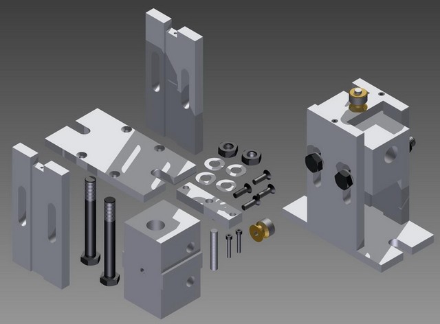

Offline ksor
  • Posts: 316
    • Keld's hjemmeside
« Reply #17 on: October 04, 2013, 01:49:27 PM »
Here I got it with some threads done the right Places it will Work ... I think  :loco: :loco: :loco:
Details on my web site: http://kelds.weebly.com/pinoldok-til-vortex.html

Offline unc1esteve
  • Posts: 126
« Reply #18 on: October 04, 2013, 04:53:50 PM »
The tilt and height is adjusted by the two bolts.
I think a linkage type adjustment could be made for the height.
All my tools require adjusting before use.
Maybe make the height adjustment removable?
