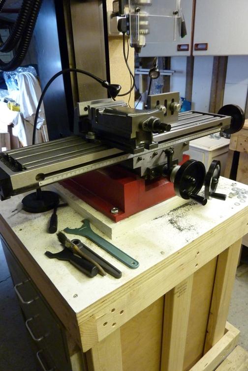

On a side point, what do you guys do to jack up small machines in terms of "feet".  I feel, like the x2, that the base needs lifting slightly to give more space below the hand wheels. Or do you just bolt directly onto the work surface?  I only mention feet as I noticed that is what he was using but was adiment that the feet were not with the machine in his advert!!  They looked like m10 bolts with a 2" metal disk with rubber glued to the bottom!

I just used some 2 x 2 hardwood under the oil tray , made a small drawer from ally to fit , but it's only a X1 a lot smaller than yours to small really .
Chris
They just look like Anti-Vibration Mounts .... nothing special, similar to these:
http://www.machinemart.co.uk/shop/range/guid/C769CDF5-DB4D-44CC-993E-8F0D8D7CE8C1?da=1&TC=SRC-anti+vibration
Dave BC
Re: A new mill for me! X3 Sieg
« Reply #8 on: August 17, 2013, 03:51:31 AM »
Chris,
I got some 2 x 2 steel box section and cut it to length and used that to jack up my mill......

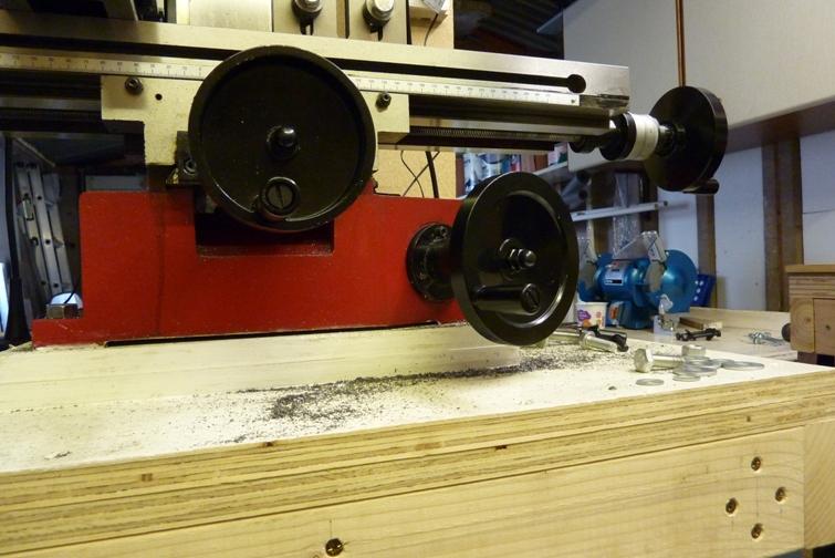

« Reply #9 on: August 17, 2013, 04:47:51 AM »
Hi Chris,
Well done with the mill purchase. I removed the feet and bolted mine to the bench I'd made for it. I put a plinth of plywood under the base to raise it slightly otherwise as you say the column handwheel fouls the bench. I decided this was a better approach than having it hanging over the edge of the bench. I'll get some pictures later.
Is it MT3 or R8 spindle
Gary
Offline garym
  • Posts: 119
  • Manchester, England
« Reply #10 on: August 17, 2013, 09:22:35 AM »
Chris,
Photos attached, as promised. Plinth is 2 x 18mm ply.
Gary
« Reply #11 on: August 17, 2013, 11:18:51 AM »
One thing I forgot to mention....
My X2 mill stands on 2 box section steel risers as I said in my previous...
The whole thing then stands in a plastic seed tray ( about 600mm sq ) and that contains all the crap....swarf/coolant ect...Stops your nice polished ench geting wet... :)
