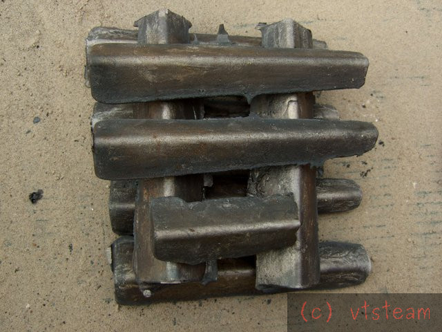

Instead of trying to pour the same pattern again, I decided to just make ingots. And to do that I would use my old broken up radiator material, rather than cleaner thicker iron.
And I decided to use flux, since i didn't care about the crucible. I would do two melts, one with oyster shell, in the form of the ground up powder they feed chickens. it is supposed to be calcium carbonate -- as is limestone or agricultural lime.
And for the second melt, I would go back to good old sodium carbonate (soda ash).
This would at least do something useful with the old crucible and convert the radiator scrap into clean metal, plus give me a comparison with the two fluxes.

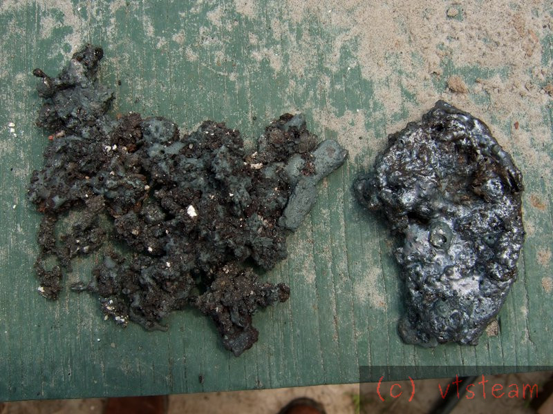

Here is a comparison of the slag scraped from the melt before pouring radiator metal when fluxed with, left, ground oyster shell (calcium carbonate), and right, soda ash (sodium carbonate).
Besides the roughness of the slag on the left, notice the white specks of unmelted shell. The right hand slag is glass-like and iridescent -- not metallic in color, and weighs less than the slag on the left. The slag on the left is only part of what was removed, while the slag on the right was the full amount, which scooped off in one swipe.

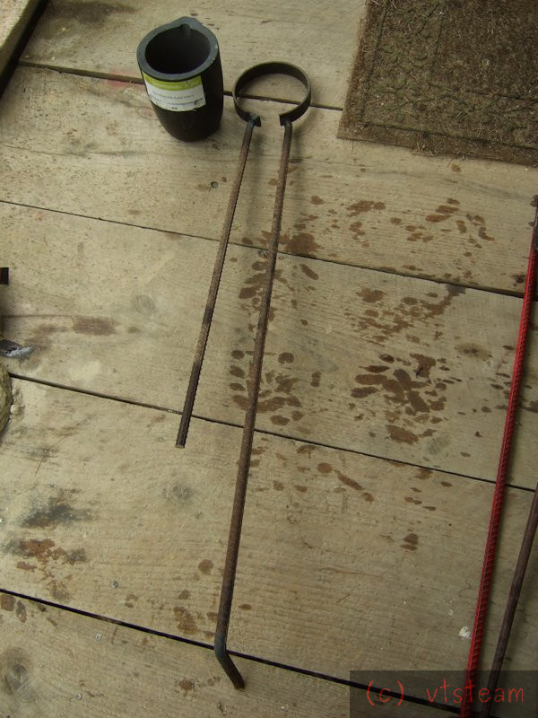

Today it rained so I did a little cold forging of the lift out tongs to fit them carefully to the new crucible. Then I rolled a steel strap and welded on some handles for a hand shank. This is the closing type rather than the ring shank I made last time. I've had two instances where the crucible slipped in the ring shank when pouring, and it's no fun!
If you think about the geometry of a tapered crucible you will realize that this is a possibility when a crucible is even tilted to horizontal. It may not slip out of the ring, but it can suddenly alter its position in the ring with a consequent redirection of the metal. Even the best fitting ring will soon be pretty approximate as a crucible ages and shows slag spills, etc.
Anyway, I saw a clamping ring type shank in Colin Peck's book, so I used that principle here, though with my usual favored re-bar, and a bent down end.

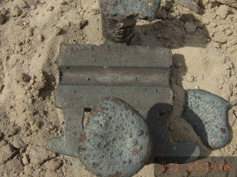

Cast this morning, with the new crucible, and just opened the mold. Not perfect, but a visible improvement. defects are fewer and smaller.
The crucible exterior looks shiny and new, the interior has some slag I couldn't scrape out, but i believe it probably has done well, too. It's too hot still to look at closely, and I'm letting it cool slowly in the furnace.
The slag was relatively compact and manageable -- not as nice as with flux added -- but much better than it had been with the old crucibles.
Total furnace run time was 1 hour 5 minutes. Actual melting time was 45 minutes, as metal wasn't added until 20 minutes after the furnace was lit.
Definite progress on all fronts. Photo of casting below:

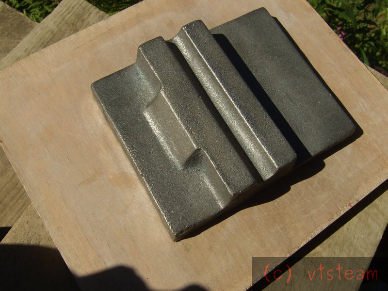

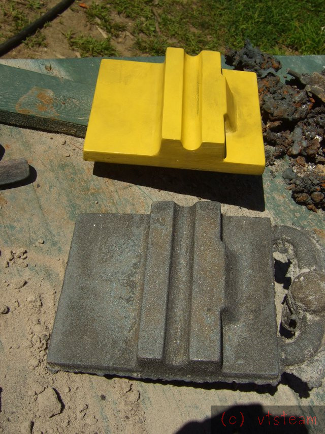

I decided to make a new pattern, somewhat larger, that incorporated another part I needed. Also this allowed me to reverse the draft so I could place a riser on the non-channeled side.
I decided to go with my latest method of melting (specific to my particular furnace and furnace lining) of using a low throttle to ramp the furnace and crucible up to red heat before adding iron. I then added 4 pounds of metal -- I needed 12 lbs for this pour, and planned two more additions. This was my largest melt -- the last had been 9 pounds. I also gave it full blast, but just slightly leaner flame than I had been using. Still very slightly rich.
I didn't bother timing the initial heat, but timed from the first addition of metal. It melted the first 4 pounds in 20 minutes, the second 4 pounds in 17 minutes,  And the last in 15 minutes. I gave it 15 minutes of extra heat to make sure, and the poker test verified it was hot metal.
This is how my own furnace seems to work best.
I got a perfect pour. No flaws. Absolutely clean. I think I now understand my furnace, my metal, my sand, my particular pattern making requirements, and my own molding requirements. And I think I can extend that to future castings. It's been a long road for me, but each time it didn't work there was an improvement of some sort or a realization. I had to see what didn't work, and learn what worked best with what I specifically have. I think I know that now. Thanks to the many who were supportive, and I'm sure I will learn a lot more as I continue to cast IRON!
I'm psyched!!!!  :ddb: :ddb: :ddb: :ddb: :ddb: :ddb:  :nrocks:
« Last Edit: January 14, 2018, 11:33:57 AM by vtsteam »

Just cleaned it with wire brush and ground off the flash:
