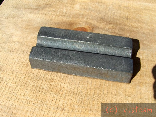

« Reply #150 on: August 05, 2013, 04:45:20 PM »
OK Steve, confess, which professional foundry did you get to do that  :clap:
  • Posts: 537
Re: Oil fired crucible furnace
« Reply #151 on: August 05, 2013, 05:14:20 PM »
Great work.  Persistence pays off.
 :bow: :clap: :bow: :clap: :bow: :clap: :bow: :clap:
« Reply #152 on: August 05, 2013, 09:28:31 PM »
Wow, thank you all! That just feels great!   :bow: :bow: :bow: :bow:  :beer:
 :mmr:
Offline ironman
  • Posts: 157
« Reply #153 on: August 06, 2013, 08:30:11 PM »
That looks really great.
What did you do to make this one a success?
« Reply #154 on: August 06, 2013, 09:05:24 PM »
Well done definetly a keeper!!  :beer:
« Reply #155 on: August 06, 2013, 09:20:28 PM »
Tom, Ironman, thank you.  :bow:
Ironman, to answer your question:
1.) I made a new pattern, reversing the draft, so I could place a riser on the non-channeled side. I could not put a riser on the old pattern because it would mess up the channel. Previously the riser was beside the pattern -- the only place it could be with the pattern draft the way it was oriented.
By altering the draft orientation and placing the riser on top of the pattern, any buoyant slag could go up the riser rather than get trapped in the channel section of the casting. Also the channel section now faced downwards, so it would naturally be protected.
While these changes would help deal with any slag in the mold, I have been on a concerted effort to eliminate slag coming into it in the first place. So:
2.) I altered my melt method to add iron later in the furnace cycle -- after the crucible and furnace walls had reached a red heat. My furnace has more mass than a blanket insulation furnace, so it has a longer warm up period. There is no reason to put iron in during this period and allow it to oxidize. I started with an empty crucible.
And to save fuel, there is no reason to run the warm-up at full throttle. 1/4 throttle works fine to bring the furnace walls and crucible to red heat. Time is more important than burner temperature for this. Once it is at red heat, metal can be added, and the furnace run at full throttle.  At this point the furnace will melt at an average rate of 1 pound per 5 minutes.  Gradually accelerating to 1 pound per 3 minutes.
3.) I gave it a longer post melt heating period to try to get the pouring temperature as high as I had patience for. That was about 15 minutes after all the iron was melted. I wanted any slag to come to the top and amalgamate, and for the casting to be fluid enough to give any slag time to come up the riser.
4.) I altered the mix ratio of the flame -- I had been running slightly richer on previous melts -- I went almost neutral -- ie. a couple almost imperceptible whisps of black smoke from the lid edges (not the glory hole). I believe this created hotter furnace temps.
5.) I increased the pressure of the burner to 60 PSI. This burner is an atomizing burner. There are two air sources, the blower (a vacuum cleaner) and the atomizing air nozzle fed by a compressor. That last one is what was increased to 60 PSI. This fed more fuel at a smaller droplet size. The flame was naturally bigger.
6.) The new better quality larger capacity crucible did not add slag to the melt, and its larger size (with more metal) retained heat better when bringing to the pour.
In other words, a lot of variables were adjusted. Apparently for the positive.

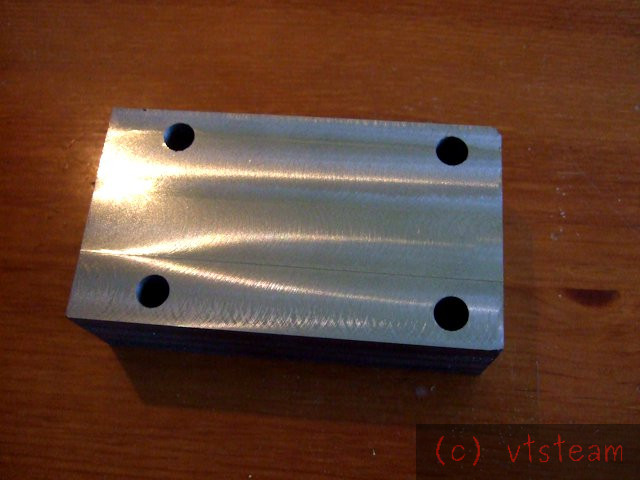

« Reply #169 on: August 14, 2013, 04:52:37 AM »
Steve,
I've just seen the photo below of your new carbide mill cleaning up one of your castings. Not only is the mill working well but very impressed how clean & homogeneous the casting looks.
Dave  :clap: :thumbup: :clap: :thumbup: :clap: :thumbup: :clap:
Does a nice job, too. This was what it did to a back yard casting.

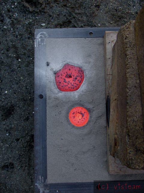

A pretty sight -- an evening pour beginning to cool.
« Last Edit: January 14, 2018, 11:40:12 AM by vtsteam »

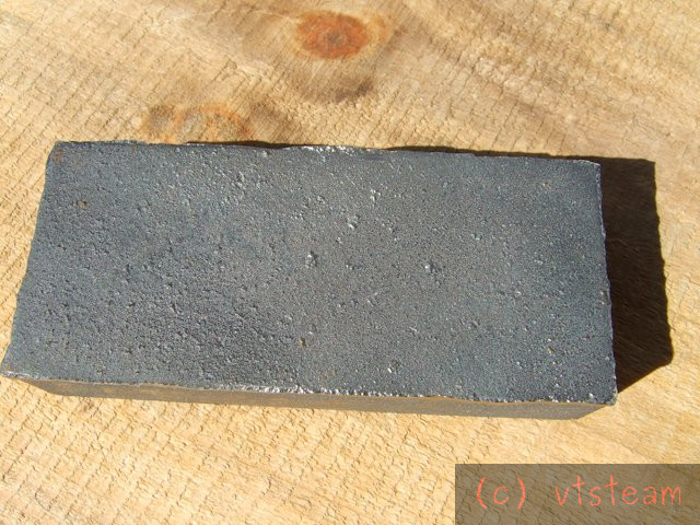

This is yesterday's casting. I decided to try pure (rusty) radiator scrap -- not refined ingots, sprues, prior castings or thicker iron. I did the opposite of what I've been doing recently, and added the metal to the crucible before bringing to a red heat, added charcoal to cover, and added a tablespoon of sodium carbonate (fingers crossed the crucible wouldn't get messed up).
Then I continuously added more Iron as the stuff in the crucible melted. Finally just before the pour, I added about a tablespoon more of the sodium carbonate, stirred and waited another ten minutes. Finally lifted the crucible set it in the shank, scraped the slag off quickly and poured.
Looks as good as the last one -- the little spot is just where a vent wire hit the pattern, but not a structural flaw. This face will be machined and the bore widened.
« Last Edit: January 14, 2018, 11:40:54 AM by vtsteam »
