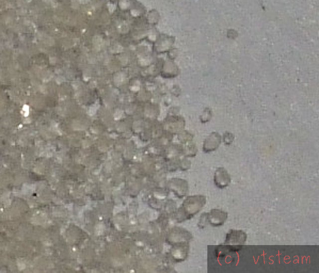

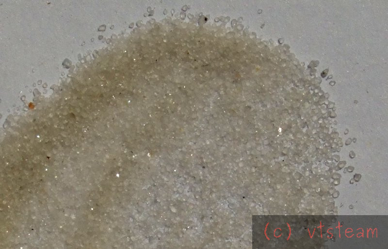

Pat, I think I have seen the same information repeated enough to have it memorized by now. That's not my way. I look forward to reading your own casting project threads.  I do see great value to be gained by rediscovering the mistakes that many others have already made, and as Andrew already stated "the journey is more important than the destination".
Change of subject. Here are photos of my F60 silica sand without any binder.

Offline tekfab
  • Posts: 133
Re: Oil fired crucible furnace
« Reply #94 on: July 27, 2013, 02:53:55 PM »
That's quite possibly the nicest F60 silica sand that i've ever seen.

« Reply #95 on: July 27, 2013, 03:04:54 PM »
That sand would I believe be called sub-angular in grain shape. I've made up some new greensand today with 4% bentonite, and 4% water. The idea being to try it, and possibly gradually increase the bentonite content by 1 % steps over a few castings.
I won't be able to try that until tomorrow in order to let it rest. But I will cast today using my other sand at 2.5 % moisture content, as measured today, and with the new thicker iron I used last pour. the crucible will be one of the poor ones, but it has only one pour under its belt, and is clean inside. I should get another 3 melts out of it before switching to the new Salamander Super A-6, which needs a pouring shank and tongs made to fit.
I will not use flux today.
Offline tekfab
  • Posts: 133
« Reply #96 on: July 27, 2013, 03:22:39 PM »
The picture is not crystal clear but to me it looks like you have a sub-angular/sub-rounded mix but as i said i'm only going by what i can see in the pcture.
