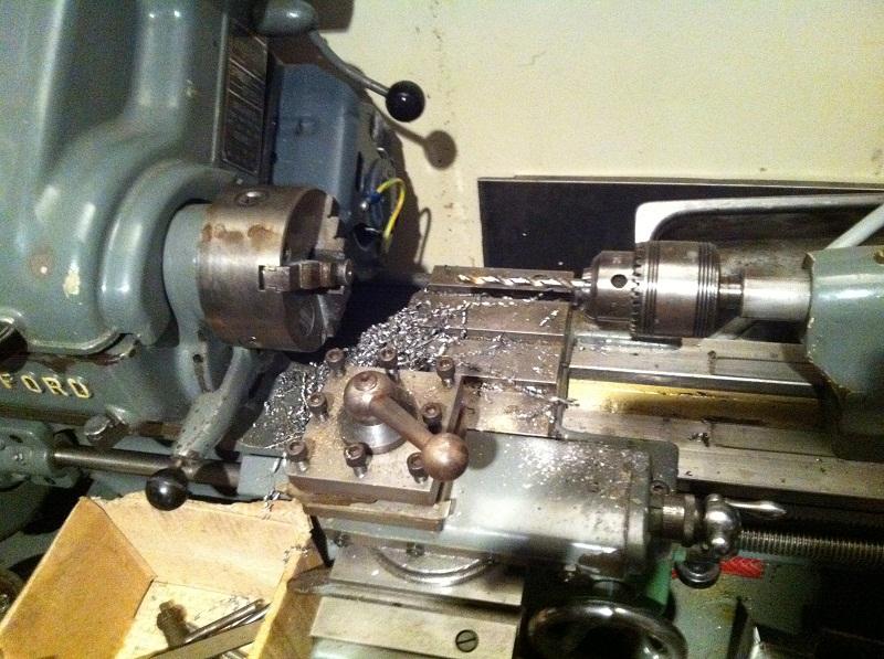

The last time I used a lathe was at school so looking at the lists of bits n pieces is starting to confuse me. I have an old Myford lathe s7 with rotating tool post. Just looking to learn how to cut internal and external threads and be able to part off. Been looking at RDG tools and mainly wanting to machine stainless would I be better of getting indexable tools due to not having a grinding wheel. I havent got much in the way of tooling and I really dont want to waste any money. Am I better of getting 8,10,12mm shank holders ?? Help please  :scratch:

That picture is chuffin huge - can you re-size it to 800x600 please?
What grade of stainless are you cutting? Some of it is hard on lathe tools.

Hows that ?  Stainless grade about 316 but could go harder.

Photo is spot on now Trebor  :thumbup:
In a Myford 4 way tool holder can only use up to 6mm / 1/4" shank tooling , the quick change tool holders made for the Myford will take 8 mm shank tooling .
I use these 6mm ones on my Myford . Set of 6mm Glanze Mini Indexable Turning Tools XC50  (Ref: 777101.)

So you could not use 8mm shanks in the 4 way tool holder ? only Ive just looked at one I got with it and it measures 8mm.

Put the 8 mm tool in the holder , is the tip on centre height ?

I'm pretty sure it's under centres will double check when I can get out there ! What's the ideal hight ?

As a rule the tip ( cutting area) of the lathe tool needs to be as close as possible to the centre height of the lathe.  An easy way to set yopur tool to this height is to put a centre in either the tailstock or headstock and set your tool so the cutting tip is at the same height as the point on the centre.  If you dont have a quick change tool post ( sorry not looked at your photo) and your tool is below centre height you can correct this by putting packing pieces under the tool in the tool post.  However if it is above centre height you would need to use a smaller section tool.
I recently bought a QCTP and I find it a lot easier but they do cost a bit to get started and extra toolholders are not cheap.
If you do need a few packers I may have some in my garage in a few thicknesses from about 0.6mm up to about 3mm.
