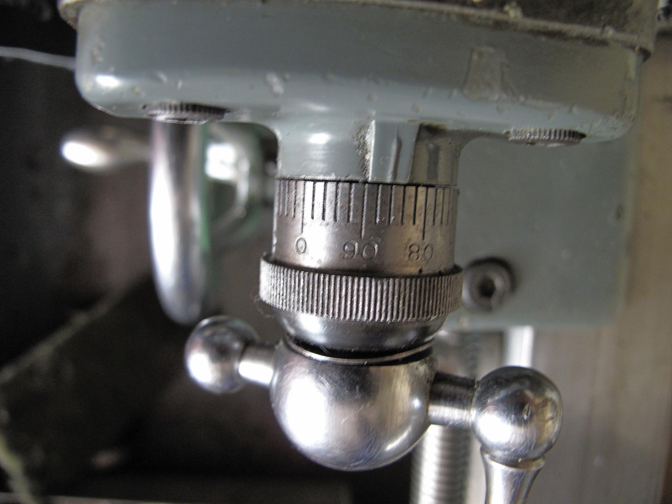

« Reply #32 on: June 28, 2013, 01:35:39 PM »
Well the metric dials are 0 to 40 and imp 0 to 100. I have feed screws that move tool post 2mm on full turn. I did check this before speaking to Myford. I have metric cross feed dial and feed screw, metric top feed screw and imperial dial.

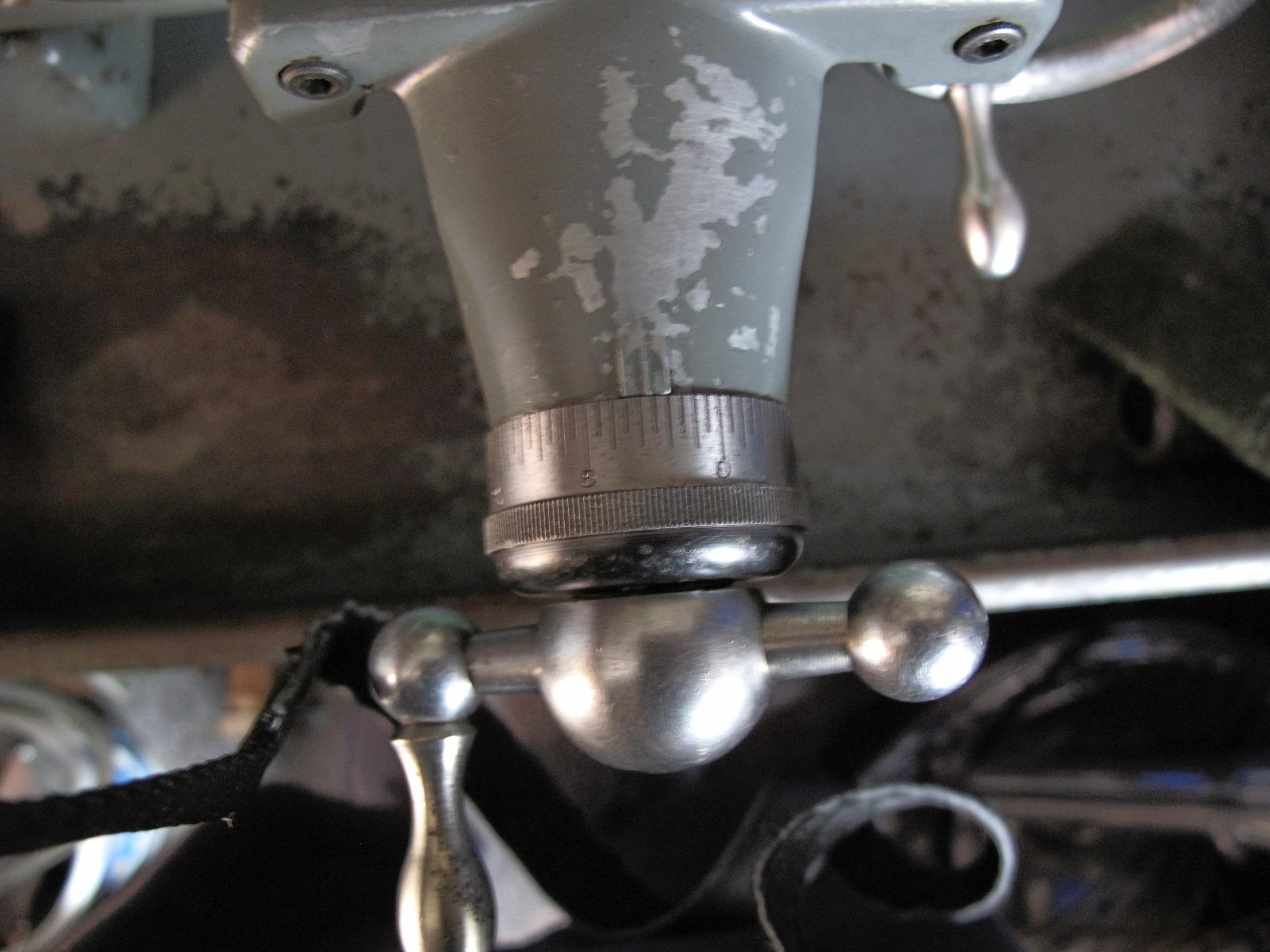

sorry about the pictures this is the only site I have trouble loading pictures on !! just got to get used to it.
Re: Lathe Tools
« Reply #34 on: June 28, 2013, 01:47:04 PM »
How far does the topslide actually move for 1 full turn of the dial.  Measures with a dial gauge ?
Offline Trebor
  • Posts: 63
Re: Lathe Tools
« Reply #35 on: June 28, 2013, 02:17:41 PM »
I only have a vernier gauge but on 1 full turn it moves 2mm.
Re: Lathe Tools
« Reply #36 on: June 28, 2013, 03:15:34 PM »
Then if that 40 on the dial was read as 4.0 it would seem to indicate the amount of reduction on the diameter per revolution.  I.e 2 x 2
Anyone agree ?
Re: Lathe Tools
« Reply #37 on: June 28, 2013, 03:25:00 PM »
Yep, direct-reading dial, 2mm travel is 4mm off the OD.
