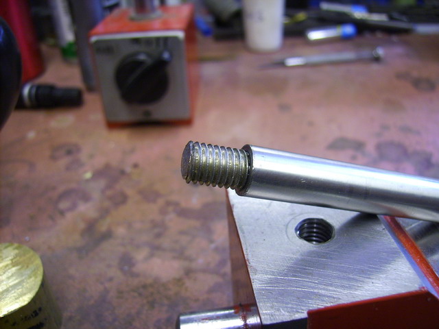

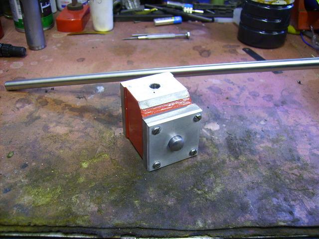

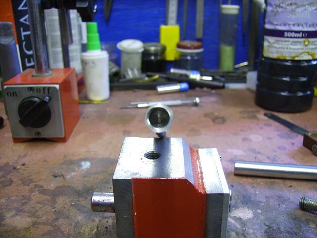

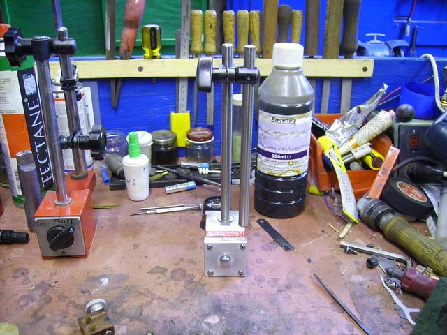

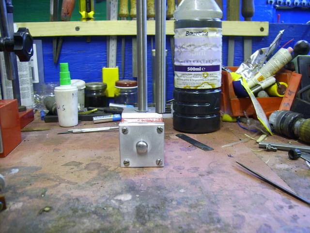

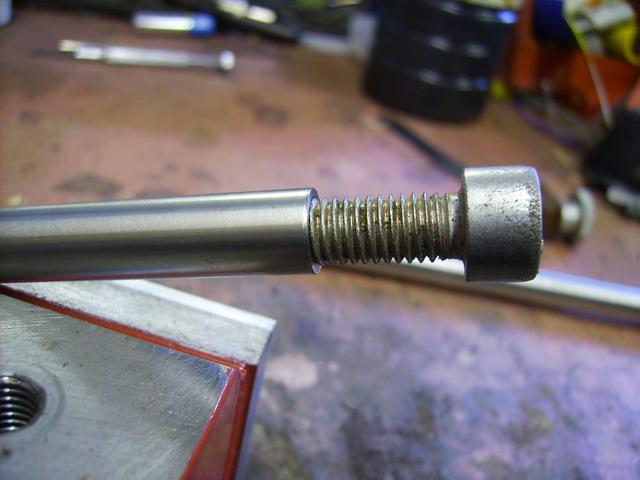

hi all i sed that i had bin a bizzy boy right i got this sum time a go but the magnet was us so i fited a new one don't no wher it cam from but it did the job but the bar that gose on the top was missing so i made a new one out of sum 10mm stanles steel rod i coped the lenth of rod needed of the clock stand that i got of john i drilld the botom and tapt one lenthe  to fita m8 cap head wich was scruwd in with sum bering fit next thing to mack is sum clamps the one in the pic is just ther for show right pics
