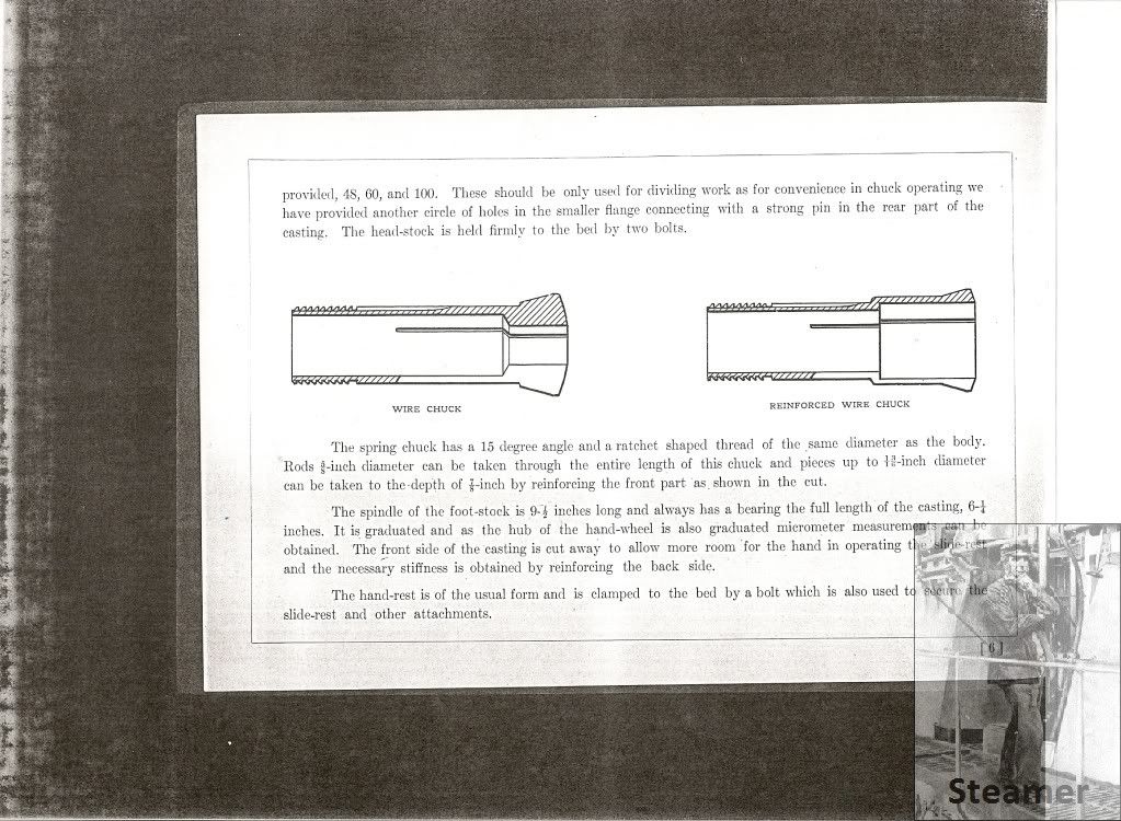

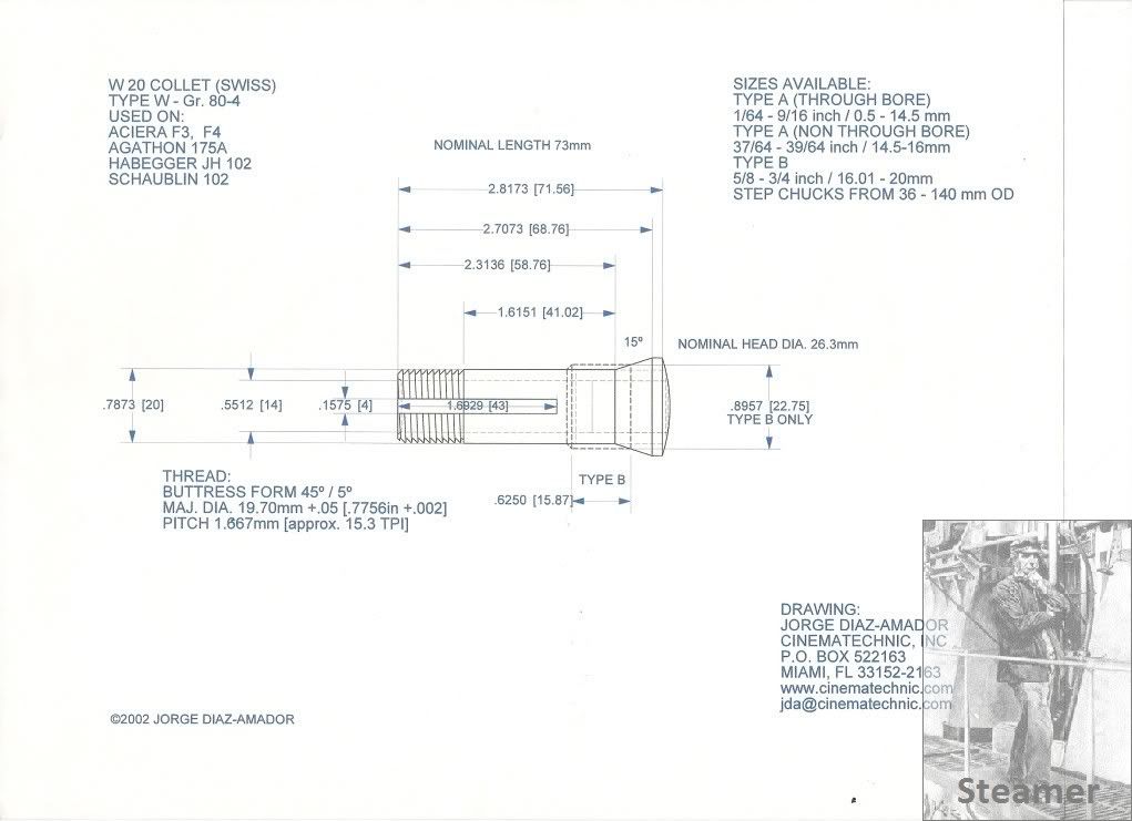

Another question for you guys with aciera machines..
I have a 20mm collet.. that has "full depth"..  but i bought an aftermarket 20mm collet, it only had like 12mm depth of grip.
Im wondering, where did that first 20mm collet come from.. it seems to be a "model A" collet as well.. can it be a inch collet like 3/4 that has been
stretched over time so it take 20mm straight shank.. it baffles med at the same time its awsome.. cause i can hold 20mm straight shanks.. but if it
breaks i will cry..

Thats a W20 collet I believe.
This style collet started with Waltham Machine works in about 1899.   Here's a copy of the 1909 catalog...including both styles of collet

W20 collets. Aciera and Schaublin uses these collets in "original" configuration.
See page 14:
http://www.niederhauser.ch/LinkedDocuments/FN_Handspannzangenfutter_en_screen.pdf
Outside diameter of shell is 20 mm, up to 16 mm passes trough, but over 16 mm must be accomdated on conical area. These collets are available, but not that popular. I have seen specs even over 20mm, but the gripping area gets progressively smaller.

Confirmed already twice, but these are W20 collets and they are mighty tricky to get hold of. I managed to get a set for my horizontal mill but you`ll have to look hard to find a set.
