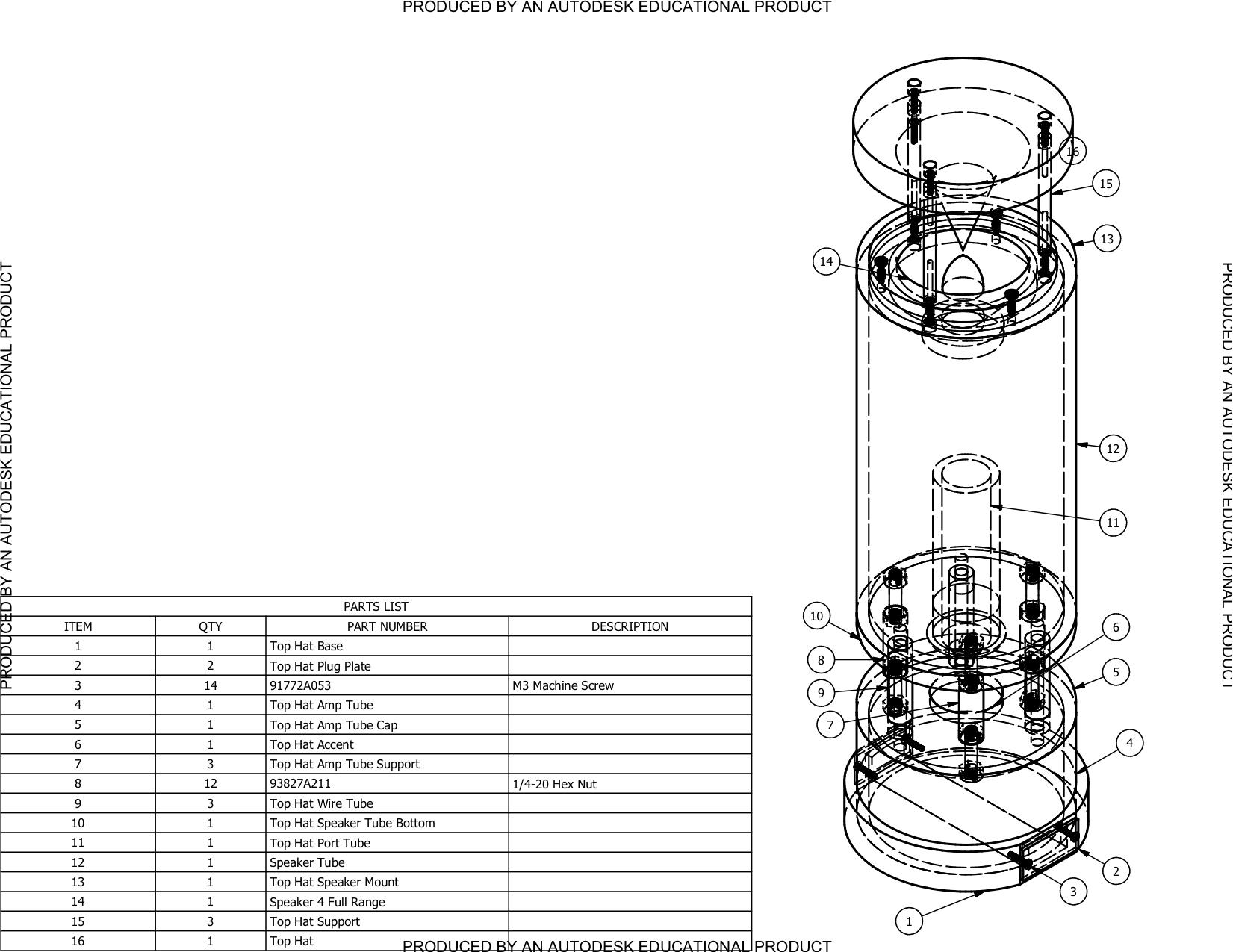

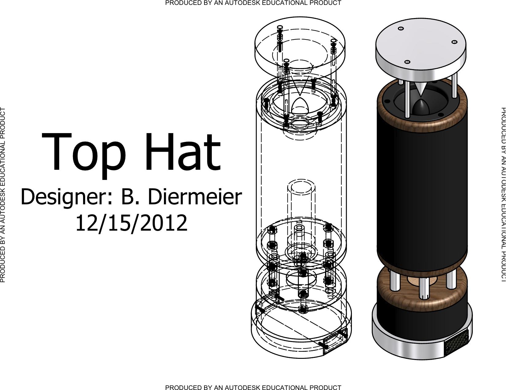

My 15 year old nephew sent over some cad drawings for some speakers that he wants to build.  He drew up full plans in cad for them and needs me to make the "Top Hat" portion out of aluminum.  I originally planed to make them on my 9X20 lathe, but now that the CNC is up and running I might give it a shot.  The only problem is the stock is 5" in diameter and my CNC only has a 4" chuck and is missing the reversible jaws so I need to find a way to hold it.  I'm thinking of making a 6" face plate to mount to the 2 1/4" - 8 tpi spindle and mount the stock to that.  Should be a neat project and I will take pictures as I go along and post on a new thread.
Here are a few pictures of the print he made for the speakers.  The last picture shows the top part that I need to make, and not just one, but I have to make two of them for the right and left speaker.
Dale P.

Great speakers and CAD work; especially for a 15 yr. old.  I'll bet his Dad's proud of him!
You can get a 2 1/4"-8 semi-finished adaptor plate from CDCO Tools.com for $42.00.  Unless you have a stash of big metal lying around, it'd be hard to beat that.

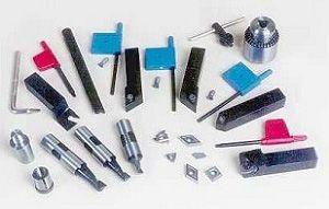

I contacted Interteck to see how much a replacement chuck wrench would be since I don't have one and also asked about replacement inserts just to see how much they charged for them.  They responded and said the chuck wrench was $116.00 and gave me a link to replacing all of the tooling and said it would cost $2035.00 for the tool holders and inserts! Can you believe that, two grand for a few tool holders and boring bars.  Here is a picture of what you would get.
No thanks, I will make my own wrench and figure out what size the inserts are and order them my self.
