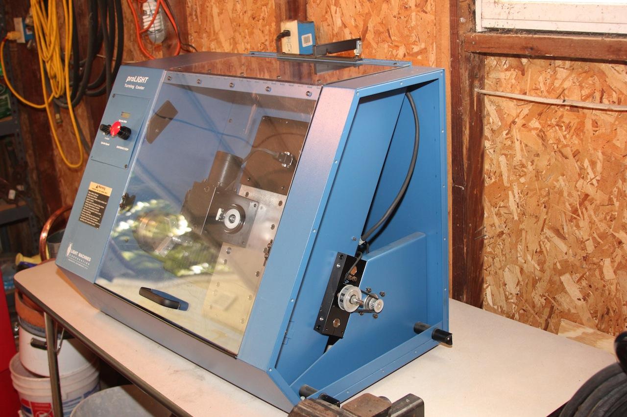

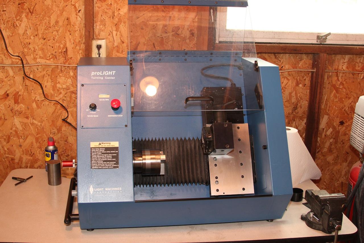

I just bought a CNC lathe.  It's a prolight 3000 and is loaded with all the goodies.  There is a automatic tool changer, a pneumatic chuck that can be opened and closed via the computer as well as the door for the machine.  It also came with a standard three jaw chuck.  As a bonus the chuck can be removed and a 5c collet will fit inside of the spindle! The tool changer holds four 1/2" tool holders which came with and four 1/2" round tools for drilling and boring.
The bad part is it's missing the control box, so I will have to build my own but for $500.00 I can't complain.  Now I need a CNC mill to go along with it.
Any one here have a similar machine?

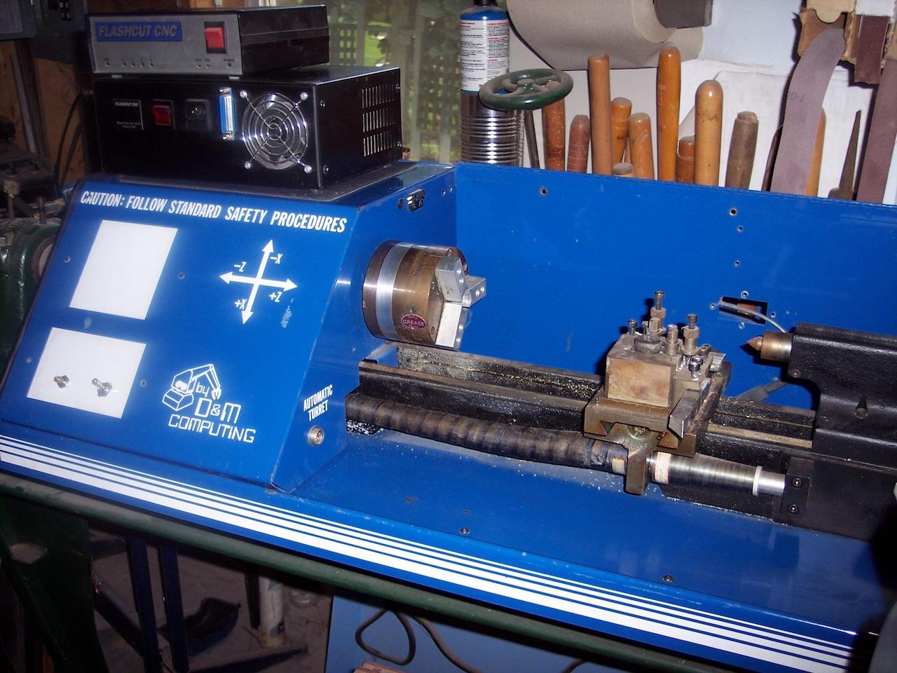

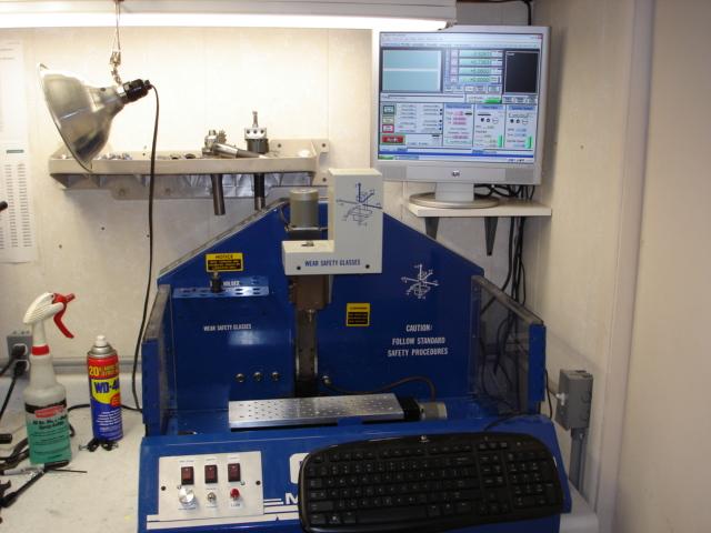

There are a few companies that make one even smaller, but for me they are too small.  This one has a 4" chuck,  6" swing and 10" in the Z axis.  The only option it doesn't have is a tail stock, but I only intend to turn small items so that shouldn't be a problem.
Here is a picture of a smaller machine made by D&M.  The seller has this one for sale too and it has been converted to flash drive.  It's a bit smaller than mine, but larger than a sherline lathe.  If any one is interested let me know and I can get more info for you.  It's located near Kenosha Wi.

« Reply #18 on: September 09, 2012, 02:49:54 PM »

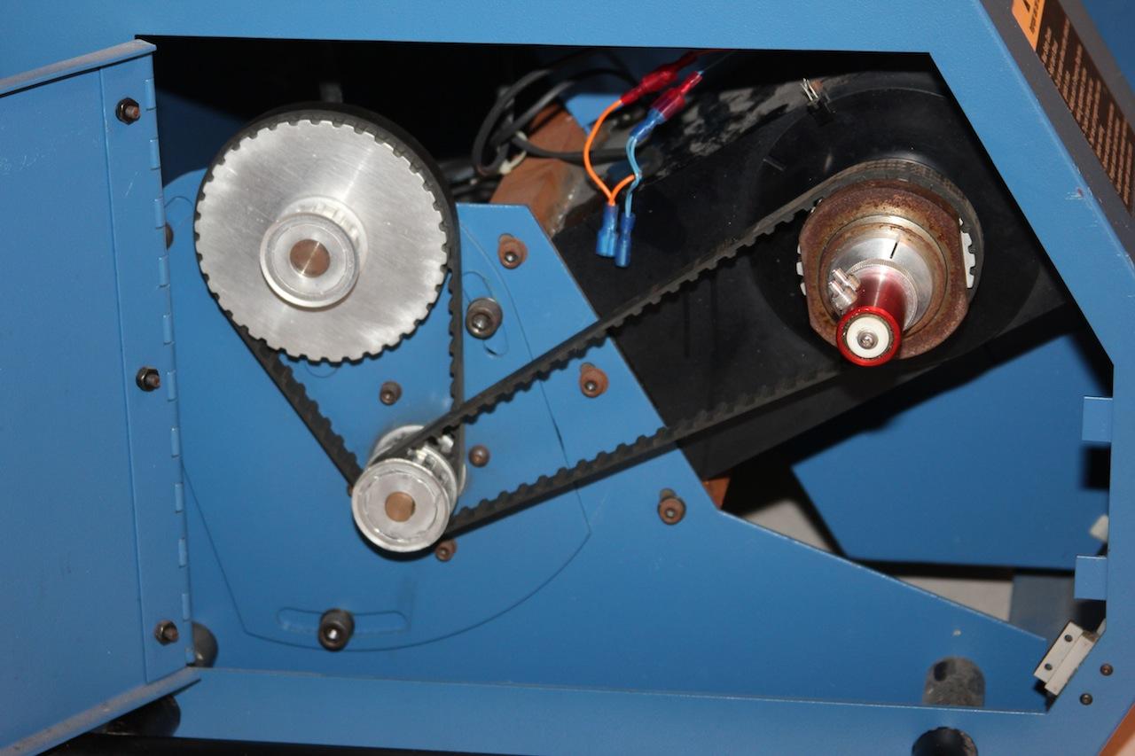

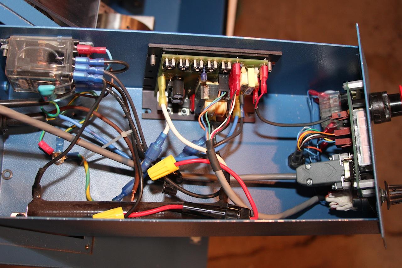

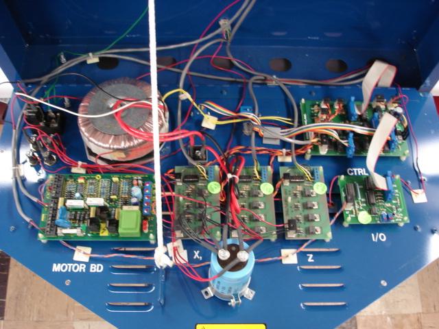

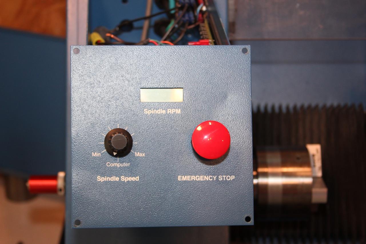

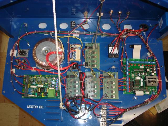

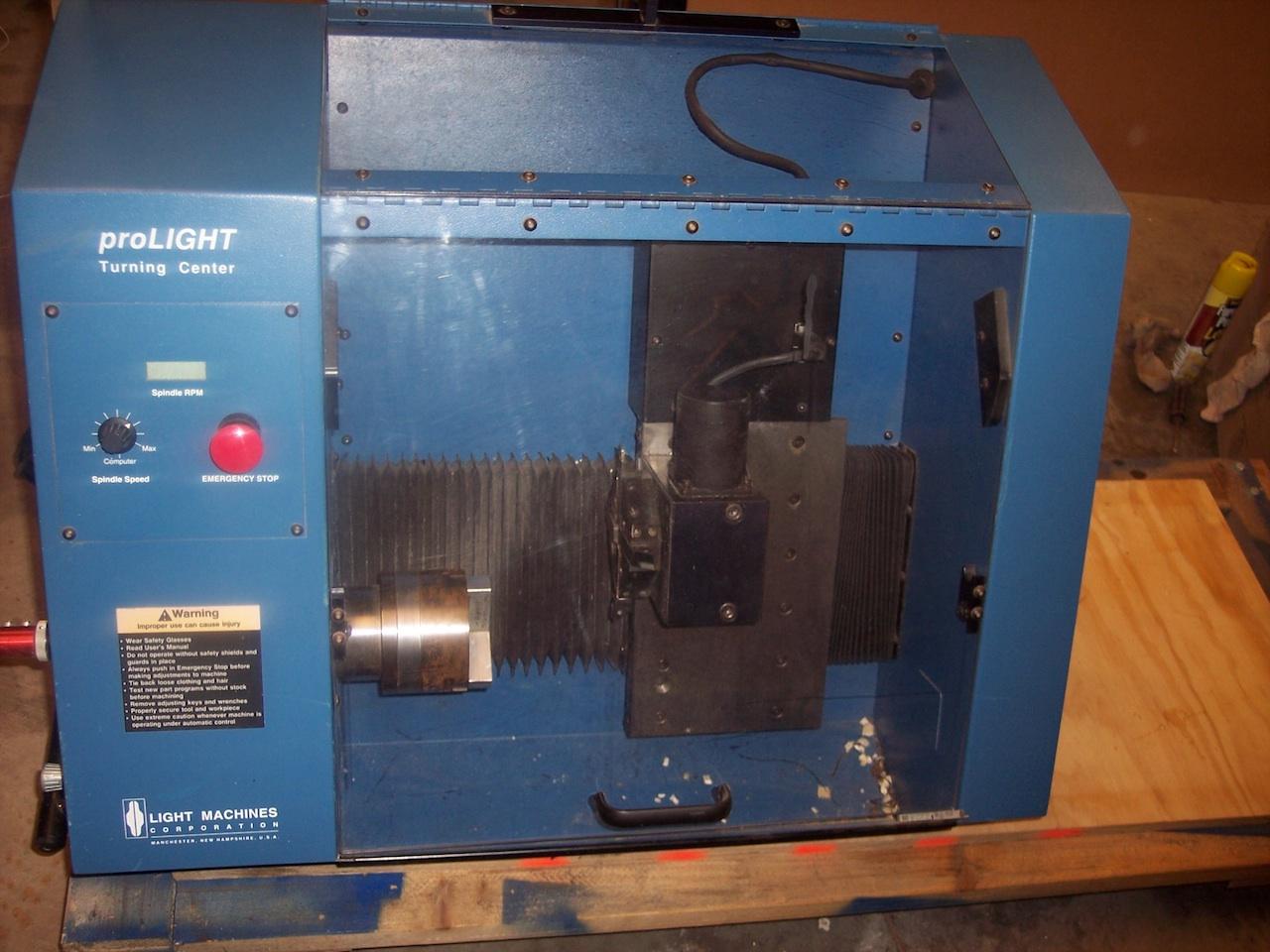

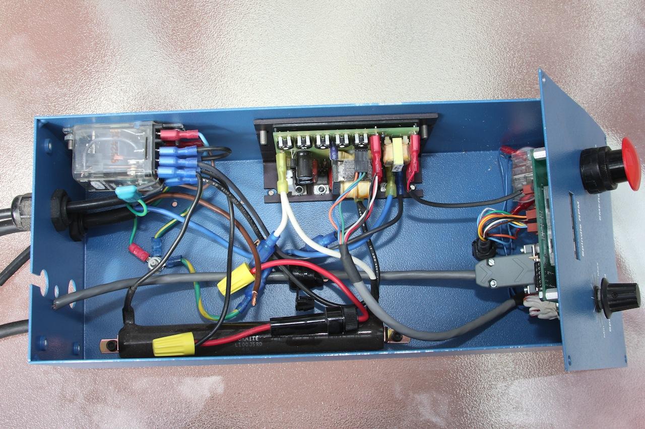

Well I got the machine home Friday and have spent some time taking it apart to see how it ticks. I have a pretty good idea on how I'm going to retrofit it to work with Mach 3, but figuring out the spindle speed control has been a challenge so far.
The spindle motor board has a manual input for a pot switch and also a 0 to 10 volt control for the computer.  The pot switch on the lathe has an On and Off switch connected to the back of the pot switch and will select the from computer control to manual control.  I'm pretty sure I can simply reuse this and hook it up to a breakout board with a output for a 0 to 10 volt VFD.  There is a LCD screen that displays the spindle RPM and the back of the board hooks up to the computer.  I think it needs the original software to make it work so I'm just going to remove it and throw it out.  RPM will be displayed on the monitor any way.
The trouble that I'm having with the speed control is that it's hooked up to a large resistor and relay and I'm not sure what they are there for.  I think it's to provide a slow start for the motor to prevent blowing fuses and damage to the speed control but I'm not positive.  If so I will simply reuse the circuit, the only trouble is the relays coil needs 28 volts to operate and my control box will not have a power supply that will work.  I could add a 24 volt supply, but then my breakout board would have to switch a 12 volt relay to turn on the 24 volt relay which seems kinda silly.  I could replace the relay, but I worry about finding one that will work as it has a ton of contacts that are all being used.  *Does anyone know if Mach 3 offers a spindle slow start when using the computer to control the spindle speed?  If so I could remove the slow start circuit and let Mach 3 do it.
Here are some pictures of the lathe.  Please let me know if you have any ideas on how I should hook up my spindle speed control to the breakout board.
Thanks Dale P.

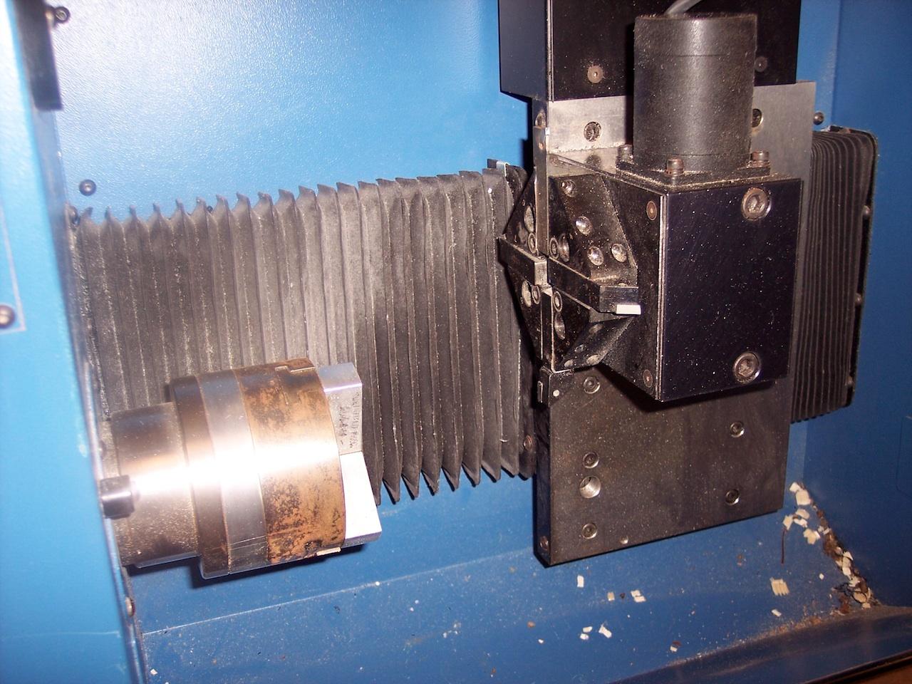

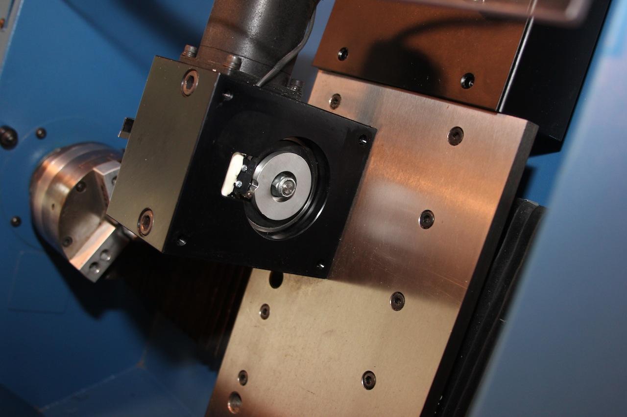

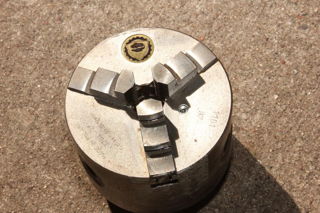

Here are some more pictures of the lathe.  As I suspected the tool changer has a micro switch so it knows when the tool is in position.  Hopefully this will be easy to interface with Mach 3.  The machine also has limit switches on all of the axises which will be nice to have.
The machine has a nice Baldor 1 hp motor for the spindle and an optical pickup on the spindle as well as an encoder.  I think it needed one to let the computer know the spindle speed and the second one was for the LCD screen on the front panel.  I'm not going to keep the LCD screen as I don't think it will work with out the original software so I can use ether pickup for the computer, I'm just not sure how to hook up the encoder to the breakout board so I probably will just use the optical pickup.
The lathe also has a pneumatic chuck and a 110vac solenoid so it can be opened and closed with the computer.  The plexiglass door also has a pneumatic cylinder and solenoid so the computer can open and close it too!  This will be easy to wire up to a breakout board and I will be able to operate them with a simple G code command.
The seller gave me a second chuck for the lathe that works with a standard key instead of the pneumatic chuck and to my surprise it was a Bison brand chuck!

Cripes, that puppy looks brand-new!  You lucky feller you.
I'm confused as to your ref to a vfd; isn't that a Baldor DC motor?  The board in the upper center of the electronics unit sure looks like a DC motor speed control.  If so it should have trim pots for accel, min/max speed, etc.  Seems strange they'd put that big honking resistor in the circuit.  Does it have a brand name on it?  Sure would be nice to get your hands on a manual and schematic for the machine.  It'd help a lot.
You're gonna have a great machine when you get it running! :beer:

Sorry I wrote that wrong, your right it's not a VFD, it's a DC motor and drive. It's a Minarik pcm21000a .  I found some good info on the web about the drive, but nothing showing the use of the resistor as it's hooked up.  Like I said, I'm pretty sure it's to provide a soft start for the motor but I have to take a better look at the circuit before I can be sure.  The old control box hooked up to the relay and must have used it to turn the spindle on and off, but it's a 28 volt relay so hooking it up will be hard unless I find a new 12 volt relay to take it's place.
Re: Bought a CNC lathe
« Reply #22 on: September 10, 2012, 03:25:25 AM »
.....The trouble that I'm having with the speed control is that it's hooked up to a large resistor and relay and I'm not sure what they are there for.   I think it's to provide a slow start for the motor to prevent blowing fuses and damage to the speed control but I'm not positive.  ......
Dale,
I wonder if that's actually a braking resistor?  Just cutting the power to a motor it will (a) freewheel to a halt, and (b) generate its own voltage. You can brake a motor by applying a dead short, but it can give a current surge - so maybe the resistor is across the motor when its stopped, and to give safer/expedited braking when you hit e-stop.  You really need to try & trace the circuit around that relay etc. to find out what the designer felt it needed.
Offline jiihoo

« Reply #23 on: September 10, 2012, 05:04:03 AM »
Hi,
Cute lathe!
If you have a hard time finding a suitable 12 volt relay that would be identical to your current 28 volt one, you can replace it with two. Just connect the coils of the two 12 volt relays in parallel and use it as one relay (after carefully tracing the original connections and making sure that the new ones are identical...) This way you can replace a hard-to-find relay with two easy-to-find ones if needed.

« Reply #24 on: September 10, 2012, 06:24:55 AM »
I bet your right about the braking resistor!  I will have to take some time this week and draw out the circuit and see how it works.
Looking at the instructions for the Minarik speed control I see it also offers some braking but I'm guessing it's not as good as using the large resistor.  So far it looks like they hooked up the E-stop to the braking feature on the Minarik board so there would be even more braking when pressed.
As for the original relay I'm going to start looking for a replacement since I can't think of an easy way to hook it up.  Most breakout boards offer a 12 volt source to power up relays and this one needs 24 to 28 volts to work.  Using two relays is a good thought too if I can't find the correct replacement.
