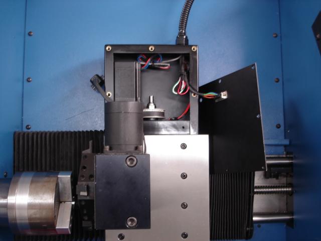

Phil,  I don't know what locks the turret at this time.  I'm guessing that there is a gear drive inside it which could make it impossible to move with out turning the stepper motor, but when I try to move it back and forth by hand there isn't any movement or backlash which makes me think that there must be some kind of lock.  I don't plan to take it apart any time soon, but if I do I will make sure to take lots of pictures for you.
There is a switch mounted inside to let the computer know when it's in position.  Hopefully Mach 3 will be able to work with this.

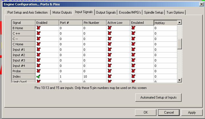

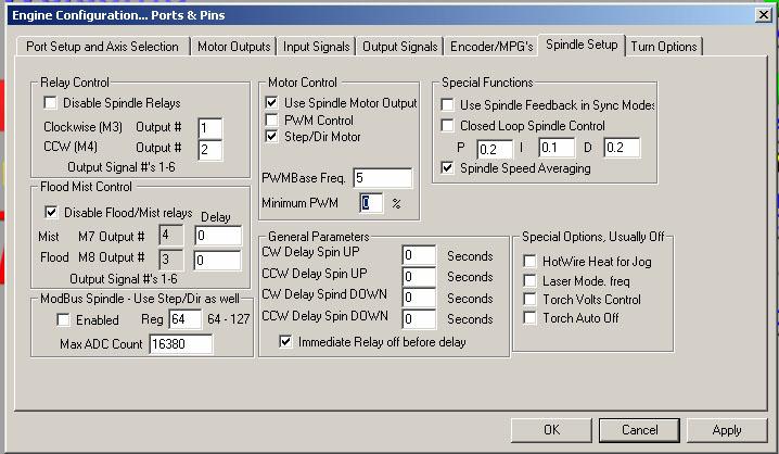

Update .... up and running. Having issue with indexing and low rpm accuracy with the HE sensor I installed (tried thinner and wider plate), rpm not consistent under 125 rpm and will not index. Ordered C3 board to see if it will correct issue.

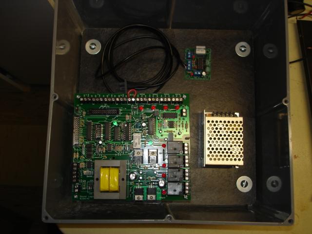

I just ordered a breakout board for my machine and also bought a C3 board for the spindle pickup.  The wires were broke off my lathes factory pickup so I figured that the C3 board would be the best way to replace it.
I ended up going all out on the breakout board and bought a Combo board from Sound Logic.
http://campbelldesigns.net/Combo-board.php
It was a little pricey, but has everything I need in one board so there will be less wiring in the end.  The Combo board has a built in spindle speed control, four relays, and three separate power supplies so all you have to do is power the board up with 110 VAC and it provides power for all of the circuits.  If I bought the C-11 board from CNC4PC I would have needed two 5 volt power supplies and one 12 volt supply.
Now I just need to figure out if I'm going to go with a toroid transformer or switching power supply for the stepper drives.

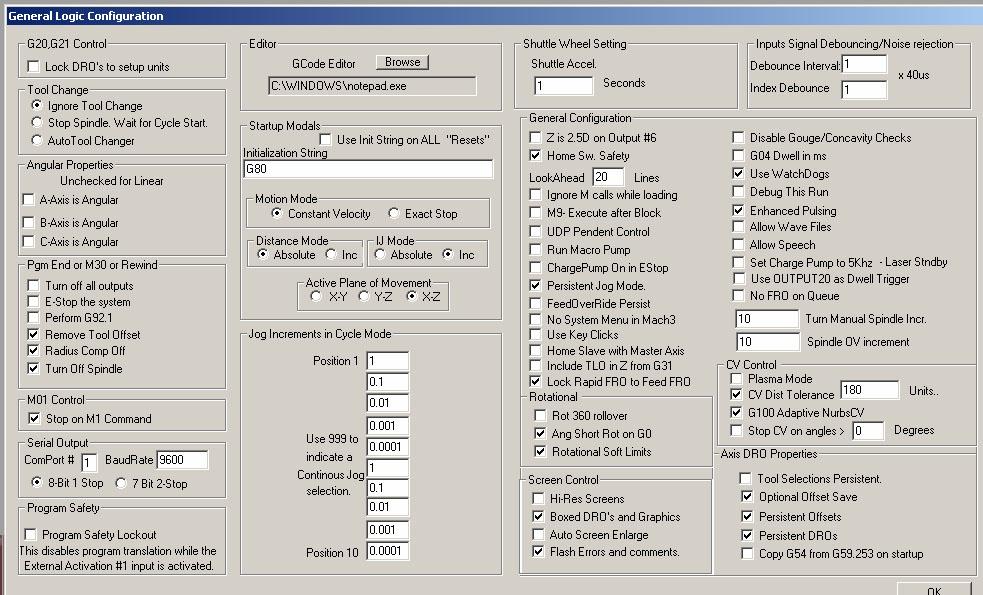

Dickeybird, can I ask what settings you are using in mach3 for indexing? With the HE sensor I was using the rpm reading was correct to the built in gauge and I could see index light in Mach while turning by hand  but at any speed  higher than hand speed light was not consistent (can you see the light in the diagnostic screen change with the spindle running), I ordered the cnc4pc c3 card thinking I had an issue with sensor and still have the same issue. Followed the instructions in Mach on the size of the slot and double checked everything still no good. Any advice would be appreciated. Thanks in advance Phil
Offline DICKEYBIRD
  • Posts: 229
  • Collierville, TN ya'll
Re: Bought a CNC lathe
« Reply #60 on: October 16, 2012, 10:52:09 PM »
Sorry, I just now saw your question and I'm about to collapse into the rack.  A long, long day.
I used the info that came with the C3 to size the hole in the disc instead of what Mach says and didn't have much trouble.  Are you trying to control the speed via Mach or just read rpm at this point?  Here's a few screen captures of my setup.  Hope this helps if not I hope to have more time tomorrow night.  My brain is gone.
edit: Seems like I had trouble with debounce...note the Gen screen debounce settings.
Good Luck!

Thanks, I'm having an issue getting indexing to work, in diagnostic screen if I turn the spindle by hand the index indicator light in Mach flashes as expected but at speed its not consistent. Running a thread code it will not start cutting the thread, spindle starts and both axis get to start position and stays there I think its waiting to get an index signal. Have you tried to do any threading? Phil
Offline DICKEYBIRD
  • Posts: 229
« Reply #62 on: October 17, 2012, 08:29:04 AM »

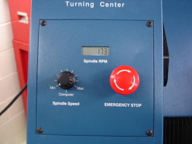

No, haven't done any threading yet but will need to fairly soon.  I still have to turn on the synch function.  I do have a dead accurate spindle RPM readout and can control the speed with M3/S word commands.
Does your spindle speed DRO indicate the correct RPM?
Milton in Tennesee
Offline cycletec
  • Posts: 16
« Reply #63 on: October 17, 2012, 02:29:31 PM »
Its close to the one built in from 75 rpm up and I can control with the s word command. I would think if the rpms are correct index should work. I dont understand why when looking at the diagnostics screen I cant see a flashing index light when spindle is running it flashes randomly.

Seems like I read somewhere that the flashing light might not be a reliable indicator due to screen refresh issues??  It also might be an issue with Mach Turn as I've heard it has a few problems in several areas; especially in threading & constant velocity.  Might be worth asking over on the Mach forum; there are some smart people there.  I spend a lot of time ther asking ignant questions and they haven't thrown me out yet!

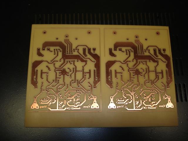

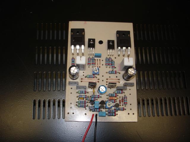

Well,  I got stuck working on some other projects.  I have a 15 year old nephew that is building his own speakers and wanted to know what he should use for an amplifier.  I said if you going to build the speakers why not build the amp too!  So we made up our own PCB board for a 125 watt amp at 8ohms and are in the process of soldering it all up.  The amp design is a NMOS 200 and can be seen here.
https://sites.google.com/site/quasisdiyaudiosite/nmos-series/nmos200-1
Here are some pictures of the PCB board that we made.  After etching the board you have to drill and de burr all of the holes!
Along with the pictures is a mono amp that we made and have 90% soldered up, and are waiting for a shipment of parts to complete the board.

You didn't build a backyard power station to power up the amp?  Kids just don't know how to do stuff these days! :D
Seriously, that's some great work you're doing and passing your skills on to your nephew as well.  Awesome! :beer:

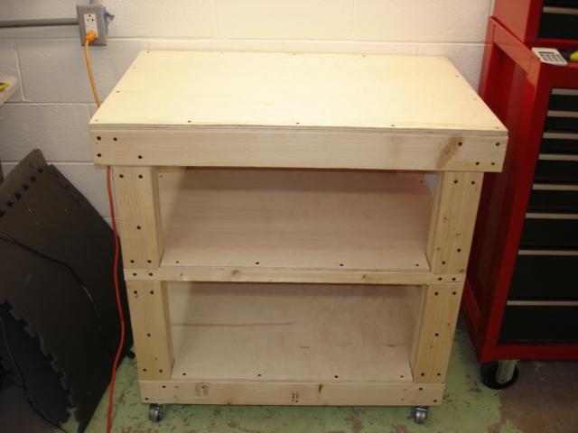

Ok, This weekend I built a stand for the lathe and am going to bring it into the basement tomorrow so I can start working on it again as it's too cold in the garage.
I ended up going all out and ordered two new stepper motors with 280oz of torque to replace the 150oz Z and X axis motors. I also bought three LeadShine DM856 digital stepper drives.  The drives will handle 70 volts and 5.6 amps and claim to run smoother, cooler, and quieter than analog drives so hopefully the extra cost for them pays off.
What I really need now is a computer and software.  I may just pick up an old Pentium 4 off Craig's list for $50.00 and run the Mach 3 demo until I can raise some more funds to purchase the software.
I should have some pictures posted by the weekend of the progress.

Here is the quick stand I put together for the Lathe.  It in on wheels so I can move it around as my shop is really small right now.  Some day I will paint it and put some doors on it, but for now it will do just fine as a bench to hold the lathe.
Fedex left me a note saying that they tried to make a delivery today, which means my stepper drives have come!!!  Looks like I will have them by tomorrow.
Dale P.

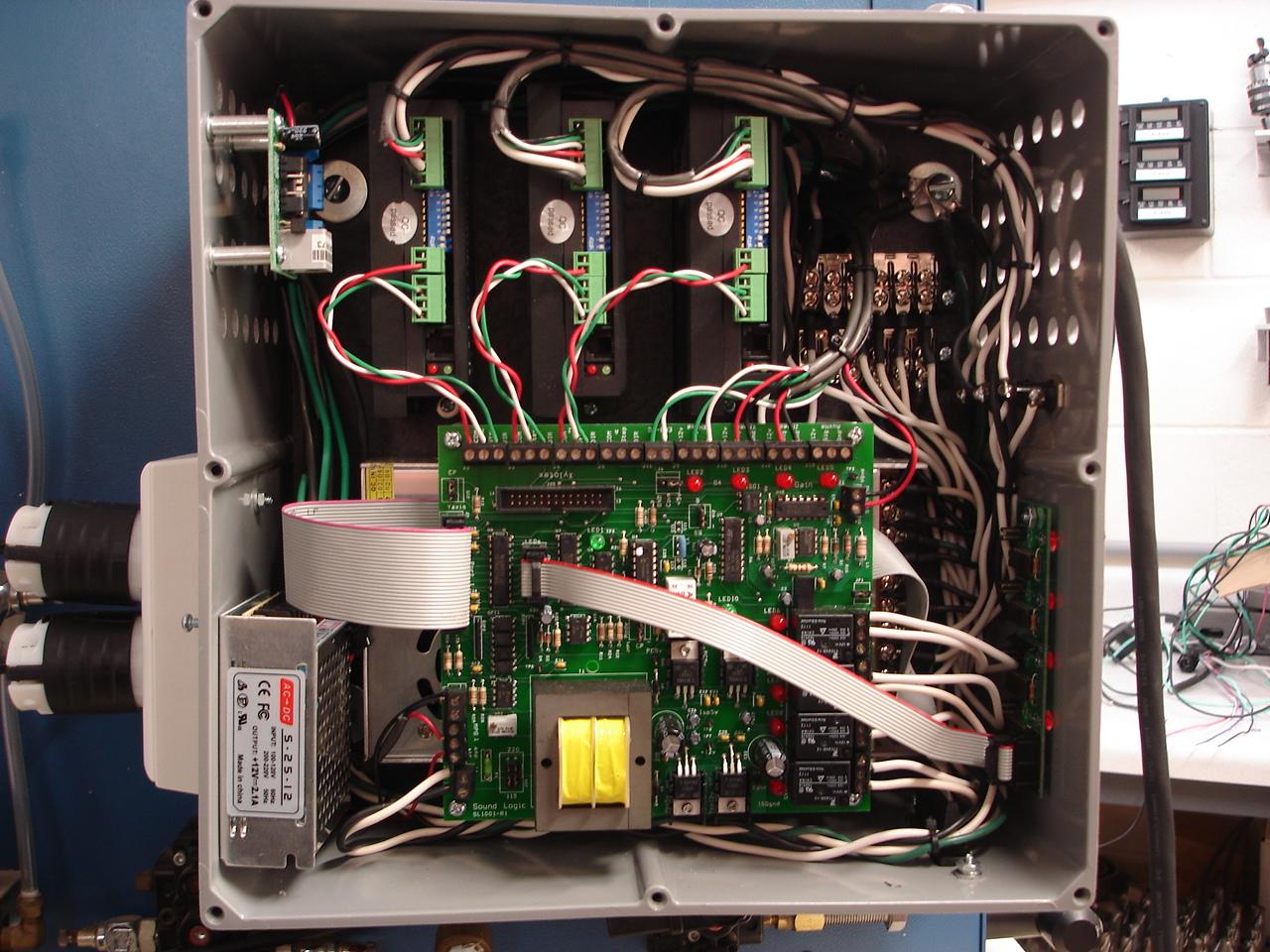

Ok, so I'm 99% there!  I just need a computer to run Mach 3 as I run a Mac in the home office.  I should have a PC by Sunday and have the lathe fired up!
Wiring is all done.  I built an entire control box, replaced the Z and X stepper motors, and rewired all of the limit switches.  Here are some pictures of the finished control box.

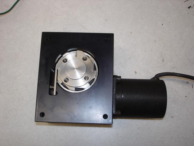

The last picture shows the locking mech on the tool changer.  I watched a Youtube video and see that the tool rotates past the location it needs to be and then turns backwards to lock the tool in place.  Reading the instructions for Mach 3 I just learned that they don't have a provision for a tool changer, just offsets for different tools.  For now I will have to turn the turret by setting up hot keys on the key board and just jog the stepper motor manually.
Let me know if you have any questions,
Dale P.
Offline DICKEYBIRD

Do some searching on the Mach support forum.  You'll find several threads where toolchangers were set up & working well from within Mach.  It requires clever programming of macros (I think that's what they're called) by folk that understand programming & such.  (Not me!)
I remember seeing a couple threads where people asked about doing exactly what you're trying to do.  They were given some code and were able to get their's working.

I will have to take a look into Macros and see what it takes to program the turret.  For now it should be easy enough to jog it into position with a hot key on the keyboard.
