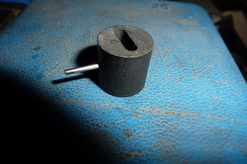

Well....... I managed a workshop hour, this afternoon.
Pity it wasn't more productive.........  :palm:
I was trying to emulate the original piston, only longer........
Guess I'll have to make a clevis, down inside the skirt. Held in with an M3 screw from 'tother end.
This stirring stick graphite is a lot coarser than I imagined it would be!  :scratch:

Re: Maiwald Makeover.......
« Reply #40 on: October 16, 2012, 12:43:13 PM »
Thanks Nick.
So, I made one........
It reminded me of compressed, dried leafmold.......
Couldn't polish it to round. It went all shapes, like a piece of grainy softwood.  :scratch:
And, the engine would only run, when persuaded with a small blowlamp.  :bang:
Think I'll make a brass piston, if I can get the time, tomorrow.  :thumbup:

Nightmare!  :doh: Well at least you've tried it, looks like I got lucky with the piece that was donated, it was much finer, more like the stuff you seen on motor brushes.
Looks like brass might be the way forward for you then, I just struggle with the whole lapping / getting a perfect fit thing though!
Nick
