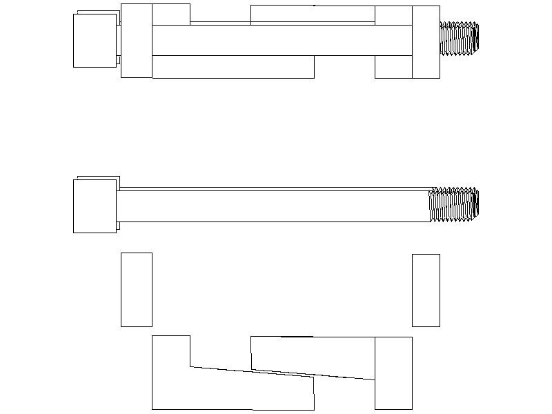

Thanks Dave,

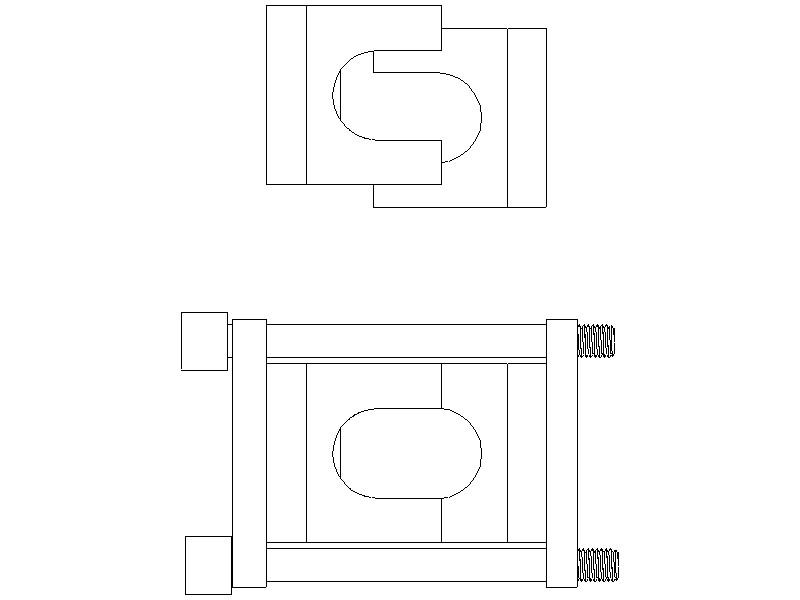

would you be so kind and draw this on profile wiev I want to make sure that I understan it truly... I would like to try this.
kind regards,
unal
kind regards,
unal
Dave H (the other one)
I think this question is for you.
I think Unal is looking for a view to show how the two wedges are forced together.
DaveH

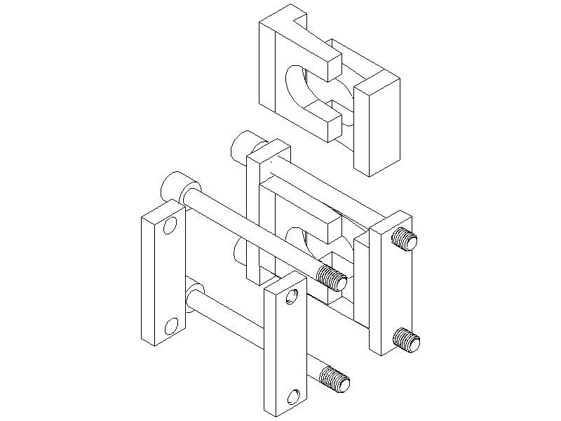

Offline hopefuldave
  • Posts: 189
Re: Stuck Collet Chuck Arbor
« Reply #78 on: March 25, 2012, 08:10:24 AM »
OK Unal, hope these explain OK - the wedges are forced together by nuts and bolts through the bars either end, these are left "floating" as the wedges will move "up and down" as they're tightened - you could leave the bars out, but then you'd need to elongate the back part of the wedge and put slots through it.
Excuse my CAD drawing, knocked up over a cup of coffee before I woke up!
You may need to make additional split collars to take up any gap between the wedge and the spindle, unless you're very lucky first time! As you have a milling chuck in the spindle (and don't you just know it!) you should find these fairly easy to make :)
SO... in use, put the two wedges around the chuck's arbor (taper), bars at each side, bolts through and tighten away! I'd use large bolts, perhaps M12 or M16 to get plenty of force on the wedges...
Hope this works for you, worked well for me!
Dave H. (the other one)
« Last Edit: March 25, 2012, 10:11:51 AM by hopefuldave »
Offline hopefuldave
  • Posts: 189
« Reply #79 on: March 25, 2012, 08:29:32 AM »
One More Thing...
Put a piece of wood or something on the mill table, if/when it drops out there'll be a chuck and wedges etc. falling on it!
Offline hopefuldave
  • Posts: 189
« Reply #80 on: March 25, 2012, 10:37:57 AM »
And yet another thing...
lubricate the bolt threads, and go up  to about 65nM torque (50Ft/Lb) evenly, alternating tightening the two bolts - this should give around 75% of the safe load for a high-tensile 12mm x 1.75 bolt and nut, and about er... (gets the calculator out) 6 tonnes of tension, so with the wedge ratio of 1/tan 5degrees and allowing a 50% loss for friction, around 30 Tonnes of force between the spindle and the chuck taper - if that doesn't do it, time for a new  spindle!
Offline ukazak
  • Posts: 55
« Reply #81 on: March 25, 2012, 06:54:46 PM »
Thanks a lot Dave,
Drawings are great, It is clear now, I will apply this and appreciated very much.

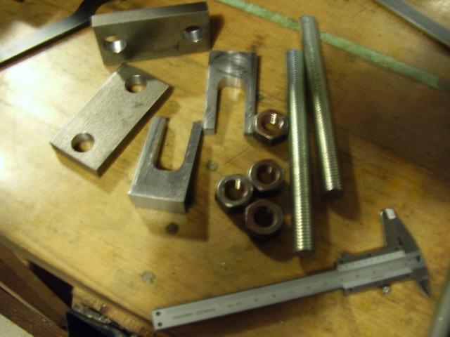

« Reply #82 on: March 26, 2012, 06:37:04 PM »

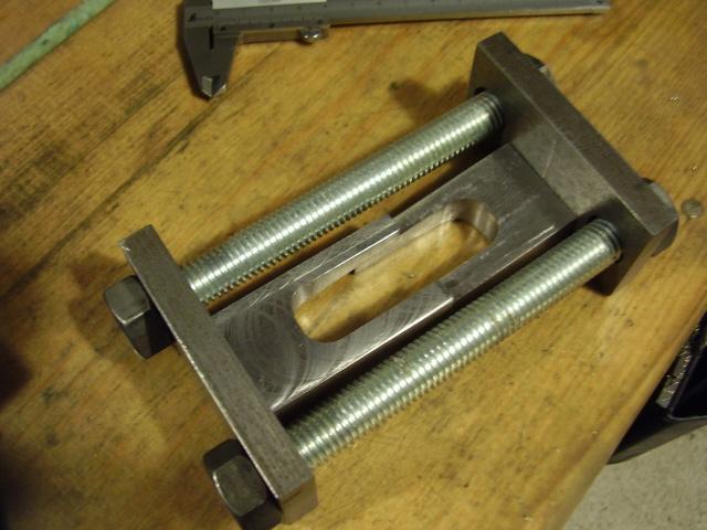

Thanks Dave,
I couldnt do much today, but made the parts... rig is ready, tomorrow I will tighten the nuts... lets see what hapens..

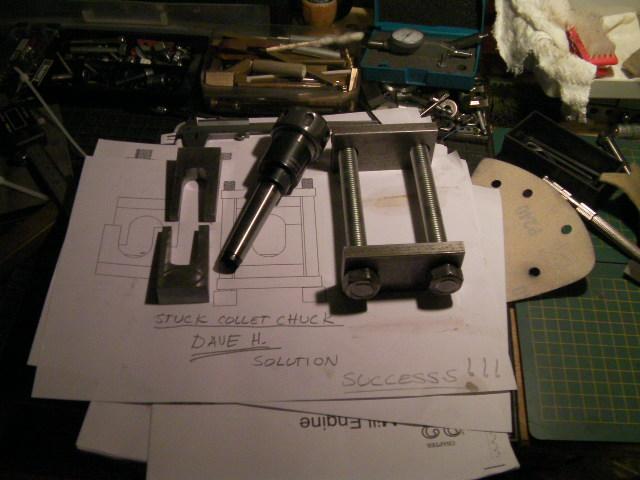

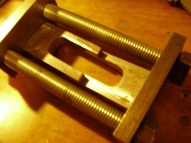

Offline ukazak
  • Posts: 55
« Reply #83 on: March 26, 2012, 06:38:30 PM »
The rig
Offline hopefuldave
  • Posts: 189
« Reply #84 on: March 26, 2012, 06:43:20 PM »
Very nicely executed, Unal!
They look better than mine, I have to say... But the big question is - did it work?
Offline ukazak
  • Posts: 55
« Reply #85 on: March 26, 2012, 06:47:44 PM »
Thanks.. it set great on the chuck, I even put some grease on it... Havent tried yet. tomorrow is the big day! (I didnt have proper M16 wrenches..)

Offline ukazak
  • Posts: 55
« Reply #91 on: March 27, 2012, 02:16:05 PM »
Gentleman,
I thank you all, every and each one of you, for your valuable times and efforts to unsolved this problem…  they are not wasted.
Special thanks to DAVE H. his solution worked like, spreading butter on your bread. Smooth and easy! Much appriciated!
Required some force but, no banging, no whacking needed. It made a “FLOPP!” voice and fall, (Thanks for the “warning” to cover the mills table with a flat MDF board.)
I think this solution would be recorded to the machinists’ literature.

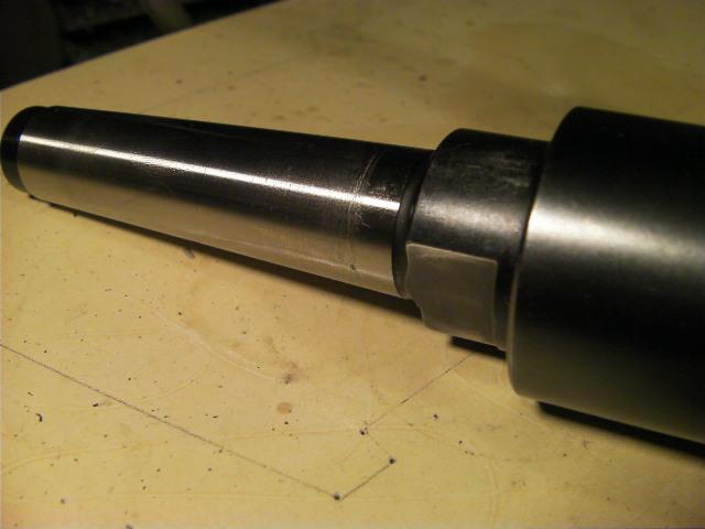

Offline ukazak
  • Posts: 55
« Reply #92 on: March 27, 2012, 02:19:29 PM »
 :clap: :clap: :clap: :clap: :clap: :clap: :clap:
not much could be seen, dirt or rust or swarf... none was there..????
just a little scratch..

No problem - I knew it worked for me, glad it worked for Unal!
I wish *mine* was as nicely made, though - I was in a hurry, needed to stick a 38mm drill through a casting and couldn't fit it in the drill! Three engineers before me hadn't managed it in ten years, took me a spare half-hour the first week on the job... Ho hum.
Just noticed the CAD drawing's a bit poor - one of the wedges looks hollow... I'll have to correct that!

Well done Unal :thumbup: :thumbup: :thumbup: :thumbup: :thumbup:
You made a great job of the "splitter" at least no damage to machine or chuck
