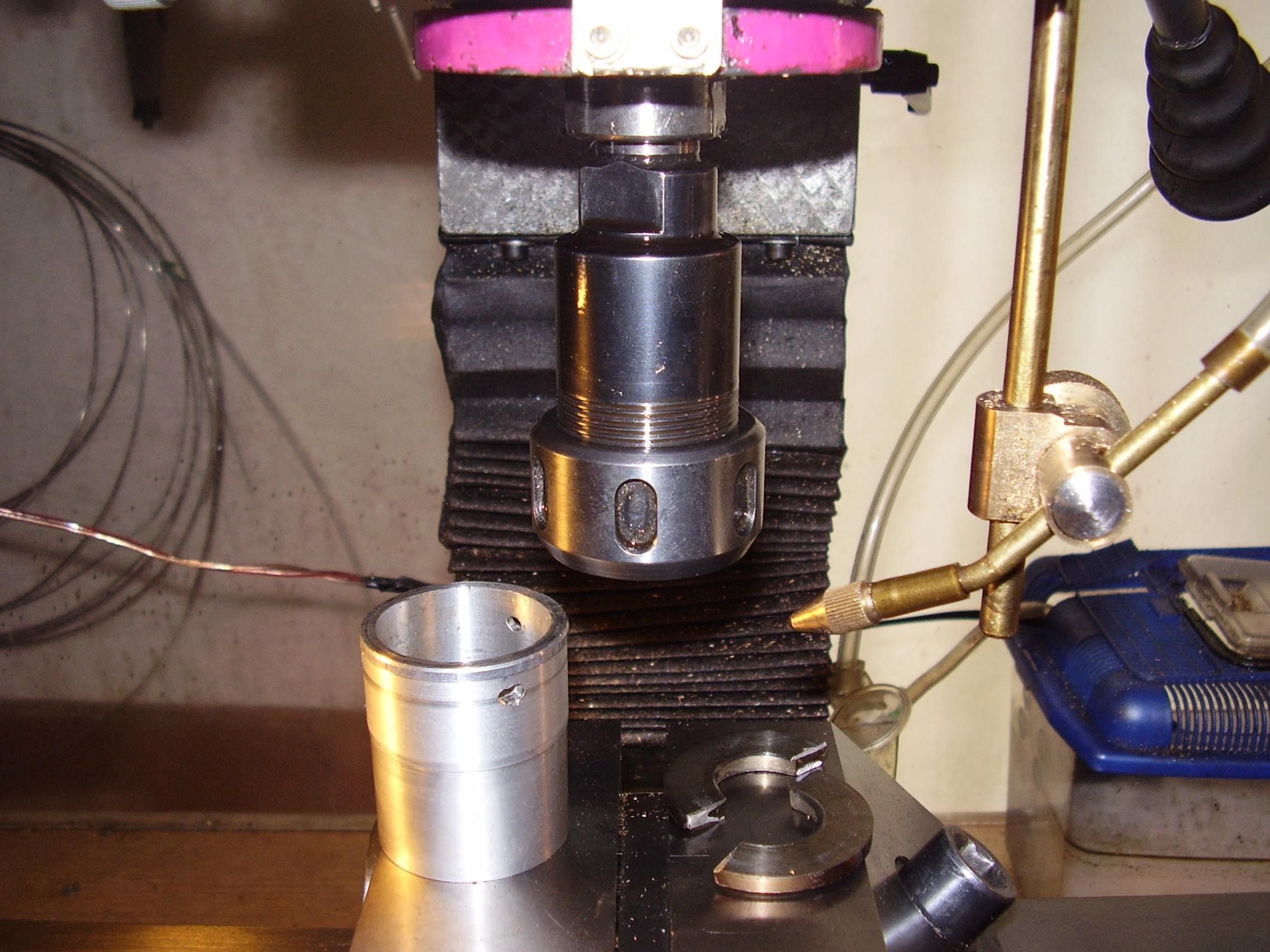

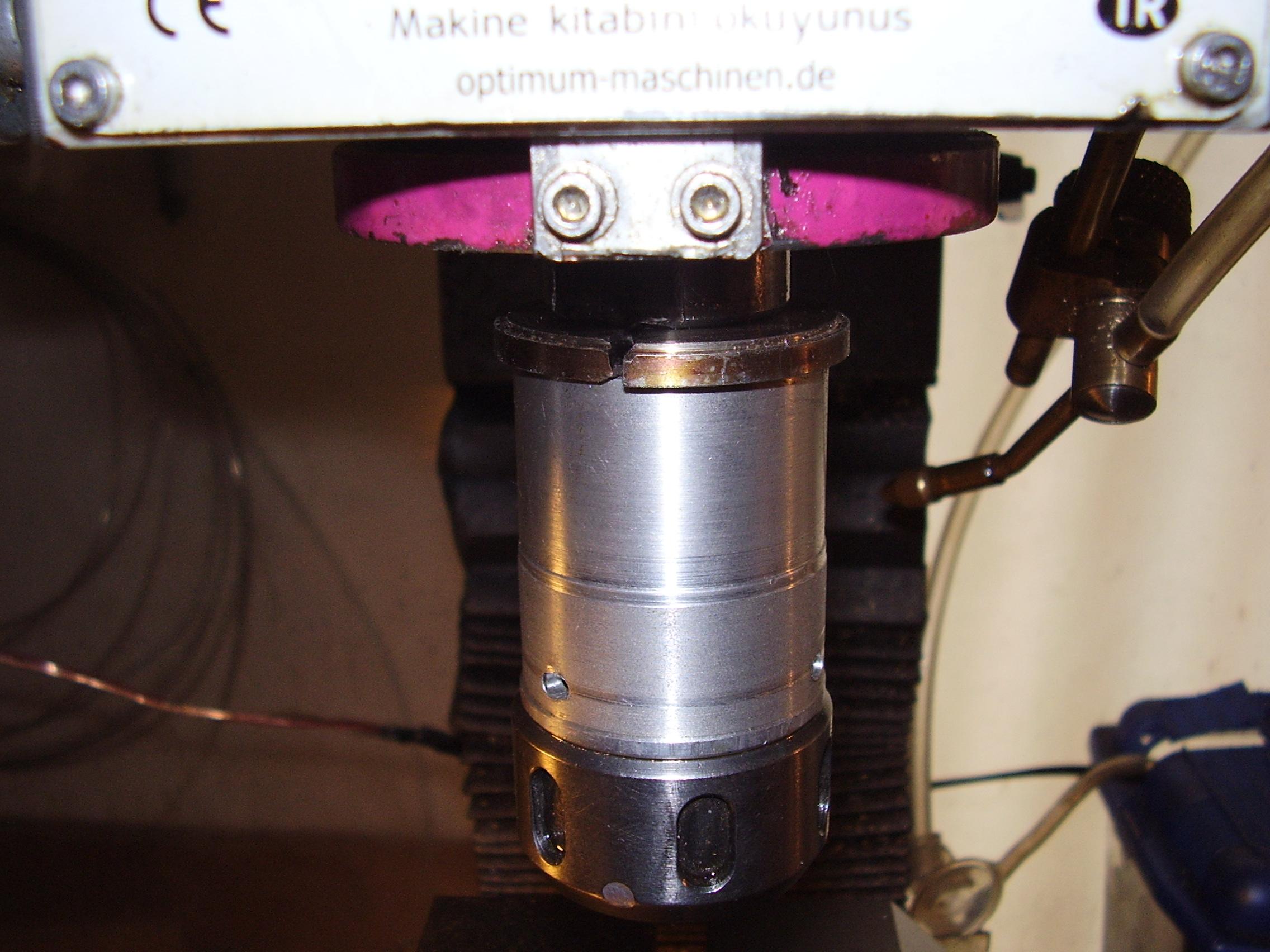

Ukazak,
I forgot to mention to grease the threads, washer and sleeve to convert more of your turning effort into trying to extract the taper.
I think someone has mentioned trying to rapidly cool the internal taper. I have some freezing spray for fault finding in electronics but you can also get freezing sprays for plumbing. I think you'd have to put as much tension as possible with the nut and then quickly cool the chuck.
I've found the opposite works on a stuck crank on a bike - tighten up the extractor as much as you dare (the threads are quite fine and only into aluminium) and then pour a kettle of boiling water over the crank. It may be difficult to get enough heat into the spindle quickly enough without damaging anything and cooling the chuck may possibly work better.
Good Luck.
Thanks to all,
Phil,
I noticed today, that the washer I turned and splitted is not properly functioning. little slop between the sleeve and washer is slightly tipping one side, so, it doesnt equally receive presure spread to entire diameter  from the sleeve. so, only the half of power we apply is transfered to spindle. I will try another washer with wider outer diameter. logic say this has to work.
Note; threats on the chucks nut have showen no signs of any damage at all...
I may also extend the lenght of the arm of the wrench with a pipe or so for more power.. no?

« Reply #41 on: March 22, 2012, 05:11:08 PM »
here
, one of them

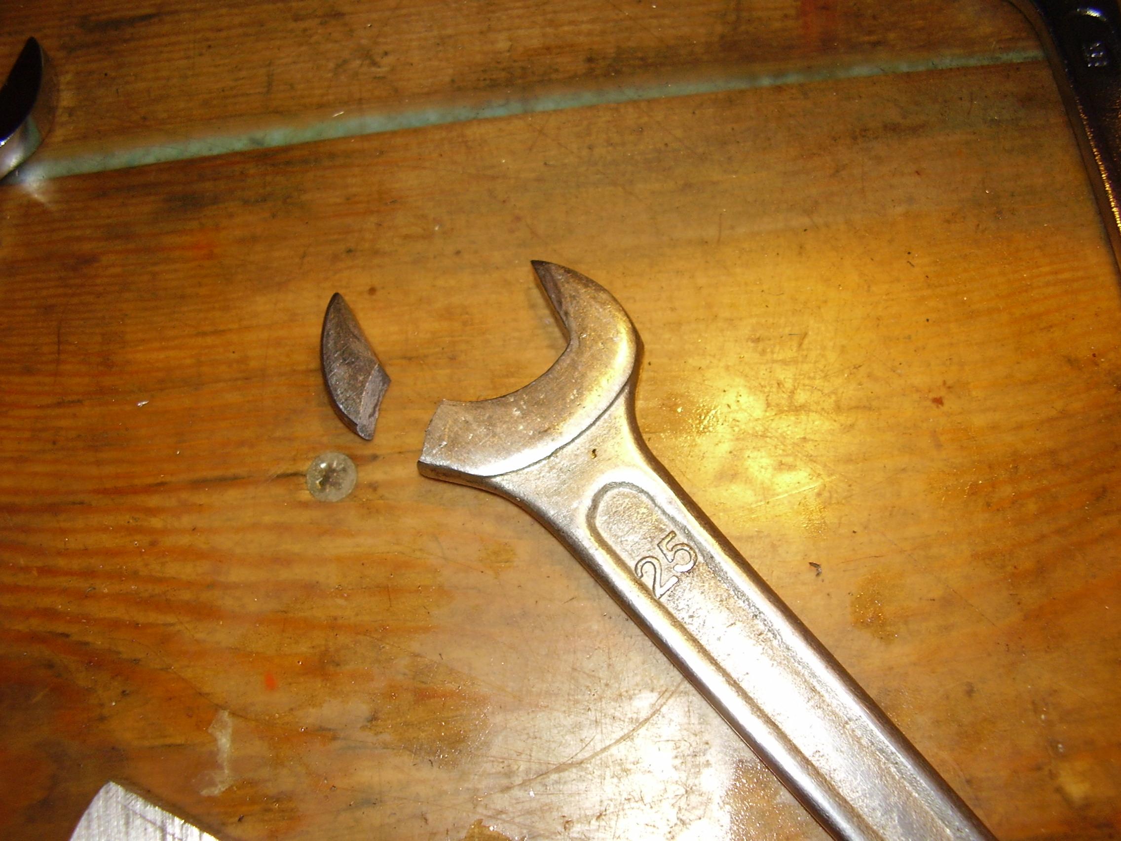

here what happened

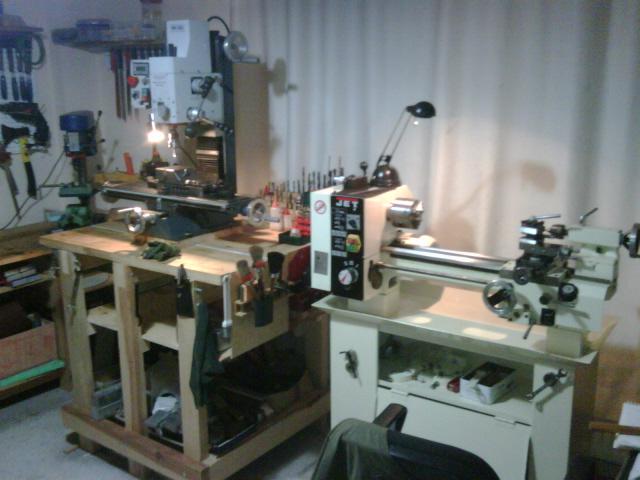

I am the one and "only" amongs 80Million who has the interested in model machining. we dont have clubs or sociaeties or any groups in this country to associate at all. I dont even have anybody to share or show or discuss..  I have been considered as a "fool" to be occupied with such things... may be, they are right!

Just a thought ,,, have you tried putting  a length of bar/lump of timber   between the quill  and the table ,, then giving the draw bar a GOOD WHACK with the hammer .

my small workshop

Re: Stuck Collet Chuck Arbor
« Reply #48 on: March 22, 2012, 05:38:53 PM »
Ukazak,
Everthing is fine - you are not the problem, you are doing OK.
A couple of the members who posted just need to show a bit more patience and understanding, and stop behaving like smart'ies, yes you two, for goodness sake give the guy a chance.
DaveH
Offline DaveH
  • Posts: 1413
  • Country: za
  • Kempton Park, South Africa
« Reply #49 on: March 22, 2012, 05:44:57 PM »
Ukazak,
You have a nice workshop there,  I could perhaps come over and offer a hand or two.
Is there any where I can park my jumbo  :lol: :lol: :lol: :lol:
