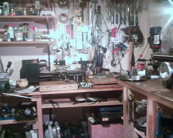

 :clap: :clap: :clap: :clap: looks like your well set up  :dremel:
Rob :)

Ukazak
That is a nice shop you have :thumbup:

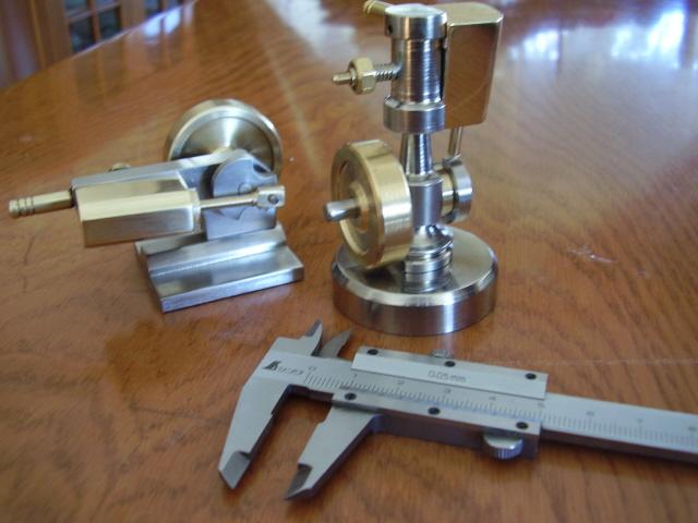

Mr Wilson, here are the two engines I made, pictures you ask.. just dont anybody laugh! in one day, I can only take so much!
Re: Stuck Collet Chuck Arbor
« Reply #56 on: March 22, 2012, 06:54:58 PM »
Ukazak
Nothing to laugh about there :clap:  :clap:
Did you work from plans or just build them
Nice to see you using a non digital vernier (lots of people can not read one)

 :clap: :clap: :clap: :clap: :clap: Two mighty fine looking engines you have built there Ukazak  :thumbup:
I built Elmer's Fancy a few years back  :dremel:

Ukazak,
Well a couple of very nice engines and very well made as well  :thumbup: :clap:

« Reply #59 on: March 22, 2012, 08:31:07 PM »
Thank you,
Those are my first and second, I work them from plans. It was all in inches which I am not custom to, but I converted them to metrics by help of calculator.
When I get enough confidence, I like one of those, horizantal Mill or Factory engines to make, but I gather, they are more complicated, valfs and all. I started to study the plans and converting to metrics.

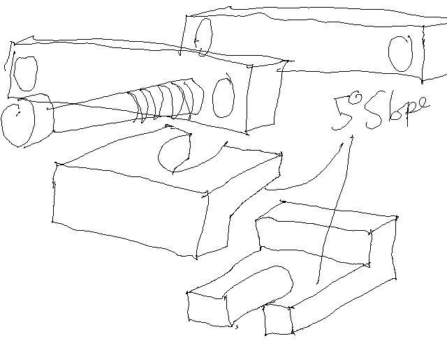

Unal.
I have been only occasionally dropping in, following your problem.....
Some while ago, I had the same problem with my mill. Here is a sketch I made at the time.
http://i110.photobucket.com/albums/n95/Dayjo/p3110001-1.jpgStuck Collet Chuck Arbor
The impact forces are taken by the machine table, not the bearings.
One good clout was all it needed!  :thumbup:

« Reply #65 on: March 23, 2012, 07:11:45 AM »
Thanks, David,
Won’t you think that would have negative impact on spindle housing?
Believe me, one of the firs things that already I tried with two big wooden blokes was that. And, because I couldn’t bear to look at it, a 130Kilo “knowing all pro”, had the one sharp WHACK! with a large blacksmith hammer... Nothing..!, it just doesn’t  budge.
Tried all the chemicals.. it doesn’t enter between the arbor and the spindle to get it loose.
This is why, this weekend I am thinking to take it to pres shop.
And I will inform all.
