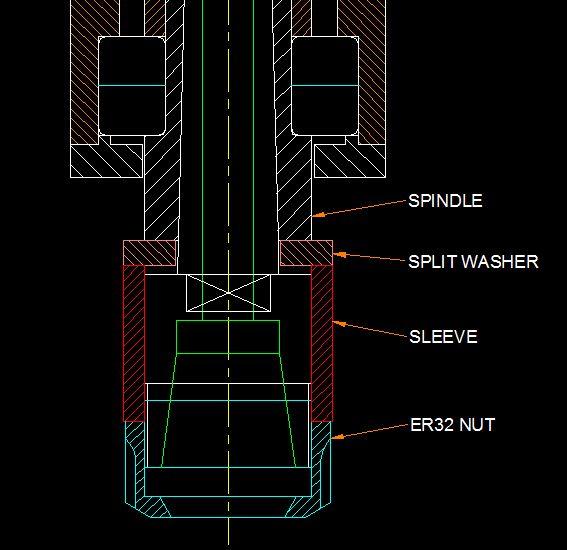

Hi Guys,
I am all new, to machining and to this site. I made a "grave" mistake, that "I know now" . Couple of years back I bought my mill (MFL 20) and just pluged in and start playing. All went fine other than couple of times stripped gears and changed.. everything was smooth and nice, up until I decided to change collet chuck...! it refused to come off... Yes, I tried to hit the drawbar as hard as my heart would alowe and oiled, WD40'd and evry trick I heard.. but, arbor is stuck.. No, it wont come off... I am doomed live with this stuck collet chuck arbor.
I didnt have any need to change for mandrane or any other reason to move it than.. or now really.. but it just bothers me, I should have removed the thing and get the rust and dust, all cleaned up when I receive the machine before I use I guess...
Well, what now? anybody has any ideas.. I can take the headstock down and apart it but, it would it be any use at all? what shall I do..? can anybody help me on this?

Is it possible to use the ER32 chuck nut to pull the chuck out?
To try you would probably need to machine a sleeve which would slide over the chuck and then a thick (say 6mm) split washer on top fitting between the sleeve and the end of the spindle.
The significant force generated wouldn't be seen by the bearings at all.
Cheers.
Thank you for all of you guys, as I was lookin around in the net, and found out that, this is no easy thinking to tacle and still unsolved problem yet, I am not the only one got the stuck arbor  the problem. so far Phil's idea  of a sleeve and collet nut and combination of some warming might put the end of this globaly suffered dilema. There was even one suggestion that, thake out the drawbar completely and lean the chuck against the side of mill's vice and give slow power  turn a while..
The chucks diameter is 33 and height to spindle rim is 72mm. I think it will work but, I hope I got enough power to tighten the nut. Is there any danger of stripping the threts of the chuck or the nut to cause jamming?

Sorry Jonny - I beg to differ with you.
I am talking about pulling down on the chuck by pushing the collet nut against the nose of the spindle itself - not the spindle housing!
Also - the chances of stripping any threads are very slim. I tighten up my ER32 collets with a lot of torque applied with 2 big spanners - and my ER32 threads aren't hardened.
Re: Stuck Collet Chuck Arbor
« Reply #15 on: March 09, 2012, 04:08:40 PM »
Jonny,
See the attached drawing which perhaps explains my proposed method better than words.
Cheers.
« Reply #16 on: March 09, 2012, 05:10:03 PM »
How about putting it into tension like above illustration shows and spraying inside of the collet chuck with cold spray. On that sort of situation combination of static pull and thermo shock has opened up stuff. Another thing that has helped me a lot is to open drawbar just a little before giving it whack to it. I think that there must be pretty many thread to transmit the blow. Same thing on steering joint tappers on auto.

I tried today,
Turned a close fitting sleeve and washer. it turned a few lines of thread, than came to a point that looked like trying to unscrewing a welded bolt.. wouldnt turn more. maybe I have to try to apply more power to it with a friends help.
one thing is for sure, one can easily depend his life on it. I did not put the chuck in there, it came on with the machine. it may have set a couple of years before it was sold to me, and I used couple of years and not removed once. So, it may be frozen until the death apart. There are no bending or twisting evidence on it, for it is spinning really  like you wouldnt know it was spinning, if if you didnt hear the machine running. if there was a twist it would wobble a bit..
may be they had placed the chuck right after test run (while machine and spşndle hot) snd there was a piece or two dust in it.. than sit there for couple of years and get rusted..
Tomorrow I will try again with doubled force to give turn or two more... if not, I may be to take down the head and get the spindle out to take it to a press shop.. hpefully, we get it out without bending the spindle or demage it someway..

I forgot to mention to grease the threads, washer and sleeve to convert more of your turning effort into trying to extract the taper.

Thanks Phil for the sketch, that will do the job no stress on bearings, with you now.
