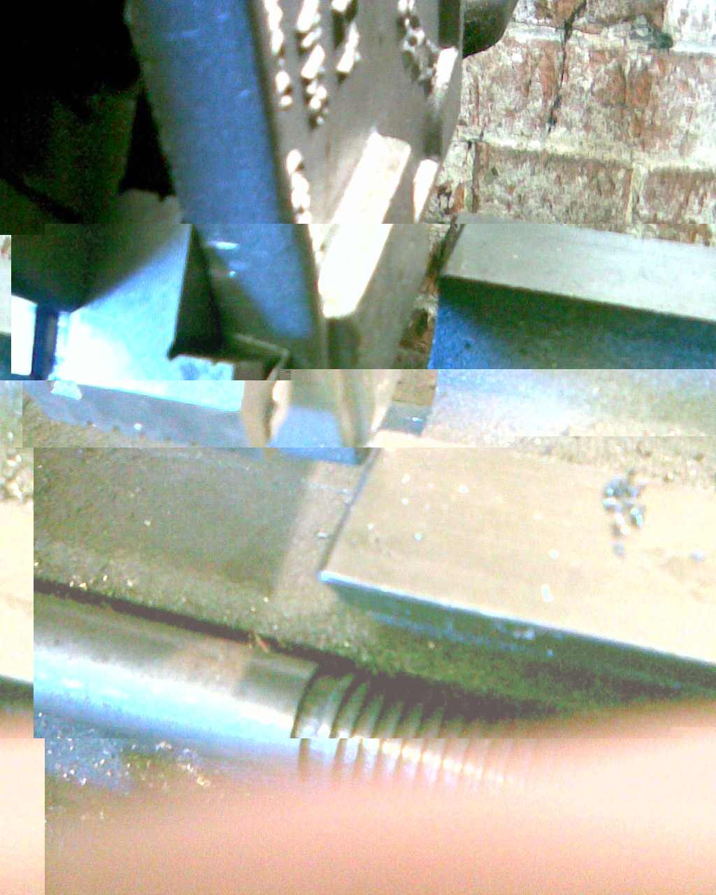

Followed his set up for machining the base...oops! :scratch:
Hmmm, spent a good few hours trying all different ways to get over the machining.
Could not mount it on the vertical slide for flycutting :bang: :bang:
Eventually, I ended up following his example, but spent ages trying to make sure it all turned. :scratch:
Had to file the corner of the flywheel bracket so that it did not catch the ways, that was to make sure that the other end cleared the bed.  :clap:
I had 30thou clearance! If you look carefully you can just see light between the casting and the end of the ways! :clap: :ddb:
Not good at taking pictures, so I didn't bother showing the finished base. Gone to filing the legs because time is getting short tonight.

Wow... that's some clearance :)
Good job on the setup. Keep the build log going :)

That's loads of clearance. I've done stuff with much less than that - and got the tool marks to prove it!  :lol:

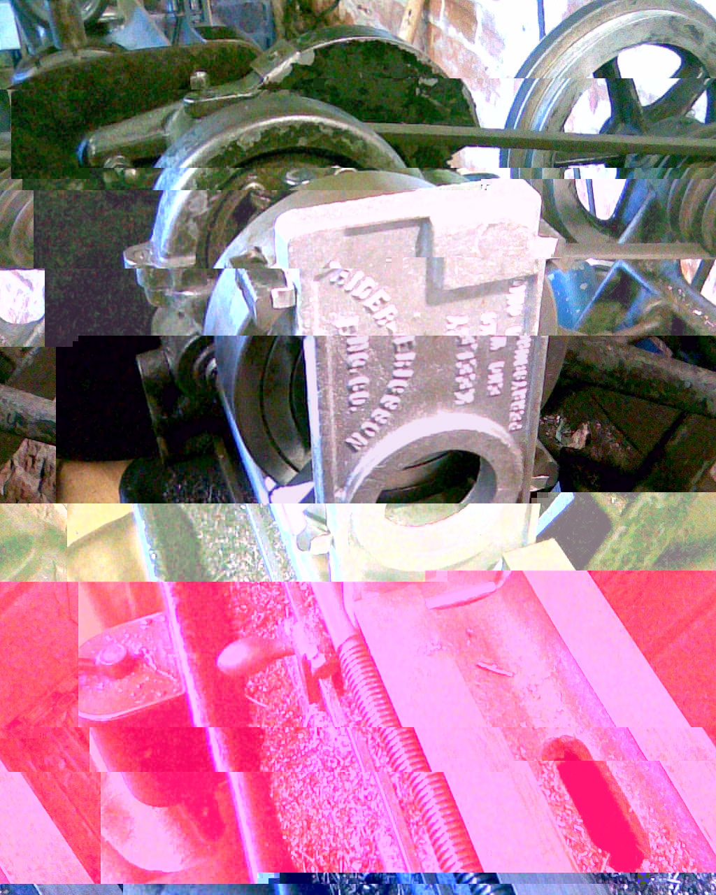

Oh well, at long last I have a bit more to offer.
Of course, my plan to strap the base to my vertical slide was as much use as an ashtray on a motorbike...the base is the same width! Back to the drawing board.  :bang:
As you can see, I had to mount the base at a 45 degree angle on the narrow vertical slide mounted on a rotating base. Its funny, you get all these bits when you buy old lathes but it takes some working out how to use them!
Finally sorted that.
Next trick...the cylinder wouldn't stay clamped in the 3 jaw chuck. Tried holding it inside and out. Kept coming loose.
Hmmm
Went back to the library. Oh look, about a million years ago someone thought of putting paper between metal to increase the grip!  :doh:
Yes, I know, you all use the trick regularly...well I forgot! :bang:

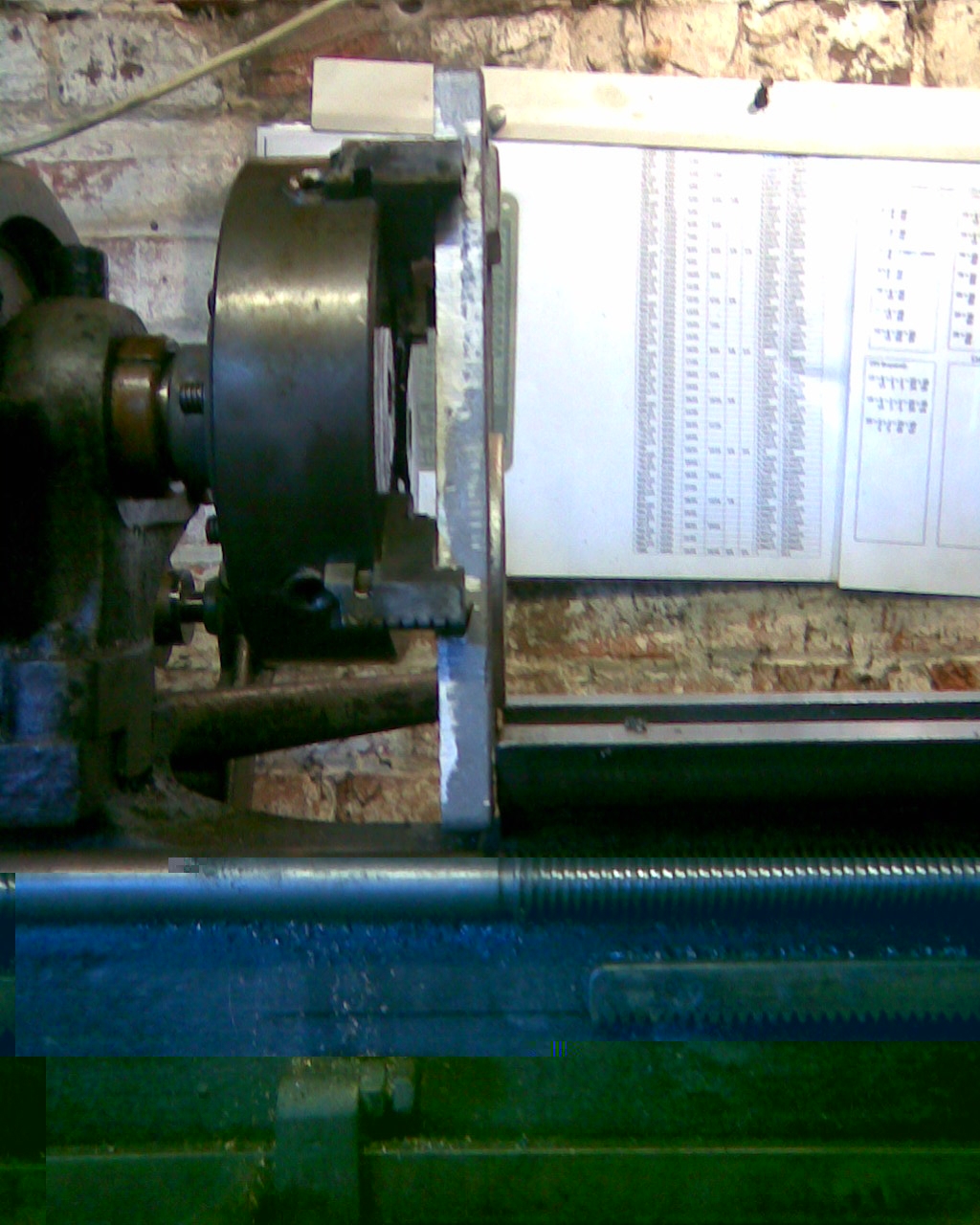

Next comes boring the cylinder. How to mount it? 4 jaw...easy! Oops! 5 inch chuck doesn't have enough space between the jaws for the table. Ok, 6 inch chuck. I sat it togther on the bench.
Looks good...er... no. The jaws close on the table by about 1/32 of an inch before centralling.
Ok, try the other way... spent hours looking for a piece of soft metal a the same thickness as the jaw step. Finally found an old copper electrical strap.
I have put the chuck onto the lathe but ran out of time to set it up properly.
I see now why it takes some people 25 years to build a locomotive or traction engine!!! :poke:

I'd be tempted to put it back in the 3 jaw and turn the edge of the flange, that way when you reverse it in the 4 jaw you can use a fixed steady on the edge of the flange which will be a lot safer and should also give a better finish as it will be a more rigid setup.
Other option would be to fix the casting to the cross slide and use a between ctrs bar as its a long overhang using a chuck.
Keep up the good work.

Nice setups Andy.
Take it gently and everything should be just fine. I gather that you don't have a faceplate for your lathe, that would allow, coupled with your angle plate, safer and more rigid setups.
Just remember that you only have one go at it before more expense drags it's a**e into the equation.
I am glad you have realised that working with castings is not the same as nice, neat and easy barstock. Sometimes it seems like you will never be able to hold it safely and rigid enough, but where there is a will there is a way, something always pops up.
Don't ignore good advice that is being given by other people, they are not trying to take over your post or be smart a**ses. They have most probably been thru it all before and can let you know about the pitfalls and successes, and it could save you a great deal of time, effort and maybe money in the long run.
Machining castings is totally different to normal run of the mill stuff.

Love the rotating base, positioning fixture thing, you used.

Thanks Bogs, I am always ready to take advice...that's one of the reasons I am putting up the project log and showing my difficulties! I have got a faceplate but can't think how to mount the cylinder on it...any and all suggestions, both polite and humourous welcome! Unless...I make up a collar to go round the narrow towards the base and tie it to the faceplate with rods and bottlescrews, with blocks to adjust and keep it steady against the faceplate.
Thank you for the fixed steady tip Jason. Unfortunately my original Drummond fixed steady is 2.25" across the throat and the finished size of the cylinder end is 2.276". Original fixed steadies are rare as rocking horse...er...stuff, I bought a whole lathe just to get one! I dont want to cut it about. Hmm...The old boys used to use bits of wood quite a lot. I've got a little pamphlet from the '20s showing some of the things made on a treadle Roundbed (9 cylinder radial engine etc). It has some weird (?) setups there, might give me some ideas. Thanks again.

Its easier when you have a flat surface to go against the angleplate but something can usually be cobbled together.
