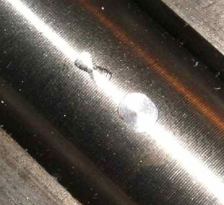

Find centre of a round shaft for drilling or keyway, no tooling, DRO's gauges, etc needed.
Fit cutter into collet, centre on shaft by eye, good eye again, then bring down with spindle running so it kisses the work, retract and look at the tool mark.
That pip on the left has been put on the shaft using gauges, DRO, Joderell Bank telescope and a Kray computer so it's spot on.
The pip on the right has been put on after the axis has been moved sideways by 0.001" and you can see it's off centre.
Sooo the MK1 eyeball CAN work to a thou.
