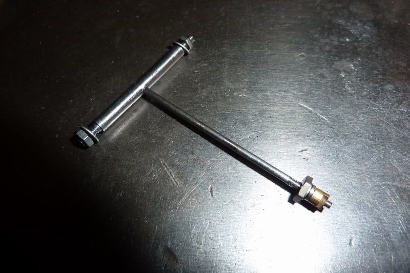

I decided I'd be a good husband and stay in with the wife on Friday night - actually I was knackered but she doesn't need to know that!  :lol:
Started making the valve rod. This was just a bit of 1/16" stainless rod with a thread on each end. The thread, unfortunately had to be 10ba (bit small for my liking). 1/16" is too small for my lathe chuck to grip so I had a cunning plan, or at least I thought I did... hold it in the pin chuck:
but this didn't really get a good enough grip. The collet was just too big so it slipped. So put the drill chuck in the headstock:
Worked this time. My new Soba 10ba die from the set I got for christmas didn't seem to be working very well though so used an old presto one and that worked!
Using 10ba also meant that I didn't have any nuts. I found one then had to drill another out that was even smaller!
Tapped in vice as couldn't feel what was happening in lathe:
The next thing to make was the valve rocker shaft. This was from 1/8" silver steel. First had to turn ends down for 8ba:
Then cut the threads:
Then had to think of a novel way to clamp in the vice level - this is the heath robinson way I came up with, rested on a parallel and used a bit of packing in the jaw to grip. Here I am centre drilling:
Seemed to work reasonably well, drilled out to tapping size and started tapping:
I was just thinking, this tapping lark in the milling machine is ok as long as use a low speed and oil and keep winding in and out... then ping!!!
I don't really know what I was thinking, 10ba in silver steel under power? Really?! I started it off with the taper ok so I should have taken it out at that point to finish by hand but no, I had counted my chickens so to speak!
Luckily I managed to punch the tap out with a bit I ground off the end of the tapping drill. I thought I had a pic but can't find it. I had actually drilled it a size smaller to attempt to get a tighter fit so that won't of helped, but it helped save it. It had only tapped a couple of threads so I opened it up to the proper size and tapped again, I hasten to add in the vice this time!
This was before de-burring:
Assembled with rod and nuts:
I then made the spring as was running out of time, that was nice and easy:
There's the assembly with the spring:

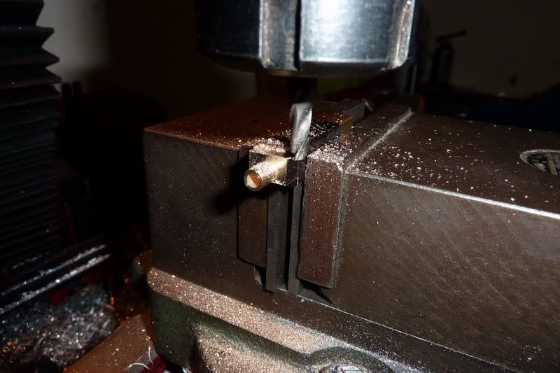

Marked up and ready to mill and drill:
Drilling for the pinch bolt - notice my mistake here, I'd already centre drilled it.
Milling the slot - I nearly made a booboo here, I used the graduations on the handwheel to get the width - which didn't work but luckily I had a small cut on and I noticed soon enough. So I just went to my markings my eye then measured each side and the bit it slots over and took appropriate amounts off.
This is what I probably should have done before, don't know why I didn't drill it in one sitting. I had to re-position and pick up the original hole:
Opening up the top prong for 8ba clearance:
and tapping the bottom prong:

Thanks lads, forgot to mention I have to saw it from the stock adn face to length too! I didn't notice that optical illusion on the last photo before, it looks like there's a raised hump but actually it's just the pattern made by the end mill when I was trying to touch on! Or is that just my eyes?!
Great idea for the camera John, will definitely get onto that. I made a tripod for a uni project once (I say I, it was supposed to be a group project but I was the only one interested it getting my hands dirty!) have no idea where it is now, I remember robbing bits of metal off it at some point though!
It will be more useful in the workshop to mount it on the mag base though.
