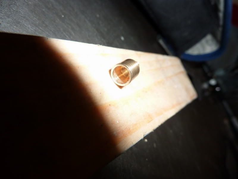

I was a little bored of the cylinders by this time so on Fri night I decided to do something else – thought I’d try the oil cups. When I looked at the drawings the small numbers scared me but I thought they have to be done sometime so I’ll try and stick to it.
So chucked some brass hex in the 3 jaw and turned the outer body dia and smaller neck dia that’s threaded to go into the cylinder. This brass was rock hard – much harder to turn than stainless, I should maybe have used that.
http://img.photobucket.com/albums/v287/NickG24/Poppin/2010-02-0521-33-21_0001.jpg'Poppin' Flame Licker
 I then had to drill a 0.020” hole – no way I was trying that so I used my smallest number drill instead, no. 60 0.040” ! Twice the size but still the smallest hole I’ve drilled and small enough in my opinion! So the hole was drilled at the lathes max speed 720rpm, it coped surprisingly well, I had to drill about ¼” or so deep so just took it steady and didn’t break the drill to my surprise.
http://img.photobucket.com/albums/v287/NickG24/Poppin/2010-02-0521-43-53_0004.jpg'Poppin' Flame Licker
I then cut the 8ba thread using one of my xmas pressies:
http://img.photobucket.com/albums/v287/NickG24/Poppin/2010-02-0521-48-04_0002.jpg'Poppin' Flame Licker
Sawed it off, turned around in the chuck, drilled out with number 13 or something which broke into the tiny hole, then faced to length.
http://img.photobucket.com/albums/v287/NickG24/Poppin/2010-02-0522-03-23_0003.jpg'Poppin' Flame Licker
http://img.photobucket.com/albums/v287/NickG24/Poppin/2010-02-0522-05-27_0005.jpg'Poppin' Flame Licker
Quite happy with the result but I then had to repeat the whole process for the other one which is starting to bore me having to do everything twice but I’ve got to remember I’ll have 2 engines then!

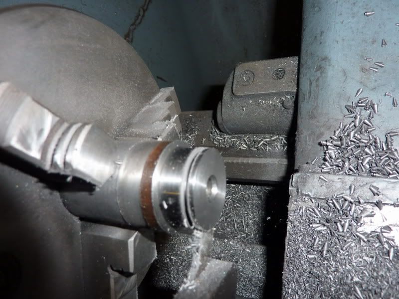

Then disaster almost struck - before I could react, this happened:  :doh:  :(
http://img.photobucket.com/albums/v287/NickG24/Poppin/2010-02-0922-01-16_0003.jpg'Poppin' Flame Licker
I’ve moved the saddle a bit in that photo, the blade dug in shattered, and sounded like it hit all 4 walls, floor and ceiling but luckily missed me.
This was my thought process immediately after switching power off:
1.   Oh ****, ******* ********.
2.   I’m ok.
3.   That could have been worse.
4.   Actually I might have mangled the chuck and caused damage to the machine.
5.   I think I might give up this hobby.
6.   Take a step back and calm down a bit.
Seriously, it scared me. I’ve never parted off anything that’s steel as the feeling I get and noise have always put me off. This time I went for it as I thought I was being soft in the past, I thought I was doing it correctly but obviously not.
When I did calm down there seemed a tight spot on the chuck jaws, something has probably got bent. I took the jaws out, cleaned and reinstalled and it works, but there is a slight tight spot at some point so I must have done some sort of damage. It still grips and seems concentric though so hopefully I’ve got away with it.

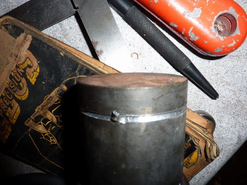

Here is the damage to the metal:
http://img.photobucket.com/albums/v287/NickG24/Poppin/2010-02-0922-06-13_0005.jpg'Poppin' Flame Licker
http://img.photobucket.com/albums/v287/NickG24/Poppin/2010-02-0922-07-13_0006.jpg'Poppin' Flame Licker
There are a few major safety points that should go without saying:
1.   Always wear eye protection – make sure you have eye protection you can see out of and are comfortable wearing and make sure you always wear it. I could easily be lying in a hospital bed wondering if I’d ever see again rather than writing this.
2.   If in doubt, stop, I had a doubt in my mind I would be able to part this off but was trying to save time. I should have reached for the hacksaw at that point.
3.   If you have a chuck guard you should probably use it. That piece of steel very nearly came out of the chuck – at the speed it was rotating it wouldn’t have been flung and I’m not saying the guard would have stopped it but it could only have helped matters. I’ll be using mine more in future that’s for sure.
I didn’t think there’d be an issue with me gripping on the threads of that bar, but with hindsight it may have been part of the problem. They were probably the weak point, deforming and allowing the stock to move.  :hammer: I did consider turning a parallel section to grip on but then I thought, it’ll grip tight on the threads and they will probably let the chuck jaws dig in a bit and get better grip.
So, I’ve calmed down a bit and the following hour and a half was spend with the hacksaw for punishment – aching now! :lol::
http://img.photobucket.com/albums/v287/NickG24/Poppin/2010-02-0923-30-33_0004.jpg'Poppin' Flame Licker
I did face the stock between each hack saw cut so at least  1 side of each blank is faced. Got a nice finish using the suds too, very good.
I could have not mentioned this mishap but I think it’s worth sharing these near misses just to give people a prod and make them think about things twice.
Nick

A nasty bit of trouble there, Nick.  Sorry to see it happen to anyone, and especially such a nice guy.
I hope you will take my comments as just a few remarks from a fellow machinist impersonator, with a fair number of this type of job behind him.  (Even when I got paid for doing it, I felt like an impersonator!);
The piece was sticking out of the chuck quite a long way.  Parting off puts more side pressure on the spindle/work/work holding device than almost anything else, other than knurling, and maybe running a profile tool into the work.
Not knowing the size of your lathe, but getting a sense of scale seeing that you are cutting 2" dia steel, this may have been too much for the lathe in the first place, but there are some things that would have helped prevent such a violent outcome.
First, since the pieces would have a bore in them anyway, it would have been a good idea to put a center in the unsupported end.  You shouldn't part off completely with a center in the tail of the piece, but you can do about 80 percent of the job that way, and finish with a saw.  The reason not to do it all the way through is the piece will pinch at the end of the cut, causing a similar problem to what you have here.
Second, having the parting blade stick far enough out of the tool holder to make the complete cut is trouble.  They wobble like a noodle, and if you had an inch and a half sticking out, it didn't have much of a chance.
Finally, just too much sticking out of the chuck.  That far out, and the effective runout of the spindle is magnified.  The work deflects a few thou, and again, the tool gets pinched, and pop!
This is one place for sure that you need plenty of lube, too.
Parting off is kind of a tough operation, especially when you're just getting to know the procedure.  Don't let it scare you off, though.  It's a normal shop op.  Find some smaller diameter pieces to practice on.  Put them in the chuck with only enough sticking out to get the tool to the cut off point.  I would think some size that will pass through your spindle would be a good practice size, and try some leaded steel if you have it.   Lots of lube and a very steady feed will do it.
Very glad there was no bloodshed associated with this, and I hope it doesn't put you off this type of operation.
It's meant to be done, but it does have to be sized to the size, weight and power of your lathe.
Glad you got the job done, and thanks for showing us some more progress.  I'll bet your poor arm is just drooping!

Nick, if I remember rightly you have a Harison 6" (12" swing) lathe?
This should have coped with parting this piece, except you would have needed to use a tailstock center as that part looks to be 6" long? The treaded end in the chuck prob made it unstable.
This is 2" diameter and very tough steel

Hi Nick
Bin there done that got the grey hairs, look on it as a learning exercise, no blood spilt which is a good thing.
Deans advice was spot on  :thumbup:
Have fun

Ooohhhh....... Nick!  :bugeye:
All part of the "fun" that is home machining!   :wave:
No one damaged..... That`s the main thing! :thumbup:
Like wot Stew said, Dean`s spot on.....
I would have machined away the threads under the jaws, for a better grip . (Or held the bar t`other way round).
Very small centre drill hole, with centre in place to support, but no real pressure applied.
1" bar...... 250rpm
2" bar...... 120rpm
3" bar........ 70rpm
Part in to a depth of 1/2" or so, only. Then saw through the reduced diameter.

Thanks for the advice Dean and all.
Just for info, the lathe is a Harrison L5 - 4.5" x 24" or something. Very robustly built, although not as robust as Darren's, with 2 hp ph1 motor.
I've parted cast iron, gun metal and aluminium with no problems but this was steel to spec in attachment. It seems to machine nicely but fairly tough. There is about 3 1/2" protruding from the outer edge of the jaws.
I was going to hold it with the centre - I don't know why I didn't, just thought it would all be rigid enough. I'd say the parting blade was stuck out just over an inch. So in future I should make the initial cut with just a small bit sticking out then extend it, then it will be supported by the cut walls of the stock I guess the further you get in?
I will have to try some different smaller diameters of steel. I was going to make the thin cam disc from cast iron as I know I can part that but my try it from steel as an exercise. Not sure how much parting blade is left in there now!
I feel like I've had a good work out cutting the blanks by hand.
Should have mentioned before, I did do the 2nd oil cup - there are just 1 per engine, perched on top of cylinder.
Thanks for the advice, am coming back around to the idea of parting!

I too have had problems with a "blade in a holder" parting tool. I reckon some of my difficulty might come from not getting the cutting edge dead square with the sides of the blade when I sharpen it, so the blade, being thin and thus having a bit of flex, gets steered increasingly off course, trying to flex more and more as it goes further in. The larger the diameter of the stock, the more the overhang of the blade, giving it more opportunity to flex. Then again, my problems may just stem from ham-fistedness and lack of experience.
I need to experiment to see if setting the blade short for minimum flex, going in say 1/4", and then pulling some more blade out of the holder will enable the sides of the 1/4" deep groove to keep the blade on course. At present, I'm using a parting tool ground on the end of a square HSS blank for greater rigidity, but I can only get just over 1/4" in with it before the saw has to come into play. But even that shallow groove gets me well on the way - in terms of cross-sectional area, a 2" dia, 1" radius bar is 3.14 sq inches. With a 1/4" groove round it, there's 3/4" of radius = 1.76 sq inches left to saw through, so 44% of the job has been done by the parting tool.

« Reply #24 on: February 10, 2010, 08:00:17 AM »
I too had problems with HSS parting blades cutting steel. OK for brass and such though.
Then I bought an insert parting tool, different world. Now I part off under power and it can be quite a rapid speed too.
This one had left and right cutting edges so quite versatile as well.
