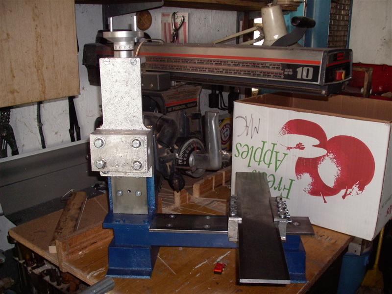

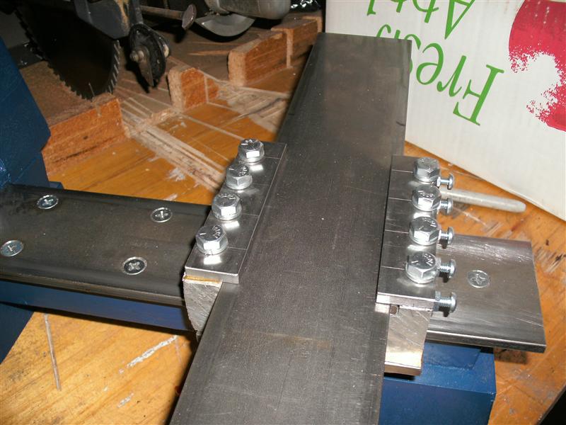

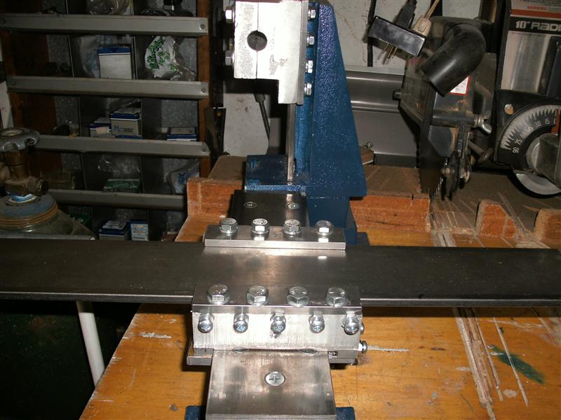

Finished fitting the cross slide
« Reply #87 on: May 10, 2010, 05:15:50 PM »
I finished the cross slide fitting today. It is perfectly square to the bed ways and is nice and tight with no play in either direction. Bed and table travel is smooth. It doesn't look like much change but it took a lot of work to get it fit properly.

Dan this is a great project.  Did you have to do any scrapping?
I had to do a little bit to square it up Bob. The CNC cut was good enough for the bearing surfaces. I only had to scrape one of the edge bearing surfaces to get the table and bed square to each other.
