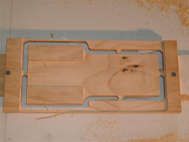

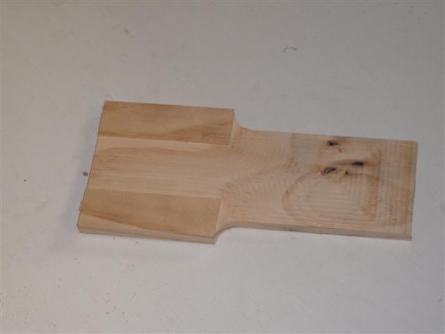

This weekend's work on the mill
« Reply #41 on: February 21, 2010, 05:29:41 PM »
I needed a pattern that was 3/8ths thick for the spindle slide. Since I don't have a planer and have no idea where I can get wood in 3/8th in dimension I used my CNC plasma/router table to cut the pattern to the proper thickness. Here is a 3 minute video on the process.

Re: My latest project. Gingery horizontal mill
« Reply #42 on: February 21, 2010, 07:19:14 PM »
That's a neat way to make patterns!
« Reply #43 on: February 21, 2010, 08:43:17 PM »
Gaget,
Couple of questions, who's table if it's commercial and could you have used styrofoam?

Offline Gadget
  • Posts: 125
« Reply #44 on: February 21, 2010, 09:21:16 PM »
Gaget,
I'm thinking of getting a cnc plasma table next year from Torchmate. It's small, 2' X 2'.
Anyway nice job. Don't want to get to far offf topic.
Bernd,
I could  have used styrofoam but will be casting indoors and the fumes from lost foam are nasty. As for the table, I built this myself. It is convertible from router to plasma cutter and is based on plans from solsylva.com. I use a Longevity ForceCut LP80 plasma cutter when doing that function.
I have seen the torchmate 2x2 CNC machines, they are very nice. I didn't spend as much on my table as what the Torchmate tables cost though. Also, the Torchmate 2x2 units come without the plasma cutter I believe.

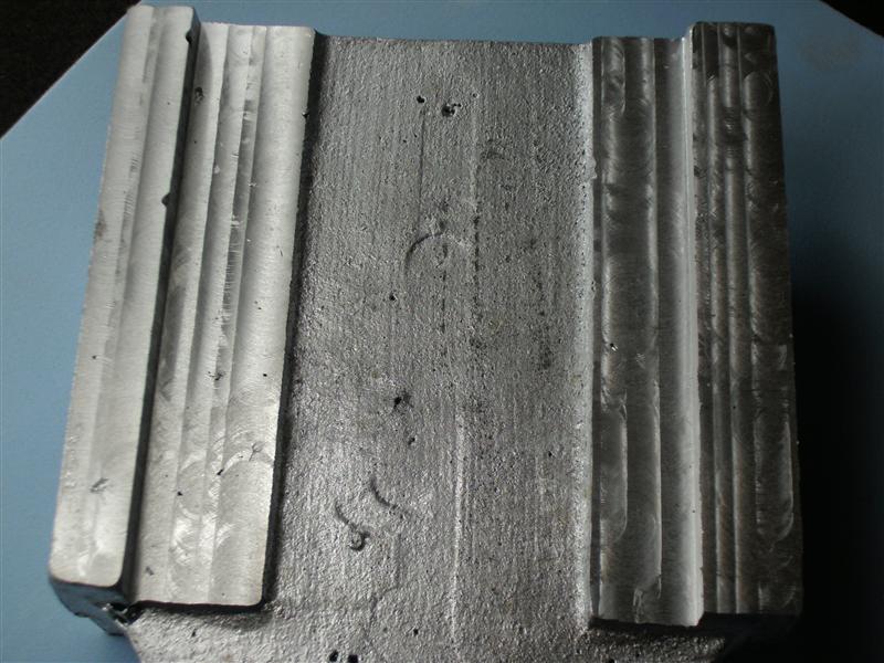

« Reply #47 on: March 13, 2010, 04:19:59 PM »
I recast the spindle slide today. Made two of them, one for me and one for Torqueman. They both turned out quite well this time. I will cast the bearing caps next and then the hand scraping and fitting begins again.

« Reply #48 on: March 28, 2010, 09:13:24 PM »
I finally have an update. The spindle slide casting was made with incorrect measurements (error in Gingery book) I recast the parts with the correct dimensions.
Rather than hand scrape the box slide and bearing cap fit I used my CNC mill to do the work. I'm very pleased with the results.
