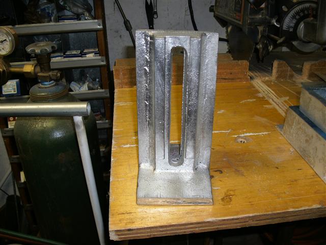

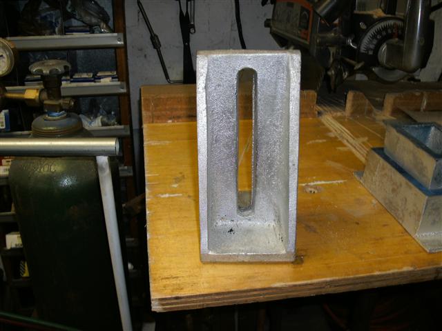

  • Posts: 125
Gingery horizontal mill update
« Reply #22 on: January 10, 2010, 04:42:02 PM »
I poured the first of two mill head stands today. This was the most complicated patterns in the build and it turned out as close to perfect as I think I will ever get. It's a split pattern with deep thin pieces that have to be pulled from the sand. I had my doubts that I would be able to pull the patterns without damage but they pulled very nicely.
I also cut the bed ways and got the first two bolts inserted. The rest will be easy now since the ways will not move when doing them.
Re: My latest project. Gingery horizontal mill
« Reply #23 on: January 11, 2010, 09:27:27 AM »
Some very nice looking casting. It'll be interesting to see this machine from begining to end.
Keep up the great work and posts.  :thumbup:
« Reply #24 on: January 11, 2010, 09:01:18 PM »
Very cool. I love to see people casting their own stuff. Building your own mill! Now that's classic! My hat's off to you sir!
