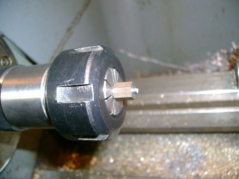

Brass turning nicely with that same tool as the crank! Took a big enough cut to get past the hex bit ... no problem.
Lot of material to come off here too ... had to double the longitudinal feed speed otherwise I'd still have been there! I must be getting lazy, don't like turning the handwheel now!
All going pretty well, couple of finishing cuts on the rod.
The middle was to be wasted down further still.
Started parting off, then filed the radius in situe. A test fit on the cylinder resulted in lots of swearing as it was already quite a bit undersize ... good rattling fit which wouldn't have worked. I put this down to getting different measurements between the internal and external jaws of my digi caliper .. piece of cheap cr@p! 'Buy cheap, buy twice' as someone always said to me at work ... not always the case, but in this case buy cheap, make twice, buy twice!  :lol: actually, don't know whether to  :lol: or  :( !
So:
No, I didn't do that in my temper, although I felt like it  :bang: ! I had a cunning plan, it was a good job I stopped there, I could turn that down to rod size and part off a bit further along then cut a thread on the end, make a disc from the remaining bit, tap it to suit and screw em together. By this time it was about 11:45 ... again, hence no post last night!
Disc drilled & tapped, parting off.
Rod in collet chuck again ready to turn down and thread end.
Disc screwed on, faced to length and profiled with needle file. This time checking fit in cylinder. It's still not spot on though, very easy to go a tincy bit too far with the file.
Missed the step of drilling the hole in, the pin was quite a tight fit in the big end but waggled it about a bit with some oil and it's loosened off. Still might be a tad tight, no it should be ok, spins quite freely.
The good news is, when I blow into the cylinder it gives a decent power stroke, but on the exaust stroke I can feel a bit of a power stroke too if you know what I mean. I mentioned this before, it was my fear that the piston doesn't rock sufficiently to vent the air pressure.  I have a 4" dia cast flywheel which just happens to have the right bore, so I tried that ... i could get it to turn over a few times on lung power until I ran out of puff. So, I think it will run, at certain pressures, but I think it's a marginal design. I might have to experiment a bit with the flywheel, the one I've designed might not have the inertia required to counter act pressure forces on the piston. Also, the best configuration to run these in is probably vertically with the power stroke upwards. Then you also have gravity helping on the exhaust stroke.
Will have to see.
