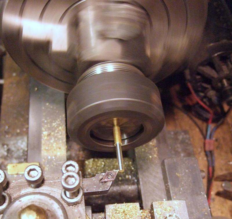

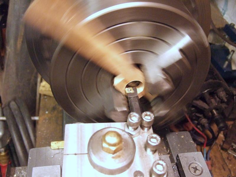

Here's a start, parting off the brake drum on my homemade lathe:
And here's the cherry wood I'll be using, milled out. It's kind of surprising how small this all is, after having looked at the plans many times over the years in the magazine.  :coffee:  It really is just a little bit of... whatever!

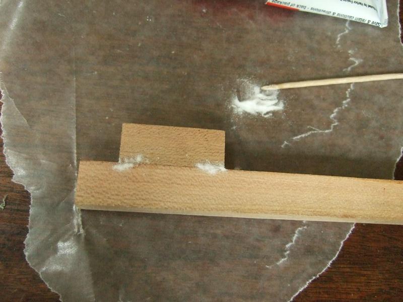

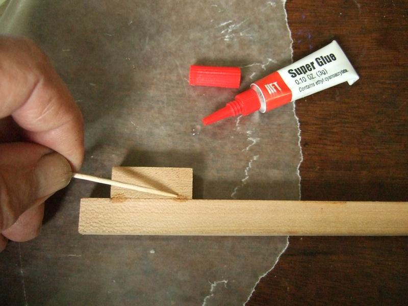

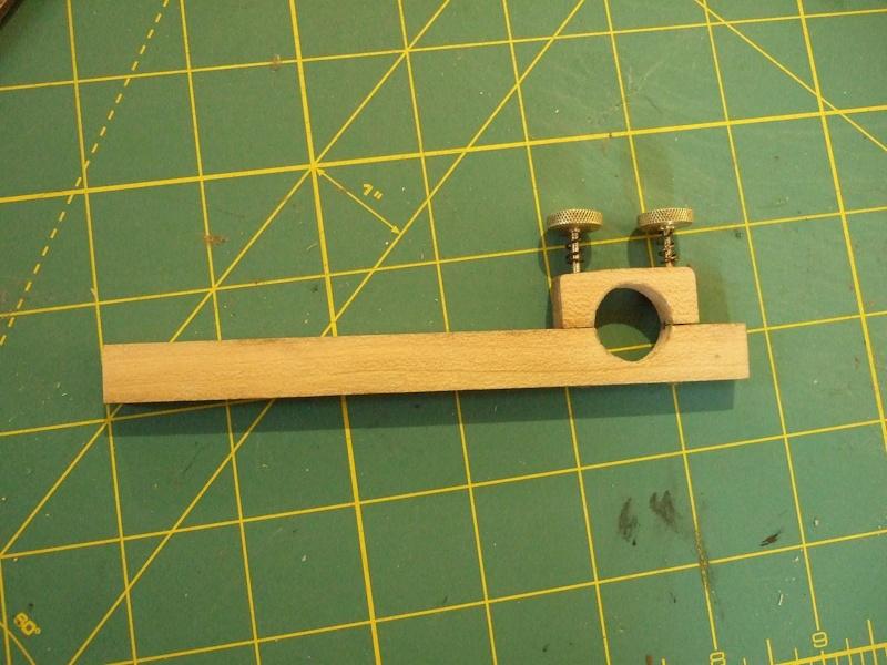

First step in making the torsion arm is gluing the two blocks together temporarily with tacks of super glue. I put two dots at either end on both sides and just let them wick a small way into the joint from the side. I used a toothpick to pick up a small amount of glue from a drop that was placed on the waxed paper. I really didn't want the blocks to be glued together permanently, and they would have been impossible to separate if I'd applied it directly from the tube.
I don't have accelerator, and wood sometimes slows down superglue's cure. So I used a couple small pinches of bicarbonate of soda, which effects an almost instant cure.

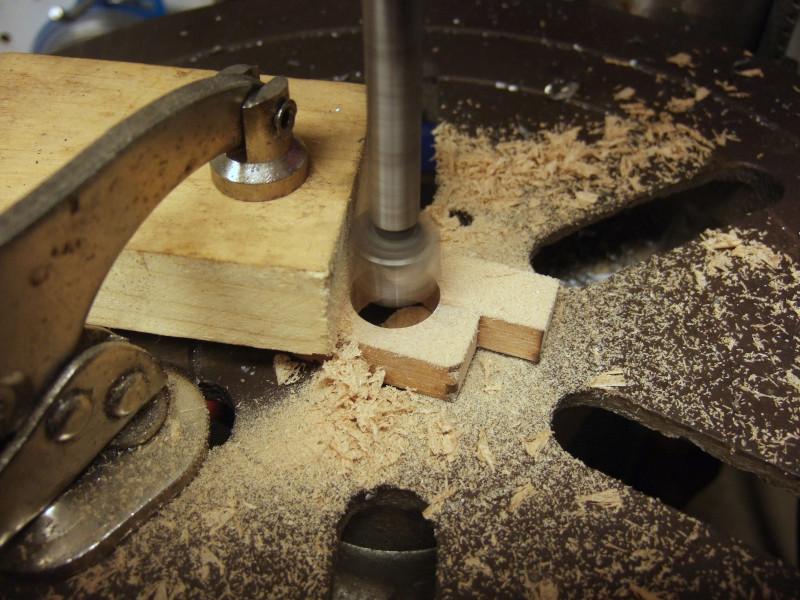

I marked out and drilled all of the hole locations in the torque arm, and drilled the smaller ones full size.
The large hole for the drum was drilled undersize with a Forstner bit.
Professor Chaddock recommends boring on the lathe, but I find centering an odd shape like this one difficult without some kind of initial pilot hole, particularly on wood. Much easier to pre-drill on the drill press. A large hole in the piece was actually easier to center on the lathe than a small pilot would have been. I just clocked in the ID with a gauge. Then I did the final boring to size.

Then it was on to the adjustment nuts. Finally something straightforward in the lathe, out of metal! These were drilled tapped, knurled, and finally parted off in my homemade lathe, the most enjoyable part of today's work:

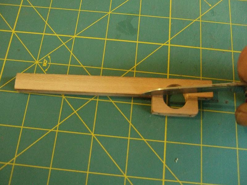

After making the hardware, it was time to split the blocks apart again. My good old Swiss Army knife seemed a better (and longer) wedge shape than an Xacto, so that's what I used.
The original brake had bolts with heads, unlike my all-thread studs and it was suggested that a tight fit in the lower arm was needed to keep them from turning. Seemed to me that  a dab of epoxy on the threads would serve both purposes for my version, so that's what I did.

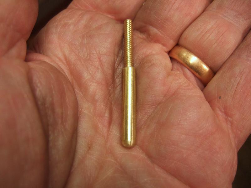

Today I started on the stylus that will transmit the force of the brake arm to the digital scale I'll be using. I started with a piece of brass 3/16" and immediately ran into the problem that my 4 jaw chuck won't hold anything that small. That's a feature among others that bothers me about that chuck. Nevertheless I worked around it by taking my square ER collet holder, and clamping that in the 4 jaw. Kind of overkill for a piece this small, but it beats having to change chucks. Funny to see an ER chuck, in a 4 jaw chuck, mounted on a faceplate, but that's what got the job done today. I thinned the brass down to .134" for threading 6-32.
  • Posts: 6835
Re: Making a Prony Brake to Measure the Power of My Hot Air Engines
« Reply #7 on: May 23, 2025, 07:53:59 PM »

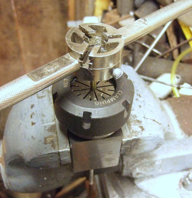

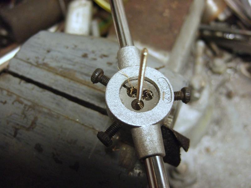

And thinking I'd break out my never before used tailstock die holder, ran into problem number two. Despite the fact that it had many different die holder recesses and attachments, it wouldn't accept a plain 1" hex sided die -- which was what I had for cutting a 6-32 thread. Rats! I should have made one myself instead of buying one to... ahem, save time.
Well, the ER collet holder to the rescue again, I started the threads in the lathe by holding a die handle and then transferred the collet holder block to the bench vise and turned the threads the rest of the way.
« Last Edit: May 23, 2025, 08:19:13 PM by vtsteam »
  • Posts: 6835
« Reply #8 on: May 23, 2025, 08:20:21 PM »

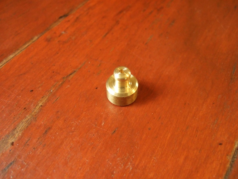

I cut the stylus to length, and rounded the end. Here it is finished:

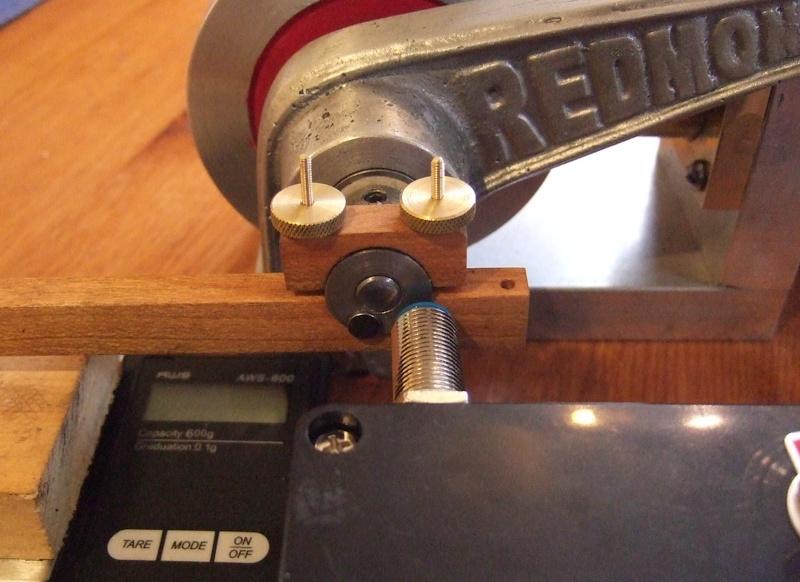

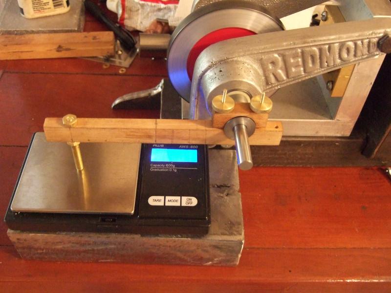

I drilled and tapped the brake arm to accept the stylus at a distance of 10 centimeters from the center of the brake drum, then secured it in place with two nuts. The height of the brake arm is therefore adjustable, and should be set level. A 10 cm moment arm means that every gram registered on the digital scale will be approximately ten times the newton-meters of torque absorbed by the brake. So grams divided by 10 is ~ Newton-meters. From that, and RPM, Watts can be easily calculated.

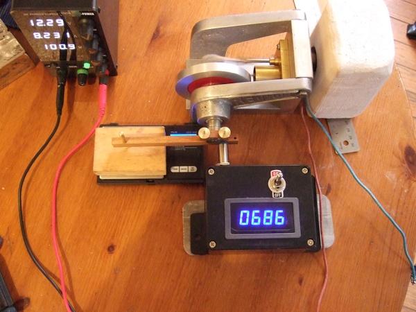

With this work done, the Prony brake was operable, though I'm not finished. But I couldn't resist setting it up temporarily and trying it out!  :zap:
I was disappointyed when at first the engine wouldn't start at all with the brake just sitting, applying no pressure to the drum. And for the first 15 minutes the engine ran I could hardly even touch the drum without nearly stopping the motor. But eventually the engine seemed to loosen up and gradually increase speed to the point where I could attach the brake arm...but without the adjustment springs... just letting the parts run together.
This brake definitely needs to be run in -- it needs more of that. But eventually this evening I was able to adjust the thumbscrews (without springs) for very slight pressure, and get the engine to run at reduced speed, registering a torque reading on the digital scale. I was gratified to see it was a reasonable stable digital reading, probably helped by the inertia of the brass stylus, which, unlike the other parts does not weigh on the drum.
Here's a picture of the first run. I do need to do a little more work to get easier and more consistent readings, to work out a measurement procedure, and to finish it off, but I'm very happy that it works quite well already!

I made a 9.0 gram compensating weight to solve the auto-shutoff problem with my scale.
When the engine is stationary and the arm is loose on the drum, the brake arm puts 9.0 grams of weight on the scale. If at any point while the engine is running I need to tare the scale, I can now just lift the arm, and substitute the brass weight, and hit tare. Then remove the weight and lower the arm again.
On Professor Chaddock's Prony brake, he uses a permanently affixed lead counterweight behind the arm to balance it. I could have done that also, but to me this puts additional dead weight on the drum while running, applying additional unwanted braking pressure at all times. His system works on the principle of a balance scale, so this is necessary in his case.

Extremely preliminary test on No. 83 with the Prony brake not broken in yet and a nearly empty Sterno can and a handheld tach (somewhat flakey: to be replaced) = 4.0 grams at 982 RPM = 0.403 watts. That's about what I expected for a starting figure.
  • Posts: 6835
« Reply #19 on: May 27, 2025, 11:07:22 AM »
Scale 4.5 @ 1060 RPM = .490 watts. With a fuller can of Sterno, again really too preliminary to take as anything more than ballpark. Lots of consistency problems controlling brake pressure and reading RPM and scale simultaneously.

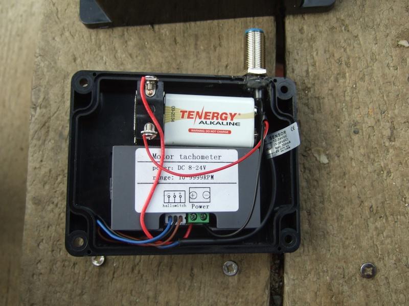

I tried to set up a digital Hall effect tachometer with a panel meter and transducer received from Ebay, but it seemed defective.  It just read 7777 or LLLL when powered up (depending on how you look at it). Today, I tested on a loose flywheel with magnet and figured out this was normal behavior, unlike my other Hall tach on my lathe, which shows 0000 when stationary. I had initiated a return, but cancelled it once I realized it worked. This could have been avoided by including a one line instruction sheet. Oh well, on with the show....
« Last Edit: May 28, 2025, 09:52:53 AM by vtsteam »
  • Posts: 6835
« Reply #22 on: May 28, 2025, 09:12:17 PM »

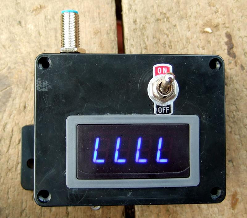

I made up a digital tach tonight. It all fit in the lid of a plastic box.
Display, bottom. Switch, upper left. Battery, right, held in place with velcro. Hall sensor, top right.
The case assembled, and the weird LLLL display:
To trigger the Hall sensor, a very small wafer magnet was attached to the outside rim of Prony brake drum with high strength bearing mount adhesive.
  • Posts: 6835

And here's a mockup of a test setup. It will need to be mounted on a base so vibration doesn't move the various pieces around. But I couldn't help but give it a test spin this evening.
The accessories made for engine testing are:
1.) A variable DC power supply. Here supplying 100 watts for heating the displacer.
2.) A DIY electric furnace made from Plaster of Paris with stainless steel aircraft safety wire for an element.
3.) DIY Prony brake from steel, brass wood and a digital scale  (yes, I still need to shorten and reverse the stylus)
4.) DIY Hall effect digital tachometer.
BTW this photo was at startup. Engine reached 1200 RPM eventually on 100 watts input.
No output watt figures yet because accessories were moving around the table at that speed due to vibration.
  • Posts: 6835
« Reply #24 on: June 19, 2025, 03:57:44 PM »
The final version on a wooden base and everything blocked up and clamped in place. I also shortened the stylus considerably:
