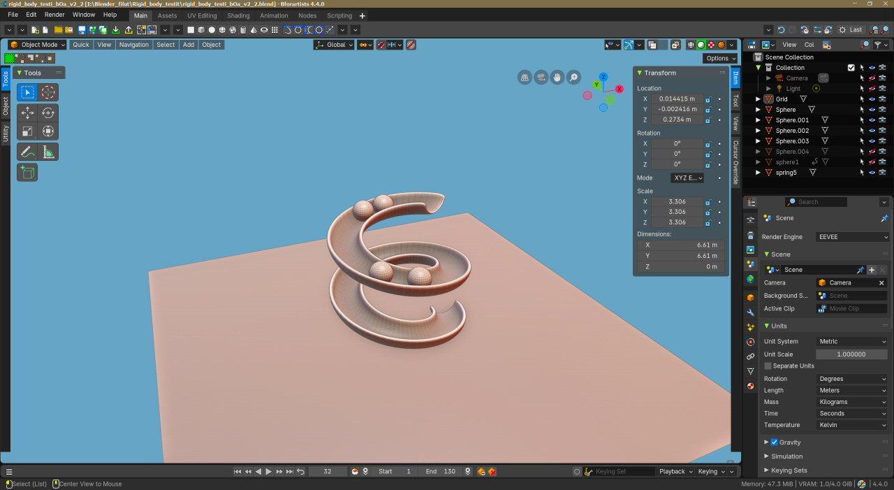

Generally, I have a habit of using only certain or needed parts/functions of different software/programs to get (or hoping to get) results that I'm after.
Blender seems to offer primarily mesh tools, so it probably isn't suitable for any precision object modeling. But how about its animation and simulation capabilities?
Few weeks ago, to get my feet wet I started with Bforartists, which is a 'hack' of Blender. It's still Blender, but has additional user interface elements like icons (and overall more colorful appearance) which may help to navigate and find certain functions easier, and to get a grasp of how the UI works.
I remember trying Blender several times in the past, but tossed it because its UI structure felt just too strange.
It's obviously for users who prefer to use keyboard shortcuts instead of clicking icons. I guess pros use it that way to accomplish things faster and more efficiently, but for newbies it may be too challenging at first.
At the moment, I'm playing with simple tutorials, hoping to learn basics of rigid body based mechanical animation with objects like this:
It appears that simulated objects must be mesh objects, so I'm trying out mesh modeling in Blender, and see how it goes.
It really doesn't have tools for drafting, although it's possible (but tedious) to make "cad-ish" 2D drawings from images. I find that in Blender, curves need to be converted to meshes for easier editing (vertices and edges instead of nurbs or bezier ones which have handles for more "organic" editing).

Some of the things that may seem odd for newcomers:
- Blender and Bforartists seem to favor quite dark themes; if one prefers lighter color viewport background, it makes certain elements(like crosshair cursor and selection rectangle) very hard to distinguish, so it might take some fiddling to find suitable color.
- Lack of easily making/editing toolbars (well not really lack, if one knows python). But there's an option to add commands to 'quick favorites', which opens by pressing Q key. It's handy, and I'm starting to get used to it.
- Using snapping for moving, scaling or rotating objects is dependent of the view, and works more consistently if the view is aligned in X, Y or Z axis. It's also dependent on how close the target is zoomed; the closer the zoom, the finer the snap, and similarly coarser when zoomed out.
Things to consider:
- It's free
- It's available for Windows, Linux and Mac
- Lots of tutorials from beginner to advanced levels on Youtube
- Also lots of free add-ons available
P.S. I wonder if there's way to show animated images or similar sized mp4 video snippets in posts? From what I've read on the forum, if memory serves, animated gifs aren't allowed for security reasons. As one possible option, I have free Proton account, and it has Proton Drive with 2 Gb storage. It allows encrypted link to files, but I have no idea how volatile it is. In other words, how long those links lasts. Another option would be to upload files to Youtube, which is also free, I suppose.
Besides those mentioned, any suggestions?

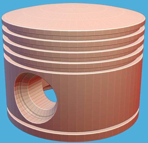

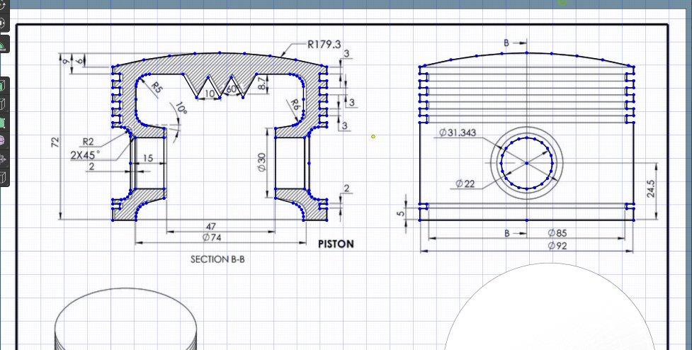

Can I ask, in your piston drawing earlier, what are the triangular sections under the crown?
Offline sorveltaja
  • Posts: 645
Nice work!  :beer:
At first I thought they are for cooling, but since when pistons had such? It would be interesting to know what kind of engine that kind of piston belongs to. But yeah, it's just random image I found on the net.
  • Posts: 9051
Some Land Rover engines have  jets of oil played on the under side of the piston crown for cooling as I imagine do many other engines
Offline sorveltaja
  • Posts: 645
Thanks for the info :beer:. I don't remember seeing that kind of cooling solution. But here we go, my knowledge about engines is limited to small, model ones.

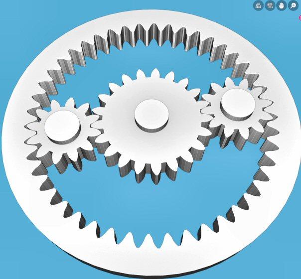

What comes to mechanical animations, like gear trains, there seems to be several ways to achieve desired results. One that I'm particularly interested, is using previously mentioned rigid bodies where several objects react to other ones in "physical" way. It may sound like I know what I'm doing, but it's trial and error process. Although there are, no doubt, very sophisticated ways to achieve expected outcome, those are for advanced users; I just prefer the 'hands on' approach instead.
It's sort of like playing with lego blocks. Animated and/or simulated objects can be modified to affect the result, like in this video, which uses same objects that were in previous video, with added elements. I didn't expect such a result, but it's actually going to the direction I'm after:

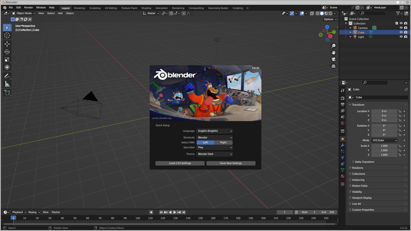

Blender 2.92 is the last version that works in Win 7. It has far fewer functions, and it doesn't seem to be as stable as the newest versions.
That's why I've had to use Win10. But the more I use W10, the more I want to avoid using it.
One option that's left, was to install Linux. As I'm not too much into learning it (Linux) at the moment, I tested several distros in VM, to see which one has most easily configurable (or "windowsy") settings.
One that stood out was Pop OS. It has a GUI that imitates W11, having options to customize it a bit more easily available(although some settings require some serious searching). Plus it supports browsers like Brave, Opera, and Waterfox, which I've constantly used in Windows.
It also has a version that has Nvidia drivers included, and that's what I'm using.
It might not be the best of the best option, but so far, after few days of using it, Blender has worked without problems (as well as the browsers mentioned), and it feels that it could be good enough alternative to W10:
What comes to running Blender on Linux in VM, only a lot older version of Blender worked; newest one installed just fine, but gave an error message and simply refused to run.
I guess one has to have a PC with quite beefy specs, and to know how to configure hardware for VM for that kind of CPU-heavy tasks.
So, what a better excuse to utilize a moped class PC, than to install software on bare metal instead?

Tried 4.4.3 Blender for Linux.
No need for terminal commands to install it. It's a self contained app, you just download it from the website, unpack it and click on the launcher file in the unpacked folder to start it.
But in my case (with this laptop) it says my video card is unsupported. Probably related to the fact that the version of Puppy Linux I'm using is a few years old, and the computer very new.
However I also downloaded Blender LTS (Long Term Service) version 3.6.22 still current, and that one opens fine in my version of Puppy Linux and my laptop:

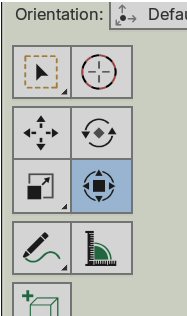

To get back to the topic, I thought to mention some of the keyboard shortcuts I use most.
To move an object, shortcut is (G) (for grab I guess). If that object needs to be moved along certain axis, key sequence G + X, Y or Z is used. Also, amount of transform can be added: G Z 100.
Same applies for scaling (S) S X 100 and rotation (R) R Y 90.
Another way is to use transform gizmo:

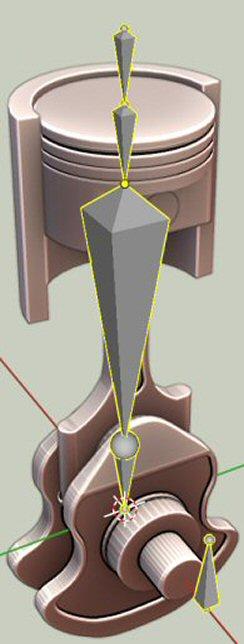

What comes to simulating objects, so far I've been using rigid bodies; some mechanisms seem to be easier than others. Seemingly simple one is centrifugal governor. It gives wild results where parts fly around.
There is another way to link objects to form a mechanism, though. It uses bones, which are widely used in character animation. It may give more predictable results, once I learn how to use it.
« Last Edit: May 24, 2025, 08:34:34 PM by sorveltaja »
  • Posts: 6835
That bones concept is interesting.  :coffee:
