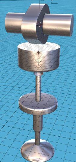

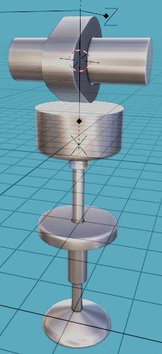

At the moment, I'm playing with simple tutorials, hoping to learn basics of rigid body based mechanical animation with objects like this:
It appears that simulated objects must be mesh objects, so I'm trying out mesh modeling in Blender, and see how it goes.
It really doesn't have tools for drafting, although it's possible (but tedious) to make "cad-ish" 2D drawings from images. I find that in Blender, curves need to be converted to meshes for easier editing (vertices and edges instead of nurbs or bezier ones which have handles for more "organic" editing).
  [ You are not allowed to view this attachment ]      [ You are not allowed to view this attachment ]

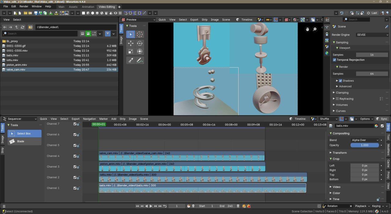

Previously I haven't done much video editing, except simple stuff back in the days in Virtualdub. I was looking for ways to make a video, that has more than one videos in it. No need to look any further - Blender has its own video editor:
On the upper left side is the folder with video files. On the bottom are the channels, where video files can be dragged. In the upper middle window videos can be scaled and moved, using same shortcuts (G for moving, S for scaling) as with the objects in 3D window. Output is rendered to .mkv video format, which is then ready to be uploaded to Youtube:
What comes to 3D rendering, from newcomer's perspective, there's an option to use OpenGL preview renderer to render the output of animation without any scene setup(lighting, cameras, object materials/textures etc). It basically takes series of screenshots of the viewport, therefore being very fast.
For some reason, its output (be it single image or video) has quite dim or faded colors, when actual 3D viewport is compared to rendered image. Maybe it's about some settings that I haven't yet found:
