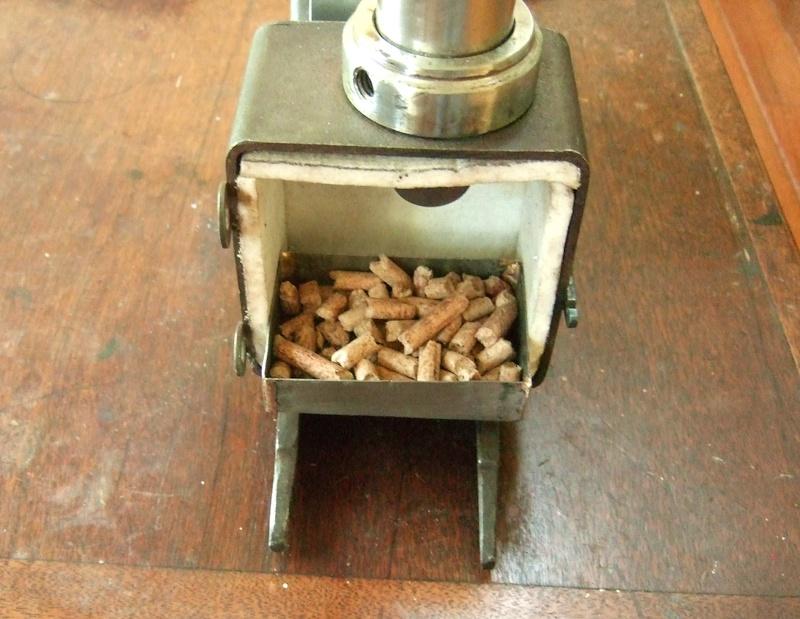

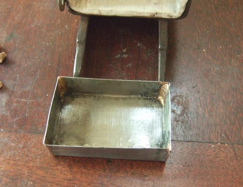

Today I made an ashpan out of some scrap galvanized tin:
And put some "small logs" in it -- ya know, just to see what it looked like......

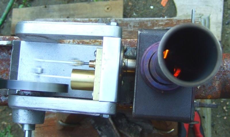

Well, then I kinda figured might as well light them and see what happens........
What happened was Number 83 took off at 1500 RPM and the base of the smokestack oxidized to a beautiful shade of purple:! Finally Number 83 was running on wood, after 18 years, doing what it was intended to do!  :ddb: :ddb:
