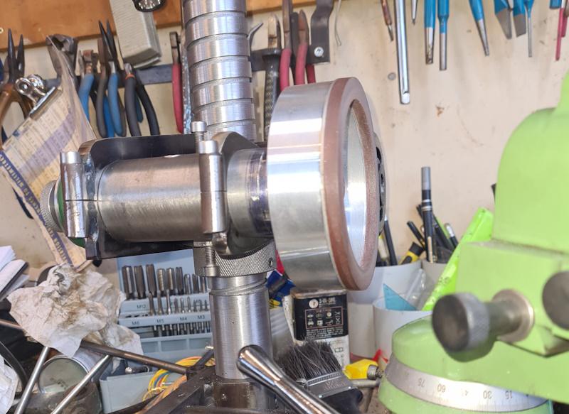

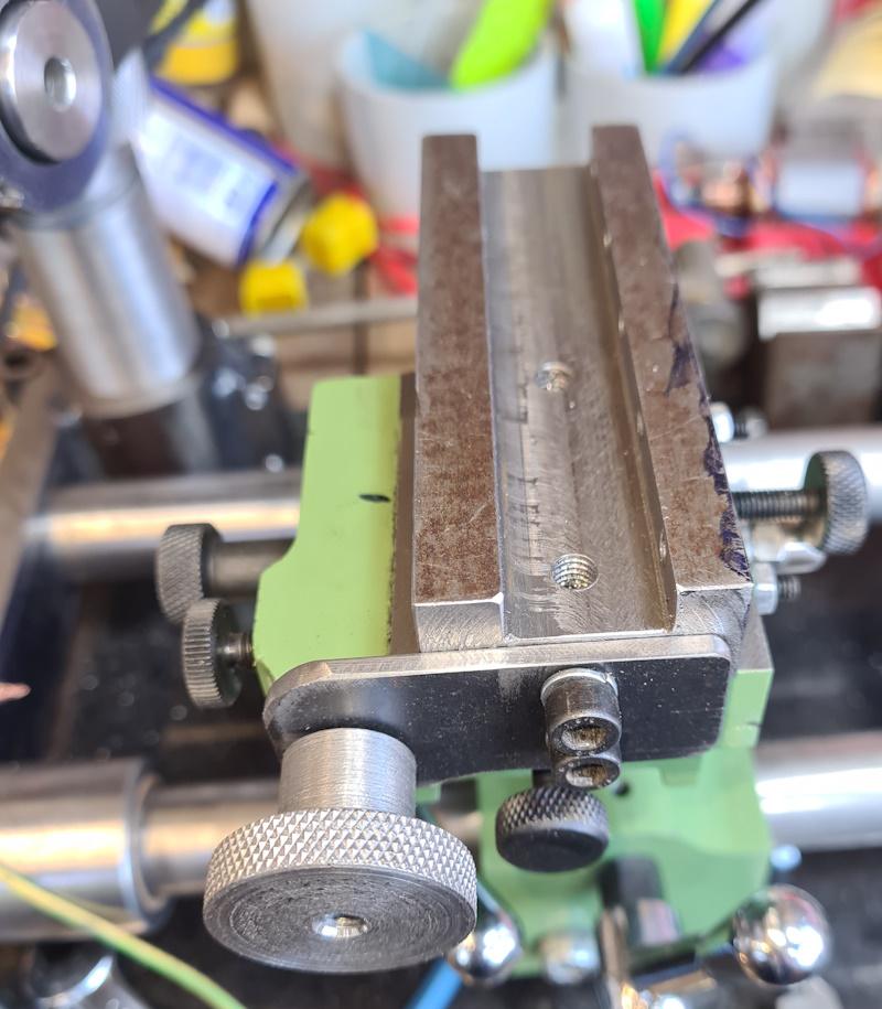

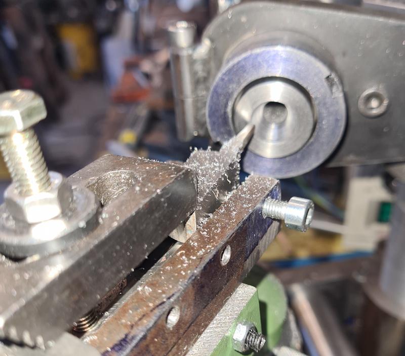

This is the next bit which apart from holding lathe tools etc will hopefully help me make the accurate 40 degree taper in the end of the spindle.
Offline shipto
  • Posts: 867
  • Redditch, UK
Re: Quornish
« Reply #34 on: April 07, 2025, 12:31:45 PM »
Its a bit difficult getting a decent picture but that seems ok. I guess the next thing is to make an arbor and make sure, if its not far away I can lap it I think.

« Reply #35 on: April 07, 2025, 07:57:58 PM »
Interesting way you made that taper, Dwayne.
Offline shipto
  • Posts: 867
  • Redditch, UK
Re: Quornish
« Reply #36 on: April 08, 2025, 02:00:29 AM »
I just guessed it would be the most accurate way I could create it. made me realise that it could also be used to make micro parts if I add a tiny chuck.

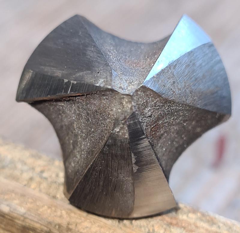

I have made the first arbor and mounted the wheel with middling success. I think for future arbors I will leave them slightly oversize and finish them on the grinder.
Of course I had to have a little play and sharpened a few endmills which look good but I havent tried to use them yet but I also had a go at sharpening a countersink which cut really nicely but looking at the picture it seems to be rubbing at the back slightly so I guess the angle was wrong but this will come with practice.

I've not had any experience sharpening milling cutters, but surely the cutting edge should be a thin parallel strip, rather than the broad, triangular feature that you have achieved?

« Reply #40 on: April 13, 2025, 08:26:08 AM »
The picture shows a countersink bit not a milling cutter and a cheap one at that. However yes there should not be as much sharpened but that was me playing about and not really putting much thought into it. Hopefully perfection will come with experience of using the grinder but I wouldn't put money on it. :lol:

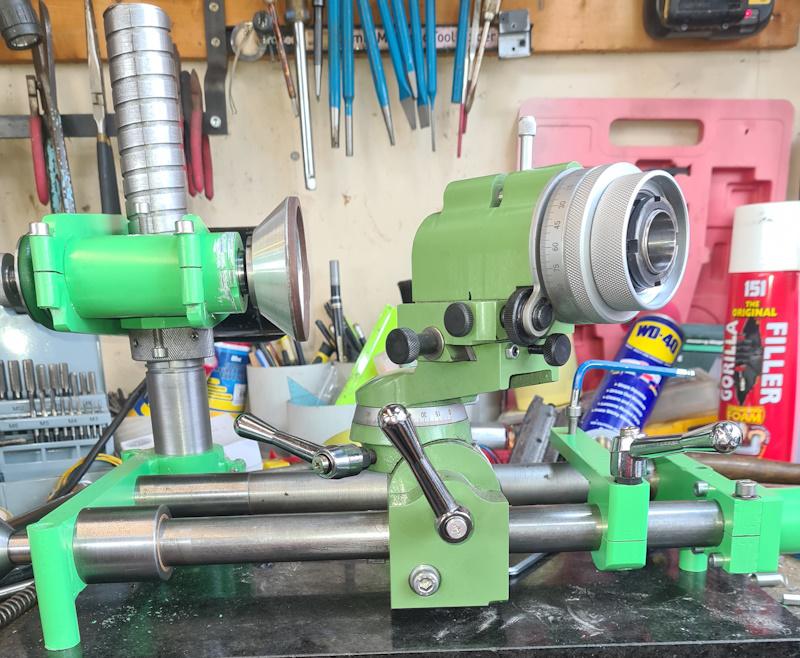

In a shocking turn of events (for me anyway) I managed to find time to dismantle it and paint it. Not a good match but I'm not that worried.
Still have a few things to do including some guards for the wheel and drive belt, replace those cap head adjusting screws with something better and make arbors for the various wheels I have which will work on this. You might notice a got the 80mm wheels to replace the 100mm one but also brought a regular 80mm cup wheel and have a few wheels from a small grinder I brought from aldi a while ago which was terrible but the wheels should do.

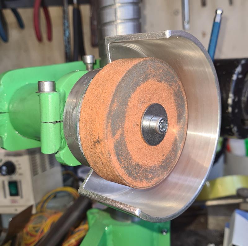

Wheel guard done the expensive way (if I was buying the stuff that is) meaning that I had a scrap of 100mm aluminium block and turned it from that. It had been lying around for ages looking for a job so I thought why not.
May have to shorten it a little but cant think why at the moment I am pretty sure that as it can rotate I can avoid it causing any problems.

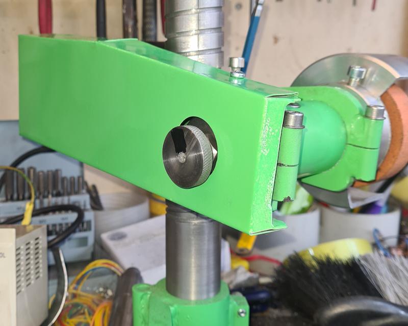

« Reply #47 on: May 04, 2025, 12:23:01 PM »
Not the best looking guard but its all I could do with the tools available so it will have to do for now. I will look at it again at a later date and try for better for now however apart from arbors for the various wheels it is done. There are many attachments I plan to add to it and will update this thread as I make them.
