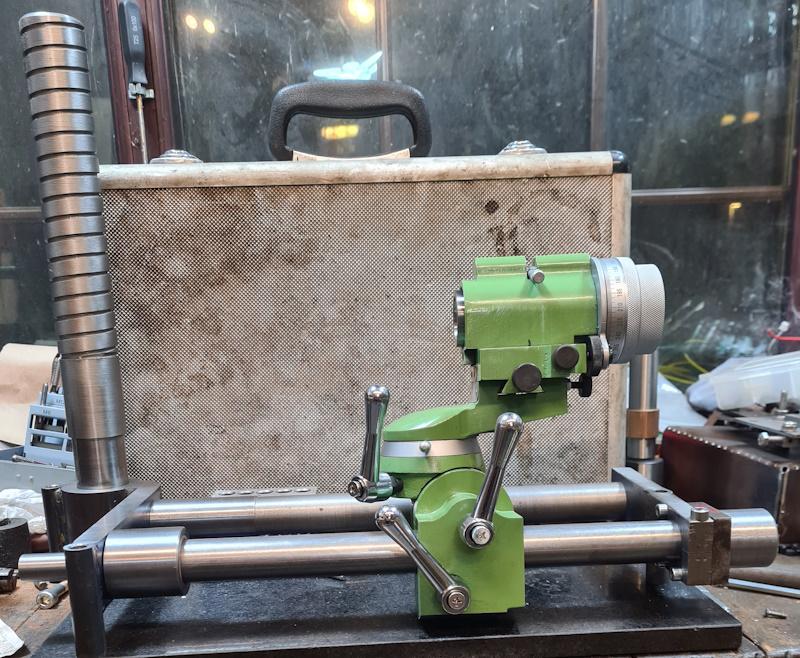

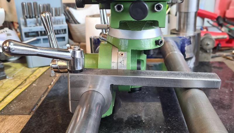

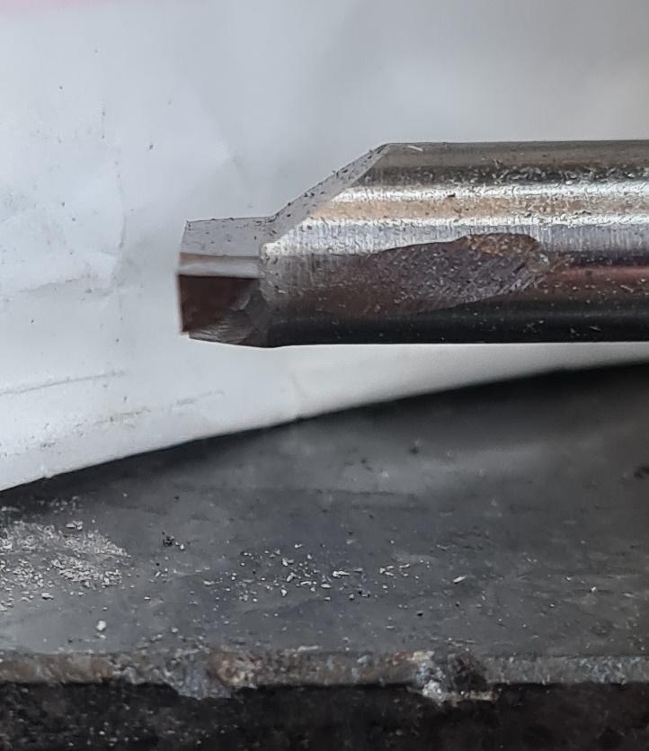

I have held off posting any details of this project because I wasn't sure it would work but now I have got this far I am a little more confident so first pic of my Quornish.
I cheated a bit by buying the U2 cutter grinder attachment rather than make the bits myself.

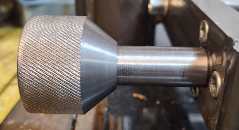

« Reply #1 on: January 31, 2025, 01:14:29 PM »

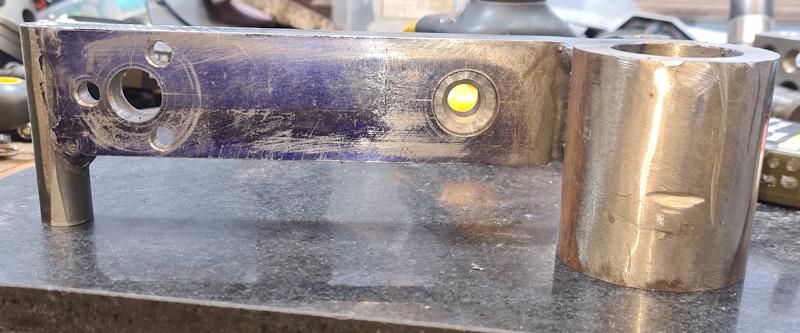

Little bit of progress I have made the micrometer thimble with a M10x1 thread, needs marking up but that requires yet another project so it will have to do for now.
Not exactly sure about my idea for the rocker arm but its cooling down in the vice right now so I will clean it up tomorrow and see how it looks.

I'm thinking its not too bad not as pleasing to the eye as the cast ones but I cant see it will cause any problems, obviously it still needs the adjusting screw and if I can find a close match for the paint that will make it look better.

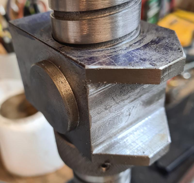

« Reply #3 on: February 09, 2025, 10:44:41 AM »

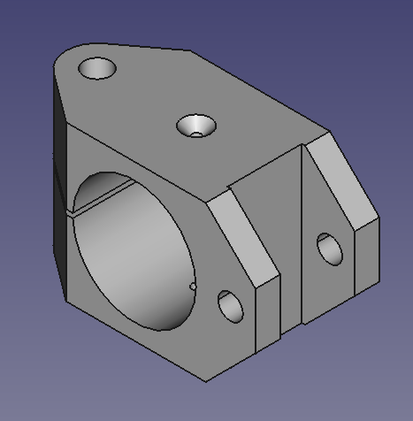

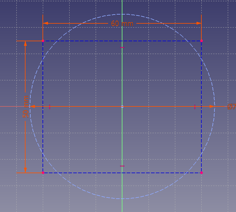

Made wheelhead height nut but I am dithering about how I make the wheelhead collar now. I really need a chuck of steel about 60x50x80 but dont have anything close. The options I have with the available materials are A)Weld some bits together to make a bit I can machine to shape or B)I have a scrapped 70mm shaft at work which I can cut off 80+mm and machine to size with some big rounded chamfers left over. Option B seems the best one to me as the 60mm can be altered to leave less of a chamfer not that it woud effect anything anyway.

« Reply #4 on: February 09, 2025, 11:20:42 AM »
B it is. A little cad work let me work out I can do this part quite easily, a little extra machining I guess but nothing I cant manage.
I think it looks just as good fabricated and machined. Looking good in general!  :thumbup: :clap:

« Reply #6 on: February 15, 2025, 09:00:08 AM »

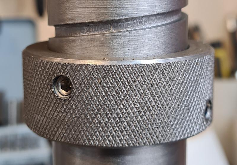

Getting on with the collar which required a few dubious setups on the lathe (my homemade milling machine is not really man enough for the jobs) I think I am going to take some more material off the back so I can use my slittling saw. As you can see in the second pic I can remove about 8mm.

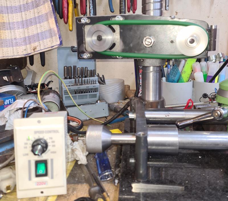

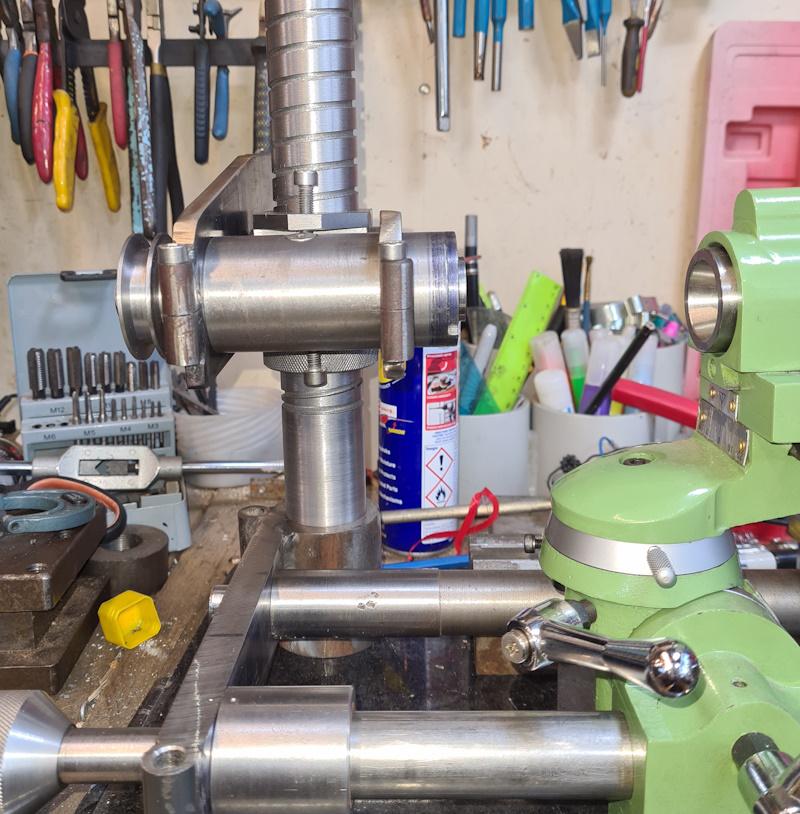

I am moving on to the motor and spindle now and if I had planned ahead I could have saved a little work because it can be used pretty much anywhere and I could have used it for making the helical groove on the upright. However I decided I am going to use the motor and spindle (with some mods) from my toolpost milling attachment. For this I am going relatively close to the plans in the quorn book, I have purchased the angular contact bearings and am even copying the labyrinth seal arrangment. I ground a cheap boring bar to make the trepanning tool, I have included an image but it's not brilliant. In the next image you can see why I needed a right angle trepanning tool and the results of it and the final image is just the modified spindle body.

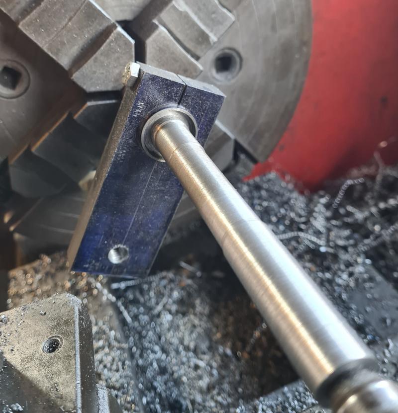

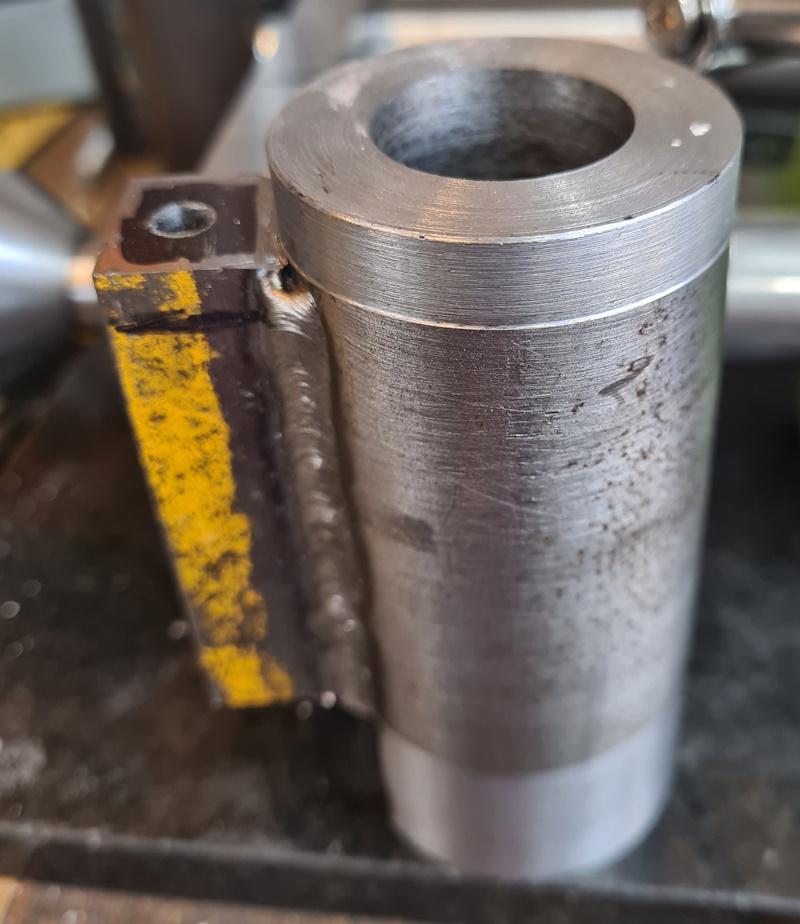

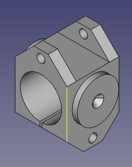

Trying to follow here shipto, but admit I'm not quite sure what photos 2 and 3 are of. Photo 1 is a tool bit for sure. Well 3 looks like a spindle housing, not sure if the trepanning tool was used on the outside top and bottom... guessing so. I imagine the inside was done with a boring bar.
Photo 2 --- is the spinning shaft and blued arm the trepanning tool itself? Does the tool bit go in the threaded hole? Are they being driven by the chuck? What are they working on?
Offline shipto
  • Posts: 867
  • Redditch, UK
Re: Quornish
« Reply #9 on: February 22, 2025, 02:10:57 PM »
Sorry was part way through posting and my mate turned up for a coffee so lost my thread a bit.  :lol:
Pic2 is indeed the shaft turning between centres and the blued bit is the drive dog I made to turn it. The trepanning tool was used to cut the recess close to the drive dog and the threaded hole has a 10mm bolt sticking out of the back being pushed around by one of the jaws of the chuck.
Pic3 just shows the modified spindle body which was used in my toolpost milling attachment (different thread).

Oh I get it! So the trepanning tool bit was in the regular lathe toolholder, working end-on. And the blued arm is just a driving dog. Got it!  :beer:
Offline shipto
  • Posts: 867
  • Redditch, UK
Re: Quornish
« Reply #11 on: February 22, 2025, 04:41:05 PM »
:thumbup: You got it. Needed the right angled trepanning tool because of the drive dog and the tailstock getting in the way.

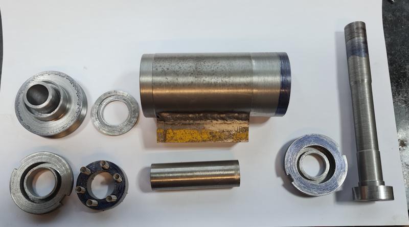

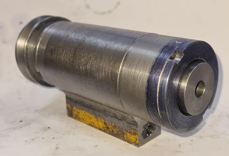

I have most of the bits done for the spindle but have to figure out a few things.
first I have to make a nut with tooling thats too big, I am thinking of grinding down a old tap to make a tool small enough.
Then I have to put a 3mm keyway in the pulley again without the needed tools, This may become a side project.
Lastly I am struggling to work out how these labrynth seals actually stop grease or oil escaping and would love an explanation if anyone has one and on that note the drawing in the quorn book shows a countersunk bolt in the middle of the spindle housing which I assume is for adding oil occasionally as I cant see any other need for it.

Obstacles overcome, spindle together and running totally free.
Next step will be the plates to mount it.

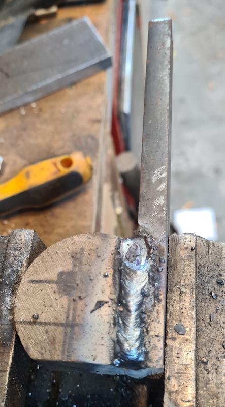

Confession time I made a mistake. When making the two base pieces I welded the upright mounting place on the wrong side of the bar stock which became apparent when I started to line things up. So I had to grind the bits apart and reweld them and I think I have got away with it everything seems to line up still at least.
