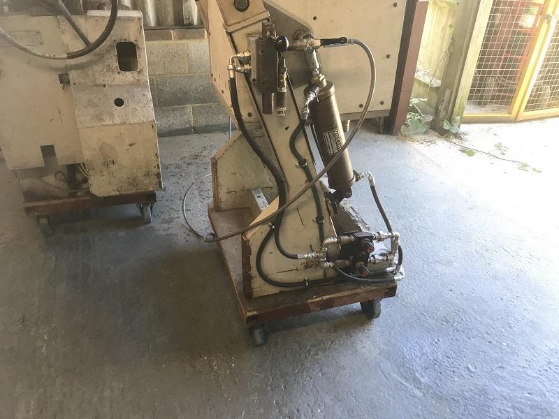

Matthew I think that you are entirely correct - diesel HAS to have some lubricity otherwise the injector pump would sieze up, and this is why 'certain travelling folk' add oil to stolen central heating oils as it's "slipperyness" is much less.
Pekka, the oil 'should' remain at ambient temperatures when in use (barring disasters  :bugeye:) so it's viscosity isn't going to decrease sadly. All my farming equipment uses ISO32 as it's rare that we get very hot here.
This morning I drained down the oil / red diesel mixture and re-filled with neat red diesel. Timing the rise (pour time)  it is now at 18 seconds which is about acceptable but I'd still prefer to be able to set it a bit faster.
Obviously this is as fast as I'm going to get without either:
a/ Raising system pressure (a pain as it uses my air distribution system common to many machines)
b/ Increasing hose bore
c/ Finding an incompressable medium more fluid than Red Diesel (unlikely)

« Reply #477 on: July 29, 2020, 10:33:00 AM »
Yes it has all sorts of ramifications Pekka. For instance the exhaust port silencer now puts out quite a bit of diesel vapour as the cylinders are discharged, so much so that I've put a plastic cup under it to catch the drips.
Obviously is not viable when actually pouring molten metals instead of testing. I am tempted to go back to 'straight air' and drain the reservoir again. I originally went to 'air over oil' as  I was getting rather too much bounce with just air, but maybe if I throttle it back it'll be OK? -
. . . I'll experiment if time permits tomorrow.

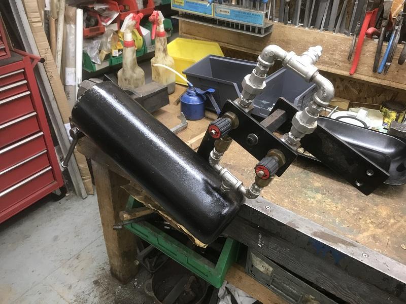

« Reply #479 on: July 29, 2020, 12:10:08 PM »
Air tends to be bouncier than incompressive liquid...I understand the merit of the air-over-liquid, liquid throttless nicer.
I wonder if a simple viscous damper would work in addition of the orginal air system? But it involves additional mounting poins, a little calculation and experiment. Also it probably does not not work equally well with min/max loads.
I never used waterbased hydraulics...apparently algae growth is a problen there, glycol coolat based might work, but that one too needs special seals. I would use the original system with air and add separate damper cylinder with liquid throttling or viscous damper.
We used once a system that had two hydraulic cylinders to perform same "swing" because the weight sifted "over the centre" of the gravity. Simplest form was to laod one cylinder (one side) with a constat pressure to prevent load from sifting direction at the middle of the stroke (that would produce a major jolt). There are load lowering valves etc...but each solution has it's own set of problems.
I have seen very well dampened pneumatic systems, but they had servos....

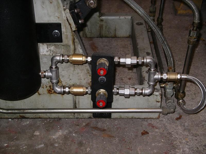

« Reply #480 on: July 29, 2020, 01:28:47 PM »
Dnot wishing to teach grany etc. etc.
 If operating speed is an issue whether pneumatic or hydraulic, cant you use speed restrictors to increase the operating time?
John, If you look 'up thread' you'll see that I have two one way valves (up & down) each followed by a flow restrictor

« Reply #482 on: July 29, 2020, 02:01:15 PM »
Ahh...sorry Andrew, missed that bit... :Doh:
« Reply #483 on: July 30, 2020, 05:13:38 AM »
Pay attention John  :lol:

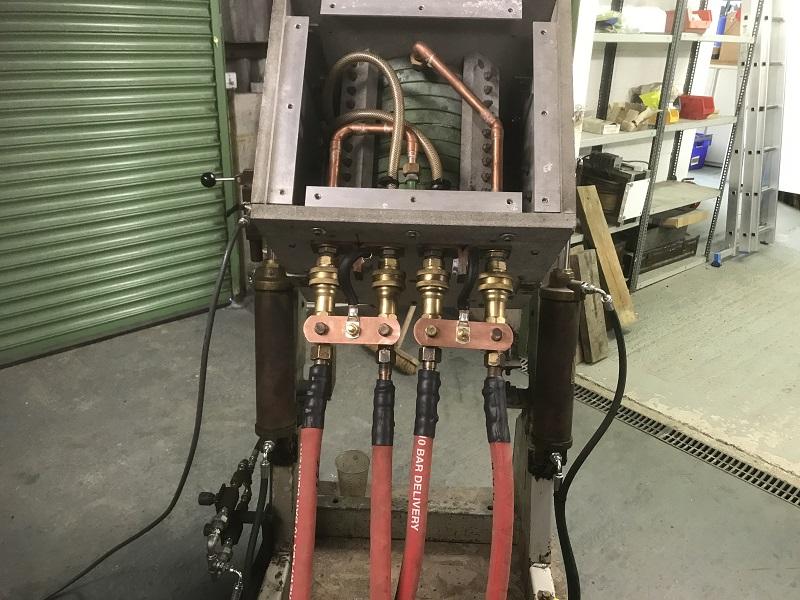

So I decided to revert to 'air only' tilting on the Raydyne furnace body as originally designed. I wasn't happy having the oil fumes in close proximity to the molten metal and the speed of tilting was a bit slow. It definitely was less bouncy, but at an unacceptable price in terms of other parameters.
I could put the oil system back relatively easily, but to plumb for 'air only' necessitated physically removing the reservoir (a cut down CO2 cylinder!) as the plumbing for the flow restrictors was screwed into a tapping in the cylinder wall. Just one pipe to remove and a somewhat longer one to make and it's done.
With the restrictors set full bore it now raises in 4 seconds and comes crashing down - just cracking them open gives about a 10 second rise and probably I could extend that a bit with careful setting of the valve. There is no longer a delay in raising the crucible, as that previously was caused by it taking time to pressurise the air over the oil in the  reservoir.
It'll take a while for the remains of the oil / diesel mix to flush out of the pipes and cylinders - already afer only a few cycles the exhaust 'air' is getting a lot cleaner and less fumy.

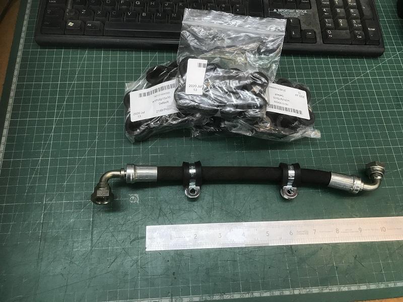

Meanwhile the more suitable pipe clips have arrived so I'll try and fit those today - not sure my back is up to all the bending down so I may try raising it to waist level with the forklift.

I managed to clamp the hoses - I can't say I'm over happy with the way they lay - flipping awkward stiff things !

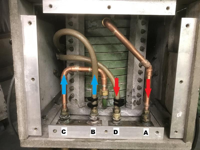

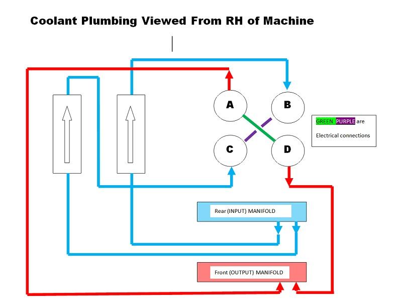

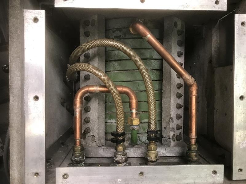

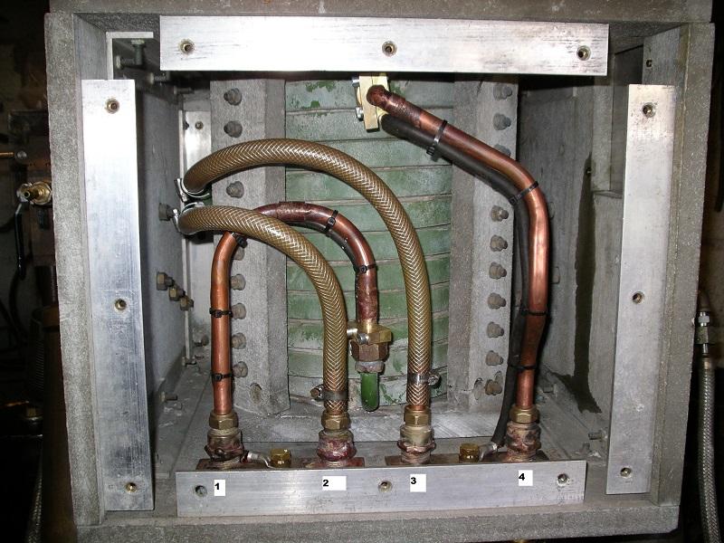

Gentlemen (and Ladies if present!)  I have a dilemma  :bugeye:
I've been wanting to power up the Radyne and use it, but at the moment I'm completely confused as to it's connections. I'm SURE that I used it previously after installing the new crucible, but the way it's internal plumbing is illustrated in the picture below it CANNOT have worked I think.
I had expected the terminals to map A, B, C, D from left to right and indeed on one photo the extreme right hand pipe has a D on it
As the photo clearly shows, Terminals 1 & 2 are connected ELECTRICALLY as are Terminals 3 & 4 - you can see the blooming great copper horizontal strap between them.
Now the actual induction coil  has a deliberate blockage where the nylon reinforced hoses from Terminals 2 & 3 come together.
So coolant entering 1 can ONLY exit by 2 (and vice versa) and coolant entering by 4 can ONLY exit by 3 (and vice versa)
BUT the electrically commoned terminals on the furnace driver are pairs "A & D" and  "B & C" with coolant flowing out of "B & C" and returning on "A & D"
So if "A & C" on the driver map to  "1 & 4" so that the top and bottom of the induction coil are connected correctly coolant has to come out of  "2 & 3"
On the tilting furnace body the terminals that are commoned at it's end correspond to the commoned ones at the furnace driver.
If I screw this up it could be curtains for the driver electronics  :bugeye:
So if any of you have been able to follow my confused ramblings - please go logically through this and tell me where I've gone wrong - or have I gone wrong - or did I plumb it up wrongly back in 2006 ? (I can see that if I swapped over the two internal nylon reinforced hoses within the Raydyne it might make more sense :scratch:)
. . . my head hurts . . . .

« Reply #487 on: August 01, 2020, 05:43:29 AM »
So in the absence of other suggestions, this morning I opened up the back of the Radyne Tilter, and lo and behold it seems that I'd done a second re-plumbing eliminating the welding cable current reinforcement by using heavier walled pipe. (It looks like I've used 3/4" air con pipe tailed with 15 mm) However the issue remains in that if connected up it would put a direct electrical short across the Furnace Driver - not good.
I 'think' by interchanging the nylon reinforced pipes I have a solution that 'should' work - certainly now no direct short across the driver !
I was able just to uncouple the threaded fittings and move the pipes, but I'm not happy with their lengths as they are touching the copper driver pipes, but I'm out of stock of 15 mm bore nylon pipe - they'll do for test purposes until I can get some more.
So now "A & D" are electrically commoned at both the Driver and Crucible ends, as are "B & C" but the order of connections on the base of the furnace body are a bit illogical reading "C B D A" left to right

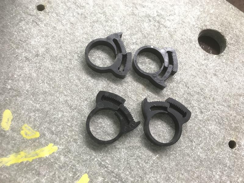

I do remember having standard metal Jubilee Clips getting hot in the field of the coil and melting pipes and sure enough the ones on the outer connections of the nylon hoses are nylon clips to avoid this problem, but oddly the ones on the other end of these pipes are standard metal ones

Hi Andrew
I'd just spent 10 minutes trying to understand this when you posted your latest update.  I think I agree with where you've got to.  Clearly the electrical connections have to take priority and that means the piping wouldn't have worked unless there was something strange going on at the connections on the side of the coil.  The other variable I was trying to get my head around was whether there was any significance to the direction of coolant flow - for example to keep the nylon pipes cooler than the copper ones - but I would hope that they would be kept sufficiently cool for that not to be a problem.
« Reply #489 on: August 01, 2020, 06:23:13 AM »
Russell, now you see why my head hurt - thanks for your ten minutes - much appreciated !!!

Much search for 15 mm bore nylon reinforced pipe so far has drawn a blank. 13 mm no problem. 16 mm no problem. 15 mm no sign  :bang:
I am conscious that access to the centre connections on the coil is severely limited so struggling a pipe on would be an issue - the other end access is easy so no problem.

Andrew,
If your object was to give us head aches, you  succeeded! I couldn't see it from your explanation and diagram! Seems to me to be break out the ohm meter time! Good luck with the hoses! It's so near now!

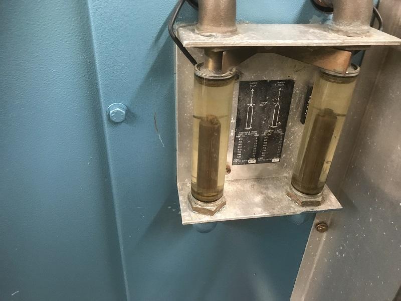

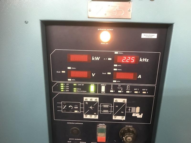

« Reply #496 on: August 02, 2020, 04:34:57 AM »
No point in procrastinating any further - get it connected up and try it !
. . . . so I did, but firstly I connected up the low power local mains feed - can't really start the big generator as the cottages are full of guests - and made sure all was working on the inverting furnace body before disconnecting it. Yes - all OK - so I removed the four hose / cable assemblies. Proved continuity where it should be, and connected up the Tilting body.
First test - does the coolant flow? Argh - NO  :bang: Oh heck NOW what's up? Intensive investigation and what do I find - those pair of flexible pipes that go to the centre of the coil do a little jig round the back and come out REVERSED ! So what appears to be the top of the lower half of the coil is in fact the bottom of the upper coil, and vice versa. So Russell you pretty well put your finger on the problem in you post where you said "unless there was something strange going on at the connections on the side of the coil".
This has been the issue all along - the pipes I moved were in fact in the correct places - there WASN'T a problem - it was actually correct in the first place.
OK, get over it, swap the pipes back, prove coolant flow - YES flowing in both circuits.
So, next test - put (low) power on the driver, let it come ready - yes it does - 'ping' the furnace body - whoopee yes we get a good result at 2.25 kHz - as expected a lower frequency than the other body as this one is a physically bigger coil so presumably markedly different inductance.
Now until I can get the place to myself and hence fire up the big generator that's about as far as I can go for the time being apart from tidying up and sorting out the safety shields etc for the pipe / cable assemblies.
. . . phew it seems to be working . . . thank goodness . . . it took long enough !
