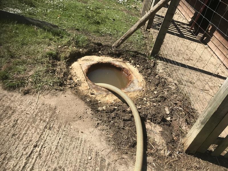

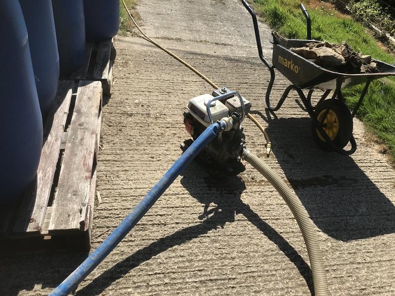

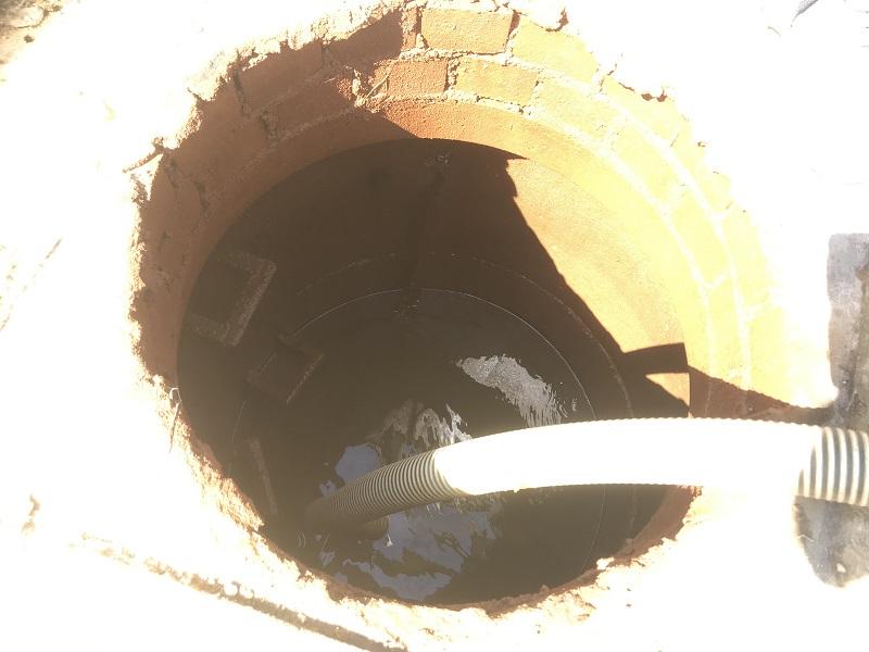

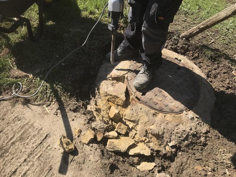

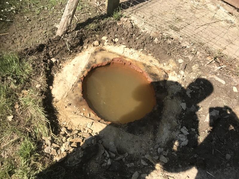

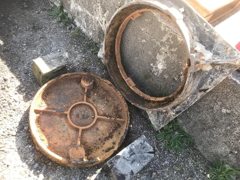

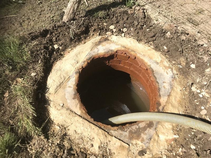

Today I managed to open up the Bore Hole  :thumbup:
My friend Andy came with his big Kango clone and in a matter of 20 minutes freed the man hole cover frame from it's flaunching. Whoever did it originally used soft sand (should be sharp sand) so it came away remarkably easily having been given a seeing to with the breaker.
I slid the forks of the fork lift truck under the assembly and carried it away for dealing with at a later time - it's a blooming heavy lump of iron !
So this exposed a 24" pool of water - again I slid my fibreglass duct pulling rod down it and it went down to 174 foot  :bugeye:

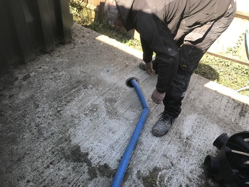

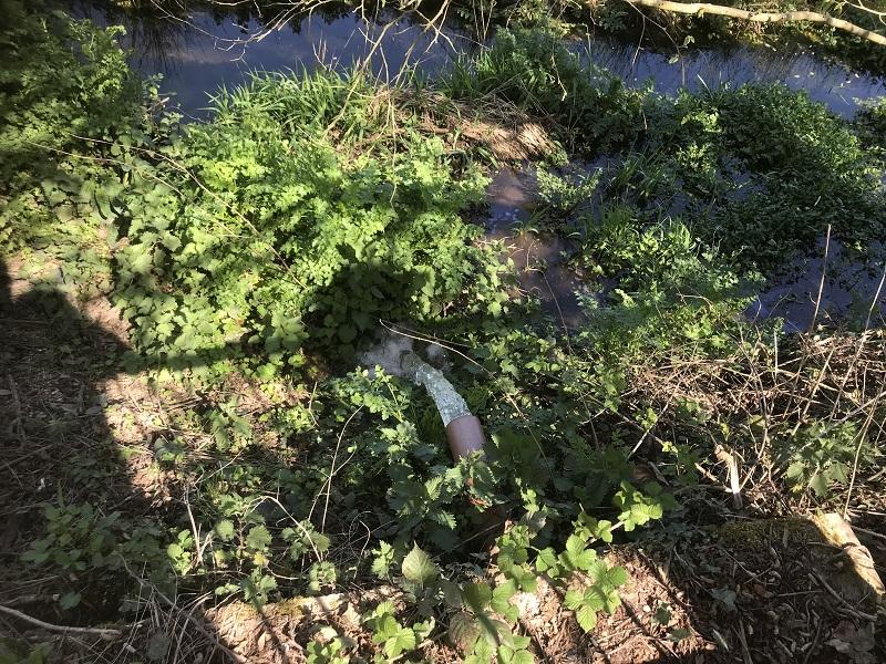

I rigged up my petrol 2" water pump, with a foot valve and rigid pipe into the bore hole, and flat pipe out to a reasonably convenient 'rodding eye' on my roof and surface drain network that leads about 60 metres to the stream. Starting the pump water fairly gushed out down at stream level and the bore hole level started falling.
As the level went down, man steps were revealed set into the side of the bore hole - it's a brave man that goes down those  :bugeye:
It was my intention to carry on pumping until I got to the limit of the suction hose to see what was revealed, but at this point the engine died on the pump - would briefly start on choke but immediately dies. So pumping operations had to cease until I find the pump problem.
A quick tidy up and a temporary cover put over the hole was enough excitement for one day  :clap:
(Pete. will recognise the cover  :thumbup: )

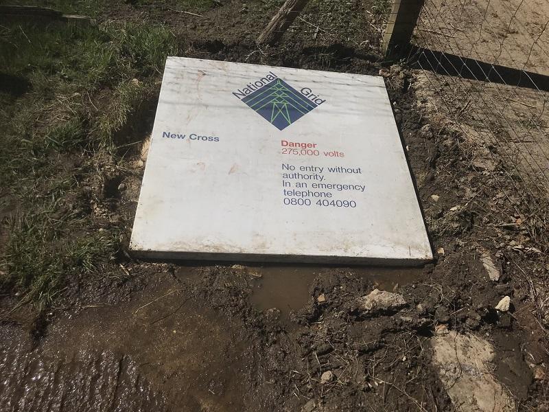

The only living boy in New Cross eh? Is this a sign (see what I did there) of a misspent youth robbing sub stations and knocking off policemans helmets? I used to have one from Reading Rock festival (1978) that said "No glass in the arena please" It was a good fit on the floor of the transit van, and covered the ribs to give us a much more confortable, and warm area to sit on the way back! I think I eventually sliced it up for under bench shelving!

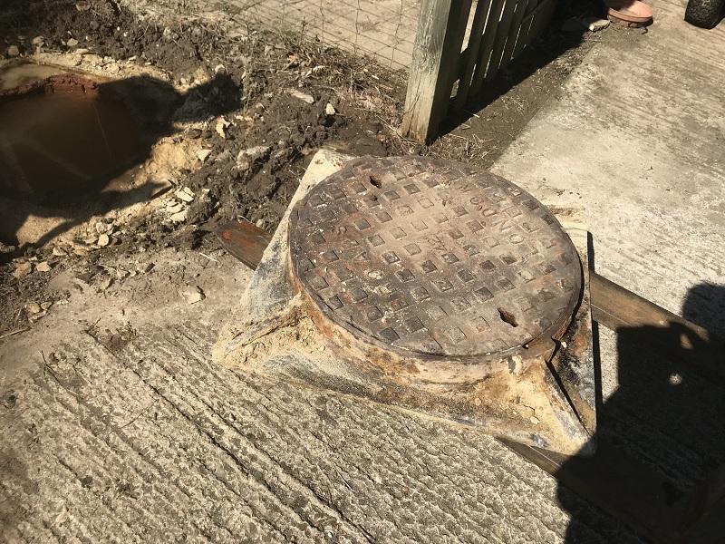

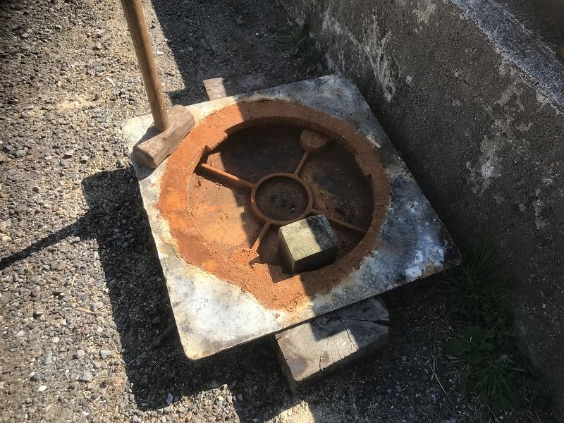

« Reply #167 on: April 20, 2020, 10:07:49 AM »
Sussex Phil not Suffolk - miles apart ! (The rigid fibreglass duct rod bottomed out at 53 metres)
The sign was obtained during a legitimate demolition (I am assured!)
The really GOOD thing about it being still 174 deep is that that is well below where the records say perforated pipe was installed so hopefully water will still seep in at a perfectly adequate rate for my needs.

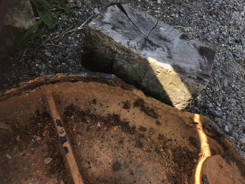

OK so man hole & cover now transportable by fork lift (I'm certainly not carrying them!!!!) so putting them in the rear farm yard balanced on two baulks of wood, and slogging the cover via a 14 lb sledge hammer and a third block of wood produced . . .
 . . . zilch - a splintered block of wood  :clap:

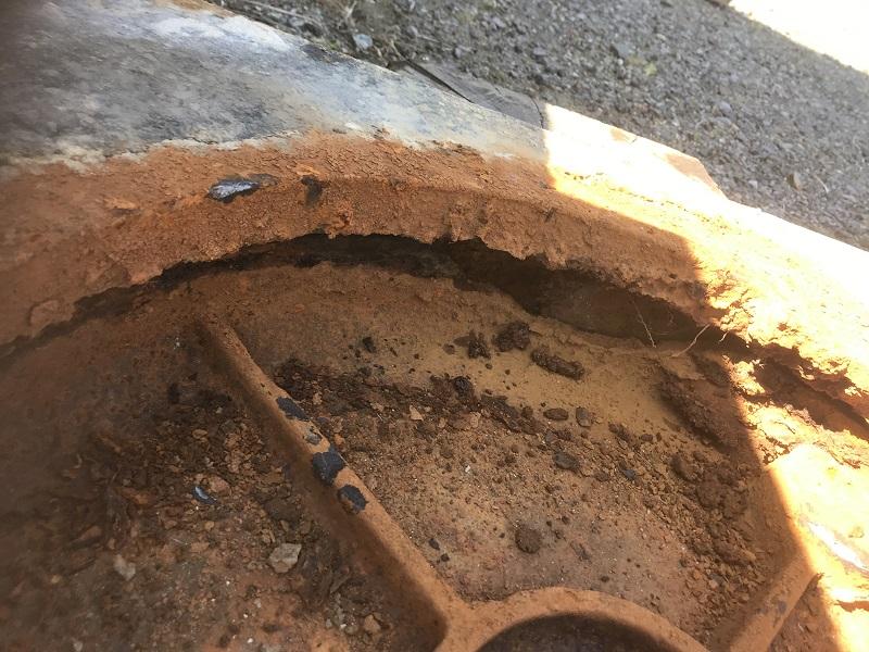

Resorting to 'metal on metal' I had a very stout go at the cover, working round it's periphery until eventually the sound changed and ever so slight movement was detected. A few more really meaningful thumps and the cover dropped out of the frame. No wonder it was jammed - some serious rust had accumulated. And note, there is some pre-existing damage on the vertical rim of the cover - obviously old from the rust on it and lack of the missing bit!
Frame and cover need a good sand blasting, but I have too many other things on at the moment, and anyway too many other peoples vehicles in the line of fire.
« Last Edit: April 20, 2020, 11:03:48 AM by awemawson »

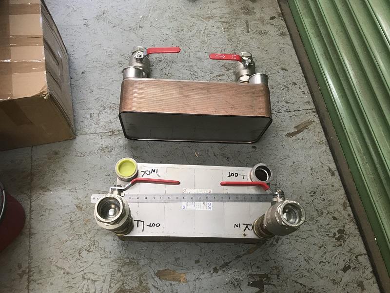

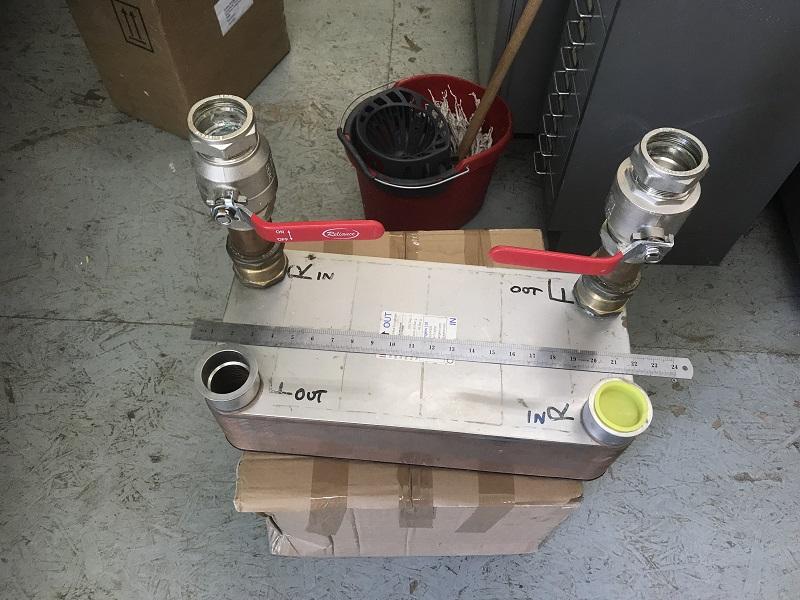

I think the cooling is getting sorted Pekka because . . . . .
I've been looking at heat exchangers that will isolate the furnace cooling water from the cold source water in the borehole. Many available on eBay, most seem to be Chinese, but many coming from Poland and Czech that also could be originally Chinese. Lots of amazing specifications, remarkable low prices and quality promises, and often with free delivery - but what spec do I need.
Well, in this application, erring on the large size is no disadvantage - I can't think over cooling the furnace water is an issue, and if it is I can easily throttle the cooling side feed water accordingly, so when a HUMONGOUS heat exchanger popped up on eBay, UK made, and brand new never commissioned it seemed too good an opportunity to pass up. Manufacturer was still in business, the H.E. was still a current 'off the shelf' model and the full specification was available and emailed to me - now could I win the auction  :scratch: Half the issue was that it was 'collect only' and the seller wasn't responding to my requests for contact to involve couriers.
OK auction was ending today at about 5 pm, so I put the item on Shiply  last night to get courier quotes, and then put a 'best offer' to the seller of the original starting price LESS my delivery quotes  :clap:
Surprise phone call this morning from the seller accepting my offer. Shiply courier happened to be close to the sellers location (Esher), promptly collected it and has just delivered it - well actually THEM as it turns out that there were two  :thumbup:
So what is it?  - it's a UKE BR205-50C 50 plate copper brazed heat exchanger intended for an air source heat pump. 54 mm soldered copper inlet ports and 2" BSP outlet ports. It weighs 34 kg ! and is 528 mm x 246 mm x  134 mm so I don't think there is any danger of it being under sized, and I have a spare  :thumbup:
So I still need to source a pump for the borehole, a tank for the furnace water reservoir (might come from the original chiller) and work out quite a bit of plumbing lay out with big pipes.
