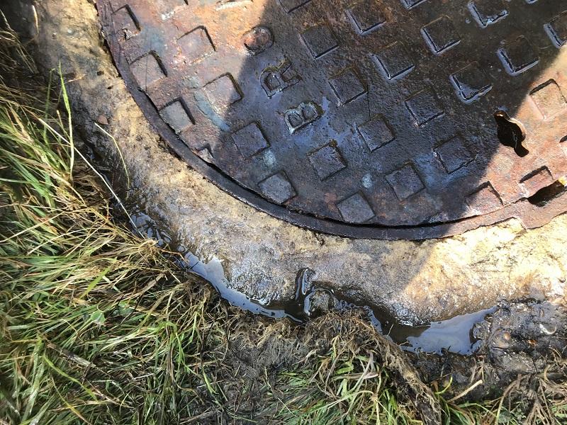

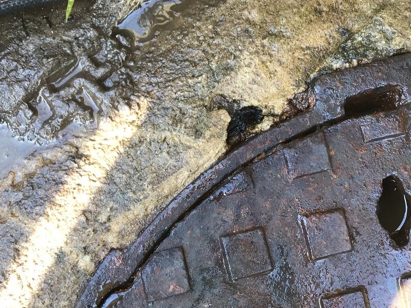

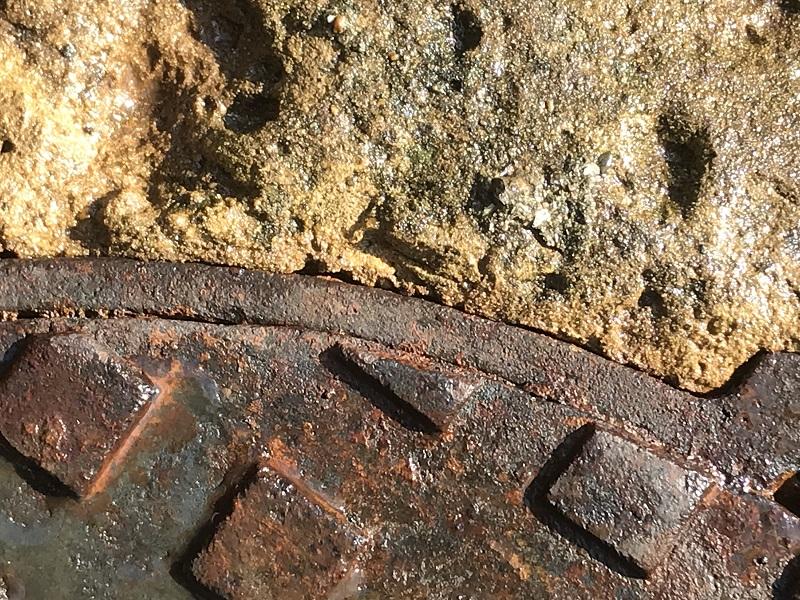

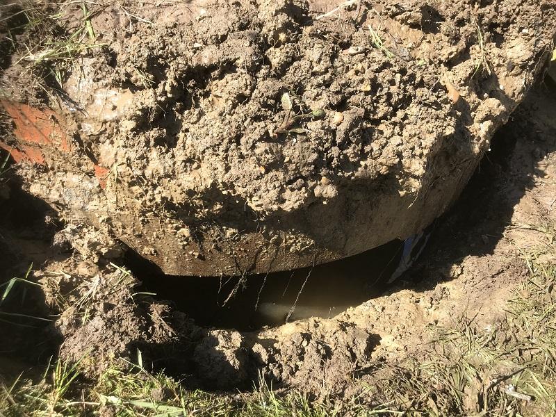

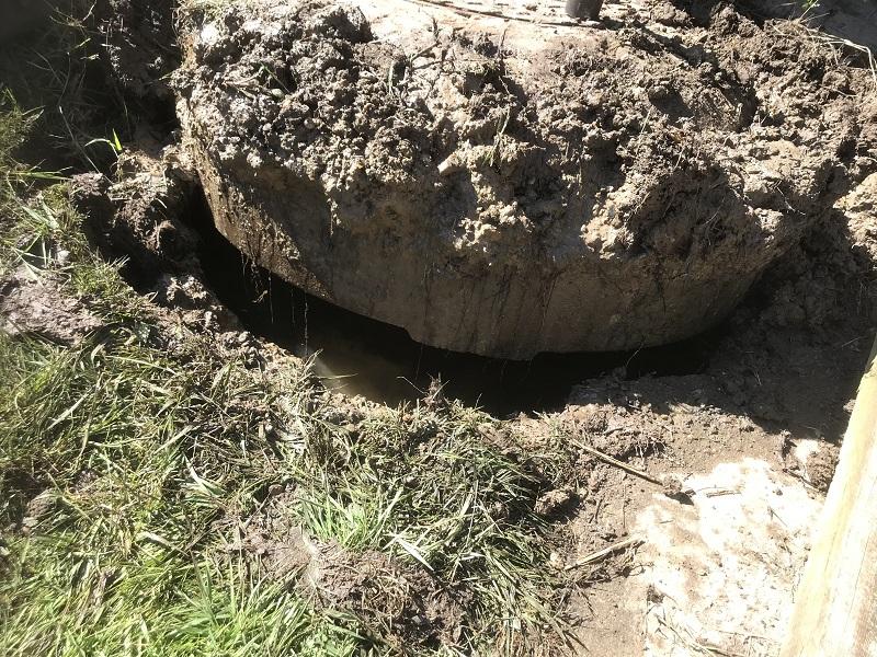

So with the finest (so highest pressure) nozzle fitted I gave the manhole cover an intensive session with the pressure washer. It was obviously doing 'something' as every now and again a great spurt of brown rusty water would came back at me in the face !
I blasted it vigorously for quite some time, then gave it more violence from the sledge hammer before again an intensive session with the pressure washer. Not easy to see what it's done with all the water about so I blew it off with an air gun.
As you can see from the pictures below the 'gap' is much more pronounced in some places but still totally jammed full in others - it MUST have helped I tell myself  :clap:

We Have A Borehole

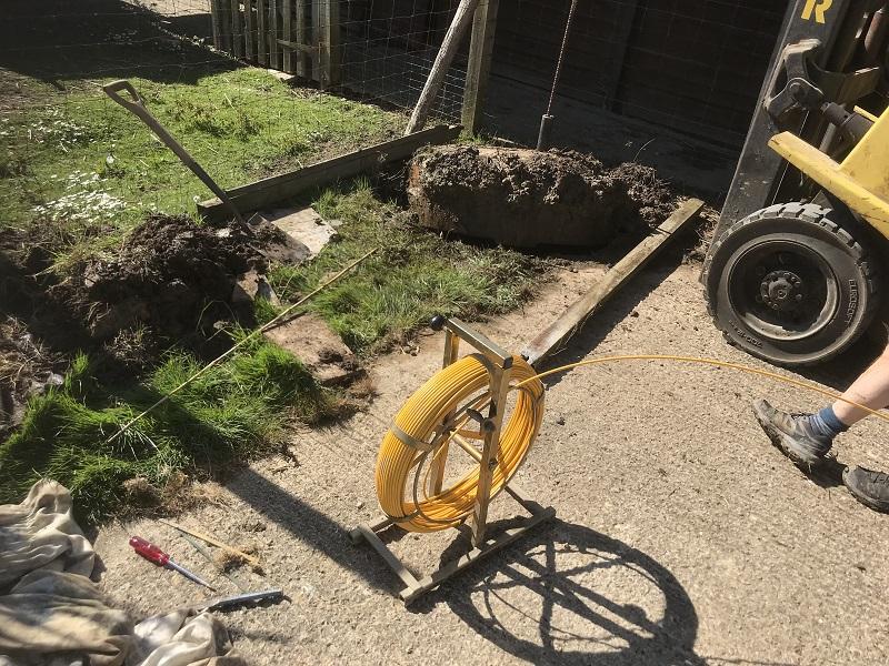

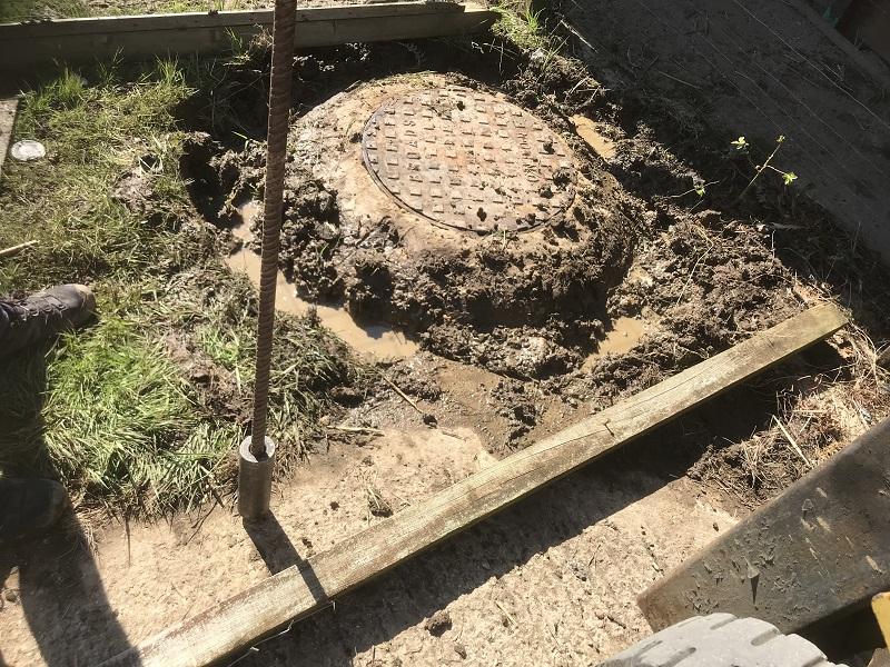

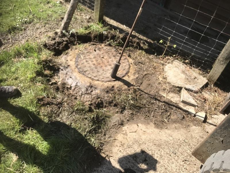

I made up my more substantial slide hammer, and even using it like a maniac for quite some time had no effect. In places I could get a hacksaw blade into the gap the full two inches of cover thickness, but elsewhere it would not go in at all - managed to clear a bit of debris using it but nothing substantial.
So I decided to use the slide hammer as an attachment and do a tentative lift with the Fork Lift to put tension on the cover - no lid movement what so ever, and continuing the entire massive concrete structure started lifting  :bugeye:
Clearing the turf away from round it, (to stop it falling into my nice water source!) I carried on lifting until a gap appeared showing WATER - lots of water !
Getting my cable drawing fibreglass duct rod, I tried pushing it down - there was a definite circular 'thing' in the centre under water - presumably a pipe, and I was able to push at least 20 maybe 25 metres down the hole before feeling any resistance. All this was at an odd angle as the concrete structure was balancing on one key (my slide hammer) off the fork lift.
Common sense told me to lower it back before there were any accidents  :clap:
So now I need to work out what's next  :scratch:

I've been tapping a 3" long strip of 1.2 mm  steel 15 mm wide gently into the gap - if you start where the gap is full depth (2") and work against the 'wall' of the next bit you can crumble bits of the rust / clay / mud until eventually you get another full depth bit, but by heck it's as tedious job. If only the Grand Children could come and stay - ideal pocket  money earner except for our current virus lock down !
Drilling the cover will be a last resort - most bore hole pumps seem to be 3" diameter - also I have absolutely no idea if the  lining pipe is in the centre of the circular lid, or well to one side, and it would be a shame to miss.
Remember that the underside of these covers are webbed like the under side of a surface plate so random holes can end up in unfortunate places un-knowingly  :clap:
