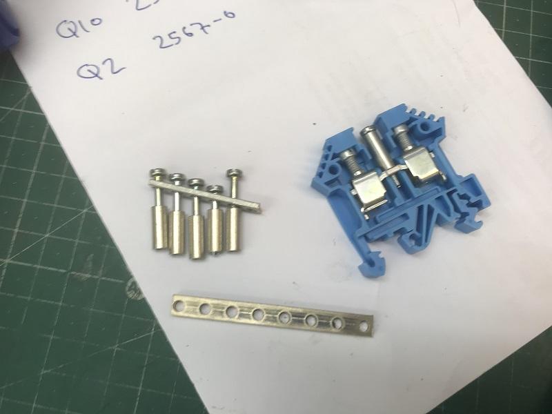

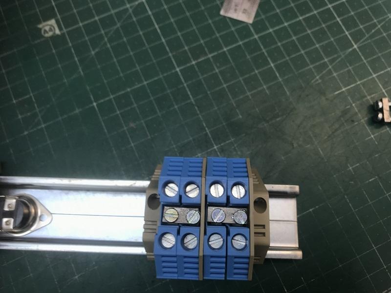

Today the plan was to measure the Temperature Sender Characteristic Curve to aid me designing a small circuit to trip at a set upper temperature (Overheat Shutdown)

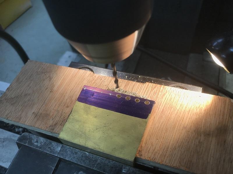

But first I needed to source some 'Jumper Bars' for my DIN terminals - these things are simply a copper bar with holes at a suitable spacing that when installed parallel up adjacent DIN terminal blocks. I'd ordered some up from RSComponents with the terminal block, and despite being listed as correct for these 8 mm wide 6-10 mm csa cable terminal blocks they were in fact the wrong spacing :bang:
I've had a 'technical query' logged with their help desk since Monday trying to source the correct part, and yesterday they came back with a manufacturers part number but they don't stock them  :bang: And nor does anyone else in the UK unless you want to buy 500 off !!! (I only need four 'two hole' lengths!)
OK change of plan for the day - MAKE SOME. No copper strip to hand, but slightly thicker brass should suffice sliced off a bit of chunky angle that was in the scrap box. No great problem, drill a row of  holes spaced at 8 mm, slice them of on the band saw, cut them into 'two hole' lengths, clean them up and tin them.
Using the screws and spacer collars from the 'wrong' ones proved the collars to be too long - so all had to be cut down to 8 mm l.o.a. Altogether not a complicated job but very fiddly and time consuming.
. . . got there in the end !

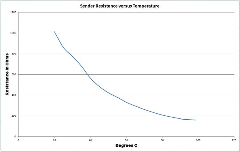

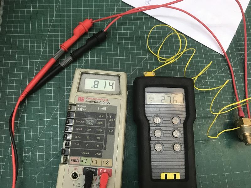

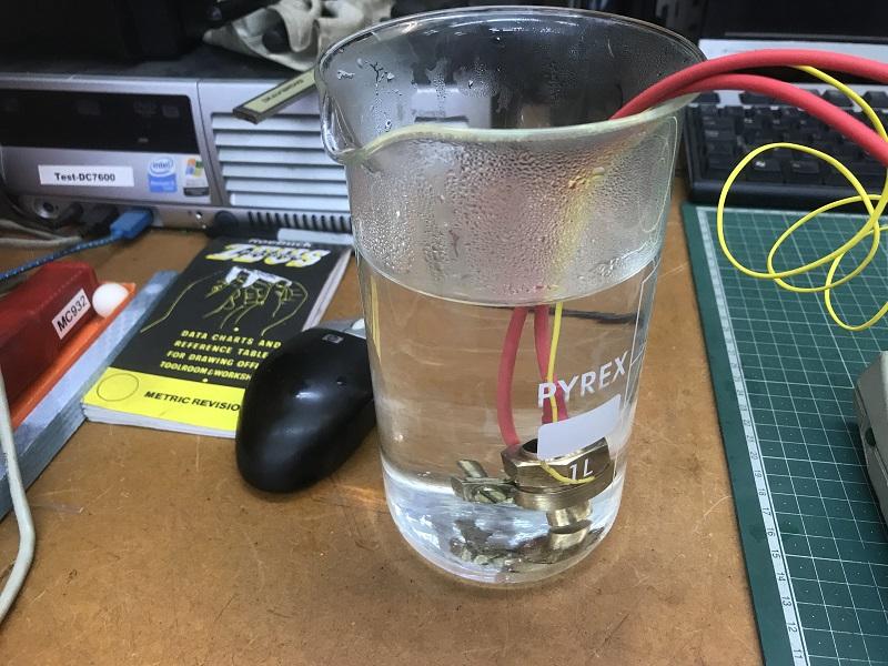

I attached the Temperature sender to a 'Type K'  thermo-couple with a hose clip, and wired it to my Comark temperature meter and Fluke V.O.M. on ohms. Firstly I dipped the assembly in a boiling kettle getting 160 ohm and 98.7 degrees Centigrade (It was only later that I noticed that the Comark battery needed changing, but for my purposes this IS OK)
Then I transferred the assembly into a Pyrex flask, poured in the almost boiling water from the kettle, and sat down to plot a 'cooling curve' - this way hopefully the sensor temperature will be a true analogue of it's installed state.
Then I plotted the figures in Excel producing the attached chart.

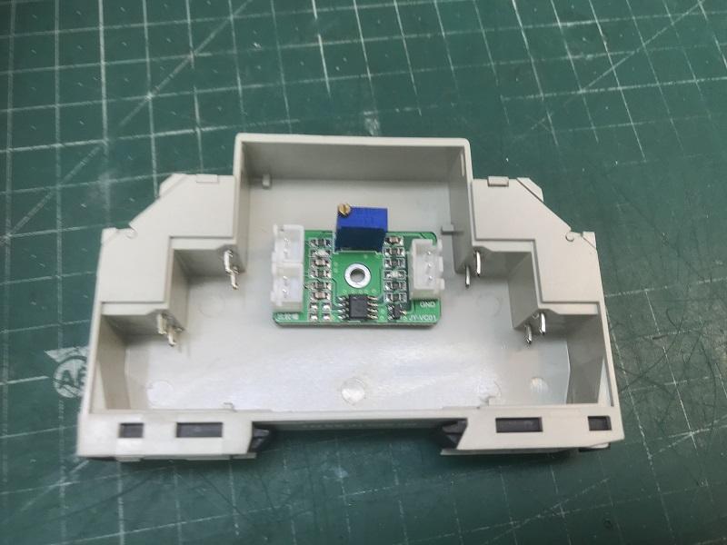

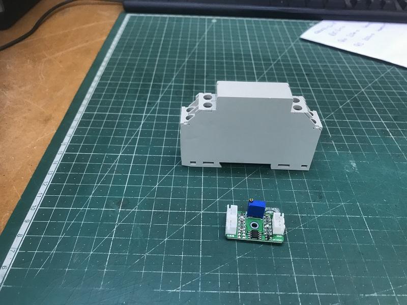

I've decided to use an LM393 comparator chip and it turns out that eBay abounds with them conveniently mounted on a PCB with a 'set point' twiddle pot. I am going to mount one of these circuits inside a DIN module case along with a miniature relay to give me a closed contact on 'overheat' - the twiddle pot on the PCB will be replaced by another glued in the DIN module case and accessible through a hole for setting.

Have you considered the case of an open circuit...? Your detector triggers on a rise in temperature wich correlates with a fall in Ohms....
If you have a wire break then it wont trigger?
The relay wont close and no shutdown....
Better to have a function that is failsafe? Ok we're not talking SIL levels here but some protection is better than none?
Re: Puma / Dorman 6LE / MacFarlane B46B / 110 kVA Generator Resurrection
« Reply #110 on: October 17, 2019, 04:34:13 PM »
It's a point to consider but it doesn't overly concern me considering the intermittent use this is going to see occasionally driving my induction furnace for maybe an hour or so.
Without managing to source a suitable sensor with a curve opposite to this one I don't really see any other option, and this one was the only one I could find on the correct 'root stock' ie 1/2" BSP. My preference would have been an on/off switch operating at about 100 deg C - this would have avoided all the faffing about with electronics, but I couldn't find a suitable  one!
I could get really fancy and use another controller input to sense that the sensor is passing current but that is getting over complicated even for me

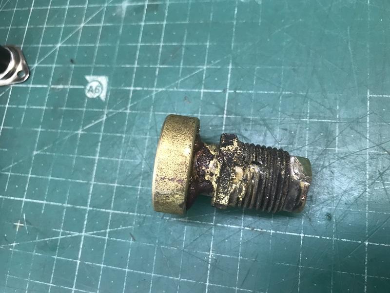

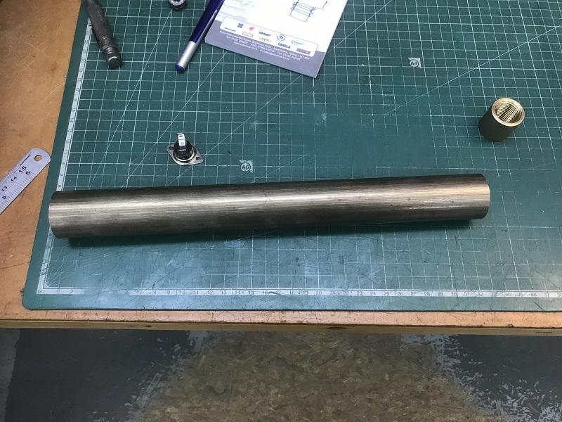

« Reply #112 on: October 18, 2019, 10:11:56 AM »
Russell thanks for the links - yes I admit I'd found one or two at very silly prices!

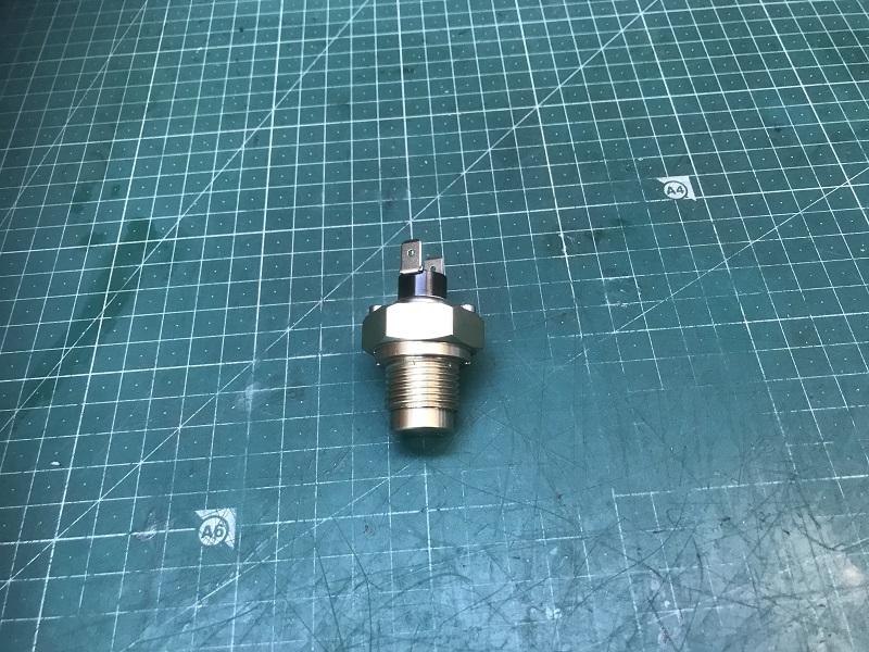

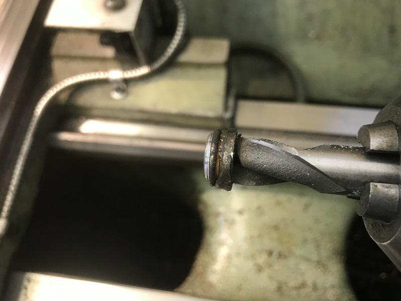

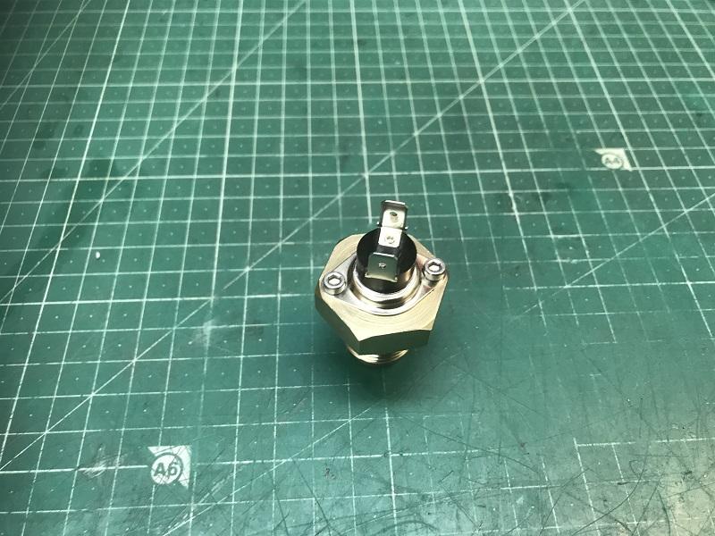

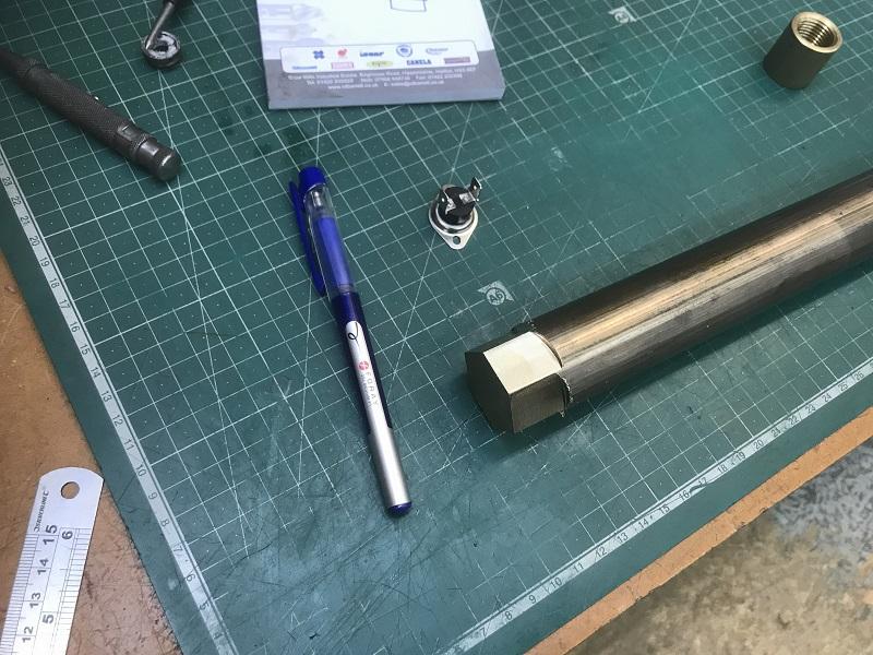

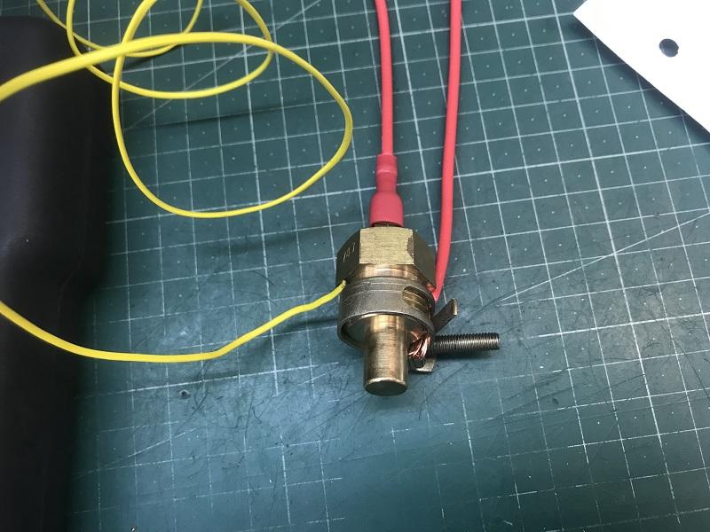

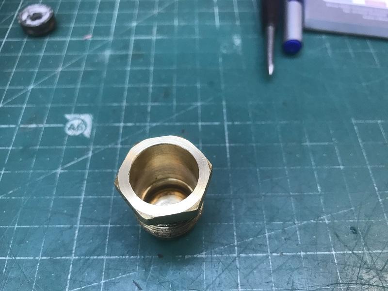

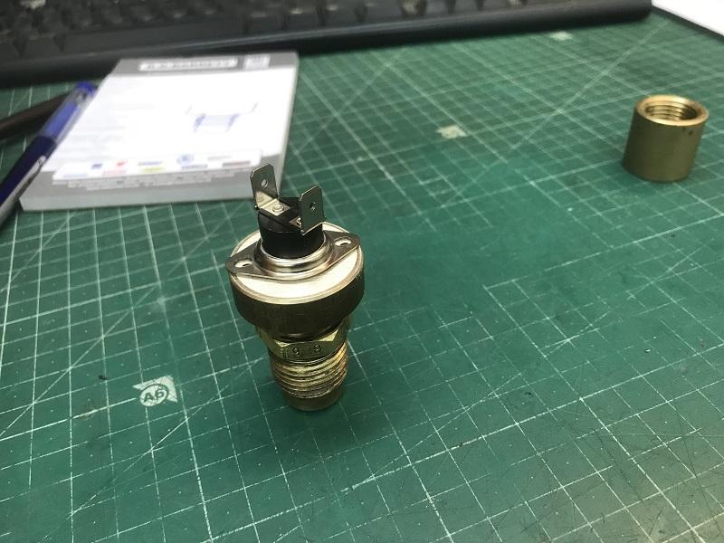

John's comments set me thinking - I'd thought that the Deep Sea controller would only take a closed contact as an error signal, but closer reading of the manual, if I'm interpreting it correctly, is that the error state can be defined as open or closed, the open obviously being safer as John points out.
Now over temperature switches intended for surface mounting are readily available - in deed I've just bought a 70 deg C one to put in the relay box to cut off the fuel and starter relay feeds in case of fire. If I could somehow use the body of the original sensor to mount one of these all would be well.

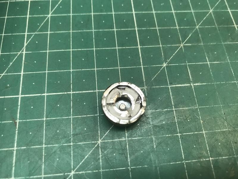

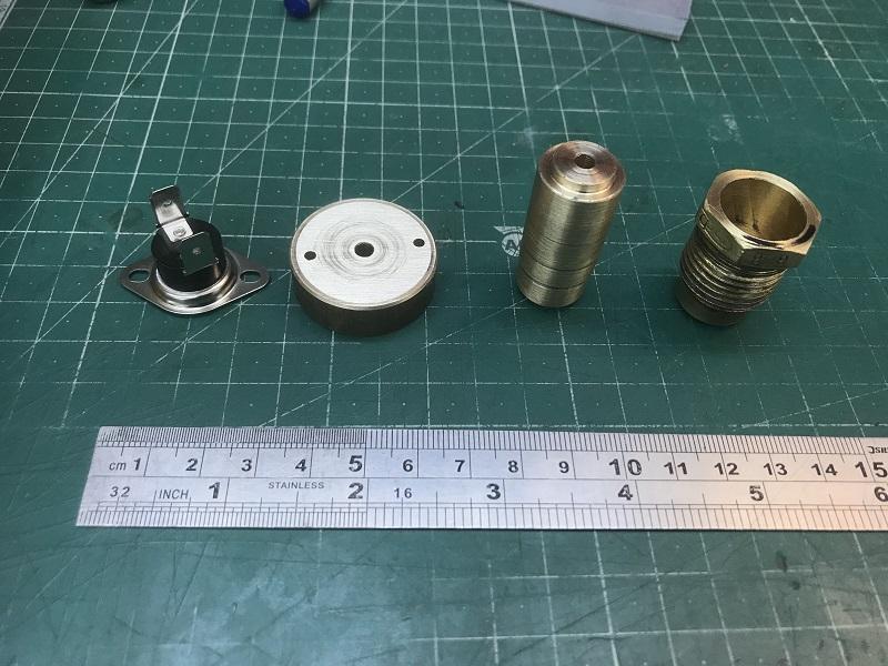

I decided to eviscerate the device - I used an old 1/2" end mill naughtily in the tail stock chuck, and chomped out all the filling gunge and eventually the sensor itself emerged on the end of the end mill!.
Then I turned a slug of brass to fit inside, along with a platform to fit on top to take the actual switch - all a bit crude but it should work.
Then ONCE MORE ! I managed to melt it all while brazing it together. I've run out of proper silver solder and have been using Harris Phoson which has a melting point of  732 to 815 degrees C which is obviously too high for the brasses that I've been using. (It's excellent with copper and needs no flux - beloved of the Heating and Ventilating Engineers!)
So - what to do? Well stop being so miserly, dig out that nice big bar of silicon bronze (I think) that's been in my stash for years, and make one from fresh.
So into the Beaver CNC mill to have a hex put on one end (just using the machine as a dividing head) then make the rest in the lathe. Came out OK - no brazing required so no more oops moments.
Now the switch is obviously not in the water but gets it's heat by conduction through the bronze bar which IS immersed in the cooling water, so there may be a degree or so difference actually at the switch, but these switches are available in a whole range of trip temperatures so if necessary I can put a 95 in rather than a 100 for example.

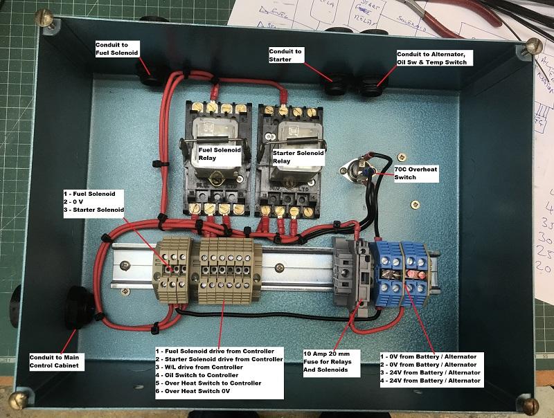

I spent today wiring up the relay box and documenting it. Far easier to do this on the bench than mounted on the machine down close to the floor, especially  with my varifocals!
It's a useful sub assembly that pre-determines various conduit runs, and as at long last I've found a source for metal conduit clips that are wide enough to drill out to mount on existing engine bolts (ordered but not arrived) I can soon get on with the wiring proper.
(I've printed and laminated a copy of the picture below to go in the box lid to avoid future head scratching)

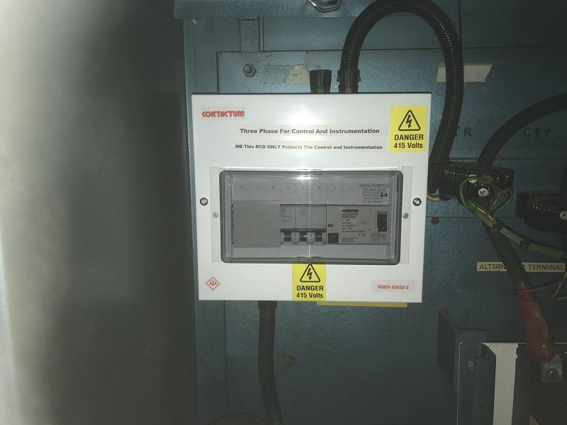

I mounted the mains cabinet tubular heater today, mainly to get it off the bench and out of the way !

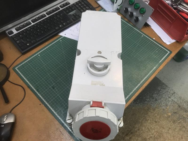

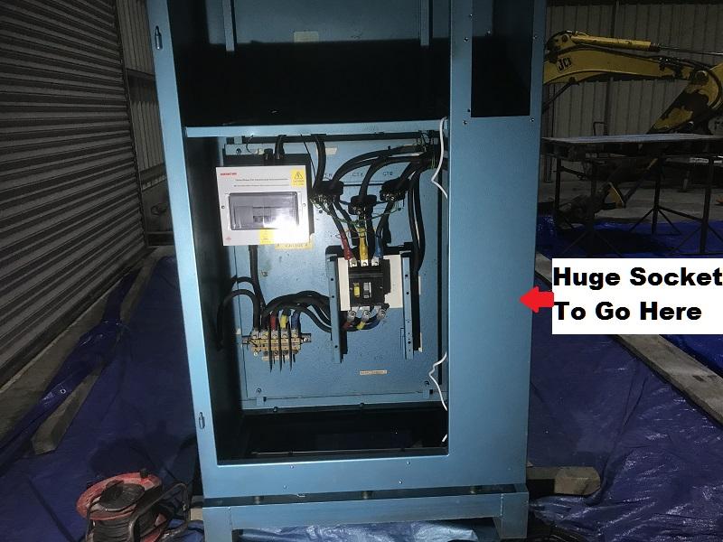

Meanwhile I'm giving consideration to how to get power OUT of this box of tricks. Simple I'd thought, just mount a 125 Amp 3 phase, neutral and earth 'Commando' socket on a panel by the terminal block. But it's not actually that simple, as then you can't close the door :bang:
Alternatives are to :
A/ mount a socket on the side of the main cabinet, but then it will be vulnerable being the widest part of the machine or
B/ Cut a hole in the door that exposes a suitably mounted socket that slightly protrudes when the door is closed or
C/ mount a socket on the door itself on flexible leads
Option A I think is bound to cause tears in the future as the machine is moved about. Option  C is neatest but at this sort of power level leads are not that flexible !
So at the moment I'm thinking option B but would very much welcome comments from anyone reading this.

I cant really add any ideas for power connections, 125Amps for a TPN socket is a bit wieldy....
As this is supposed to power the  furnace, why not hard wire the two....?
BUT, You should consider some protection relays for the genset.....Undervolts, overcurrent...etc..
Our 3.6 MW turbine sets were used in island mode ( there were two originally....) one duty one standby, and auto start....but one day someone decided to start a compressor ( a refrigeration system..)  that was driven by a 6.6kv motor rated at 2.1MW.....suffice to say, the load imposed on the genset caused the shearing of the pins on the shaft coupling as the motor tried to start....
« Reply #119 on: October 19, 2019, 01:35:58 PM »
John, under / over volt monitoring is no problem as the Deep Sea control has that built in and is just a case of setting the right parameter.
I'm not absolutely certain but I think that the output breaker by Merlin Gerin is set to trip at 150 amps. I need to investigate further.

Could you mount it behind the box, so it is accessible from the side, but recessed for protection?

Russ thanks for that idea, it’s certainly one to chew on.
Sorry to disappoint, but there’s little prospect of this thread fading out for a while yet (unless I do!) as there’s loads to do still  :clap:

I think I've solved the output socket location issue. So far I've been working with the door removed, and it didn't dawn on me that the door is not full width, there is a panel on the right of the door about 8 or 9 inches wide that is still exposed when the door is shut. Ideal place for a socket, but I realised really you want an isolator as disconnecting 125 amp connections without switching the load off makes BIG flashes ! But the main isolator is inside the door  :bang:
. . . never mind, looking at my stash of 125 amp plugs and sockets I discovered a humongous switched interlocked 125 amp unit that will just squeeze onto that panel !
