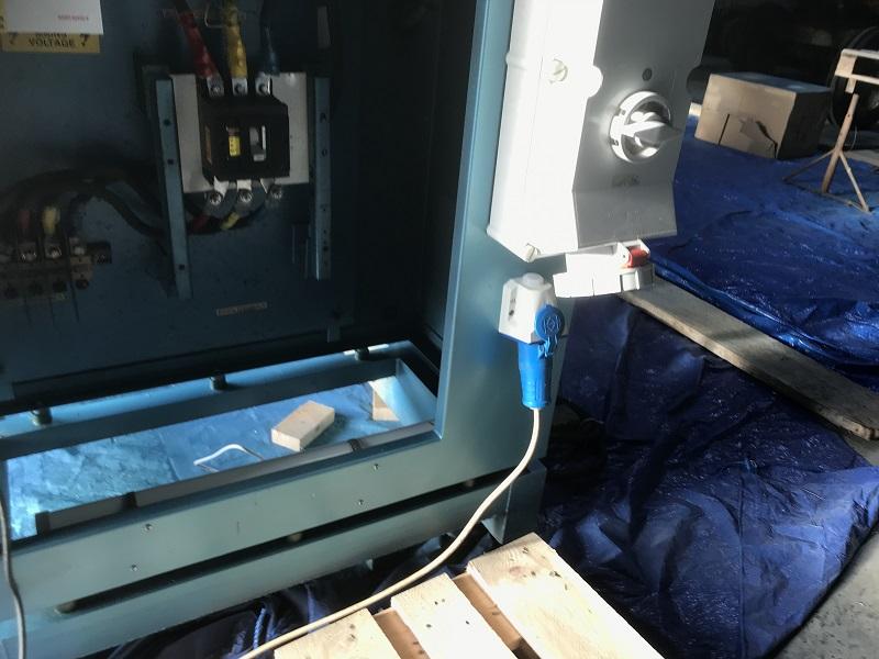

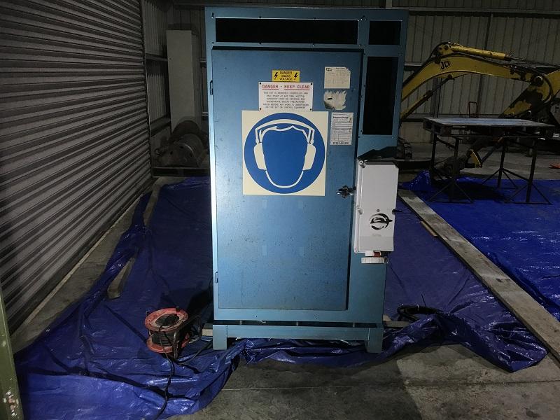

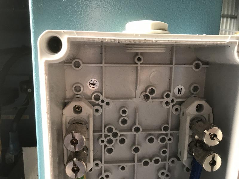

This afternoon I got the huge output socket / isolator fixed (6 x M6 Rivinuts) and measured up to get the cables to wire it up. Now the generator came with some very over specified cables about 3 metres long - by my measurements they are 150 CSA, and believe it or not to get round the various bends it's 2.5 metres from generator terminals to this socket, so I'd need 10 metres - now 35 mm CSA cable is just under £6 per meter and is marginal, and I've not had a quote for 50 mm CSA but it will be significant, so I've decided to go with the 'overkill' cables - after all the electrons won't mind a bit more elbow room  :clap:

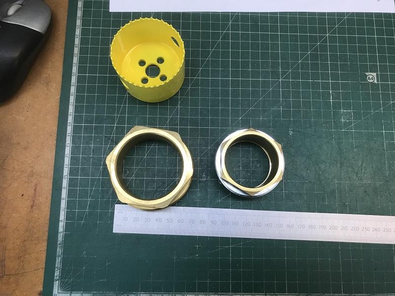

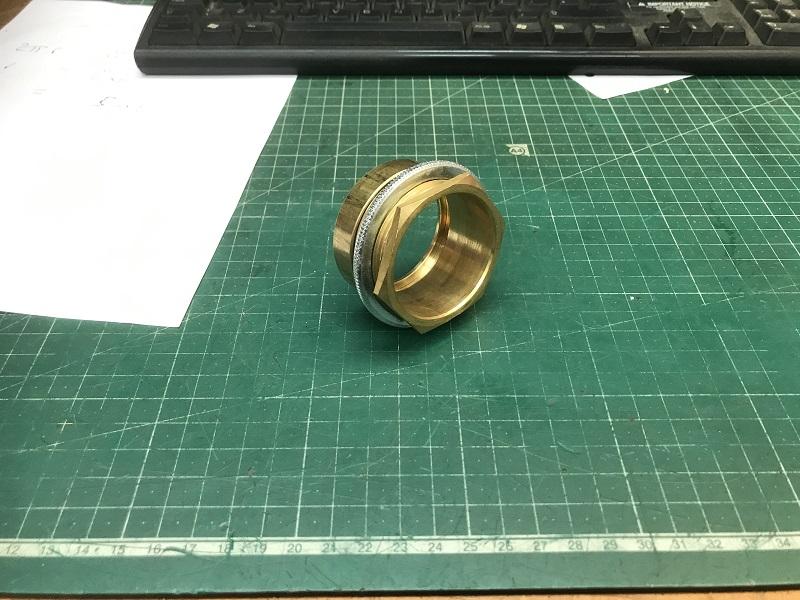

But a consequence of this decision is that the 50 mm brass bush I'd got to pass the cables through the cabinet wall into the switch / socket no longer is big enough. 63 mm bush on order with appropriate hole saw which works out much cheaper than buying new cables!

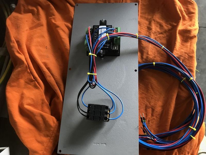

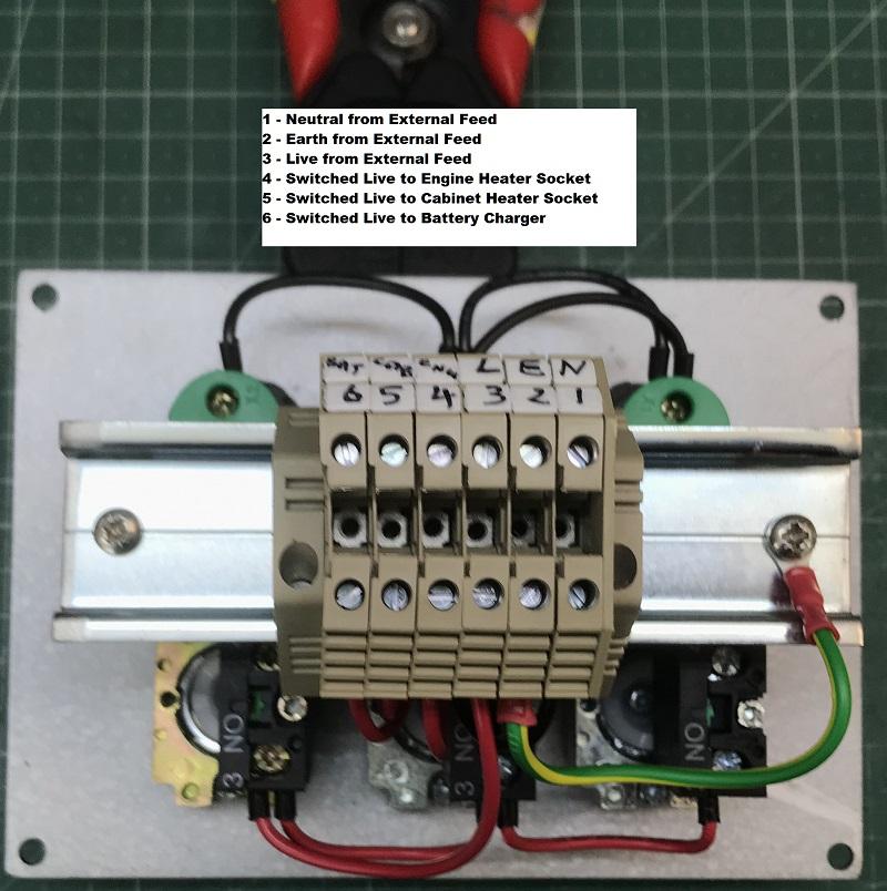

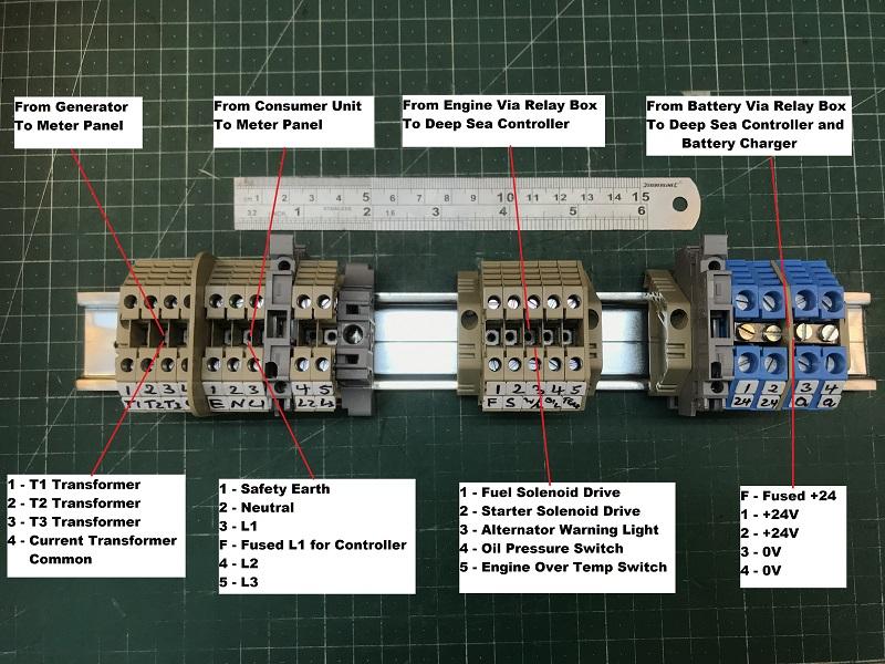

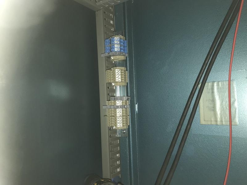

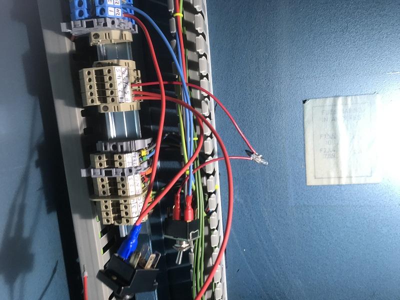

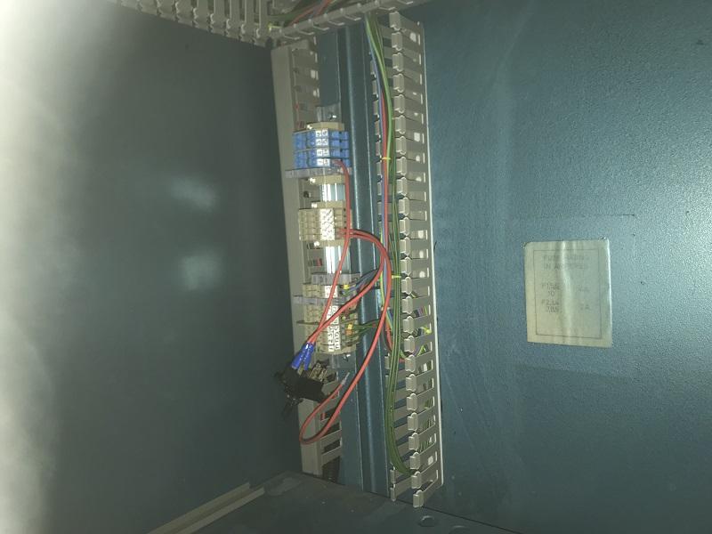

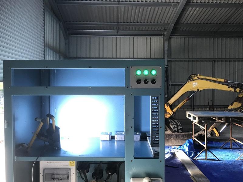

More DIN rail terminals arrived this morning, so I was able to complete the switch panel as a 'module' - this is the panel that distributes 'domestic' mains to the cabinet heater, engine heater, and battery charger to keep the generator ready to start when called for.
I also fitted a 16 amp 'Commando' input socket to the cabinet below the 125 amp output socket (socket angles ensuring that they don't clash) and then installed and tested the switch panel having put a bit of trunking in to tidy up it's wiring.

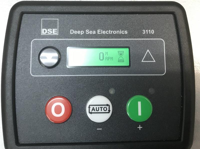

Then I AT LAST got round to putting power on the Deep Sea controller on the bench to prove that it was actually alive - rather late in the process and I'd be stumped if it wasn't, but all seems well - it went through a start up sequence reporting it's software issue, then went into 'wait' mode waiting for a button press - phew it works, I was rather dreading this test.

That second photo with the domestic input socket certainly puts the output into scale!
Russ
Re: Puma / Dorman 6LE / MacFarlane B46B / 110 kVA Generator Resurrection
« Reply #130 on: October 22, 2019, 04:56:55 PM »
Oh yes Russ it's certainly a whopper, and it only just fits without fouling the door handle as it turns. I want to replace that handle with one with a lock and I'll have to be careful that it's no longer.

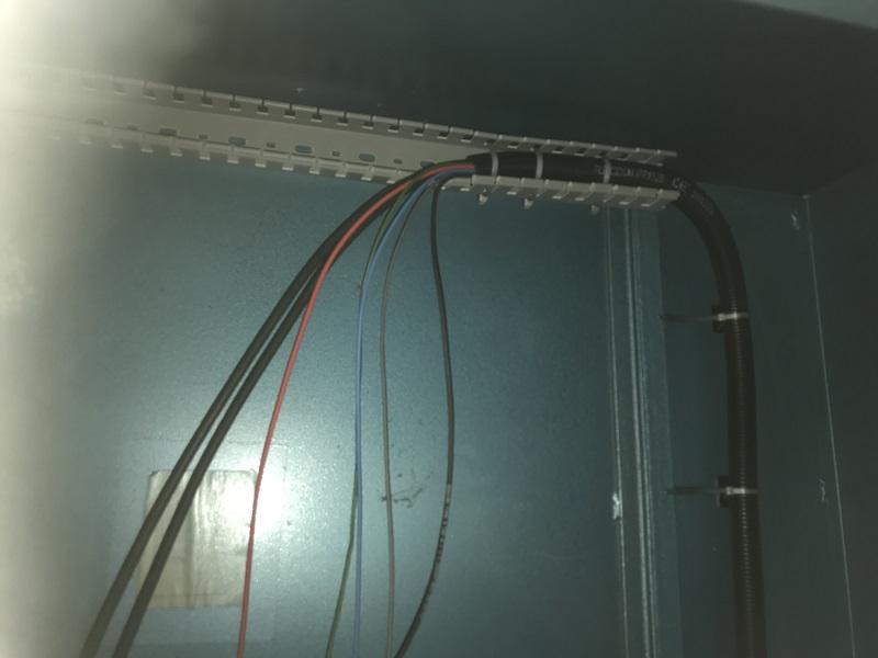

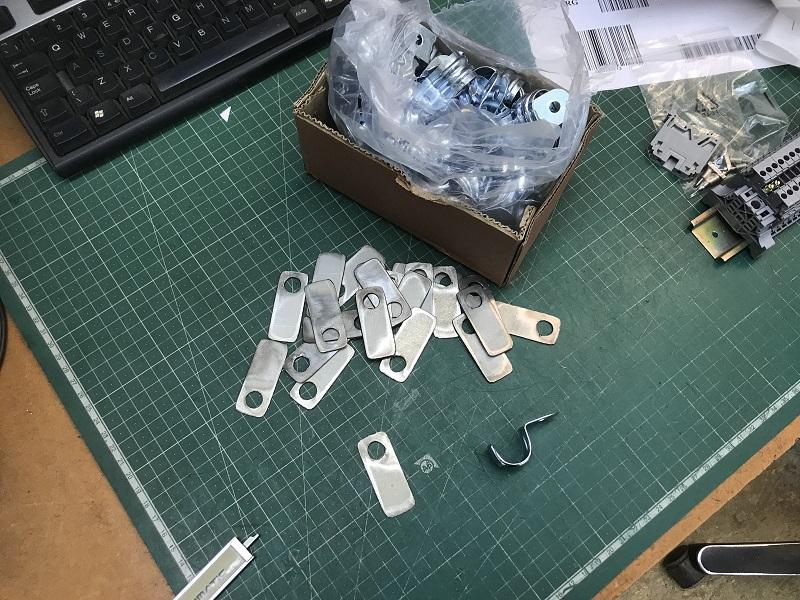

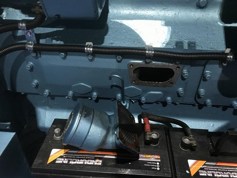

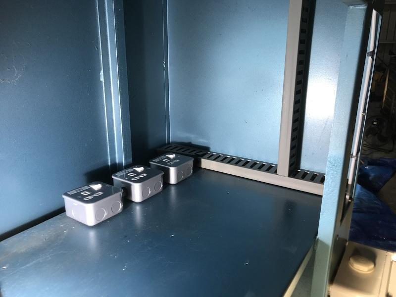

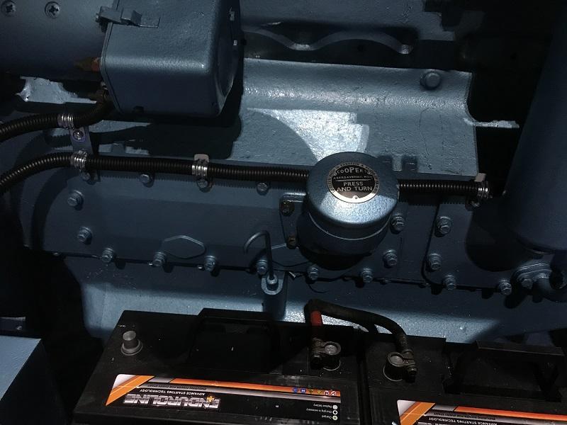

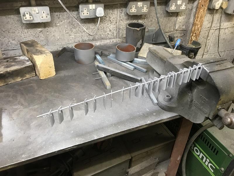

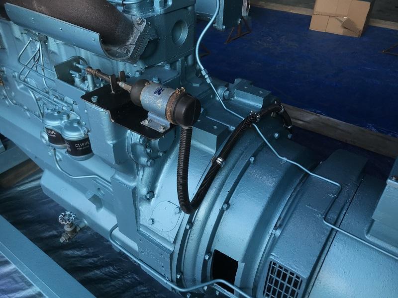

Yesterday my boxes of 20 and 25 mm conduit 'half clips' arrive. These are the clips for the flexible conduit that is draped all over the engine and they have to fix on existing bolts so needed to be wide enough to drill out to 10 mm. They also need a 'backing plate' in places where they are in free air to stop the conduit falling out of the back of the clip.
I cut a batch of backers and after a clean up gave them a coat of zinc paint.
Only had time to fit one conduit - the one for the fuel solenoid, but they seem to work OK  :thumbup:
Social duties stop more play today  :(

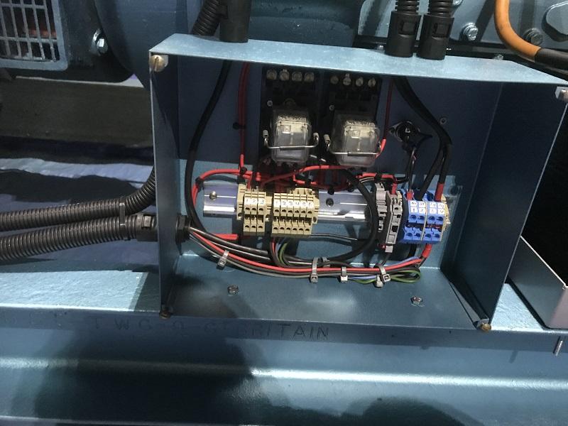

I did actually manage to escape for 90 minutes this afternoon, and assembled and documented what I'm calling the 'Gathering' DIN rail assembly. This is essentially where all the modularised parts get connected together, and it also houses the fuses for L1 and 24V that go to the Deep Sea Controller.
It takes a surprising amount of time to put these things together !

Any reason for the Blue Klippons?   :scratch:
(Normally used on IS circuits  :zap:)
Earth ones normally Green/Yellow...
Or did you run out of the beige ones? :lol:
« Reply #136 on: October 23, 2019, 01:05:53 PM »
They were what RS had at as reasonable price that would accept 10 mm csa cable. The beige ones are up to 4 mm iirc. As for Green / Yellow, yes it would be nice but minimum orders hit you in the pocket!
RS seem to be in a right mess in the DIN terminal department, with catalogue errors and incomplete ranges stocked. It wasn't like this when they were Radio Spares and only had one location and that was in the City just round the corner from my then office !

At this point My Hermes delivered the new 63 m brass bush  so I was able to get on and fit it. The cables that will go though it are seriously difficult to bend - in fact I'm thinking I may need to use my pipe bender on them, and because of this I wanted the bush mounted as high in the output socket enclosure as possible to give more space to  manipulate them, Needless to say the moulding of the enclosure didn't have a hole suitably  high so I had to do a bit of sculpting with my air detail filer to create a starting spot for the drill. After this drilling the big hole went without too much drama and the bush was fitted. Glad to say the cables now pass through reasonable easily.

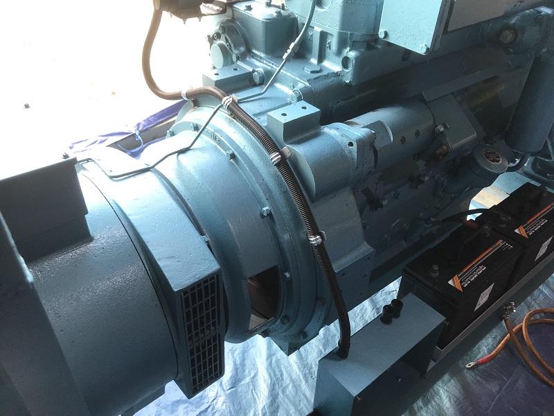

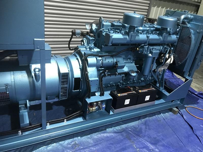

I then wired up the starter solenoid as that is one conduit with only one function and relatively simple to do.

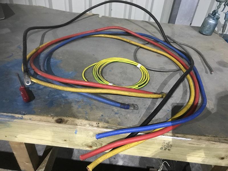

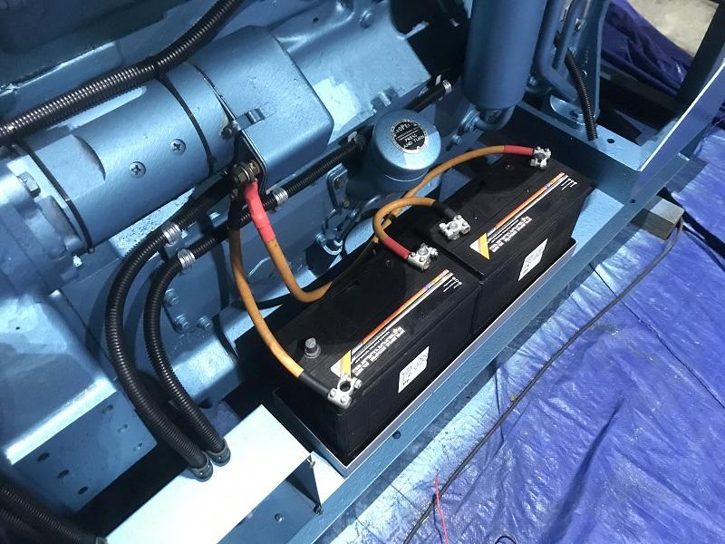

Anyway before the allotted hour I managed to make up new heavy duty battery leads using cable from the originals and terminations from Vehicle Wiring Products, and install them and wire in the starter motor solenoid.
When I got back early afternoon I had a good head scratching deciding the best place to locate the 'Gathering DIN Rail' and how to get cables to and from it. It ended up mounted vertically on one of the cabinet reinforcing rails, and being serviced by slotted trunking and flexible conduit. Then I made up the seven way cable form that runs from the relay box to the cabinet, and pulled it through. Quite stiff this one as it contains two 10 mm CSA cables.
I had major difficulty getting self adhesive pads and trunking to stay glued despite rigorous cleaning down with IPA. In the end I changed to using acetone as a cleaner, and ran a hot air gun over the bits that were to be glued, as I strongly suspect that I was getting condensation between cleaning and gluing. Seems OK at the moment but we'll see if it's all fallen off in the morning !

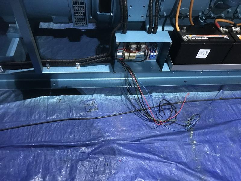

Firstly I re-attached the exhaust / silencer assembly so that I could start the engine. Then, temporarily wiring a fuel solenoid switch and dabbing a wire to drive the starter solenoid I started the engine and let it run for a minute or so just to make sure all was well - it was, and no water leaks after introducing antifreeze.

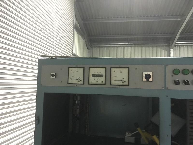

Then I terminated both ends of the seven way cableform that I pulled through from the relay box to the control cabinet. Moving on to the current transformers I identified all their connections, replaced the eyelets at the transformer end as the originals were rather corroded, and wired them to the Gathering DIN rail terminals.
Then I made up cable forms for the voltage measuring side and current measuring side of the Meter Panel, wired them to the Gathering DIN rail terminals and installed said panel.
Moving my temporary fuel solenoid switch and 'dabbing wire'  onto the Gathering terminals I then started the engine from within the control cabinet and was able to prove out the wiring for the phase to phase voltage measuring. and frequency meters - all seems to work OK :thumbup:

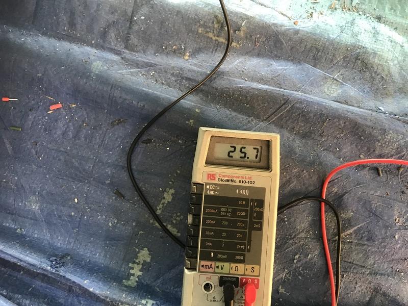

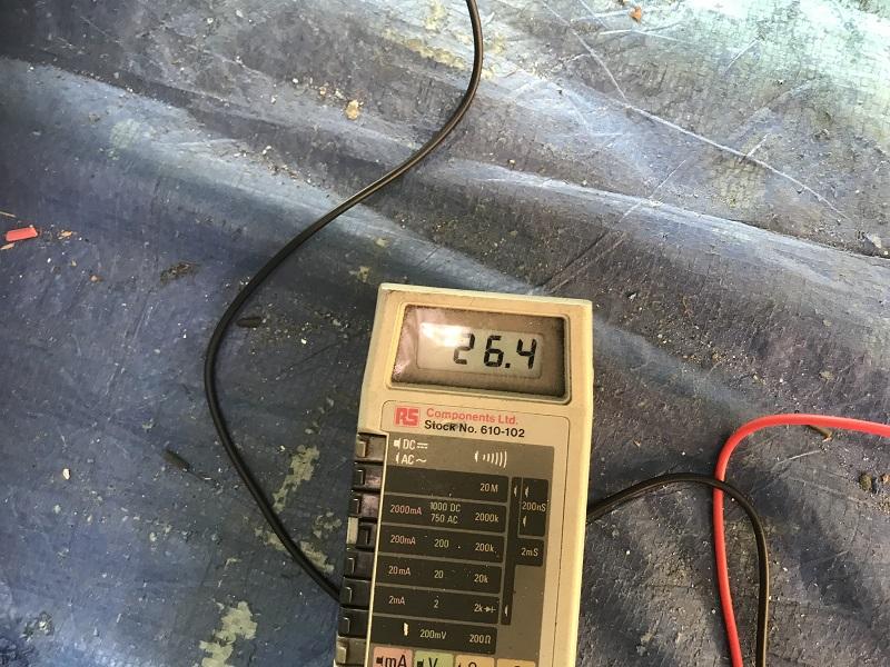

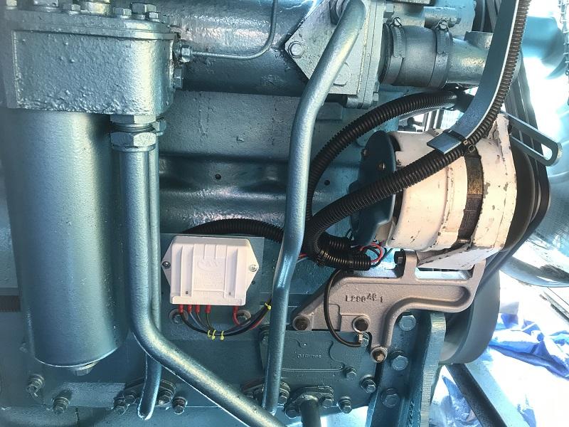

A day of contrasting highs and lows today.

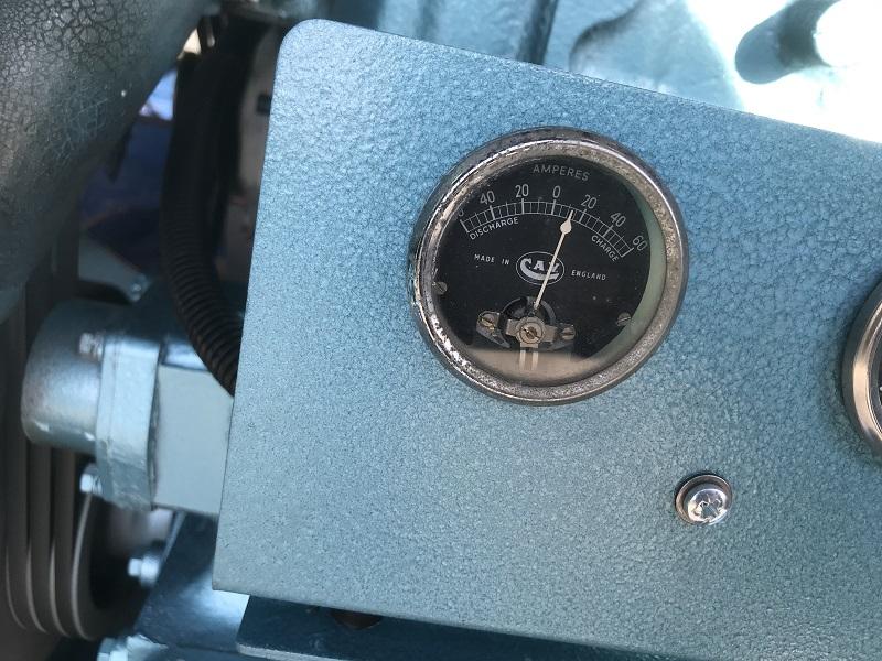

I started off on a concentrated effort to pull all the cables through that interconnect the Alternator, it's Regulator, the Ammeter, the Over Temperature Switch, and the Oil Pressure Gauge. I'd not been looking forward to this as some cables have to start off in one conduit then swap to another to avoid joins - examples being the 10 mm csa heavy ammeter cables, and the bundles were pretty much on the limit of what you can pull through the flexible conduit, and especially the reduced diameter of their terminations.
All went reasonably well - I decided to wire the CAV 440 regulator on it's 'Low' setting for the moment - apparently this sets the regulated voltage to the low end of the spectrum.
Now in the final implementation the 'W/L' (warning light) connection is sourced from the Deep Sea Control, but for testing I wired in a bulb. This is supposed to be about 2.5 watts at 24 volts, and the only low wattage 24 volt bulbs that I had to hand were telecoms 'wedge bulbs' drawing all of 20 mA - but I tried it anyway. The W/L input is intended to give an initial current flow through the field winding to start the alternator generating, and when it does the light goes off as now both ends are at the same voltage.
So - the moment of truth - start the engine having noted what the battery voltage was to begin with and watch what happens. Initially nothing - the light stayed on, the battery voltage was unchanged, and nothing showing on the ammeter. Then after perhaps 45 seconds the light went out, the battery volts started to rise, and the ammeter showed a ten amp charging rate. Every subsequent starting has resulted in normal charging activity.
My conclusion is that the alternator rotor had little residual magnetism, as I've dismantled it and anyway it's sat unused for many years on the auto-electricians shelf as the bearings were bad. The 20 mA was not really enough, but gradually the alternator 'bootstrapped' itself - I've no doubt that the correct 2.5 watt bulb, which would be drawing about 100 mA would have got it going pretty well instantly.
So, on a high I decided to wire in the Deep Sea Controller. Firstly I wired up a cable form to make connection easier, fixed the panel in, and found that I'd made the cable form about 12" too short to lay nicely in the trunking  :bang: I decided to connect it up anyway 'as the crow flies' fashion just to prove that it worked, and then I made a BIG mistake. Friends arrived and rather than downing tools, I rushed to finish the connections and must have got something wrong  :bang:
Connecting the battery the starter solenoid instantly pulled in, then the display went blank - no life - a dead controller  :bugeye:
Now I have subsequently powered it up on the bench, and it is starting up normally, but it's 'switch outputs' are sitting at 8 volts (it runs off 24) so something is sick. I will investigate further, but also I've sourced a replacement - at least if the original heals itself I'll have a spare  :thumbup:

Jeeez...! Where did you dig up that old Fluke dvm from? :lol:
