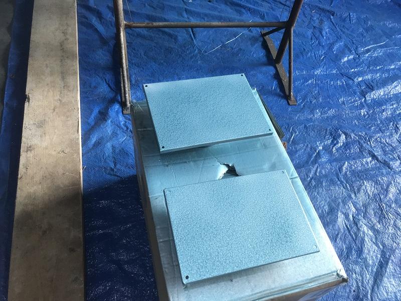

Thanks chaps for the offers and the suggestions - much appreciated but I've decided on Hank Bushes as I have the kit to fit them.

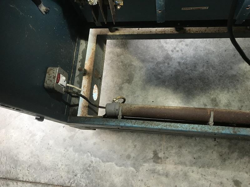

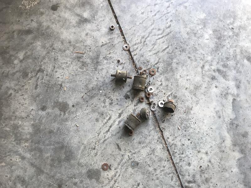

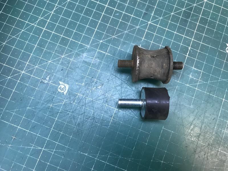

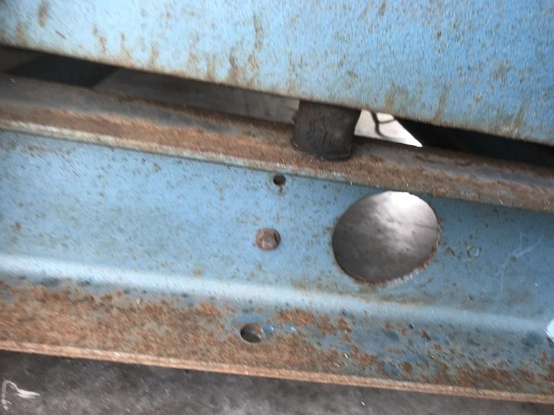

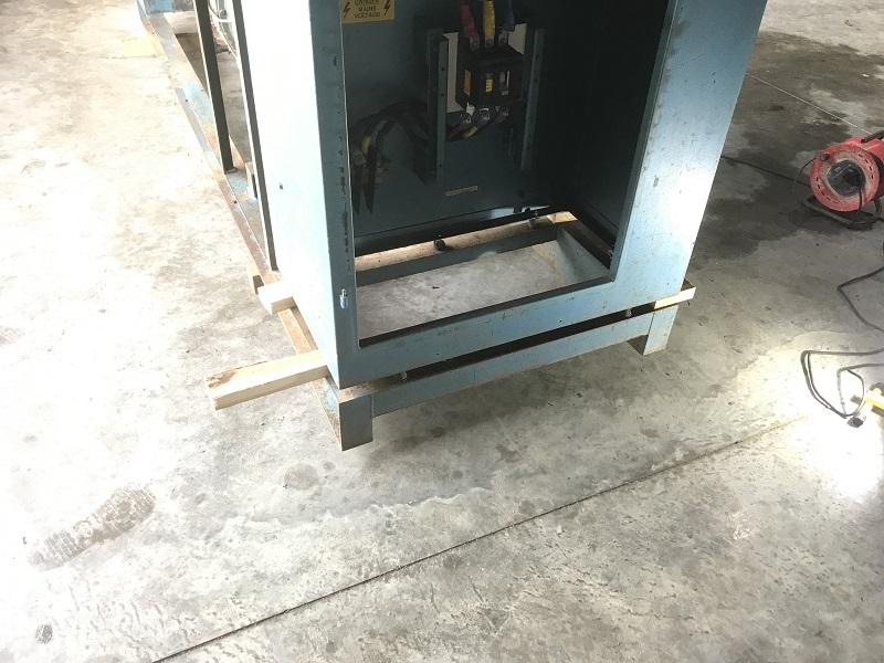

This morning I set too replacing the eight anti-vibration rubber bobbins that secure the main cabinet to the chassis. Originals were 3/8" UNF x 32 mm tall male male. My replacements are M8 20 mm tall and male female. I saw this as a potential advantage when it comes to fitting, but obviously I needed spacers to make up the 12 mm shortfall. I made eight delrin spacers and 'set too'. It was only then that I discovered that five of the eight originals had been screwed into tapped holes in the chassis rather than held by nuts from below - this necessitated not only unscrewing them but lifting the cabinet even further and drilling out the threaded holes to 8 mm clearance. I got there in the end  :thumbup:

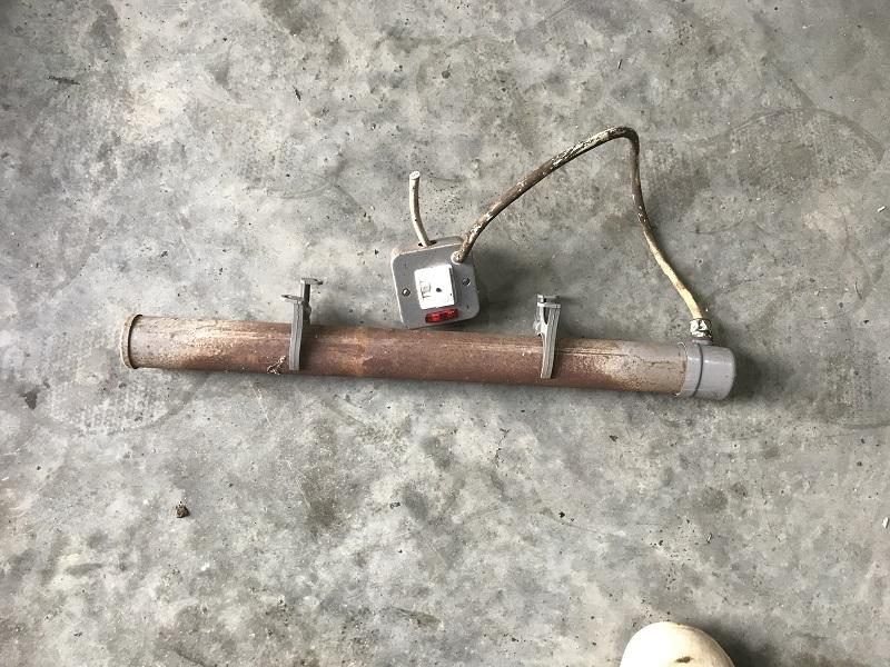

In the process of replacing the rubber bobbins I also removed the cabinet heater, that actually is a green house heater if I'm not mistaken - it doesn't work but I think it's probably a good idea keeping the cabinet dry so will get a replacement.

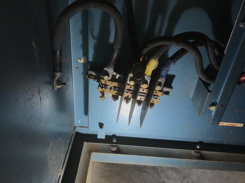

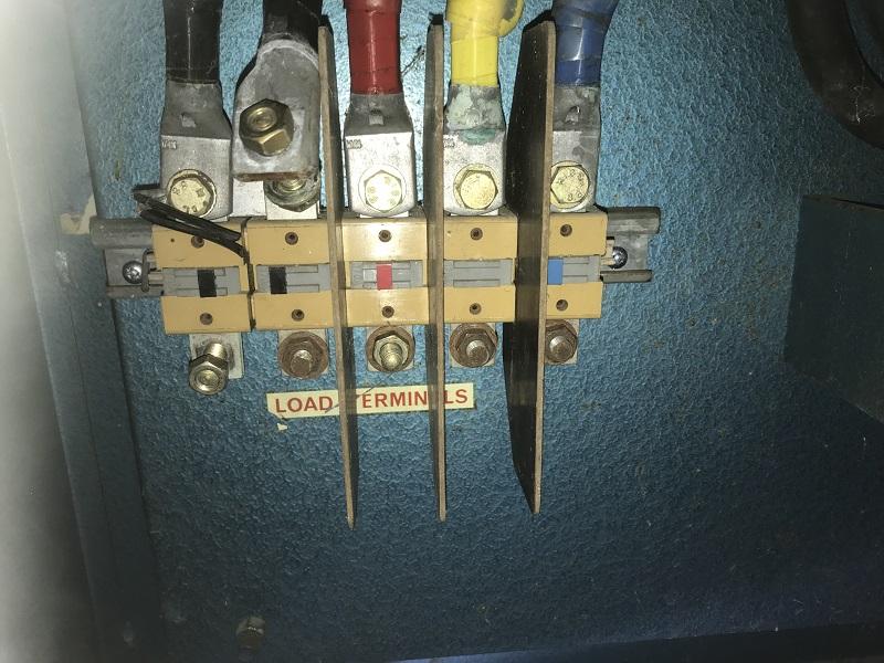

Then I wanted to sort out the main output terminals as they were flopping about unfixed at one end, not good with this sort of power behind them :bugeye: To my horror I then found that they had only been fixed with self tapping screws one of which had pulled out - the cables attached to these terminals are massively heavy and self tappers are in my opinion definitely NOT correct in this situation. I drilled them out, fitted hank bushes and bolted it back securely.

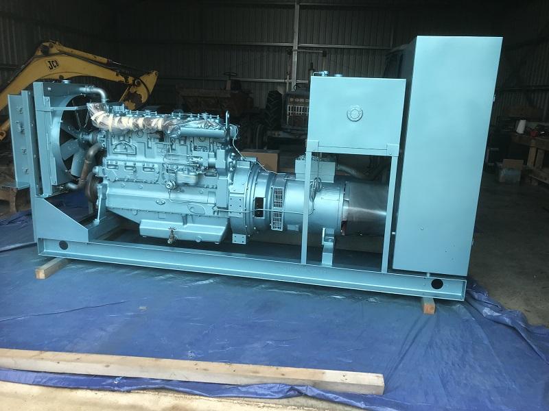

So, no excuse, get ready for painting. A last go over with a wire brush, a bit of masking of things not to be sprayed, and an acceptance that it's not going to be a perfect job, as the more I look the more bits of flaking paint I see !
So a wipe down with a rag soaked in the 'Universal Thinners' that the paint uses, drag the machine out on the fork lift, spread a tarpaulin to limit the mess on the floor, plonk the machine back on bearers and mix up some paint.
This is when things started to go wrong - I pour paint into a mixing cup through a paint filter funnel but this time I succeeded in overbalancing the cup and funnel dropping a fair amount of paint in the process  :bang:
Clearing up the mess I started spraying and it went quite well - first gun load of paint went on nicely. Diluting the second batch I messed up somewhere as initially it was far too viscous, and when I added a bit of thinners I went too far in the other direction and ended up with some runs. Still this is only the first coat - at least one more to follow and an opportunity to rub down in between.
Still it definitely looks far 'bluer'  :clap:

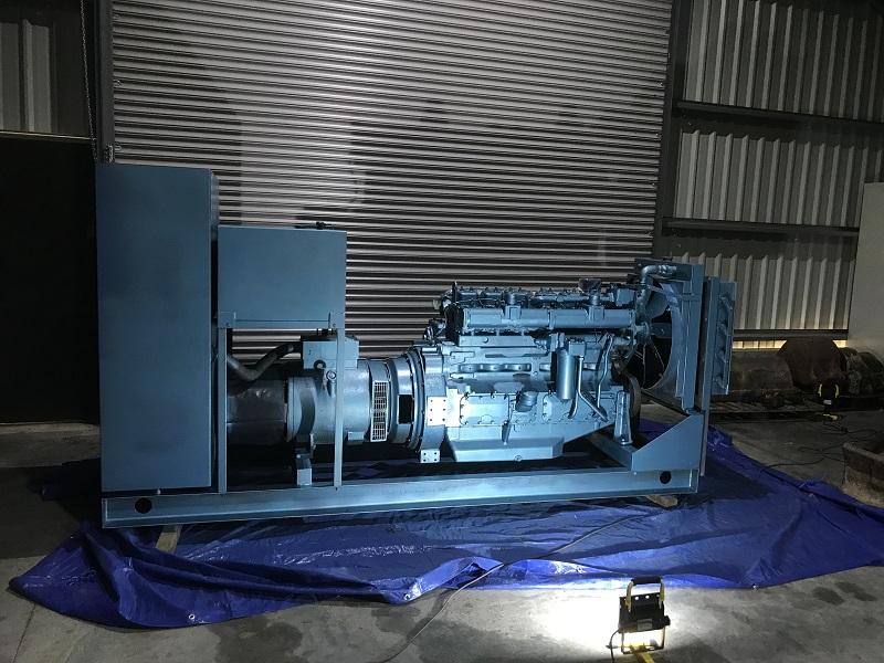

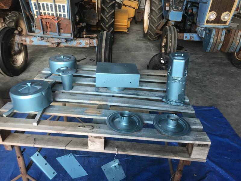

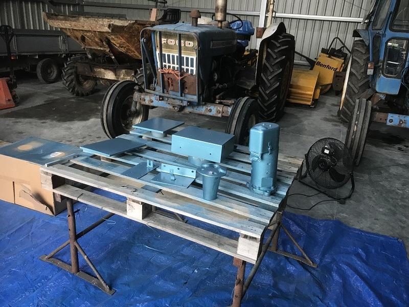

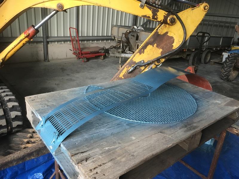

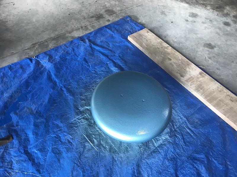

The day started with sorting out three pigs that were due to go on a one way journey (Sorry Will_D !) but when that was finished it was time to get a first coat of paint on all the odds and sods that I'd removed for various reasons.
Spread another tarpaulin and set them up and gave them a first coat - some like the insides of boxes, will only get one coat but other bits like the lids for instance will need another coat.
I used up the gun full of paint catching a few bits on the engine that got missed so it will have to wait a day or two to harden before I can Scotchbrite it and then give it another coat.

« Reply #61 on: October 07, 2019, 07:54:22 AM »

Good work Andrew. Accept alfanumeral "Like". Like Fords at background too.

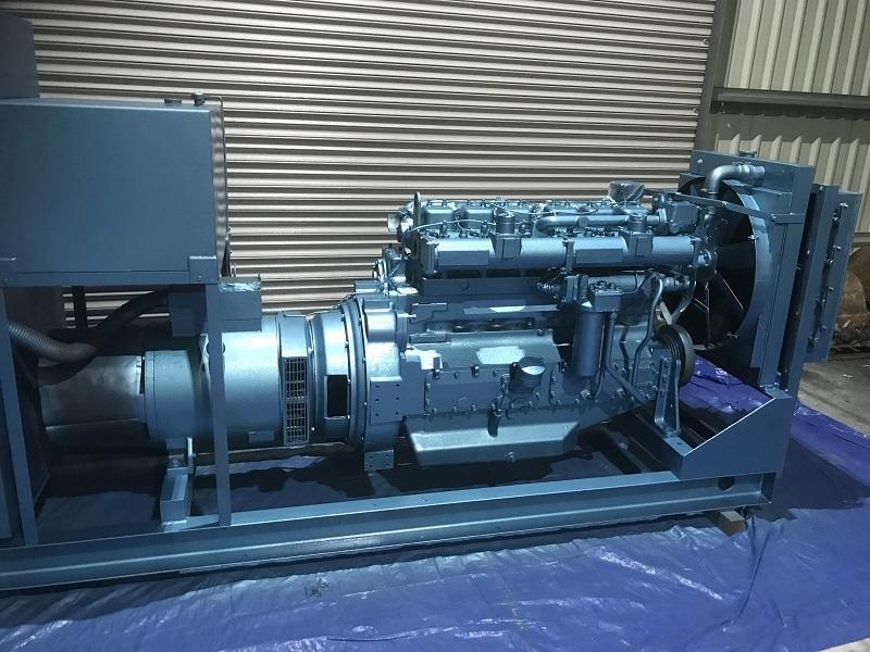

Up early this morning, gave it a bit of scraping in places and a rub down with a green Scotchbrite before giving it another coat. It's actually come out quite nicely and I reckon it's OK up to about 2 foot away now Ade  :clap:
Photos probably won't look too different from the previous ones but the actual job definitely is better :thumbup:
Re: Puma / Dorman 6LE / MacFarlane B46B / 110 kVA Generator Resurrection
« Reply #72 on: October 08, 2019, 05:35:57 AM »
Looks good. I reeks utility and looks loud even when it is not running.
