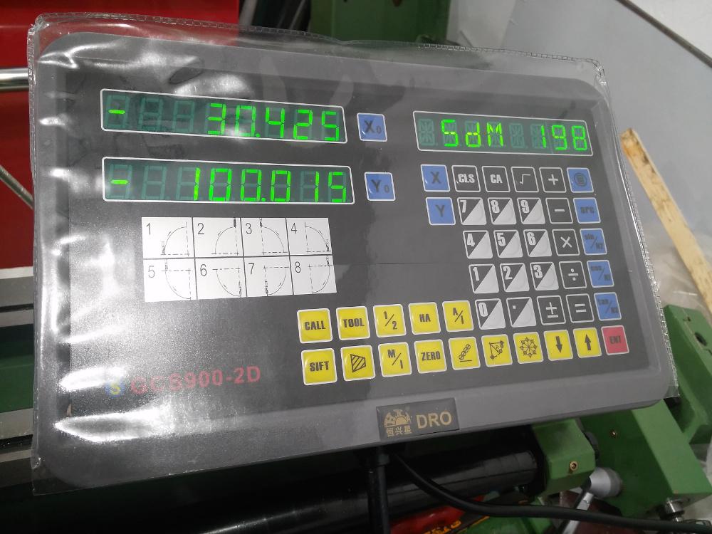

I cannot seem to change mode from a MILL-3 to a LATHE-2. It might have helped if I had the manual, though not necessarily so.
This is a cheapo DRO which I ordered with 1u resolution on AlieExpress. When it came 5u was supplied. I think they sent the wrong scales. Went to dispute and I got ~ 30% off. This all happened some time ago.
However I figure I can use it on my lathe, but its set to MILL-3 and I can find no way of changing it. I can get into the setup routine and change the axis resolution and other params (by holding the '.' button on power up) but it does not give the option to change the mode. The manual has disappeared into the nearest black hole, doubtless it will turn up when I no longer need it.
An earlier version had an s key on the left hand side of the display, but although the panel has the 's' key marked there is no button.
Any assistance greatly appreciated.

Not sure if this is applicable but I seem to recall an old thread where something similar was discussed.
 I think there is a hidden button somewhere., maybe just a little hole that needs a pin.
Russ

No holes or hidden switches. I took it apart to see if there was anything like that and failed  :scratch:. Just a single pcb and 5v psu, only wiring was to 9 pin D connectors on rear panel.

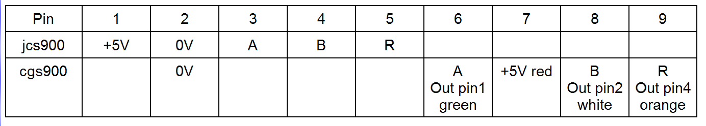

The membrane switch panel does not have a switch at the s position and is flat in that area, despite being printed with an s for one. My other two DRO's are the JCS900 flavour and they both have switches in that position, as indicated by 'clickable' bumps. When I ordered it I thought it was just a clone pf the others, but the axis and zero switches are in different positions also. Likewise the alternate reader head wiring scheme is used , pins 2-gnd +6-9 for supply and signals, vs pin2-gnd and pins 1-5 for supply and signals.

No space. Its a membrane keyboard ( https://en.wikipedia.org/wiki/Membrane_keyboard, scroll down to see how it works picture ) , a solid layer of 3 materials bonded together. It connects to the circuit via a ribbon cable.
Did have mad thoughts of swapping it for one of the other (JCS900) keyboards, but don't want to end up with scrap.

Is there a hidden switch at the 's' position?
Ie, there is a switch there, but the top is not domed. Try pressing it with say the end of an Allen key.

The first thing I tried was a small allen key to depress the 's' area. But there is no switch there :-(
If I resolve the issue I will post the solution.
However I would recommend any future purchasers avoid this particular model. It seems to me the JCS900 versions are easier to work with and the button layout is more logical. Mixing and matching with the GCS900 version is not smart as the axis zero and axis function buttons are transposed. Inevitably meaning that when going from one machine to another you zero the axis by accident  :Doh:.
Another snag is that the machines use different pins for the 9 way connector. I may alter the inside of the DRO(s) to accept either 9 pin configuration, its only 4 links on the socket then they become usable with either head reader version (see pinout below).

Finally resolved the GCS900 mode problem.
Turn on and rapidly and repeatedly push and release the M/I button (bottom row, third key from the left) while it boots. This will bring up a menu in which dro can be selected using the arrow keys. Press enter and then select the required mode, Grinder, EDM, Lathe, mill etc. Once the correct mode is displayed then press the '.' button, in between 0 and +- key to save.
Hope someone finds this useful  :thumbup:
