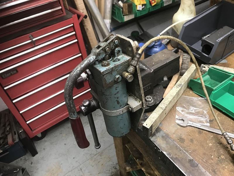

Yes I think so but the proof will be when I can put 10 bar on the original switch.
I put it all back together again this morning and re-installed it. All seems to work as it should and I’m now going through the myriad of places oil is supposed to emerge checking that they are all lubricated ok
Tiny volumes in some places so not immediately obvious.

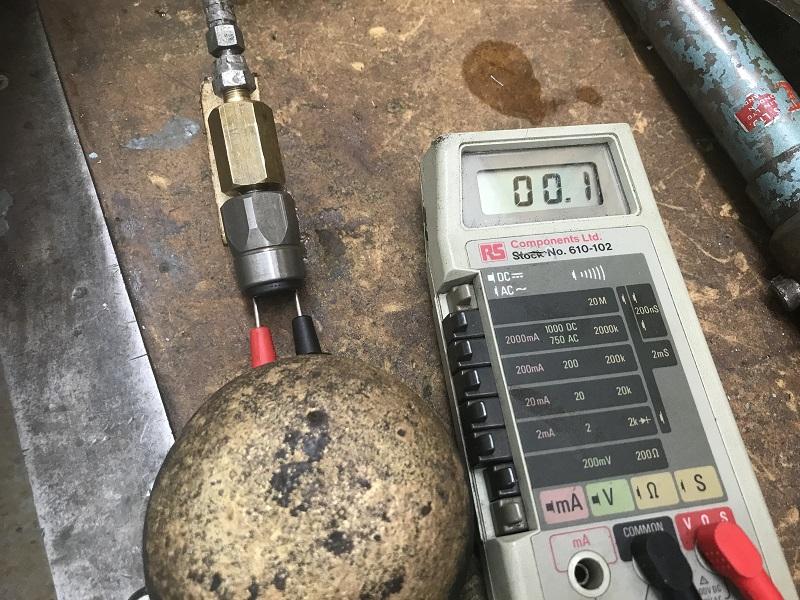

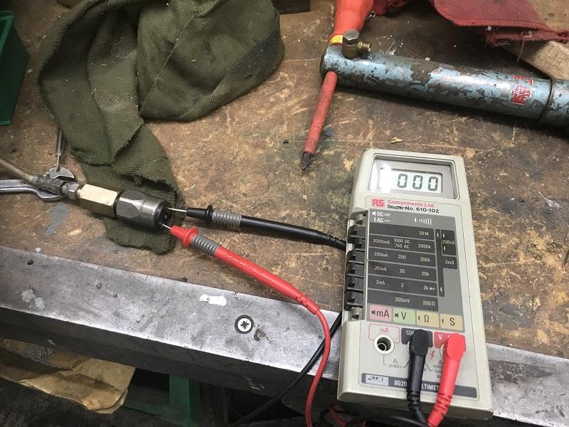

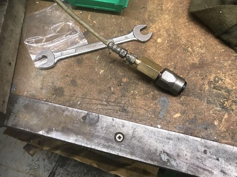

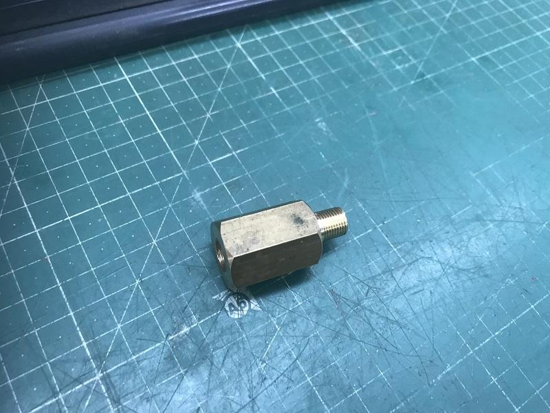

This afternoon I made up a test adapter for the pressure switch - M10 x 1.0mm female to 1/8" BSP Male with a female cone in the end.
Assembling the switch to a test pump and guess what - the switch is INNOCENT - apply pressure switch closes release and switch opens.
I was just packing up and processing the photographs when I realised that there was a possible / probable miscarriage of justice - looking at my photograph of the Fluke meter it was on its next to HIGHEST ohms range not it's lowest  :bang:
Of course I'd dismantled everything and put all away, but there was nothing for it, there would have to be a re-rial in the light of this new evidence. I put everything back together repeated the test and OK the accused WAS innocent, and released from custody.
 . . at least I now have a spare pressure switch.
As for the original fault, I believe that the copper wires had corroded where they were crimped - possibly due to the sulpher in the oil, or maybe other causes, and the outer plastic sheath had held the bits in intimate contact, often adequate and sometimes not. Remember that the plastic sheath is retained by the outer crimp on these spade lugs.
« Last Edit: October 08, 2020, 11:12:01 AM by awemawson »

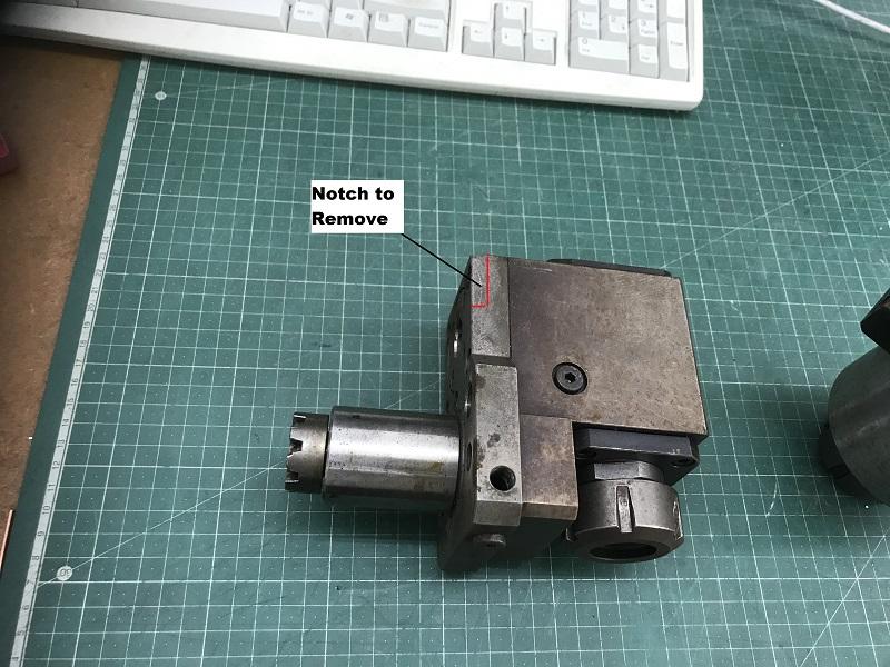

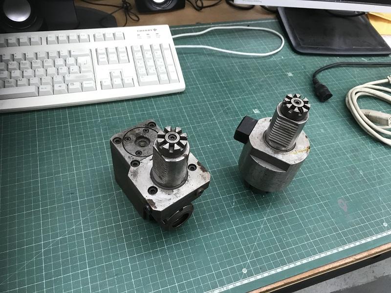

Advertised on eBay a couple of months ago were a pair of PCM swiss made powered tooling holders - a straight one, and a 90 degree one. The description was vague, and although they looked to be VDI holders the seller couldn't say if they were VDI 20 / 30 / or 40. A search on the PCM part number of the straight one (as it showed in the advert photo) implied that it was VDI40 as I need but was no means definite. However the drive end of these holders looked to be identical to the Beaver ones that I had had to modify on my existing holders.
Anyway no point in getting too excited - he was asking silly money and had already rejected a more reasonable off that I made a few weeks back. Well, he went through the hoops of re-listing the items four times so last week I made a slightly increased offer and to cut a long story short they have just arrived. A quick inspection shows the bearings to be reasonable and although they need a clean up they are in infinitely better condition than the previous ones that I got that were seized solid and needed new bearings and seals.
The straight holder fits 'as is' directly on to the tool turret with no modifications needed, and the drive engages nicely. The 90 degree one will need to be modified (as I had to with the previous one) as the heel of the mounting face fouls on the centre disk on the turret. About 1/4" needs to be removed - perhaps a bit less - to clear the disk, but I've done it before so can do it again!
. . .so I'm a happy bunny today  :clap:

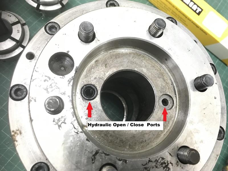

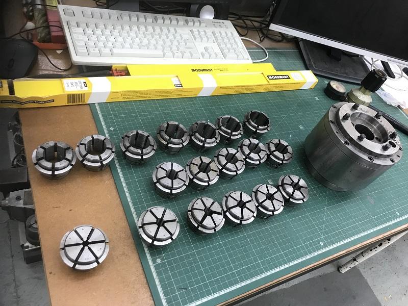

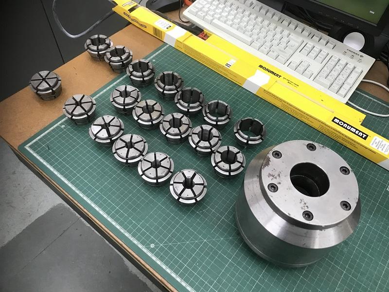

Since I bought this CNC lathe I've hankered after a collet chuck, which saves all the hassle of soft jaw turning etc. Problem is that the way chucks work on this lathe is rather unusual.

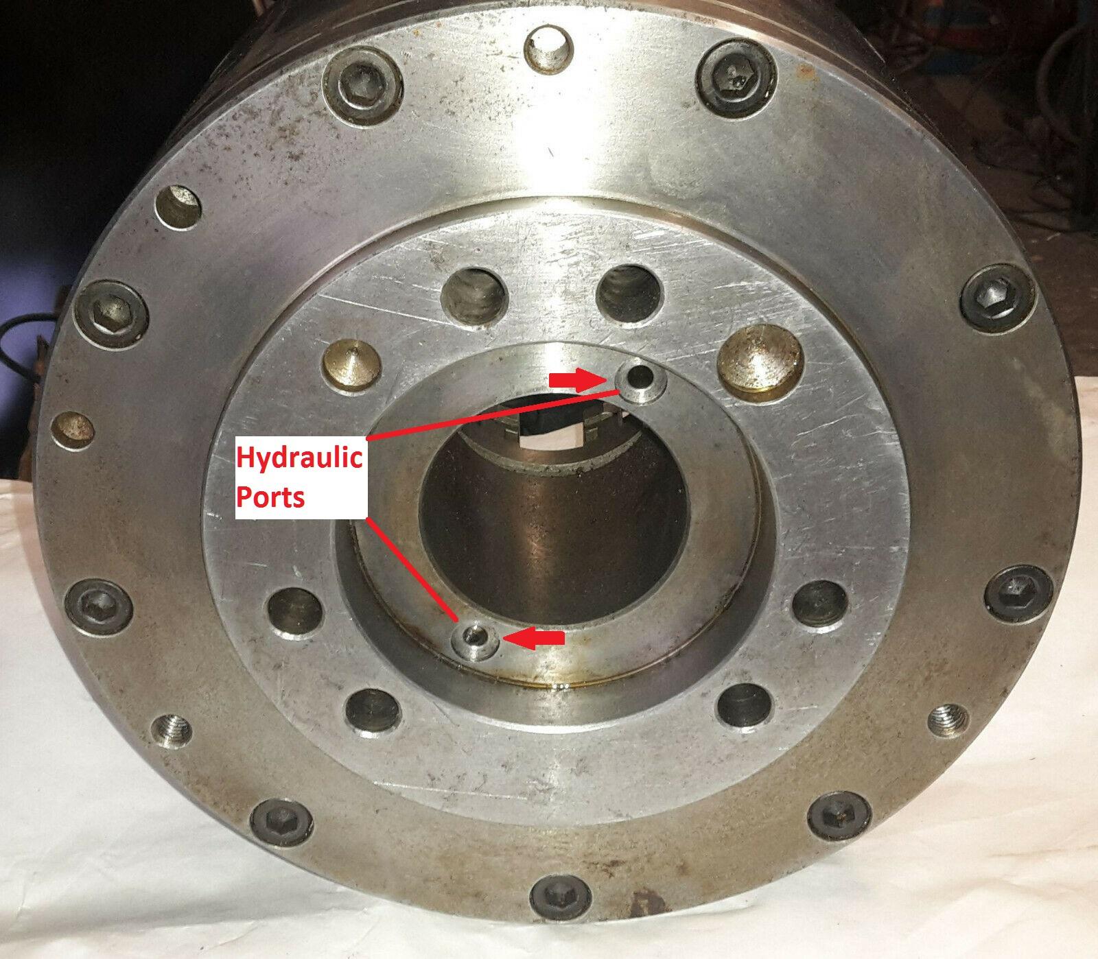

Most hydraulic chucks, be it collet or jawed, have a draw tube co-axial with the spindle which is pulled or pushed by a remote co-axial hydraulic cylinder. On the Beaver the chuck has the cylinder built into it, and has two ports (open & close) in the face of it's rear surface that mate with similar holes in the spindle nose where an O ring is trapped to seal the oil.
Now my main chuck is a Pratt-Burnerd 1749-02780 which I very much doubt was a special for Beaver so it must conform to some spindle nose standard (I assume). The lathe spindle 'seems' to be an "A2-6" standard spindle shape with the two hydraulic ports added.
Anything conforming to this standard is remarkably rare - in the last few years I've found one chuck like mine in the UK that the seller wanted really silly money for, and one rather beaten up collet chuck that was a fair price, but no collets and being in Canada transport killed the deal.
So when a collet chuck using this same system turned up on UK eBay complete with an almost complete set of collets I got quite excited. Conversations with the seller revealed that it was off a Beaver lathe - excitement raising to fever pitch - soon to be dashed when I find that it was off a Beaver TC10 lathe (mine is a TC20) that has an A2-5 sized nose so not directly compatible.
Explaining to the seller how limited his potential market was persuaded him to release it to me at a very reasonable price (£200 inc carriage) which is worth it for just the collets.

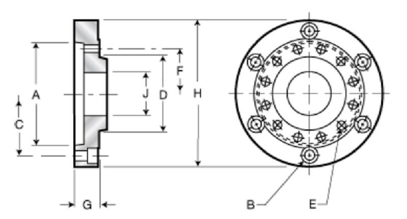

So LOADS of googling shows that at least two firms make a converter plate from A2-6 nose to A2-5 nose - they don't have the bores for the hydraulics but if the adaptor plate is fat enough there might be room for some drilling of oil galleries converting from the collet chuck's 60 mm PCD to the spindle noses  84.2 mm PCD. Both are 6 mm diameter.
I envision drilling blind holes into the two mounting faces of the adaptor at the two PCD's with a cross drilling joining them which can be blanked of with a sealed grub screw, but this depends on the adaptor plate being fat enough and actually managing to buy one!
Absolute 'back to the wall' solution is to make the adaptor plate myself, but it has rather a lot of precise features and needs to be absolutely concentric so not something to knock up in a wet weekend.
I have thoughts of 3D printing a model to prove the concept.
. . . the other issue is actually handling the original chuck - nowhere above to put a block and tackle and it weighs 47.2 kg  :bugeye:

Looks like a fine piece of kit and sounds like a good price too. What I can't understand is how you fit / change the collets - surely you don't undo all 6 fixings?
« Reply #916 on: March 01, 2021, 01:57:52 PM »
Oh yes you do Murray !
Not that bad really with a handled hex driver - usually it'll be for small runs of parts.
Numerous phone calls today are bringing me round to thinking I may HAVE to make the adaptor plate. So if I do I'll pretty certainly  do it on the manual lathe on an expanding mandrel between centres so that I can work on both faces and have some hope of maintaining concentricity.
Andrew,
I'd turn one side, put the necessary holes in, and mount it on the lathe to turn the other side.
Just like finish machining a backplate for a chuck.
« Reply #922 on: March 01, 2021, 04:29:01 PM »
Scary CNC machining that second side Phil when you can't even see the work piece :bugeye:
I'd certainly have to make several trial pieces before committing to the final one but I do agree it's the best way of ensuring concentricity !
