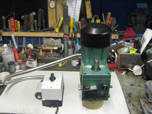

« Reply #75 on: February 06, 2017, 05:48:50 PM »

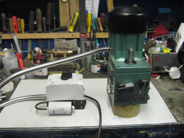

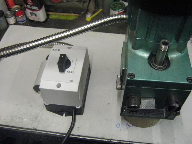

still a lot to do need a bench for it a bracket making up to bolt the switch to swafe covers D.R.O and so on

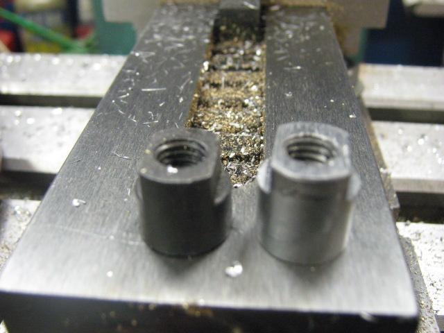

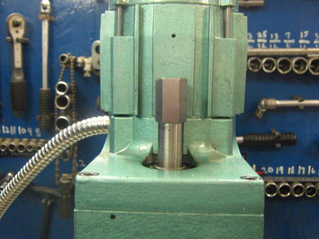

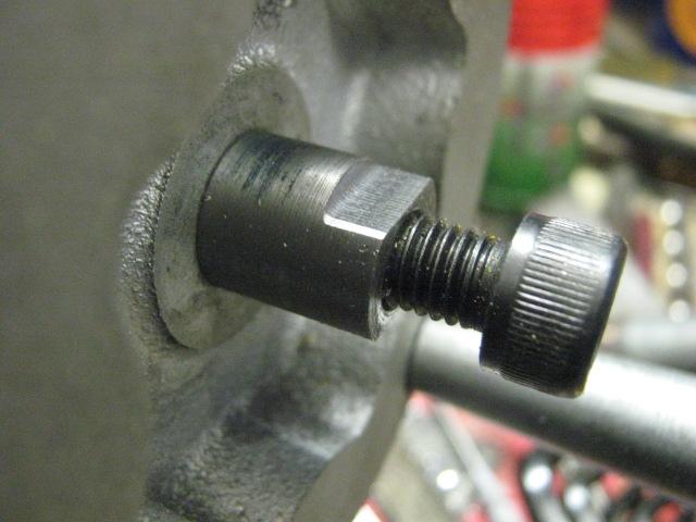

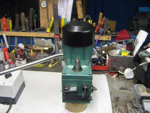

hi all will throw this out there on the mane shaft that's the silver one in the pick on the top there shod be  a ejector nut its a 16mm by 1 mm pitch thread with a hole in it witch you un do the draw bar when the draw bar  hits this it shoves the morce taper free has any one got one they can do a drawing off so I can make one up the manufacture name plat sits right behind the shaft and was well beaten up as people had bin hitting the draw bar with a hammer and the plate at the same time I have removed the name plat as the motor is gnaw 240 volt still kept the plate im going to put a pace of stanles steel in its place hopefully this week end
Re: home made mill
« Reply #90 on: February 16, 2017, 05:03:12 PM »
Iff you have a corser thead on the draw bar it will pull the taper in and then release by unsrewing , turn the chuck or cutter in untill friction is felt tighten the nut a turn or two , jobs a goodun .

« Reply #91 on: February 17, 2017, 03:24:26 AM »
I do have one of those "undo"- caps on my Emco FB2 mill. All it really is, is a sleeve or cap over the drawbar bolt which resist the force of the screw coming up. Rather simple really.

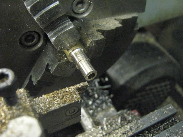

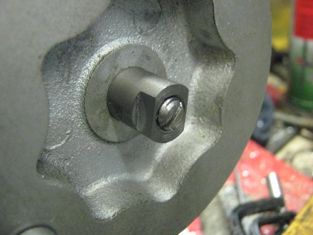

« Reply #92 on: February 20, 2017, 06:28:49 PM »

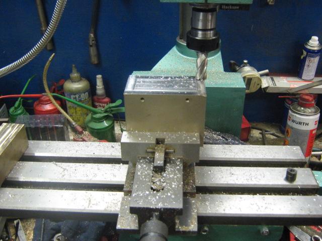

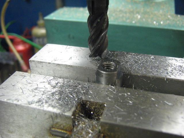

hi its a live its a live made my take on the ejector nut 17mm c/f stanles steel drilled out to 15.3mm taped 16x1 mm by 30mm deep drilled a 7.3 hole in the top for the alan key to fit threw clocked the head in had a bit play with a block of aluminium then put the flats on the two new back lash screws then made up the two locking screws  right sum pics    ps   any on no where I can get sum of that lovear rubber to make bed covers with

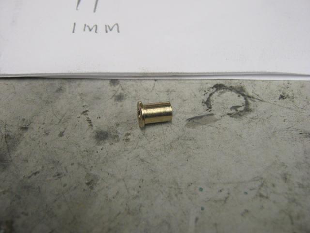

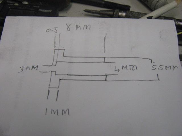

« Reply #97 on: February 27, 2017, 05:32:21 PM »

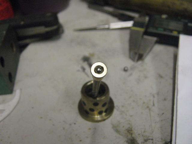

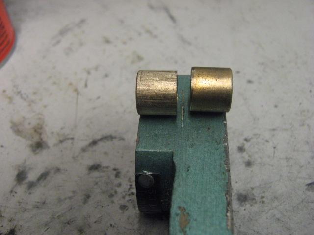

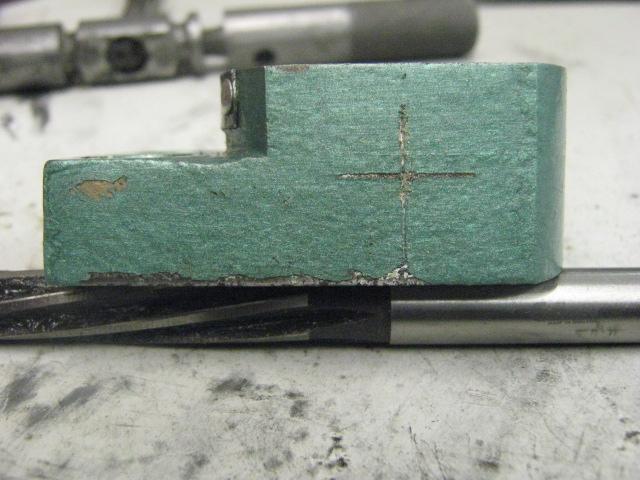

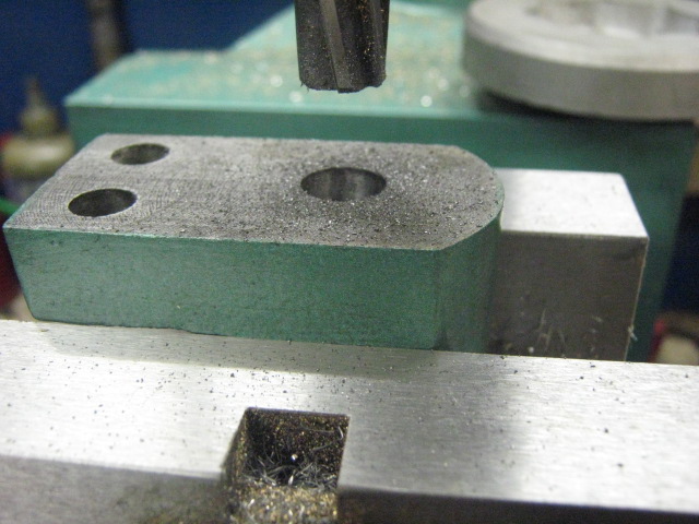

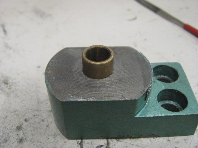

hi all bin bizz with the mill this weekend the two brackets on the top table had to much play in them sos no pic of this bit but on the first bracket on the back side the hole was 11.5mm and at the front 10.5mm so had a rut and fawned sum 12.7mm O.D  with a internal of 9.5 oil light bushes  just the job as the shaft is 10mm so reemd out  the bracket with a 12.7 mm  reamer then with sum Bering fit put them in but left a oil gap between them then once the stuff had gone off reemd out to 10mm then lost the key one the end of the shaft mad a new one then fawned the old one  :doh: any way all fitted up nice next make two oil ports only got on dun will do the other one tomorrow just need to fit the spring and drill the bracket  right pics
