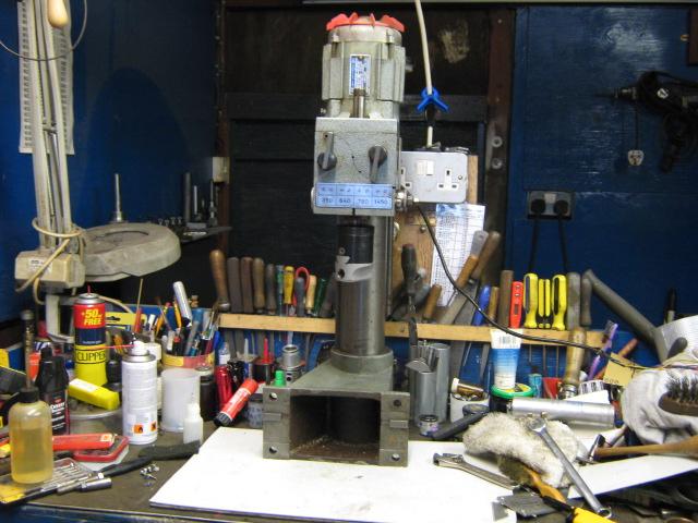

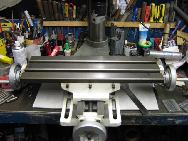

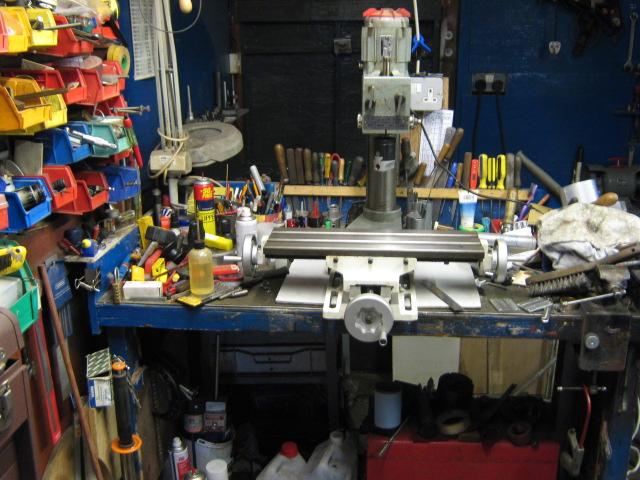

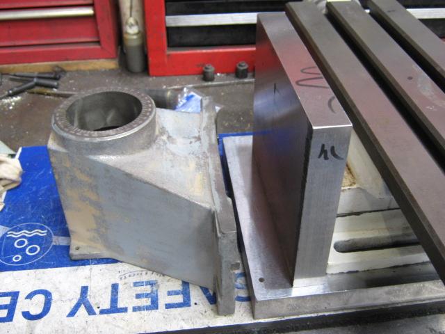

hi all not posted much as I ant bin up to out but john got a X.Y table of a chap sos john did give me your name but I have forgotten it so back to the plot went looking on the bay and came a cross a emcomat 7 milling head all the way dawn the other end of the country  I won the bid so me and me friend  David went to pick it up set off at 6 in the morning got back 6 at night any way I need to make a base plat a bit like a angel bracket to put the two together right sum pics

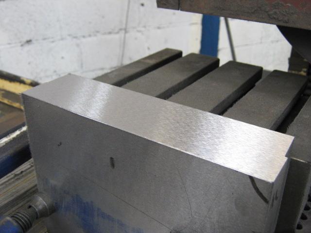

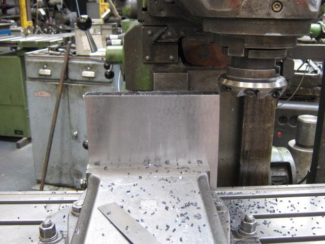

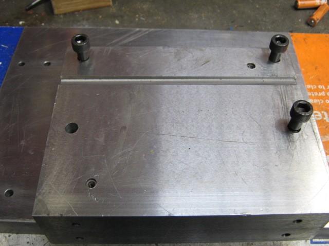

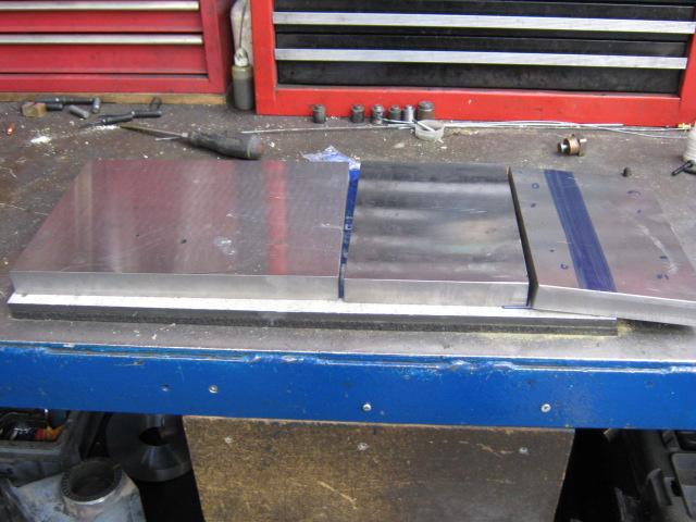

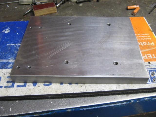

hi all thanks for the comments thanks al so for the offer of sum plate but that's one thing I have a good supply of I work as a tool maker and thick plat is never a problem any way got to work this morning and had a good rut at watt was lying a bawt got an old  base plat 30mm thick so cut it in to lumps and set one of the apprentices to start and mill them to shape yes I no its cheating but it learns them haw to clock big lumps up any way tonight first mod  the handles on the X and Y was to say the least shocking m8 hole but the shaft of the screw went from 7.6mm to 6 mm and the hed's was no beter   so mad new ones up the next thing on the list is to fit locking handles to the X and Y tables and on the mane column right pics
Re: home made mill
« Reply #5 on: July 02, 2016, 03:42:38 PM »

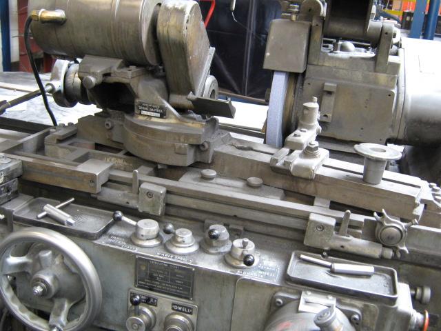

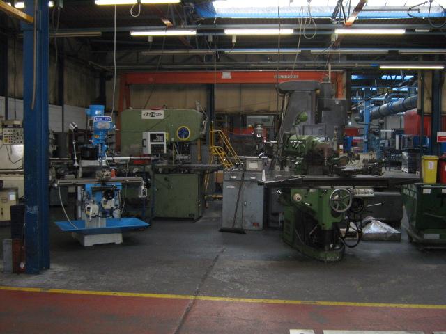

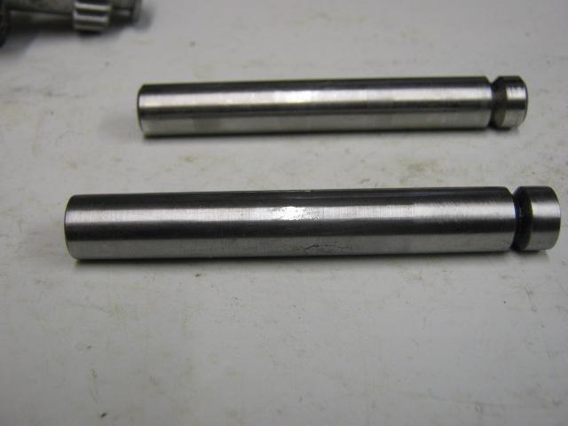

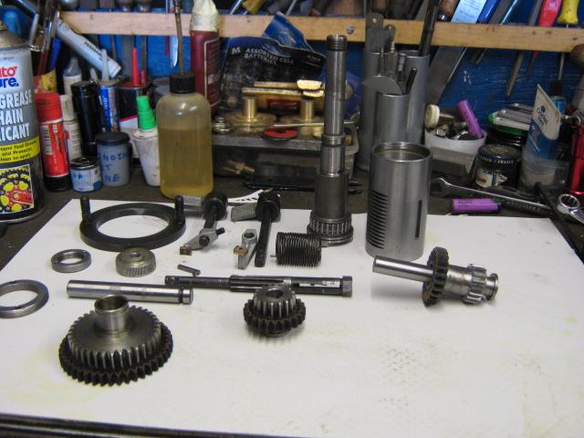

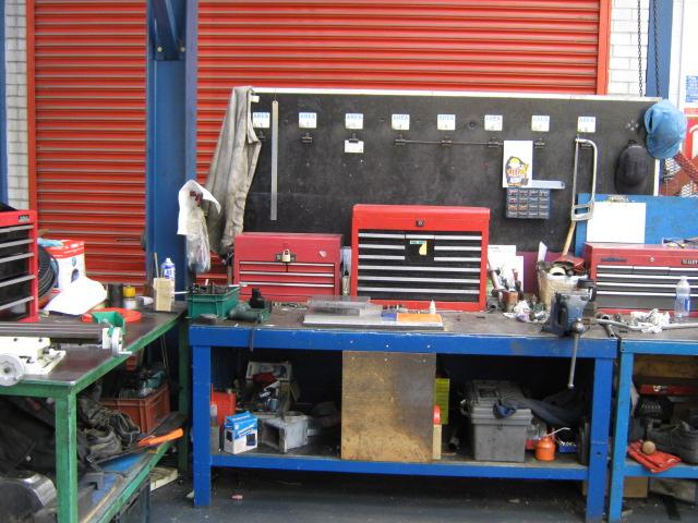

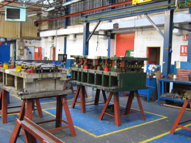

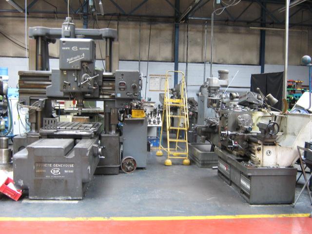

hi all things have bin going slow with the mill I striped out the head all of the bearings need replacing one shaft badly scored made a new one

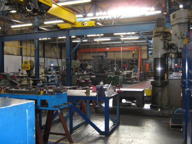

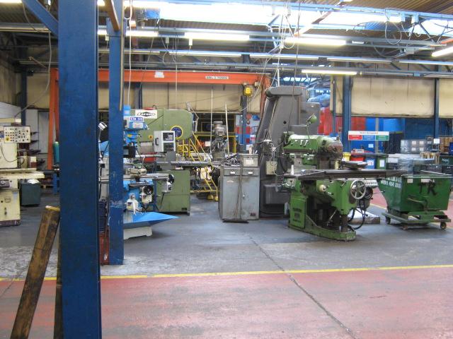

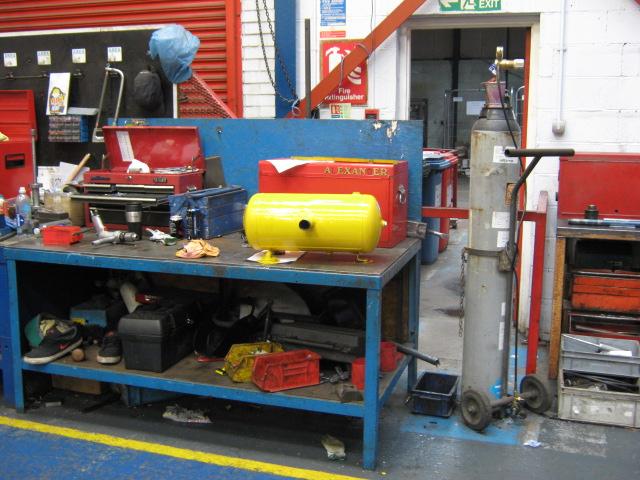

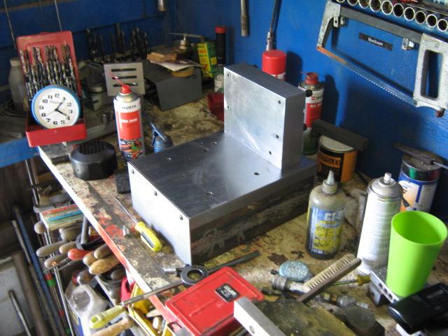

went to work this morning did watt I had to do then set to on the two plats that will be the upright ruft  them dawn to size then grind them to the proper size plus sum pics of the mashean  shop right pics

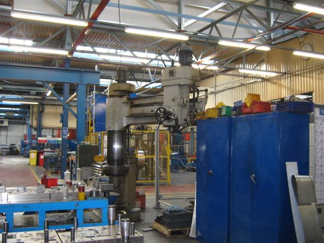

more work shop pics

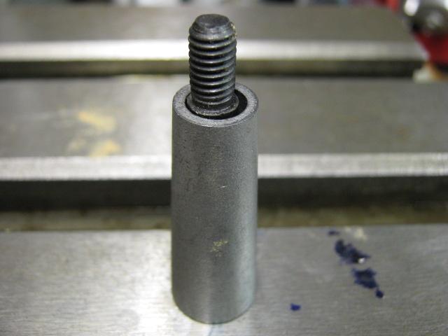

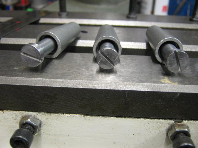

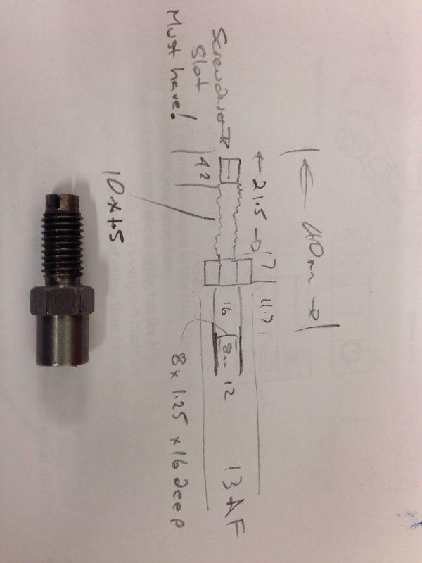

well can any one help the draw bolt on the mill is m8 but the MT2 sleeves have a m10 thread in them  their is sum sort of thread adaptor that goes ether on the draw bolt or in to the tooling can any one help with pics of the item I need to make up will post sum more pics soon

Hi Krv,
  Here ha go! Hope the sketch is clear enough, if not please ask!
Cheers Kerrin

« Reply #9 on: July 09, 2016, 06:42:22 PM »
Those workshop pics are tool porn :drool:.
Re: home made mill
« Reply #10 on: July 10, 2016, 03:48:35 PM »

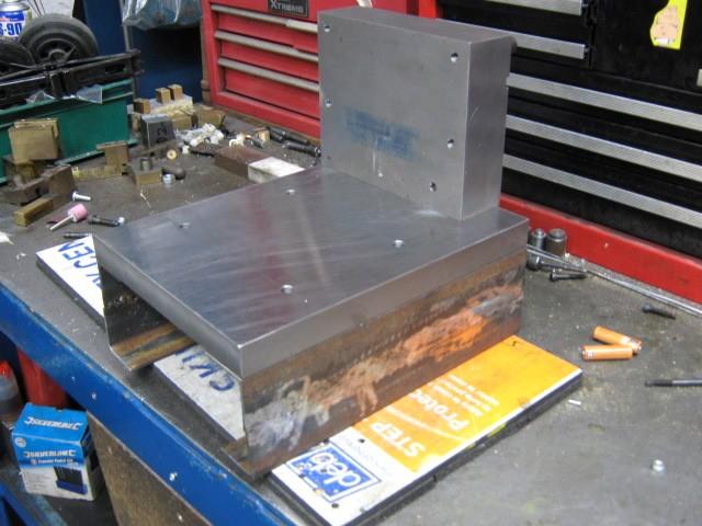

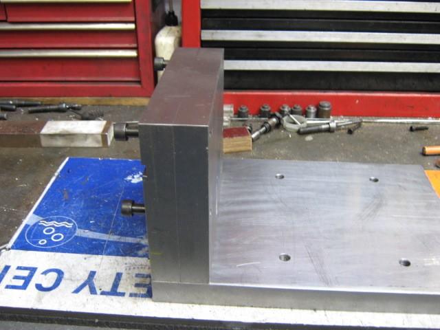

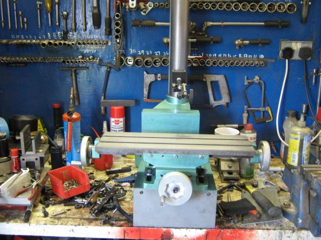

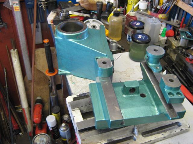

hi brill thank you  the mill base is al most dune made two uprights to stand the base plate on to all I need to do gnaw is make two plates fore the front and back right pics and more pics of the woks tool room and I don't no if you all can remember me getting a tool box of john well that's the one with big boy on it

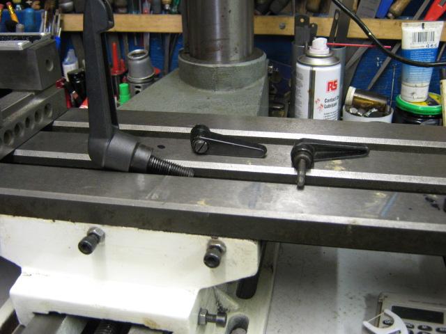

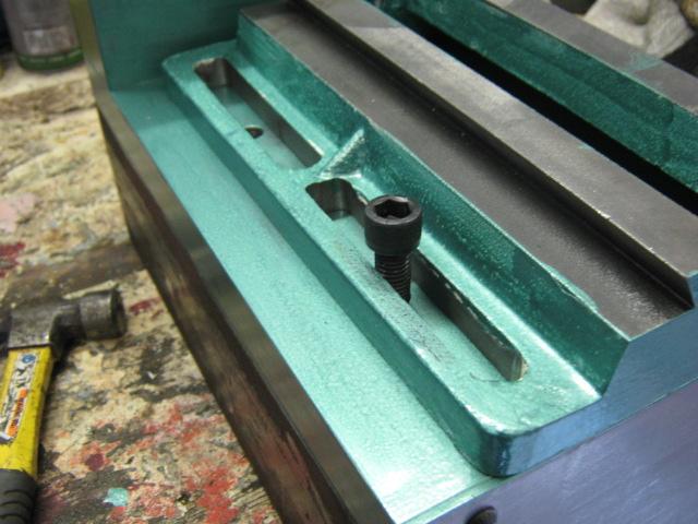

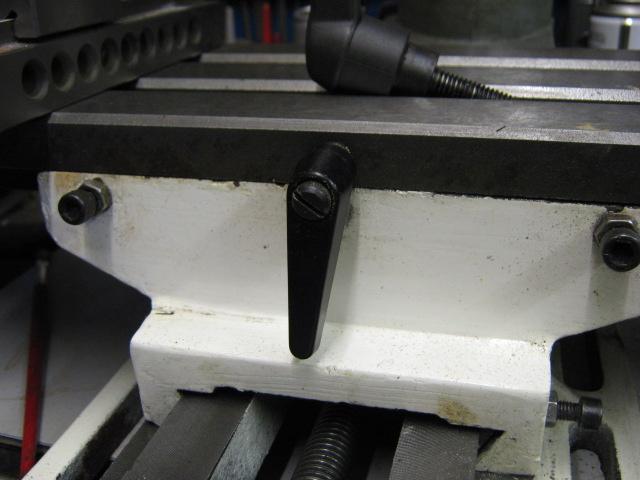

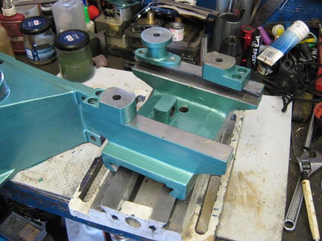

hi all not much bin happening with the mill its all back home drilled two holes for the locking handles and started to pant things up pics     o and a few hols to tap for a home made angel bracket

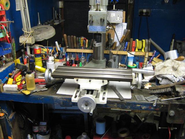

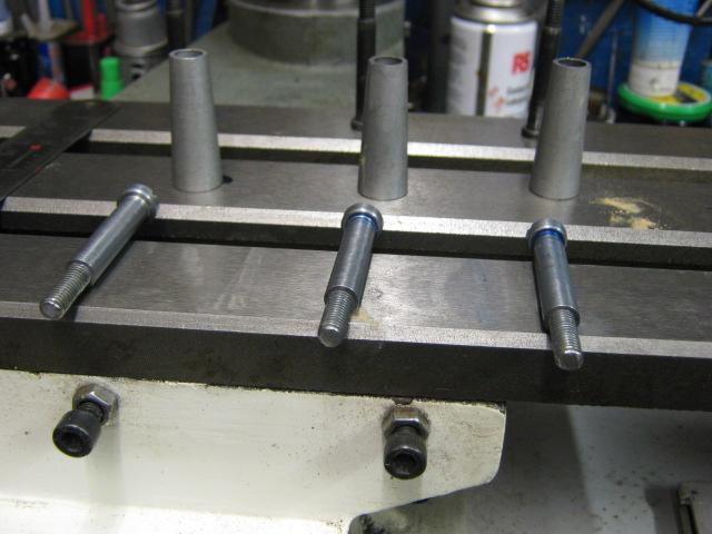

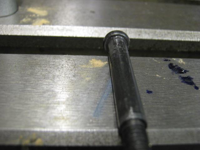

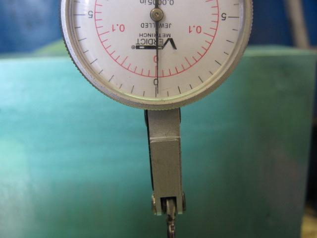

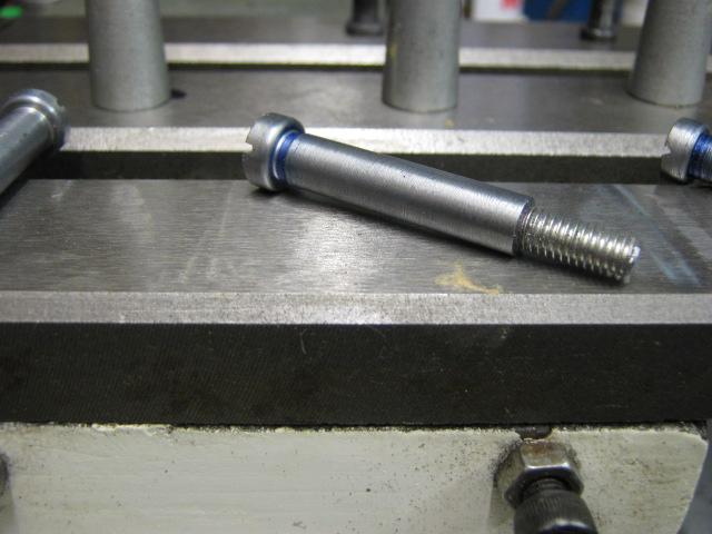

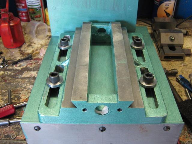

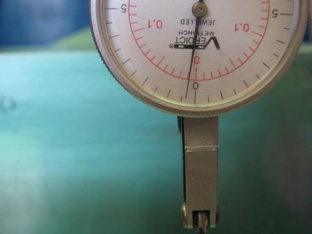

hi all thanks for the comments all but dun gnaw as im on holiday I have had sum time to put the z and y bit on the base I had to make sum washers for the 4 fixing bolts there 5 mm thick od 32 mm with a 10.2 hole then just put it all back together and clocked the table in so its running parallel with the column run out at both ends the same with a dip in the middle I need to make two bushes for ether end as their is to much play in the end brackets and to drill them to put oilers in the next big job is I need to make a spacer block  to bring the head of the mill to the centre of the table  right pics  first pic of the dti is in the centre then next left then right

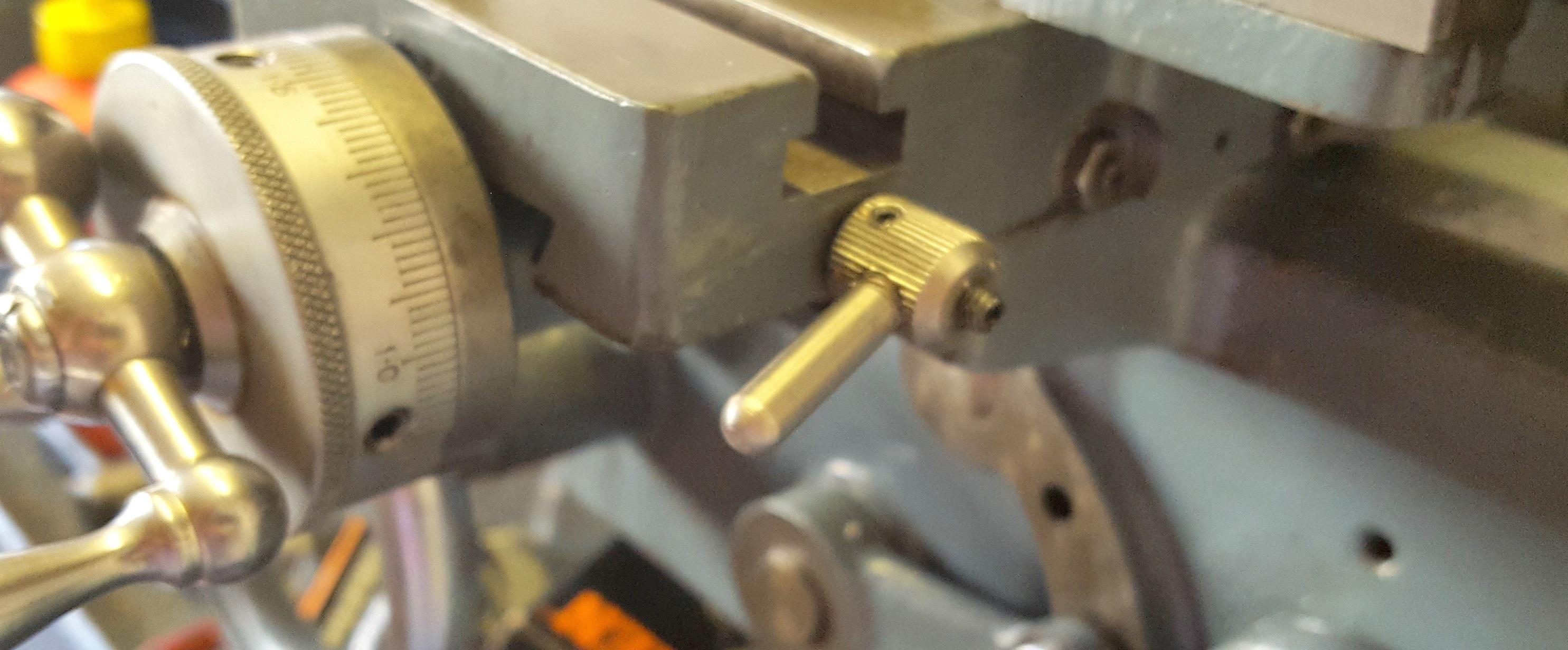

You can't lock the cross slide.
Locking the saddle will prevent most of side to side motion, and tightening up the slide gibs helps.

I fitted an extended screw in place of the standard gib adjuster and fabricated a small lever. I can now lock my cross slide. This is on a Boxford.

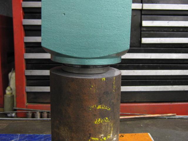

 yep seems to be a conmen problem im on hold at the moment I have got the lump of bare to make the extension to bring the mill head over to the table just had no time to set it up to bore the male fitting will get their soon

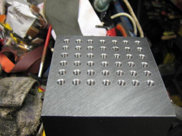

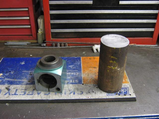

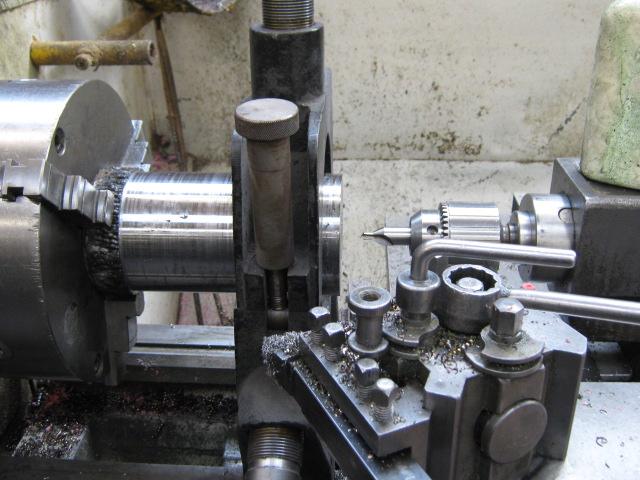

er you have lost me it is all redy bolted on the back will take sum pics to show you any way as at work tomorrow so will be starting on the extension to put the head over the table  so I will be posting pics if I had a fixt steady for me compact 8 then I wood have dun this at home. and john is going to  have a bit play with his new mill two mill out the two slots for the nuts to go for tinting it to the coelom head
don't like doing things at work as to me its cheating as a lot of people on hear only have watt they have in their home work shop   and not a fully kited out tool room
Re: home made mill

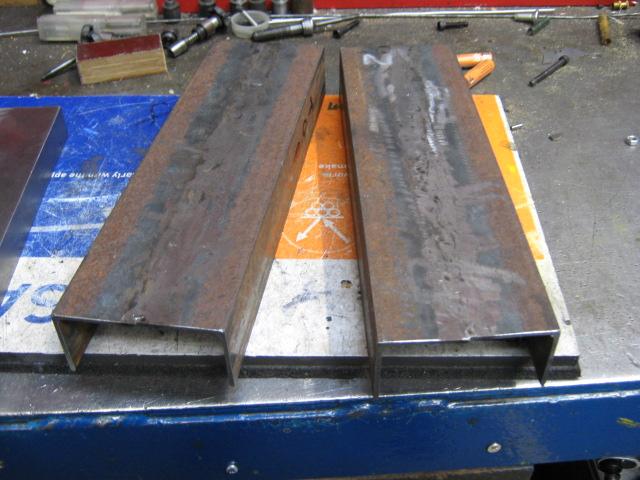

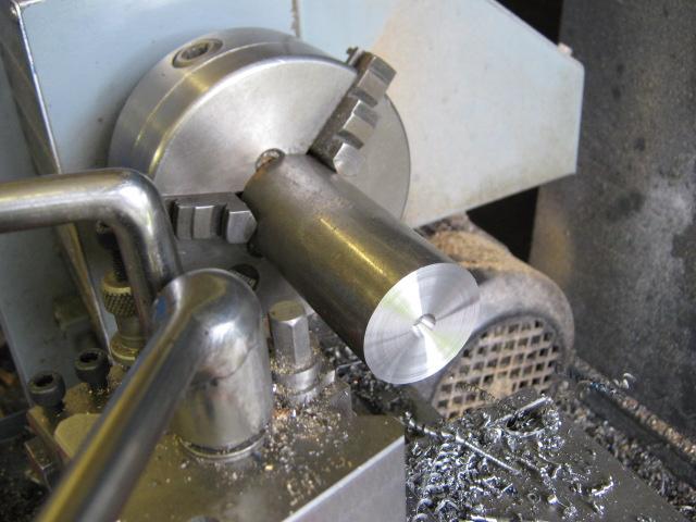

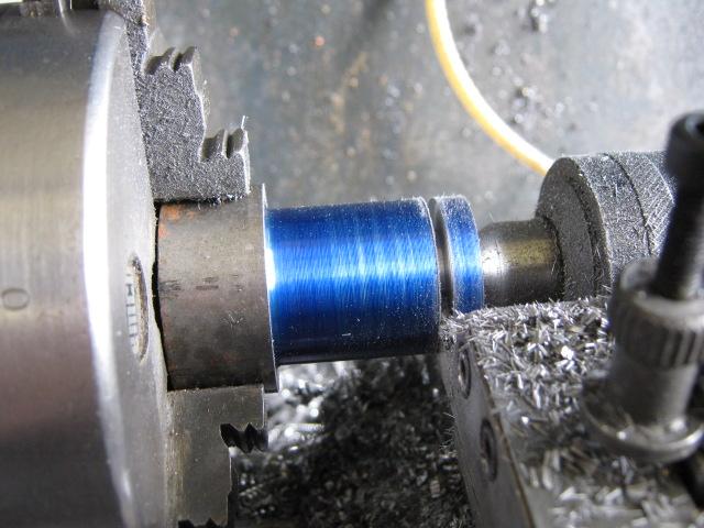

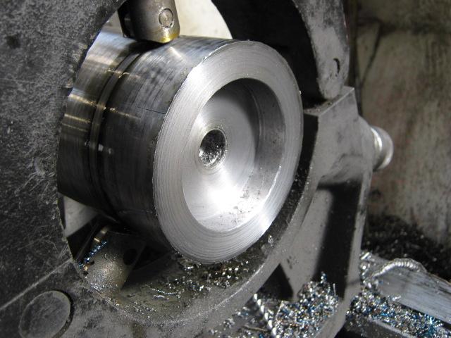

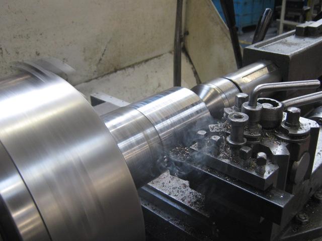

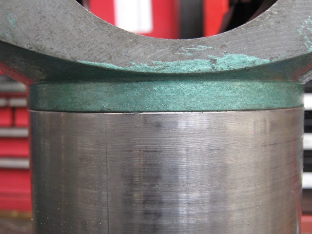

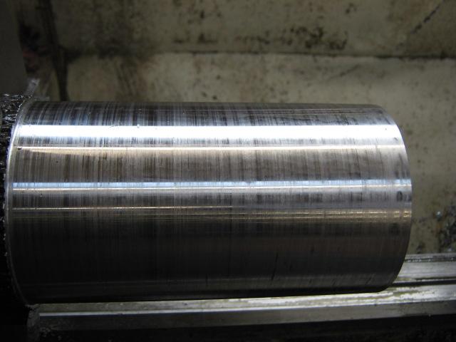

« Reply #24 on: October 01, 2016, 03:05:36 PM »

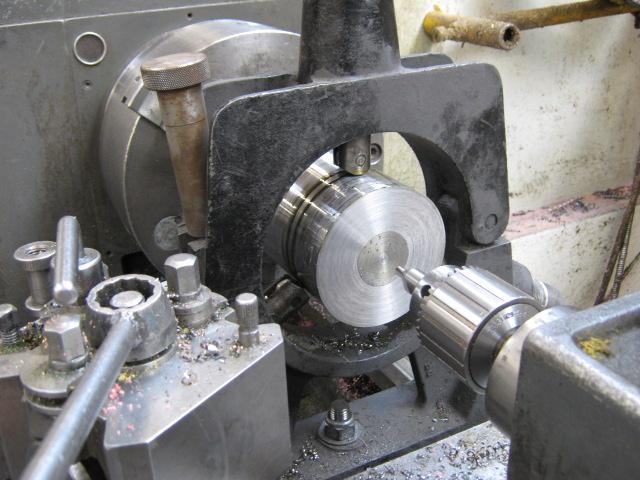

hi all as promised the bare stock was spot on  100mm so I had to put sum weld on it to make it bigger  but before I did that I marked out the centre for the running centre to go in to then I lade dawn sum weld the finish size is 100 mm but the bar was not even so did this  to give me a nice finish I then set it up in the lathe and just turned it dawn to 100 mm there is sum holes where I have not put a nuff weld on these will just be field in as its not critical as it will be panted   then set up the fixt steady to bore out the end it needed to be 15mm deep by 70mm wide all dun the next step is to get it to john's to drill and put the two cut outs in for it to fit on to the Colom head right pics
