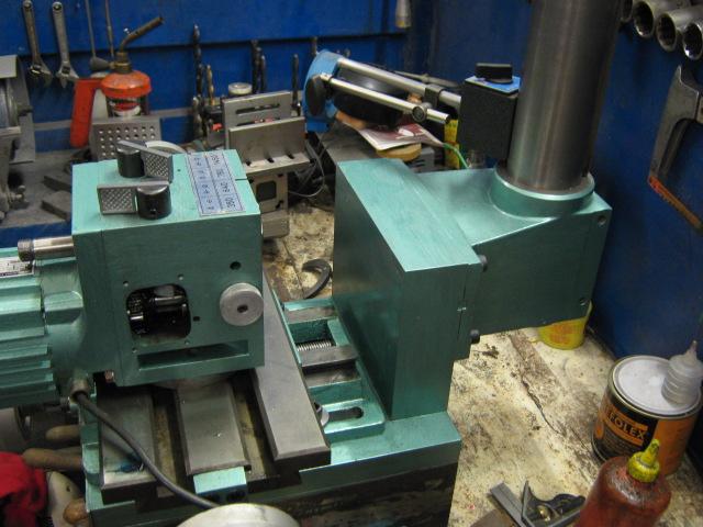

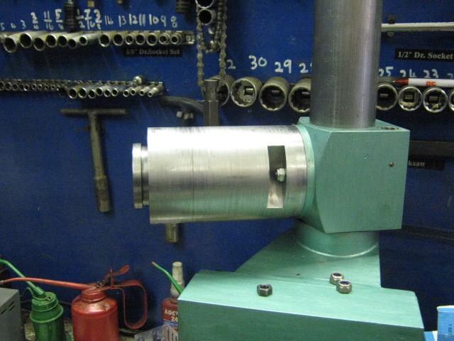

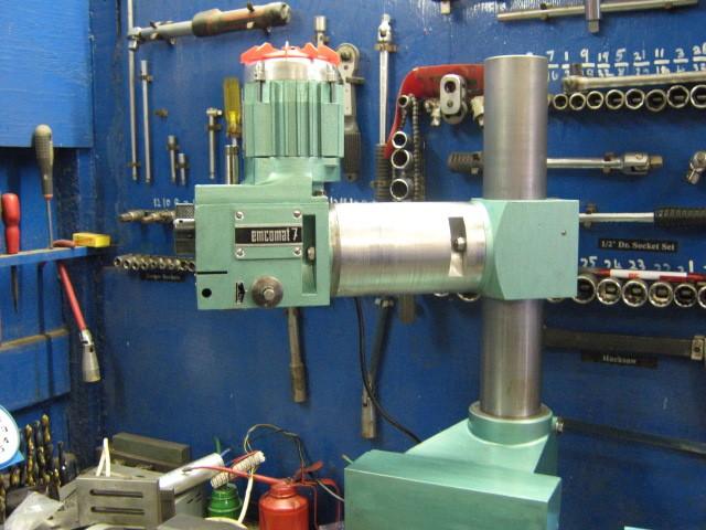

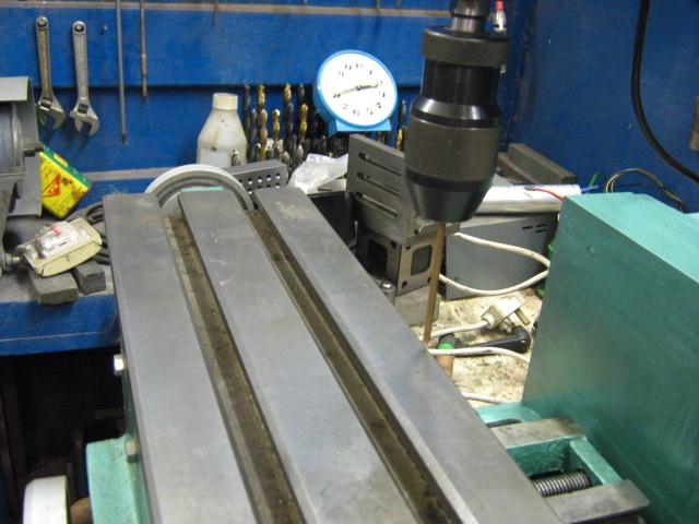

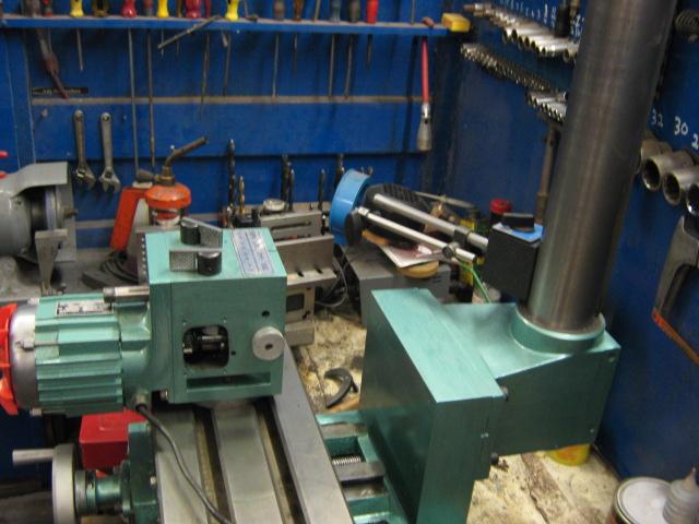

DavidA  hi hear is sum pics of the mill Colom I can move the Colom all the way from left to right   and there is a pic of watt john has to cut in to the extension right pics
Re: home made mill
« Reply #26 on: October 22, 2016, 03:38:44 PM »

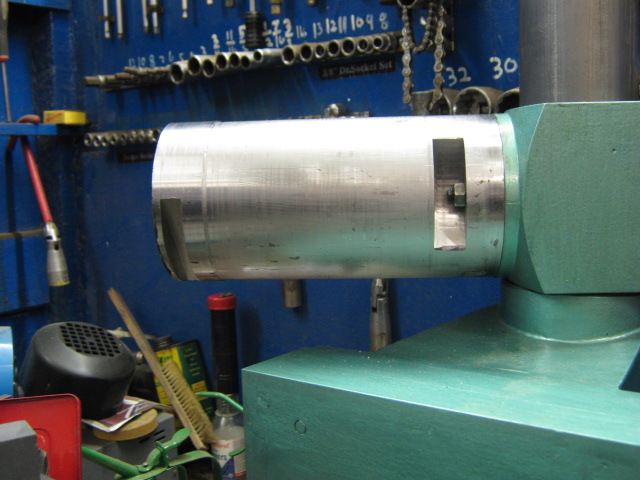

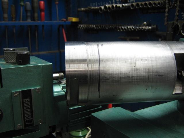

hi all john milled in the two cut outs for the two nuts that will hold the extension to the Colum  and a brill job he did thanks john
set the extension up today to find out haw much of the extension needs cutting dawn by the length of the extension will be 130MM long by the time I mashie the end right pics

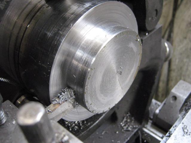

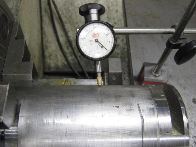

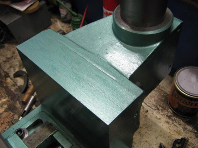

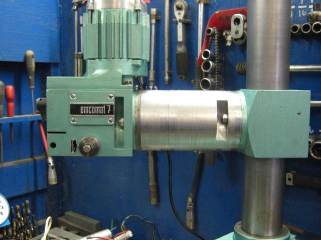

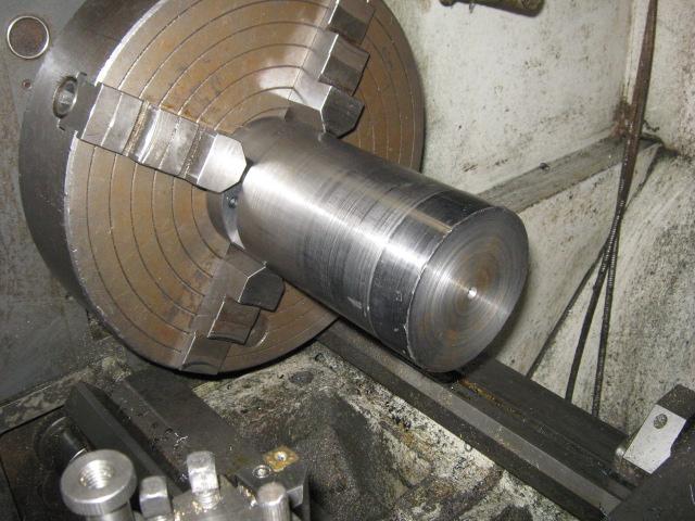

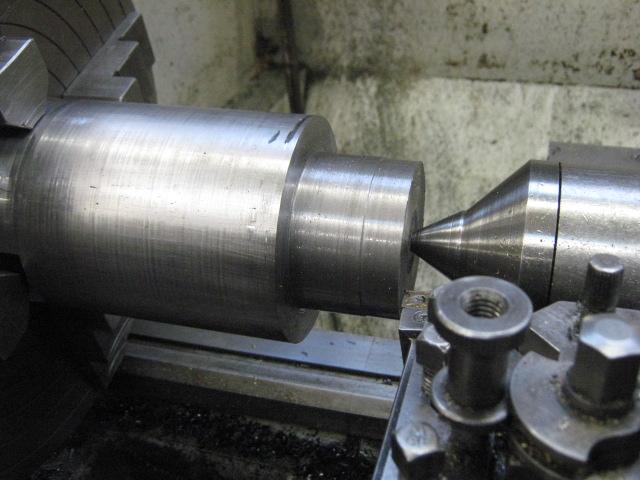

hi all on the final stretch was at work today so I finish off the mill head extension set it up in the 4 jaw chuck then clocked it in  then took the end dawn to size then to length then put the grove in for the clamping brackets will put sum more pics up tomorrow of the hole thing coming together right sum pics of watt was dun today and thanks for all the comments

Looking good Bob
Re: home made mill
« Reply #31 on: October 29, 2016, 04:51:07 PM »
thanks john will get it all together tomorrow

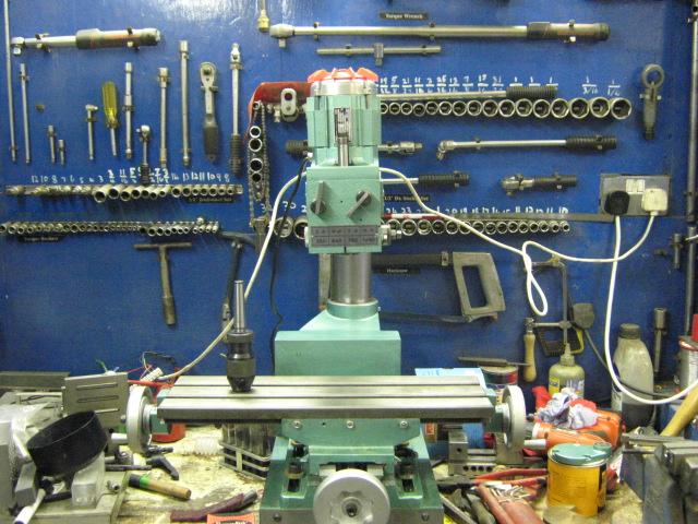

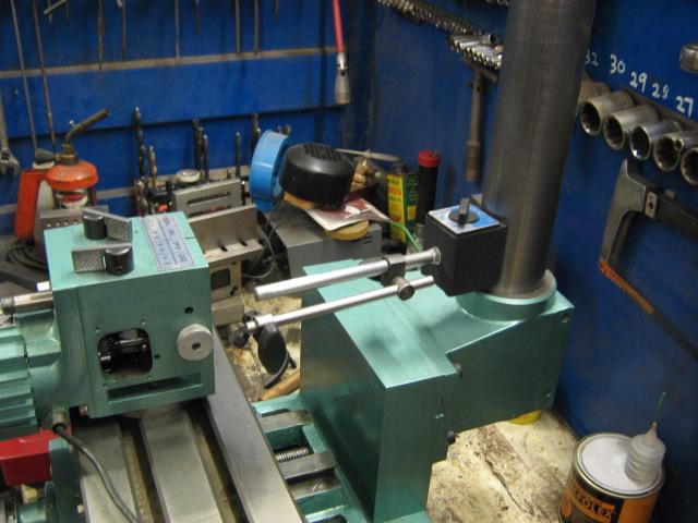

hi all well the extension fits but im going to have to make it lighter so this will involve cutting it in have then boring etch have out then welding them back together that ant a problem all that needs doing gnaw is make a stand for it sort out the electric's on that point dus any one no the type of capacitor needed for the motor the one that's running it at the minute is my sper one of my lathe any way pics as promist

Looks good Bob , why do you need to make it lighter?  Is it not raised a d lowered by screw mechanism so would lift ok and be more rigid ?
  Keep up the good work Bob , it's almost done  :thumbup:
 Cheers Mick
Re: home made mill
« Reply #37 on: October 30, 2016, 06:59:44 PM »
yep its raised by a screw but its jamming on the Colom not a problem going up  but jams on the downward move support the mill head not a problem I don't think I will loos out in boring out the middle  will still have a wall thickness of 30mm carnet go bigger as it will go in to the slots that john made

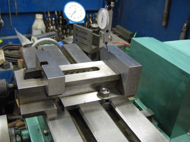

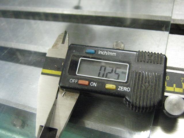

hi I will get the in fo off the motor tomorrow the length of the extension is 6 inches mad it that long so the mill head will cover the with of the table from front to back  im going to clock the head in tomorrow night so their will be sum pics of that on tomorrow    thanks all for the comments
Re: home made mill
« Reply #41 on: November 01, 2016, 06:05:01 PM »

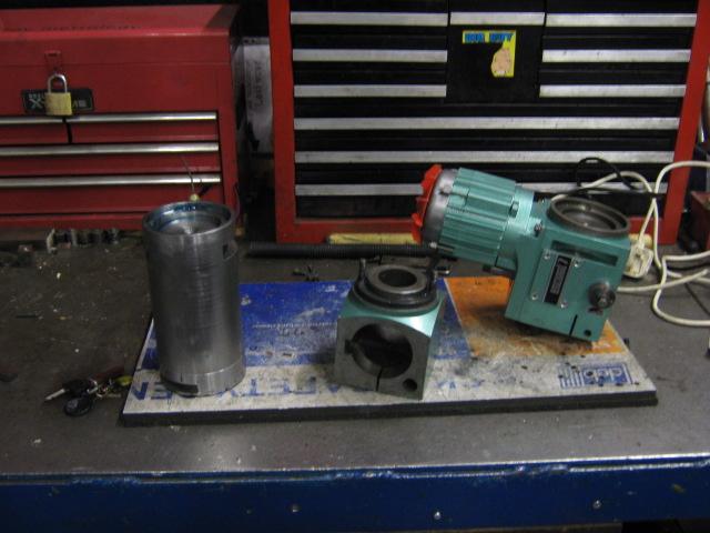

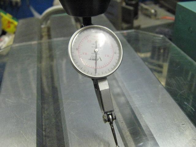

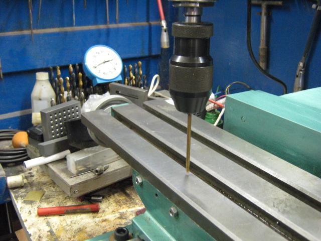

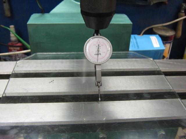

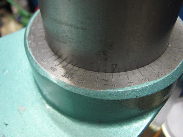

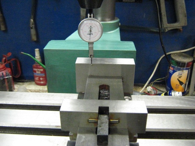

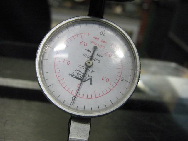

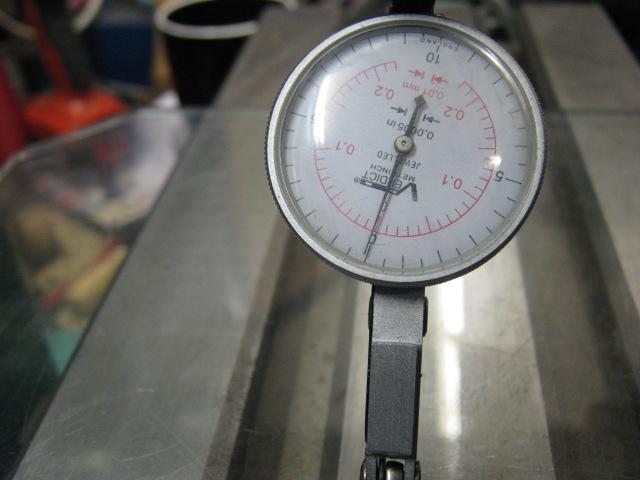

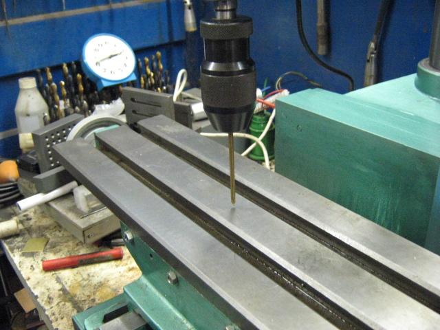

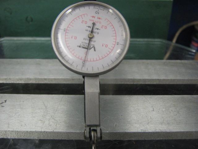

hi all just a bit more clocked the head in tonight I had to put sum 0.25 mm shim in the top you will see them in a pic to tilt the colam over to clock it in put the vice on and clocked that in to I need to make sum t nuts up right the in fo  on the motor is sa follows TYPE AOR-63-4
D/M 0.18 volt 440 amps 0.55    55Hz U/min 1380 KW 0.24   N.R 617103 and the make of the motor is wiener starhstrom  werke right pics
