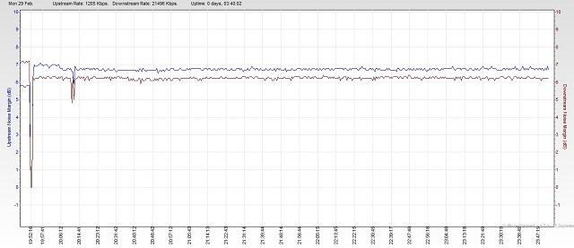

Well interesting results today  :ddb:
Before Mr BT arrived, by chance I was running a logging program, reading noise margin figures from the Home Hub 5a, and charting them. Then the 'phone rang, one of those nuisance calls that this time did me a favour  :lol:
The noise margins went all over the place and the Hub disconnected and restarted! When it was back up, I called my number from my mobile, and sure enough I could reproduce the effect  :thumbup:
So bright and early, Mr BT came, put his magic gizmo on the line, pressed a few buttons and diagnosed "Rectified Loop Fault' - most likely a damp connector block somewhere. Well the outside line comes from a pole in the road, to our gutter board, down the wall and appears on the other side of the lounge where the Master Socket is - but the Master socket has internal type wire, whereas the outside line disappears into the wall in external type cable. So there must be a joint box under the floor. 'There's your fault' he says. Hang on says I - prove it to me, ladder up to the gutter board, cut the cable and test again BOTH ways - into the house and back to the Exchange. He does this and guess where the fault is? Yes - on the line to the Exchange (Phew !!!!)
So off he trots to the Street Cabinet (which is over a mile away) does a few things, runs his tests again - ALL CLEAR. So what did he do? Used a different pair from the Street Cabinet to the Exchange, and used a different pair from our gutter board to the Cabinet (luckily it's as two pair)
The ONLY bit of cable unchanged it that under our lounge floor AS IT's OK  :lol:
Hub up and running, seems immune to incoming calls and connected at 22 Mbps  :clap:
Early days of course - only been up an hour or so  :scratch:
Graph attached: 1st disturbance was the nuisance call, 2nd disturbance was me calling on my mobile.

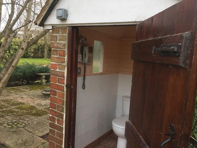

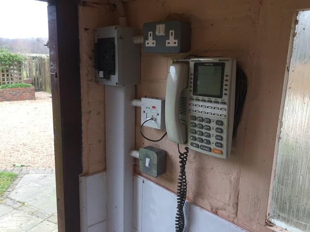

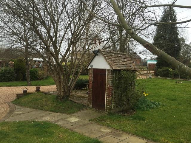

  • Country: ie
Re: Any Telephone Engineers on the forum ?
« Reply #14 on: March 18, 2016, 03:48:35 PM »
Jeez, How much time do you spend in the outside loo to need a dedicated service?? :bugeye:
 :worthless:
We want to see your Bog!
  • Posts: 9051
« Reply #15 on: March 18, 2016, 04:00:03 PM »
I wondered if anyone would pick that up and run with it  :lol:
When I was trenching new soil runs in from the house to our private sewage system, I decided to resurrect the old outside loo as the trench went right past it. As I was also putting in water  pipes and trunking for mains cables to it, I decided to go the whole hog and run telephone extension line and a CAT5e leg from the nearest patch panel.
The idea was to put a WiFi access point in the loo to cover the garden, but in practise I never have. However having a telephone extension there is very handy if the phone rings and we're in the garden  :ddb:
  • Country: ie
« Reply #16 on: March 18, 2016, 04:06:09 PM »
Andrew, I commend your forward thinking:
"If youy are going to a job do it properly!"
  • Posts: 9051
« Reply #17 on: March 19, 2016, 06:28:53 AM »
Here you are Will, just to satisfy your toilet picture fetish  :clap:
You can even see it from space - see the last picture  :lol:
Offline modeng200023

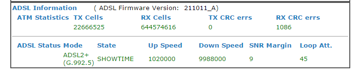

This is a bit off topic  :offtopic: but I had a problem with DSL and my Actiontec M1000 with drop outs and reboots.  Century Link said it was my modem so I changed modems after considerable back and forth testings and conversations with tech support.  That temporarily solved my problem.  I being an electronic tech sort of guy opened up the original modem and found bulging caps so I replaced them and it has worked perfectly ever since only have a few dropouts over 6 months.  I also opened up the second replacement modem that was as used unit also and found the same bulging caps and a few more.  I replaced those too and retested with the same good results.
