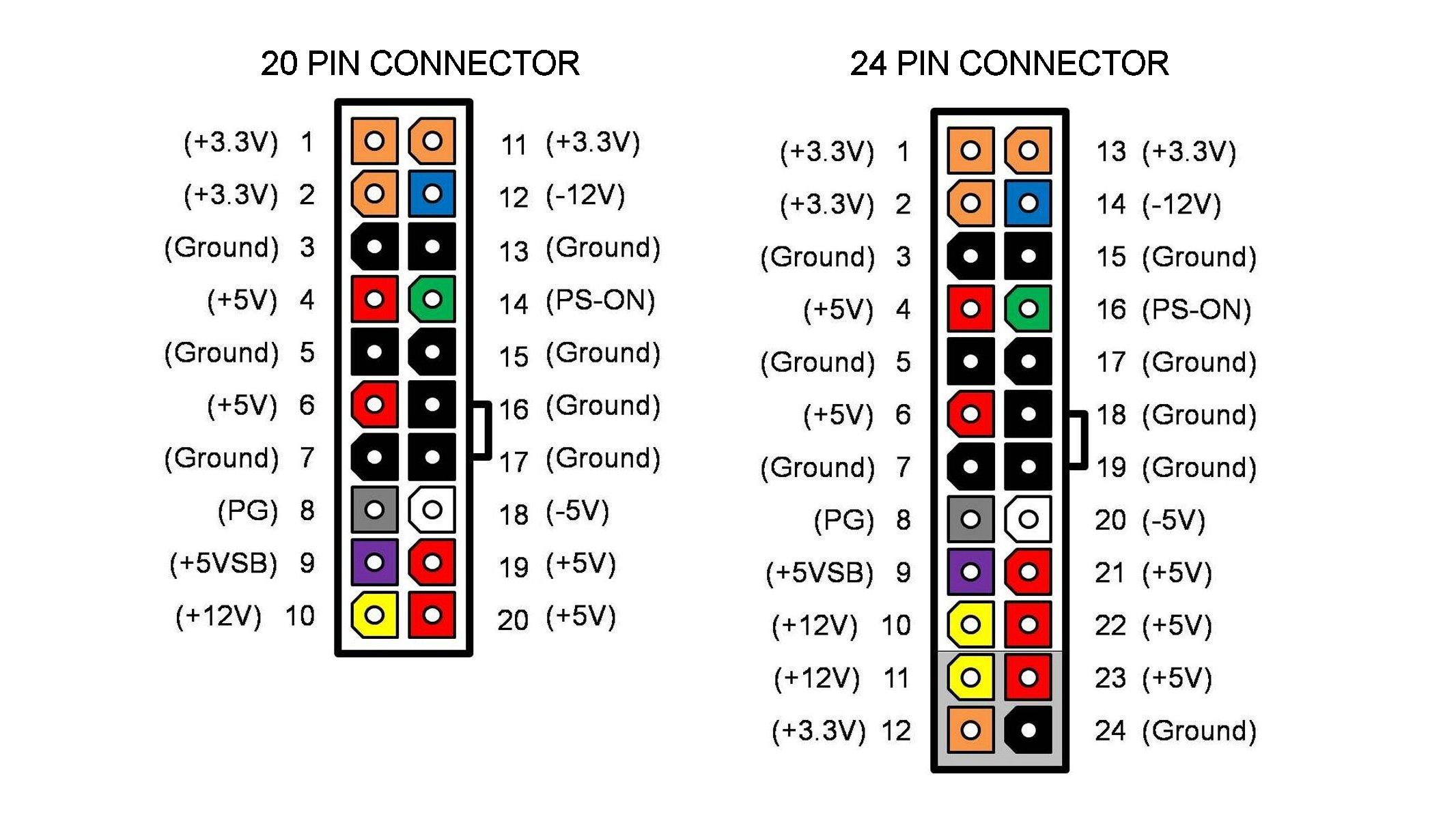

which kit did you get, it sounds a bit fussy needing various voltages.
do you have a power supply in mind?  I know computer power supplies give +12 and +5, I don't know about -12 tho.
thanks for the heads up on the battery connector, I'll test mine first, I've ordered the case for it as well but it hasn't arrived yet.
Roy.

Hi Roy
Cheers for tip about  the computer power supply  :thumbup:
You going all up market on us and getting the case   :clap: :clap:

  • Posts: 2559
Re: Digital oscilloscope project/kit
« Reply #65 on: December 29, 2015, 02:48:27 PM »
Many of the older style at power supplies had -12v for the genuine serial rs232 ports..... If you come across summat that might be useful, check the label on it...
I think modern day psus dont cater because of usb.......
 A suitable supply can be made from a 9v ac transformer, 2 diodes, a couple or three capacitors and a 7805 regulator.....for starters...
Shout up if any help needed... :zap: I'll try and find someone who knows about this stuff... :lol: :lol:

« Reply #67 on: December 29, 2015, 02:53:51 PM »
I think i have a spare 300w unit in the shed Rob. Ow! and an adapter to link to it to give the screw conector thingy's. I made a couple for mates a while back.

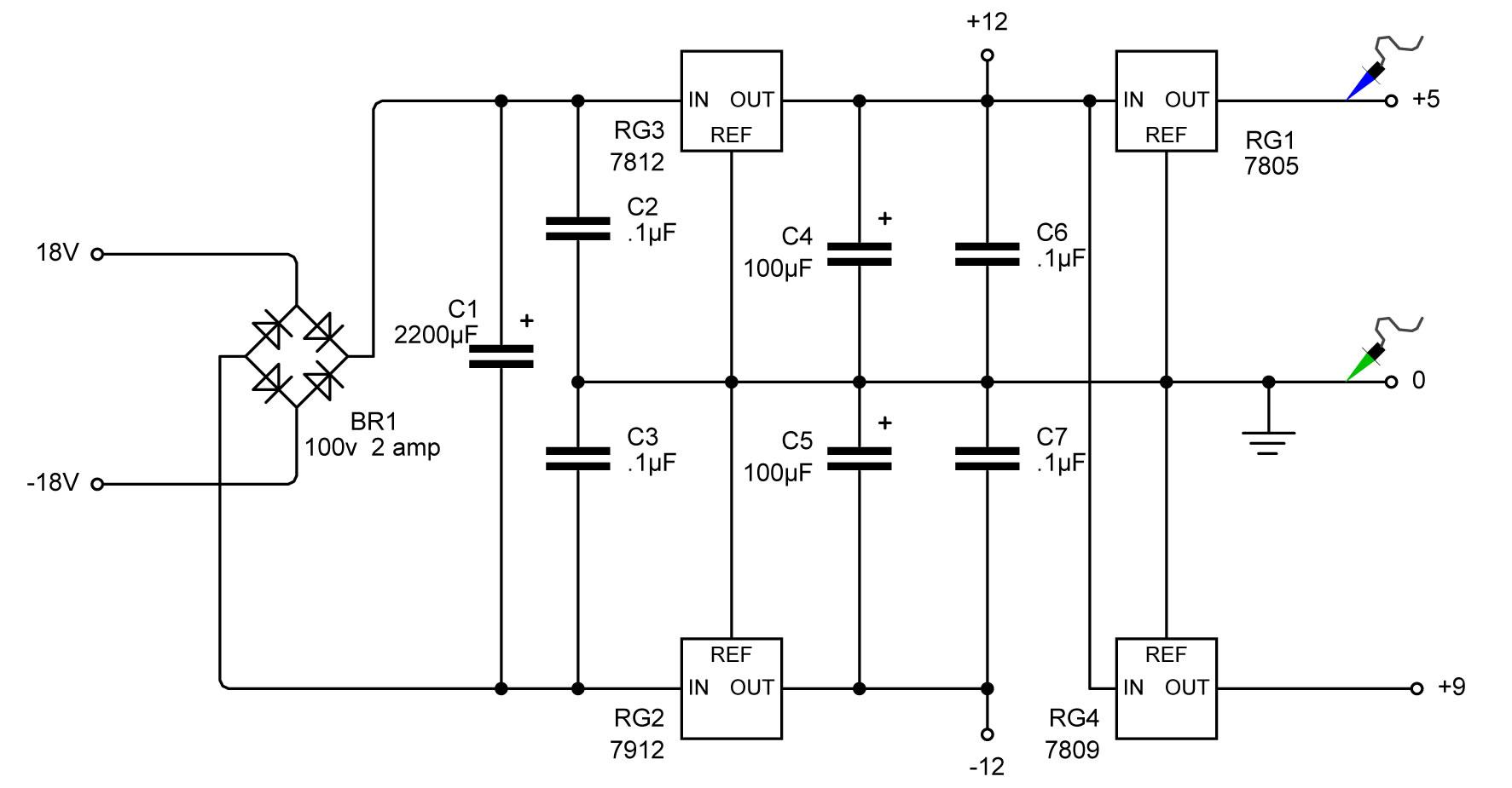

Thanks for the link to ,interesting and helpful . I think you can now get a breakout board for computer PSU's
I have attached the PSU  circuit drawing ( re done by my very own hand )  that came with the function generator .
Cheers Rob

The Signal generator project arrived from Banggood yesterday , so I welded all the bits together today  :zap:
http://i1066.photobucket.com/albums/u410/RobWilson100/Electronics%20Projects/P1100775_zpslupqngow.jpgDigital oscilloscope project/kit
http://i1066.photobucket.com/albums/u410/RobWilson100/Electronics%20Projects/P1100776_zpsiizlugbd.jpgDigital oscilloscope project/kit
Cant test it until I build a power supply for it  :coffee: , also the PSU circuit diagram I posted earlier has a couple of faults  :Doh:
#1   the supply needs to be more like +18 - 18 volts   as a 12 regulator needs more than 12 volts
#2  the  -12 rail needs a 7912 voltage regulator not a 7812  ,the  7912 is a -12v  reg   .
Cheers Rob

« Reply #72 on: December 30, 2015, 12:33:21 PM »
Going to cobble together something like this  :zap: :zap:
http://i1066.photobucket.com/albums/u410/RobWilson100/Electronics%20Projects/Circuit%20Wizard%20-%20Power%20Supply_zpsxzpyjuet.jpgDigital oscilloscope project/kit
Rob  :coffee:

Rob,
Nicely assembled...  :clap:   Looks pretty neat and tidy....Hope it works for you..... :zap:
Just be aware that the pin outs for 78 and 79 v regs are different.......
The + 12v reg may need a heatsink on it too as its supplying  current for the 9 & 5 v regs....
« Reply #74 on: December 30, 2015, 01:03:24 PM »
Rob,
Cheers John , if you see the northern lights tis just me going up in smoke  :lol:
The reg pinout got me on the simulation ,,,,,,,,,,was wondering why I was getting -18v  when it should have been -12 v ,,,,,,,,,,,,,,had the 7912 wired wrong  :palm:
I have ordered heatsinks for all the regs  :thumbup:
anything else you or anyone could recommend to improve things   ?    :wave:
