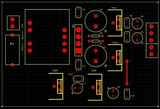

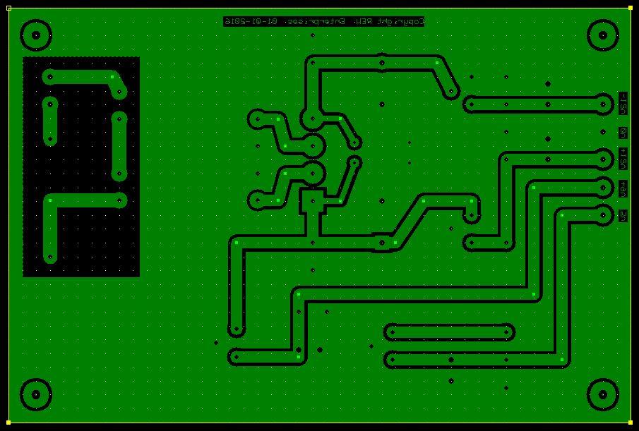

Here you are, Rob ...
PCB for your PSU, not including diodes & LEDs ..
Done on ExpressPCB. Took about an hour.
Re: Digital oscilloscope project/kit
« Reply #105 on: January 01, 2016, 04:25:13 AM »
Morning and a happy new year to you  Dave   :wave:
You missed off my transformer lol , Your layout looks allot more efficient / better than mine  :thumbup: , I like the way you laid  out the  regulators .
All the best , Rob

Nicely done Dave... :bow:
Rob, the tranny connections are at the lhs side of the board..... To the left of the bridge...
If I were building it, I'd use a Molex 3 pin plug on the transformer leads, and use a matching 3 pin header on the board...a much neater approach rather than direct wiring but to each his own.... :D

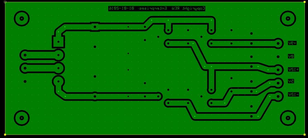

Here you are, Rob.
PCB Tranny now in. Looks a bit messy  :scratch:
Back to my Becks & cashews ..  :beer:
Hope I've got 'em re-sized properly.
EDIT1   Near enuff ...  :loco:
EDIT2   Each dot is on a 0.1" pitch

« Reply #118 on: January 01, 2016, 02:53:08 PM »
Dave,
I know you done well...... :bow:
But I think the distances between the copper infill are a bit close around the transformer.... :scratch:
I prefer at least 6mm creepage distance for safety... :zap:
Just  my 2 cents....while drinking my Carling cider.... :coffee:    Enjoy.... :)
« Reply #119 on: January 01, 2016, 03:10:33 PM »
My electronics /PCB software can't do a ground plane   :scratch:
Rob,
Are you sure?
I managed to do a copper pour to fill. What i couldn't do was neatly connect a pad to the plane. I've uninstalled it now so can't tell you exactly how to do it.

Dave,
Yes, quite right, there should be more clearance.
Did it when I was sober, [ or very nearly ], brain would be lacking some essential toxin and thus not on top form.
Rectified now. Back on full power, like a re-gunned CRT.
