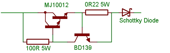

Ok lads
A question for the electronics chaps ,   I would like to build a circuit that would charge up a bank of capacitors to anywhere between say  10v  to  35v and when charged  to the set voltage disconnect the power supply from the capacitor bank .
Any pointers ?   :scratch:
Nope, no Pointers, mates got a Staffy  :lol:
Depends on what you want to do, I'd use a PIC, one analogue channel to read a pot, and set the reqd. voltage and another to read the cap. bank volts.
Use one digital channel to drive a relay to disconnect when it's up to what you want.
How big is this cap. bank anyway ??  Not a good idea to try to charge a damn great heap of the things from zero without some attempt at a current limiter. A big cap. is close to a short circuit at initial switch on ...  :zap:
Stresses the rectifier no end ...

I was planning  to use a current limiting resistor to charge the caps .  As to the size of the cap bank thats still a big question mark  :palm: , I would like to build a small cap discharge spot welder

Ok lads
The details depend on things like how: how big the caps are, how fast you want to charge them, and what your input voltage to this circuit will be.
But essentially you would use a current limited power supply set to the target voltage and a diode. Very simple for small (ie <=10A) currents.
PK

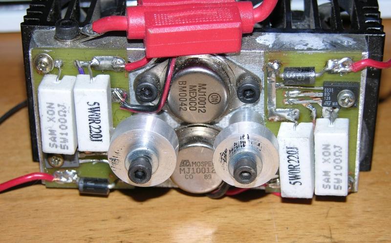

« Reply #337 on: May 04, 2016, 06:27:50 PM »
A simple constant current circuit is better than a resistor because it will allow faster charging.
I used this for a small anodising supply once.

« Reply #338 on: May 05, 2016, 12:30:47 PM »
That sounds a much better idea PK  :thumbup: , something I will look into .

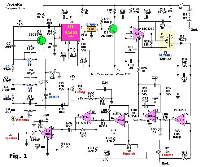

« Reply #339 on: May 06, 2016, 05:30:07 AM »
update on my non working airband receiver.
it's still not working. :doh: :doh:
I've checked all the elec caps, the're round the right way, all the chips are right way round in the correct places, I unsoldered one leg of each diode ( 4 in total ) and tested those, the're the right way.
the transistors are the right way according to the silkscreen.
I even pulled all the chips to check if I folded a leg over inserting them, all OK.
I'll try some voltage checks next.
Roy.

« Reply #340 on: May 06, 2016, 07:06:58 AM »
Roy, when you say its not working, can you elaborate a little please? Is there any audio?
Maybe theres no air traffic transmitting? :lol:

« Reply #341 on: May 06, 2016, 08:47:58 AM »
sorry, I was a bit vague  :hammer:
connecting the bnc socket to a long wire I have in the loft and touching the top of one of the chips with my finger I can barely hear a commercial radio station.
the 3 controls do nothing.
this is with a 9V battery, if I plug in a 12V wall wart the transistor mentioned previously gets hot even tho it's supposed to work on 12V.
there are a few voltages noted on the circuit diagram that came with it , one of them being 12V but there aren't as many as I would like.
I haven't had time to check them yet.
Roy.

« Reply #342 on: May 06, 2016, 10:19:02 AM »
Hi Roy
the original project is here -
http://www.sentex.ca/~mec1995/circ/aviarx/aviarx.html
with 1K load resistors I don't expect the transistors to run hot
 but the TO-92 cased 78L08 regulator added to the Chinese circuit  could
 (depending the current taken by the receiver and the volt drop across the regulator)
PS original circuit from http://www.sentex.ca/~mec1995/circ/aviarx/aviarx.html

Re: Digital oscilloscope project/kit
« Reply #344 on: May 06, 2016, 11:39:58 AM »
The voltage regulator serves no real purpose, there's insufficient headroom from a PP3 battery to allow the reg to function....
I'd be inclined to leave it out....
Just use a current limited power supply when testing the receiver for the first time.... :zap:
