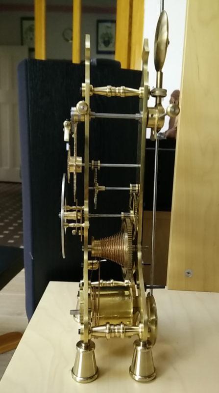

Just finished my second clock to a design bt W.R.Smith it has a Grasshopper escapement invented by John Harrison around 1755

Did you use CNC for any parts (e.g. Dial)?

After a bit of a problem with the spring barrel being too tight it's now starting to keep good time.
The dial, controllers and some of the wheel crossing was done on the CNC mill

Very Nice, how will you keep it clean? my Congrieve's I strip and clean them ever 5 yr or so.   :bang:

I plan to get a glass dome when I see one the right size and price.
