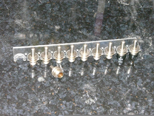

But I could calmn down fast if you would tell me more about the gripper on this page:
http://www.caswa.com/cncathome/spindles.html
Got some anecdotal information, but few things were not evident to me.
* Is that taper more or les SK15?
Its just an 8 degree taper, no idea who else uses it.
* Can I have dimenssions of the gripper collet and pull stud?
Tough, I don't use that spindle any more.  On a scale that small, I found the plain shank toolholders worked better.
Those are 8mm shanks.
re the studs:IIRC the heads of the studs were 5mm diameter.
* How does it work?
There's actually some deceit on that page (not everything you read on the interwebs is true you know).
The cad model shows a complex arrangement with three leavers and an o ring opening them.
With that spindle being so small, I got better results by making the claw look a lot like a tiny R8 collet with a groove just inside the nose to grab the stud. Then I bent the collet open and hardened it. Pulling on the drawbar would then close the thing around the studs.
* How much is the griping force? You probably had some some figures in mind when you were planning taper/force. Care to open a process a little?
Short answer, not enough. When you get that small, the overhead bits (pull studs, claws, springs etc) start taking up disproportionate amounts of room. That room comes off your friction surfaces and you loose grip.
Another bad bit is that the pull stud setup requires quite a lot of precision and hardened, high strength parts. I ran the plain shank ATC for about a year with a soft collet.
Finally though, when we started using the little router for production work, and employee cooked the magnets off the servo motor driving it. This triggered us getting our first water cooled, 24KRPM spindle. For a small machine, with a high resonant frequency, these are just the ducks nuts. I'm talking 6-10 times the metal removal rate. I'll be putting up a page specifically on them.

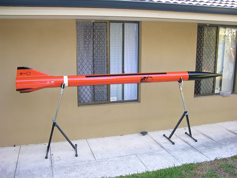

Scary looking stuff those rockets.

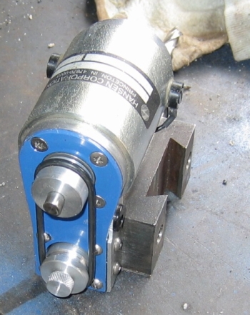

You also had interesting QCTP mount spindle:
http://www.caswa.com/cncathome/images/spindle_toolholder.jpg
Care to tell about motor power/rpm and what is that spindle good for? Looks like a 100W brush DC-motor?
I have tried dremel (not worth of unless you have nerves of budhist monk), I have Proxxon BFW 40/E which I think is a bit of a toy in performance and pig in size:
http://www.axminster.co.uk/proxxon-bfw-40-e-mill-drill-system
I was in process of putting an 3 phase AC motor with vector drive to get close to right rpm with belt drive, when I got slightly off the track with PM AC servo, less than 1/2 the size and more rpm, but I had stability issues (AC servo and old inverter).
I have been reading some stuff on BLD motors, but haven't been able to nail the motor/driver combination. I don't want to go RC stuff, and can't bring myself to pay real brand servo prices. Probably will build two. One rough one for drilling 2-6 mm dia holes and realatively low rpm and other with collets and high rpm. I like belt drive, gets the motor away from spindle and easier to align.
Yeah, its a bit of a dilemma.  The requirement is for a small powered head that fits on your toolpost and can drill big holes.... Hmmmm. To get the performance, you need something about the size of an Seig X2 head, Which is too big.  So you go small and fast, which means small cutters and chatter.....  Dremels are a classic example of how far marketing can take a bad design. The overhang from the bearing is enormous. I've heard good things about the proxxon..  When I've really needed to get jiggy with a toolpost spindle, I've ended up with a trim router. Noisy but effective up to 1/4" cutters... To answer your question, the motor was about 150W. But driven by an O ring on those little pulleys, I doubt it could transfer 100W.
I reckon you're on the right track with the FVD. Fractional horsepower 3phase motors still tend to be quite large though. Brushed DC is really the best power density per buck at low RPM's maybe add an encoder and run it from a Gecko DC servo drive.
As you've figured out, adding an encoder gets you a brushless servo which can deliver high torques at low RPM's for medium bucks. IIRC I bought a 600w Servo for about AU$650 landed a year or so back.

                  Welcome to the forum, your Rockets look very interesting, can't wait to see more posts.
