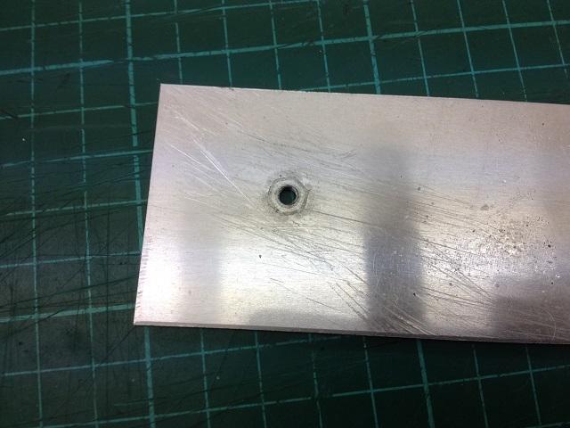

 John(Doubleboost),
Very neat repair you demonstrated in Sunday Nite Nightcap # 66 (
0iPSQ&index=1). Is there a formula or rule of thumb that lead you to choose 7mm to bore for a M4 nut? Any correlation that can be used for such repairs using SAE nuts?
All the best to you and Debs.
Chuck

To do this we need to calculate the diameter of a nut ACROSS THE POINTS given the conventional width of the nut measured ACROSS THE FLATS.  That diameter, suitably adjusted for an interference fit, will be the size of the recess into which the nut is driven.
Take a look at the canonical circular arc diagram shown below.  In this diagram the desired diameter,  d, will be twice the radius, r.  Similarly, the width of the nut, w, will be twice the apothem, a, shown in the diagram.
d = 2*r
w = 2*a
From the diagram, we have,
a = r * cos(x)
so:
2*a = w = 2*r*cos(x) = d * cos(x)
Solving for d,
d = w/cos(x)
For a hexagonal nut, x will be 30 degrees so,
cos(x) = sqrt(3)/2 = 0.866
Finally,
d = w/0.866 = 1.1547 * w
Remember to drill slightly smaller than d so the points of the nut have something to bite into.

Sorry Lads
No magic formula I measured across the flats and just went with that
The flat bottomed hole it the important bit
I will have a play with different size nuts & post a bit video
